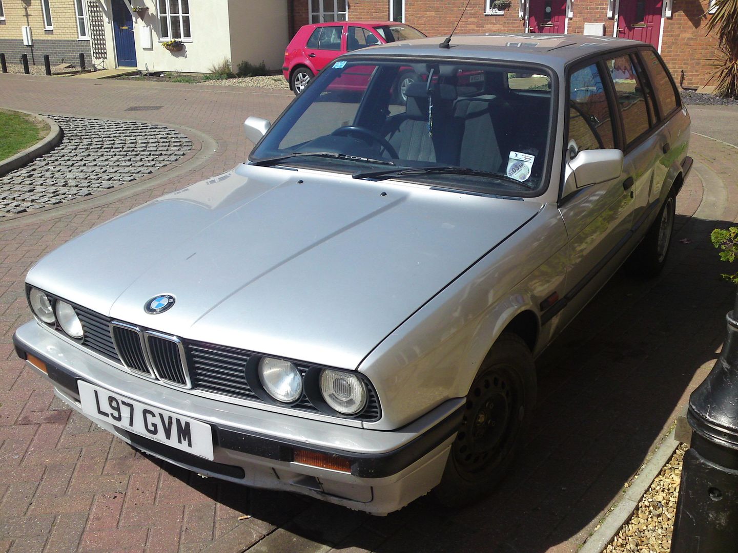

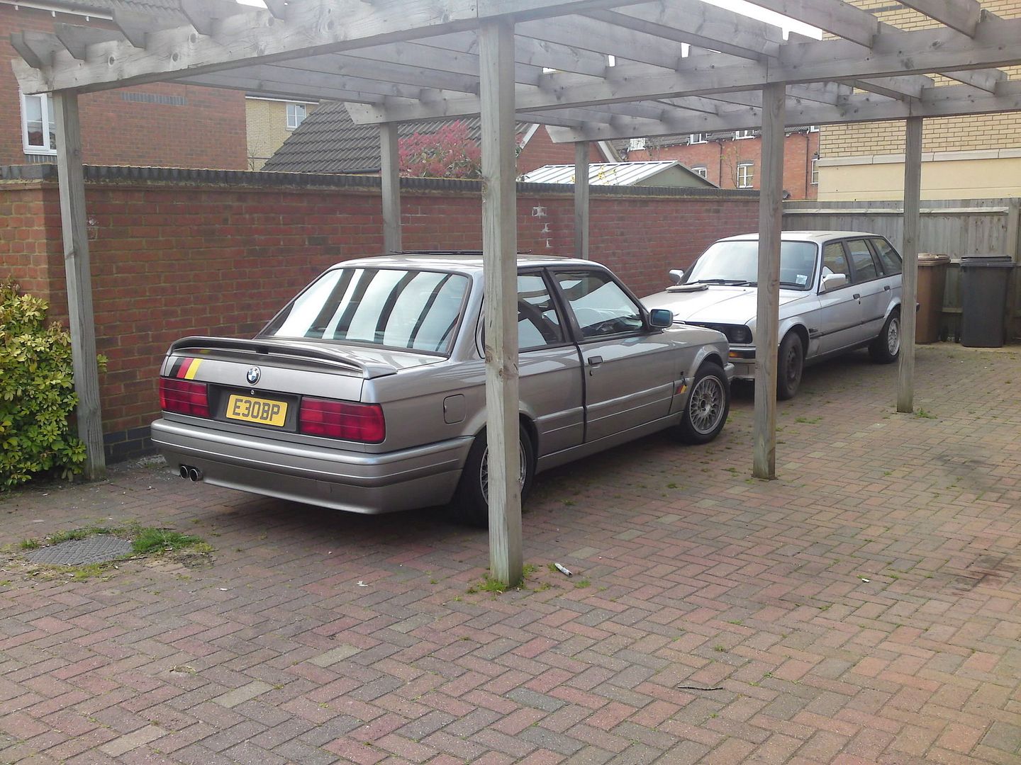

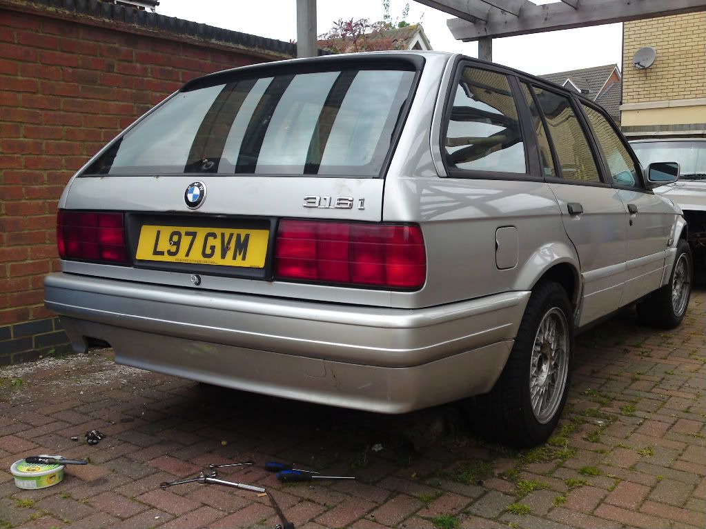

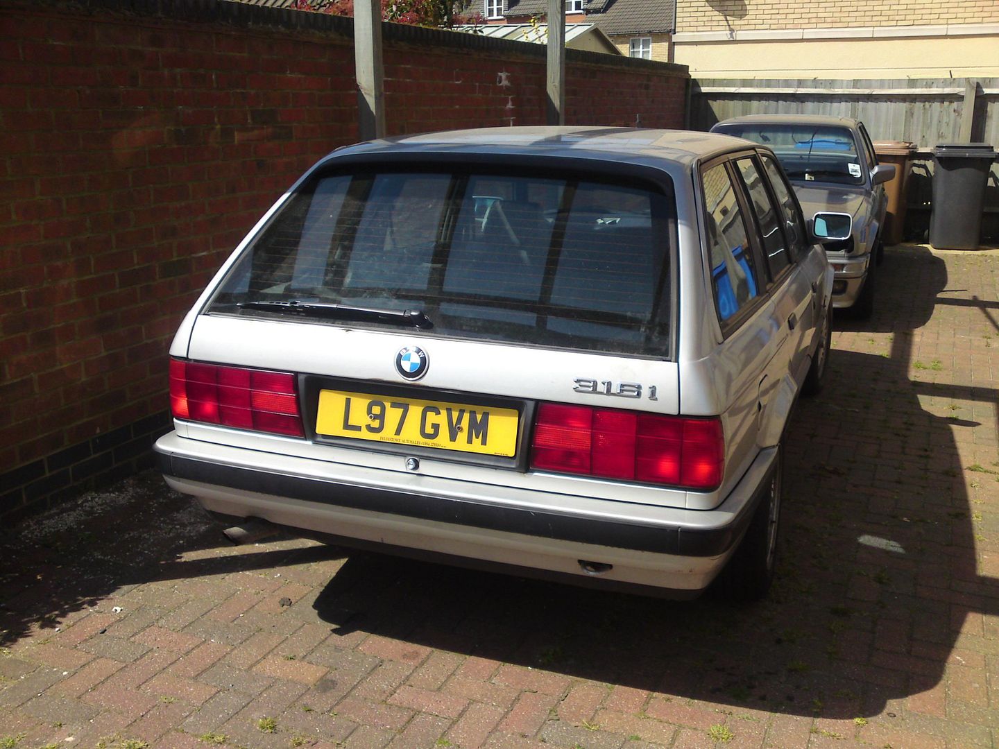

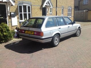

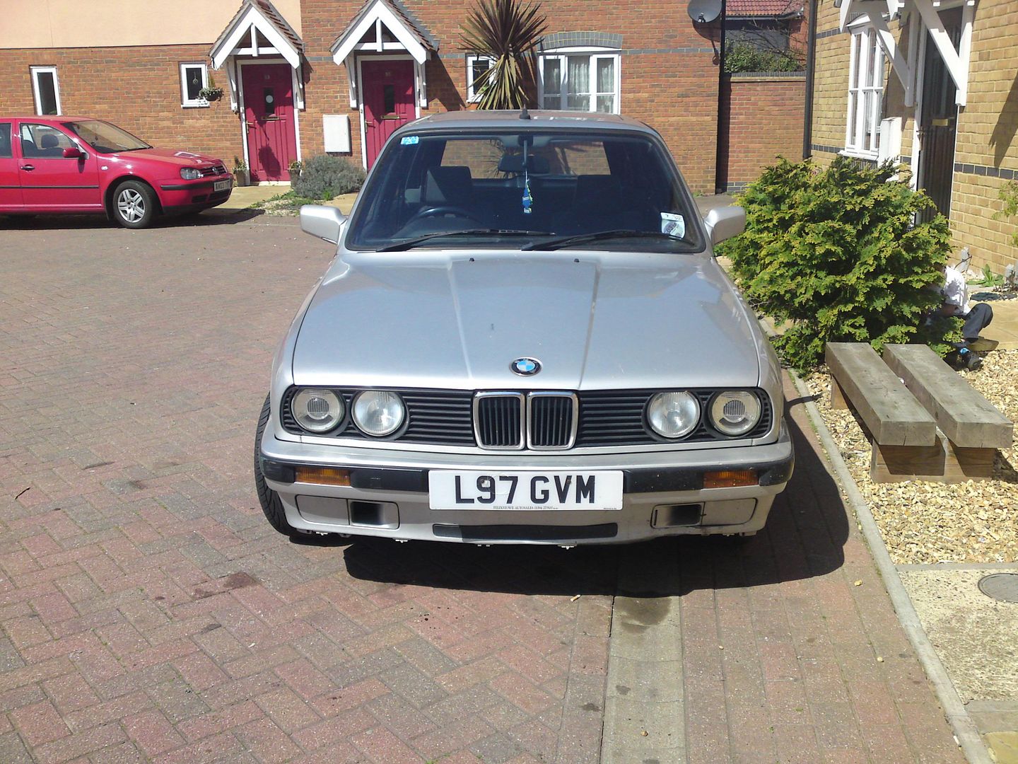

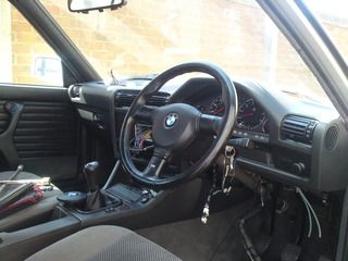

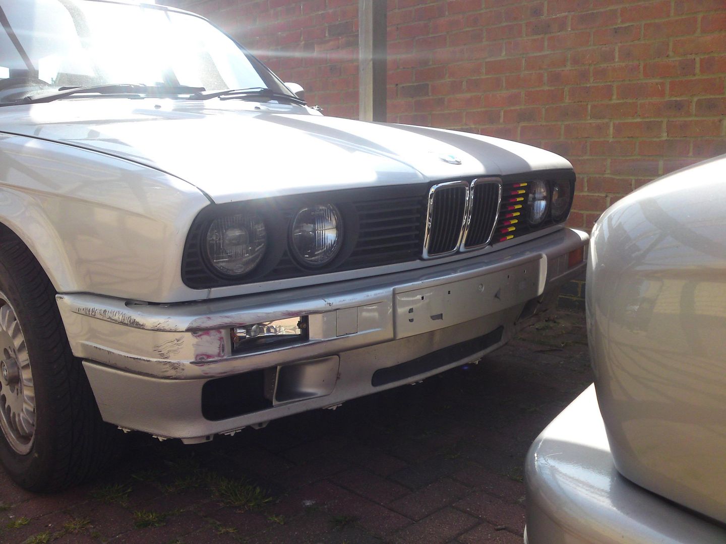

Well i now have the touror home that i got as a free bee, the mot runs out tomorrow so i`m going to start striping it.

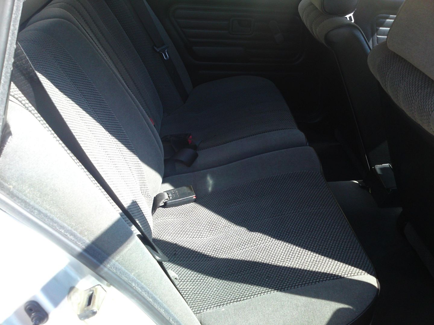

first thing on my list is to do the interior completely rip out the touring interior dash seats and carpet and then do the same to the sport swapping everything over that will go dash, electric sunroof kit and panel at the same time sell my black leather to make way for a tour leather.
here a couple of pictures

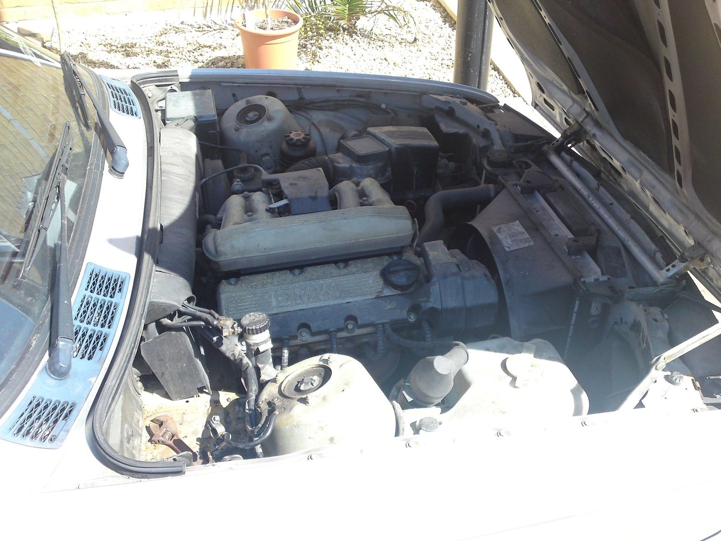

The engine bay is solid no rust well lacquered and very dirty, 316 m40 has the cam-belt gone so will be lifting it out soon.

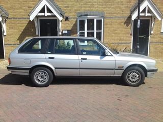

borrowed this picture from the net i`m sorta want it looking like this.

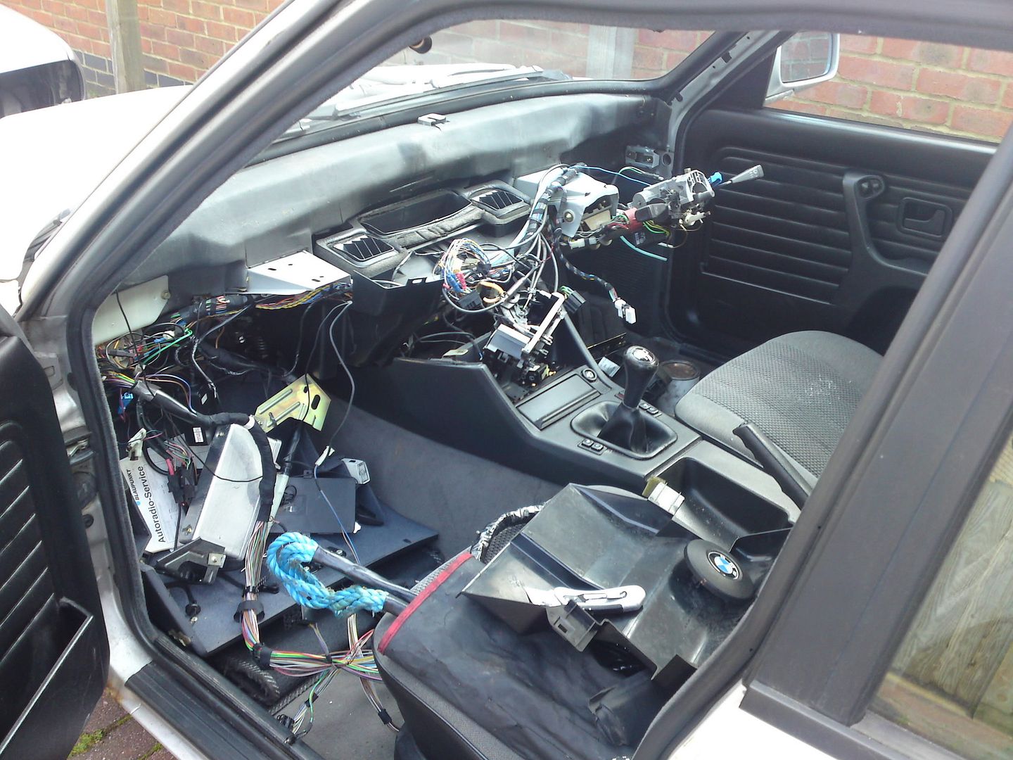

well i`v taken out the dash today as it was very cracket every where, easyer than i thought but just got to put it all back again :roll:
look at them both :cry:

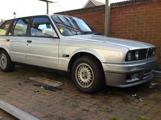

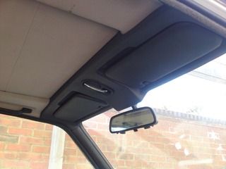

just a couple of things i`v done so far.
cut the roof to make way for sunroof cover and but in the map light.
taken out the old cracked dash and put in the one from my sport.
swap over all the lights.

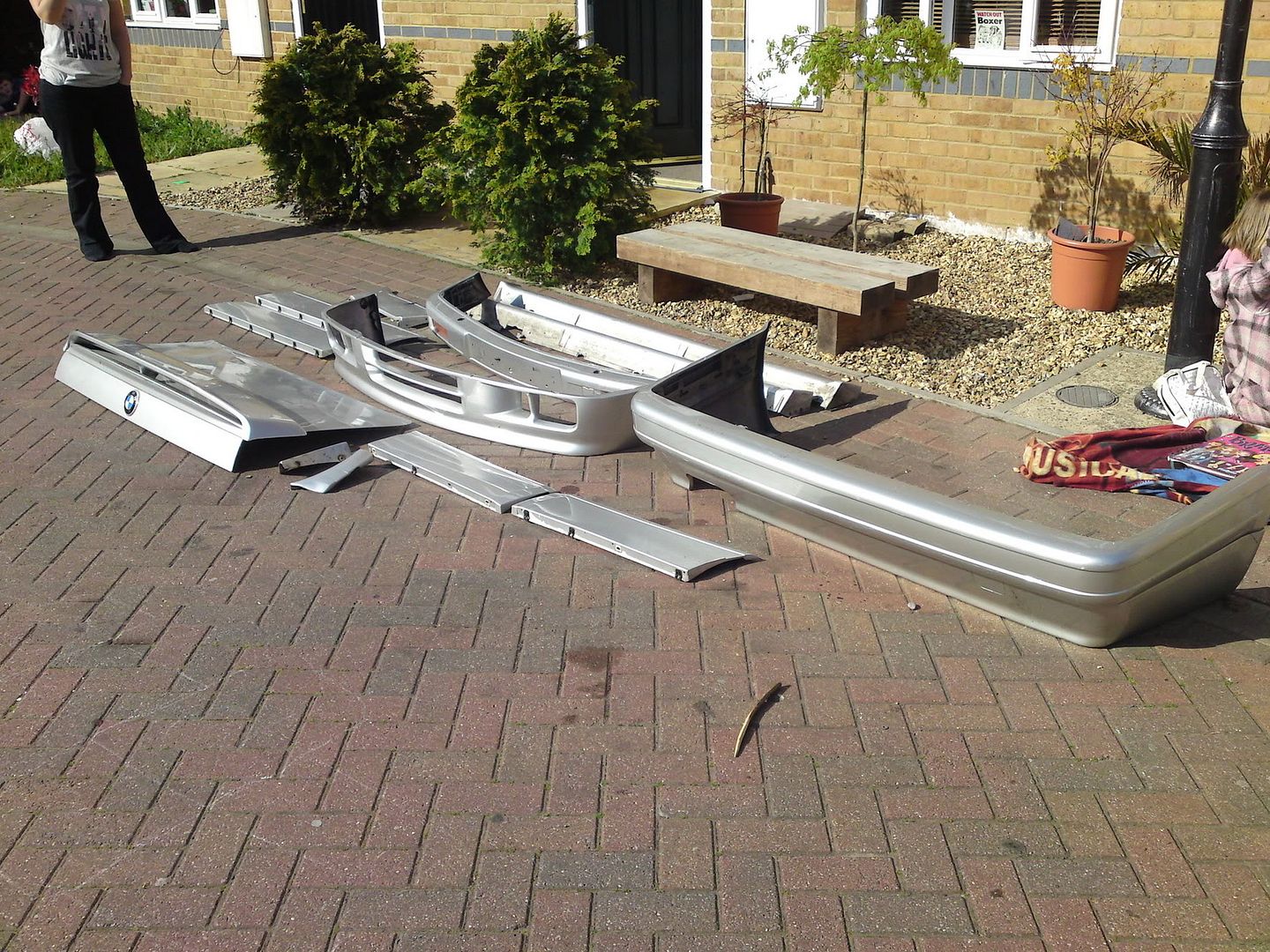

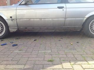

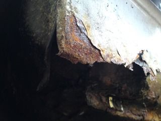

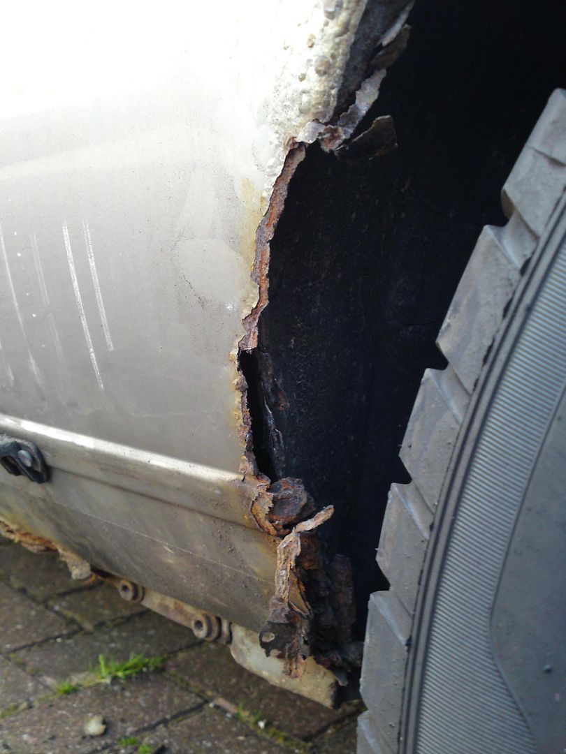

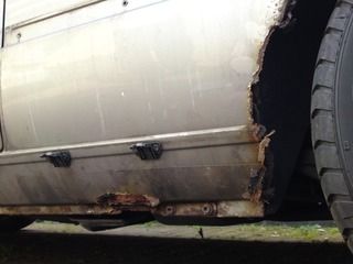

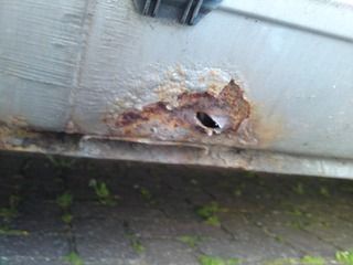

well i started to take the tech 2 kit of the sport today and look what i`v found :roll:
i`v also started to put the tech 2 kit on the touring as well.
Posts: 11155
Sun Apr 25, 2010 7:00 pm
Nasty. Make sure you put some waxoyl behind the side pods.

kieran325
Posts: 5016
Sun Apr 25, 2010 9:30 pm
8O That's shocking Baz!!

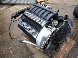

Well it looks like it`s going to be m50`ed but not to sure on what to do engine is coming to me at the end of the month going to need some help from all you m50 guys.

Just got back from a 2 hour round trip to pick the engine up it`s dry all round saw all the paperwork had a full service history by BMW and the clocks was sitting on 119,866 miles. very happy man lets just hope it runs good when it`s in.
where do i start :roll:

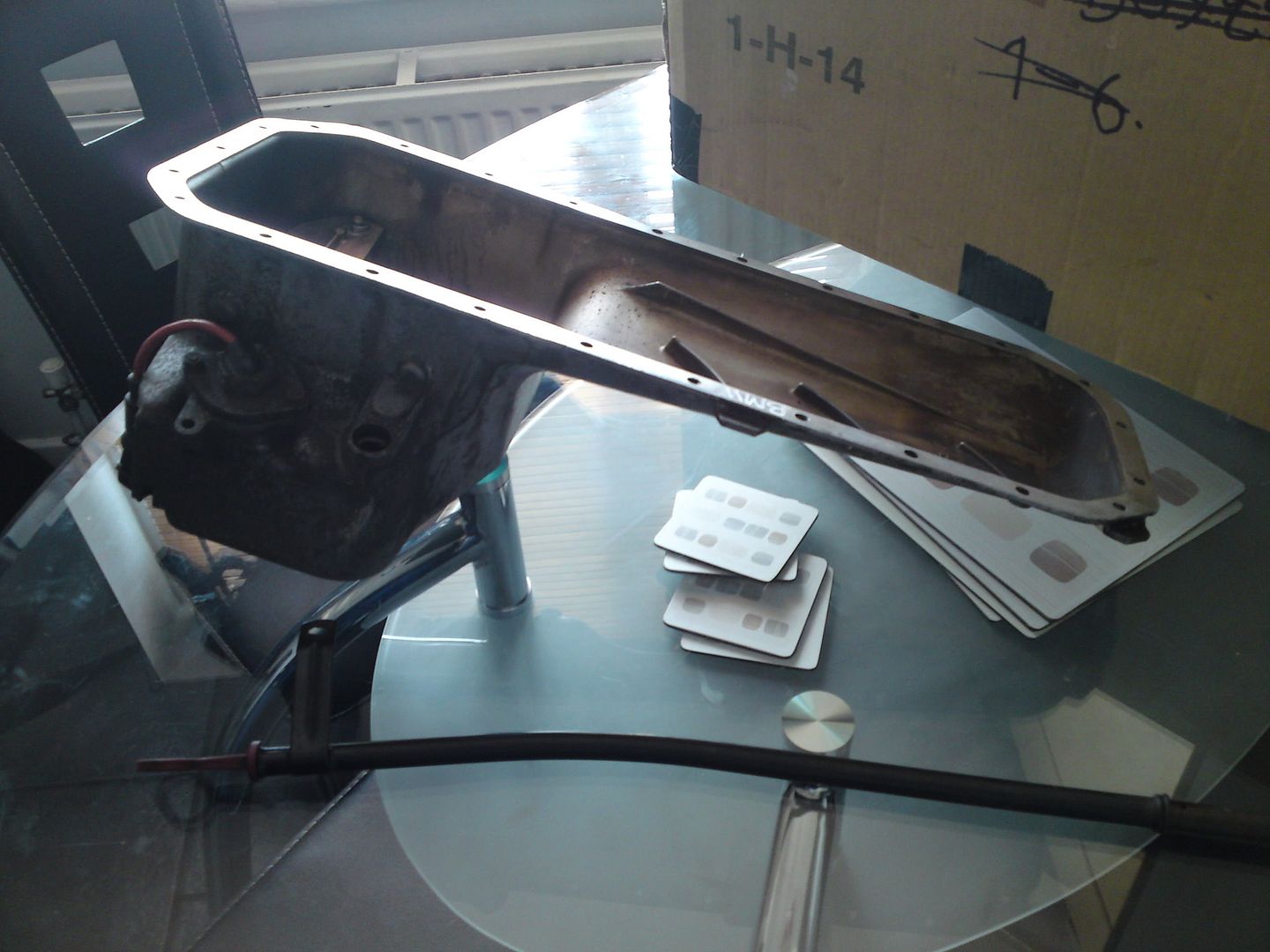

Get the sump and oil pick changed over. Get the rubber mounts from the e28 i'm guessing. While the engines out, lighten the flywheel, IS gearbox.
Baz666
Posts: 3516
Location: Ipswich, Suffolk
Tue May 04, 2010 4:23 pm
All brought and should all be on its way to my door this week just need to find the mounts.
euro car parts i think. do anyone know which e28 mounts i need ??
FMH
Posts: 3213
Location: Birmingham
Tue May 04, 2010 4:26 pm
I'm not 100% sure but i think any e28 rubber mounts will do. I'm assuming the engine has come out an e36 considering you were after the e34 sump so you already have the metal mounts.
Tue May 04, 2010 7:52 pm
This is going to be great baz, its a shame the sport was like that but i recon 95% of average condition sports are like that behind the bodykit
Touring will be perfect when done, tech II touring with M50
You need
E34 sump oil pickup pipe & dipstick.
E36 engine arms
E28 M5 rubber engine mounts
M52 exhaust manifold
the 4 pot rad should work will need a temp sensor putting in the side for the leccy fan, an IS one or e36 one would be better as they are bigger
m20 flywheel and clutch
320i gear slector
325i prop
e36 rack
Pm danthe for plug and play looms :D
i think the 4 pot gearbox should work with the m50 :)
Tue May 04, 2010 9:03 pm
Baz, make sure you buy & fit a new sump gasket when you swap over the sumps, you certainly don't want the dramas of needing to replace the gasket once it is in the car :)

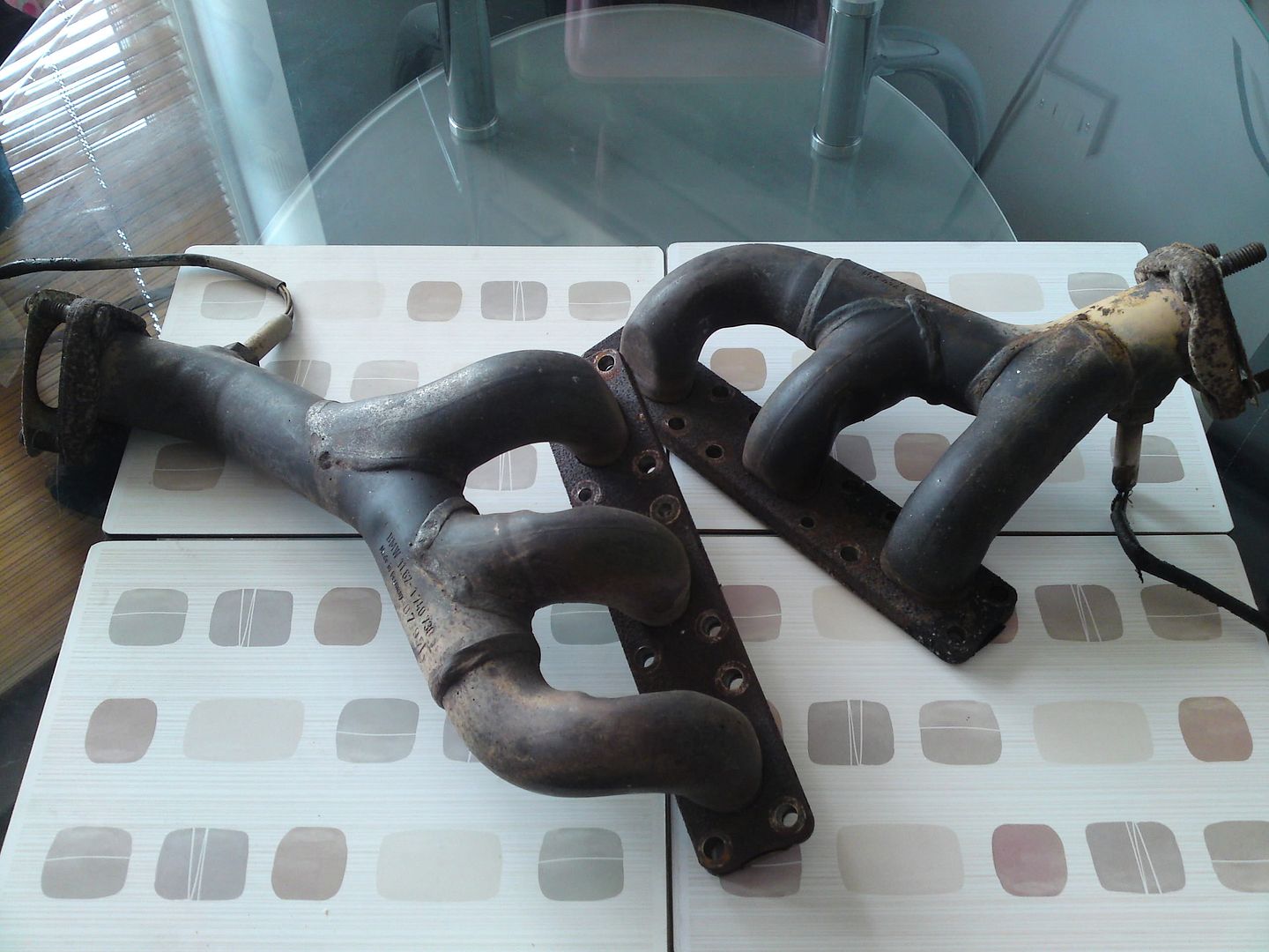

Thanks Alex i`v got e34 sump, clio servo, m52 manifolds on the way to me just need to find the rest, did you do it all your self fella i`m abit worried as i dont have a clue what i`m doing really.
Beemerlad yeah i`v got the sump gasket on order with my main dealer.
if there`s any one out there with a bit of free time on there hands that would like to come and give me a hand then all means do so :mad:

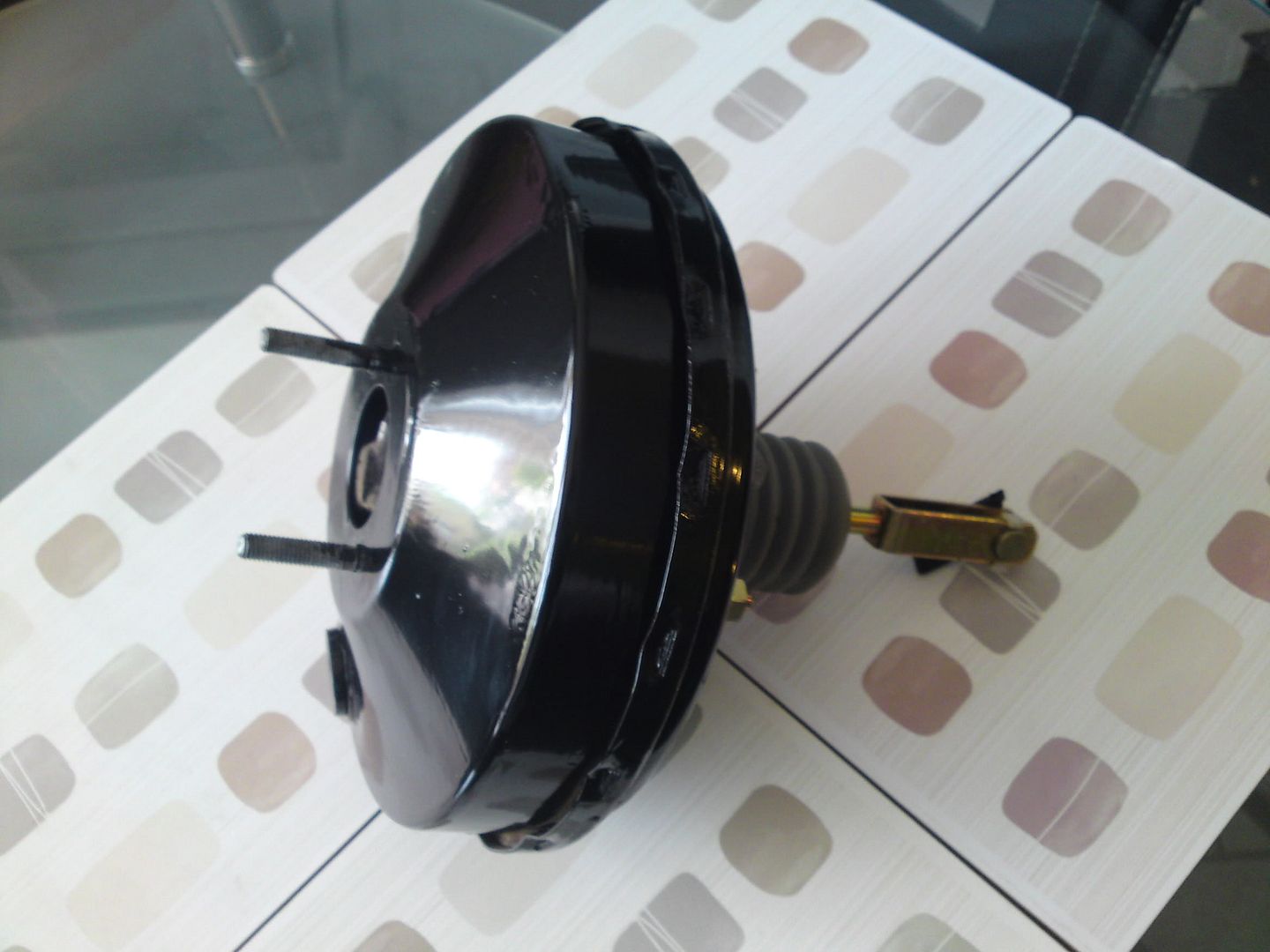

Parts are now start to turn up :cool:
m52b25 manifolds
also clio servo

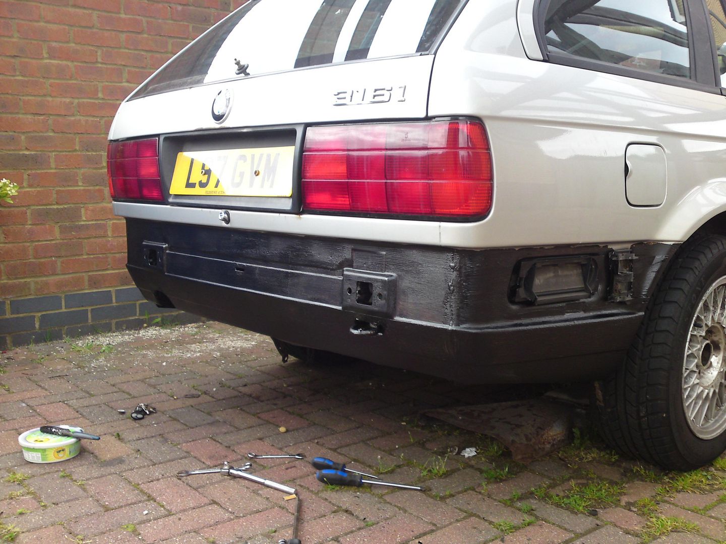

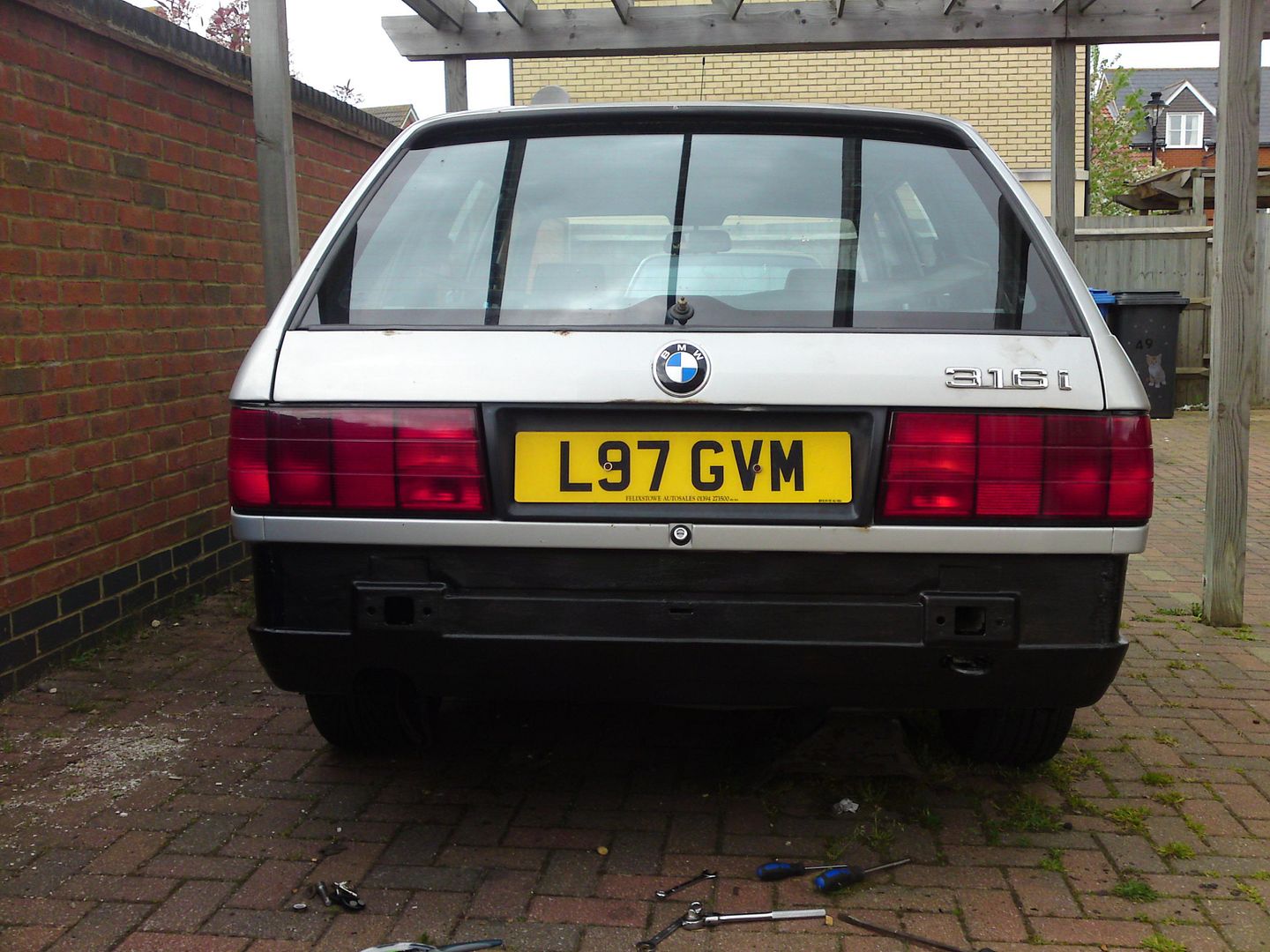

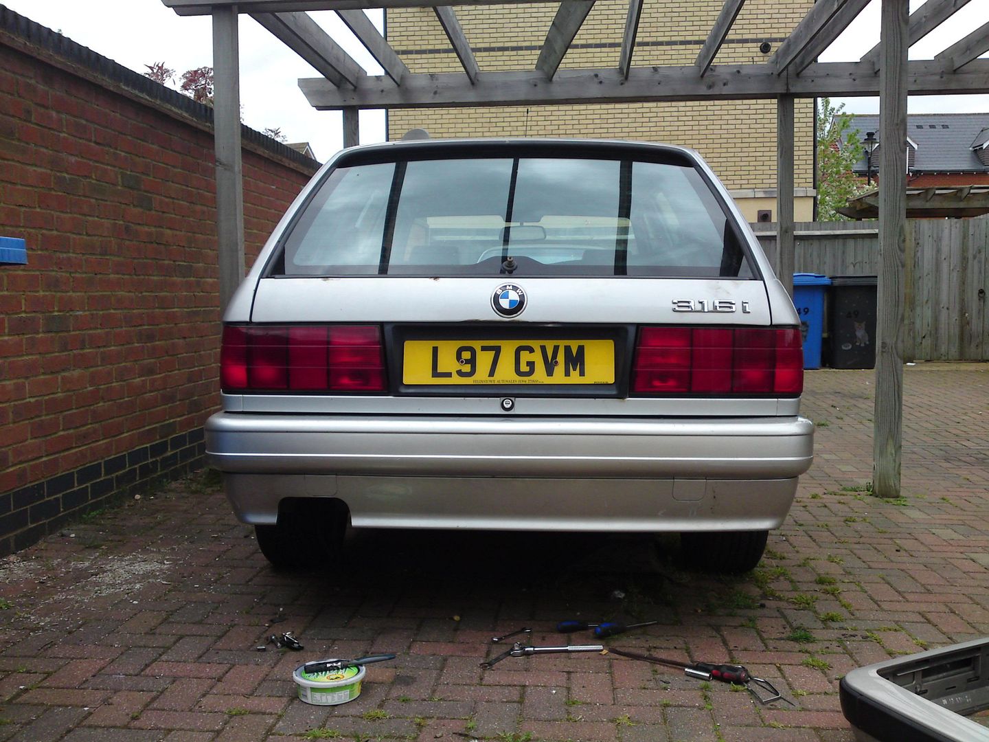

bit of an update had a bit of a play with the rear. I`v undersealed the rear valance which was solid away and but on the rear tech2 bumper.
