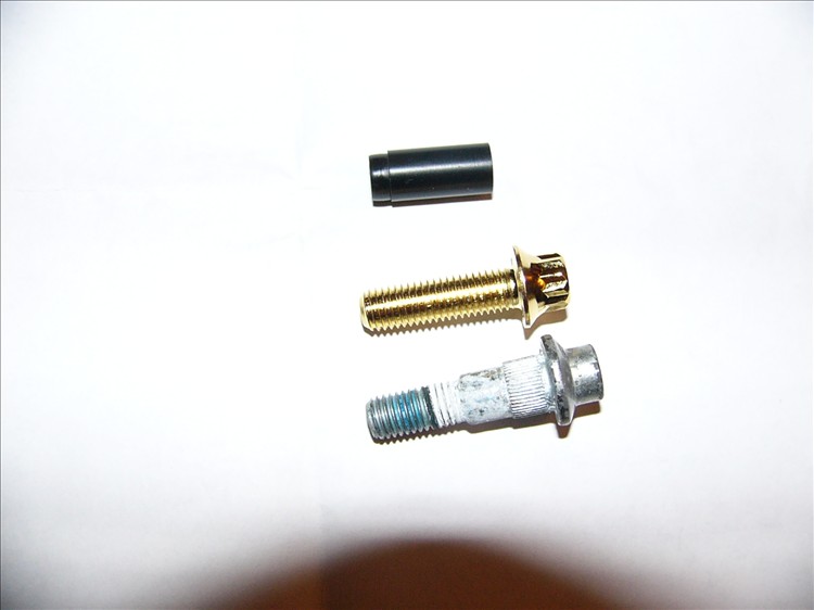

nice....i love them :cool: :cool: :cool: just 2questions...for what is blue tape on bolt and glue (or what is it)?? and if u can tell me where did u buy them?? and can somebody help me, what colour is on these...realy nice ones :twisted:
S38B38
Posts: 458
Location: Iceland
Sat Mar 06, 2010 10:51 am
Miris325i wrote:nice....i love them :cool: :cool: :cool: just 2questions...for what is blue tape on bolt and glue (or what is it)?? and if u can tell me where did u buy them?? and can somebody help me, what colour is on these...realy nice ones :twisted:
THESE looks just like mine hahaha
This , center looks like the set i had under my M5,, the color is similair to E39 M5 oem wheels ,, shadow-chrome, but because of the many spoke system it really not shows the color,,
the tape,, hehe,, all 7 mm aftermarket bolts are not tight fit to the oem 8.x mm hole on the BBS RC wheels but oem BBS nut are also 7mm but the chest of the bolt is bigger ,, shown here
thats why i had a LATHE to made these thin nylon sleeves,, but i didnt had more of them so i used el-isolation tape,, works as well an 30 times cheaper
and the glue,, loctite is a MUST,, do not even think not using it,

You put a small drop of the glue on the bolt .. where the nut will sit when tightened ,,
