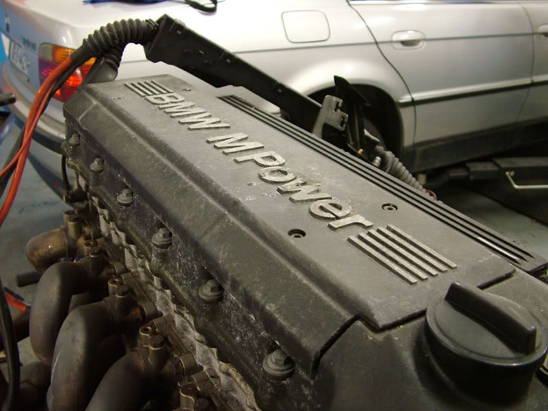

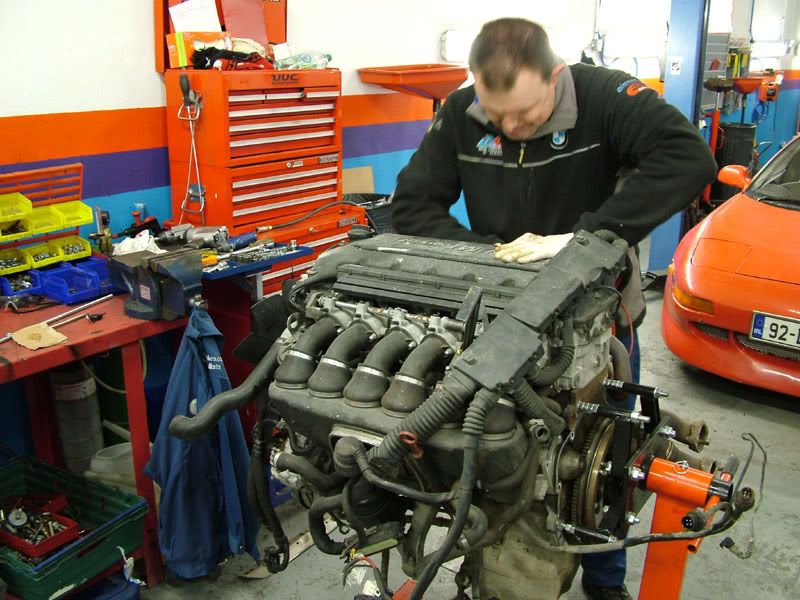

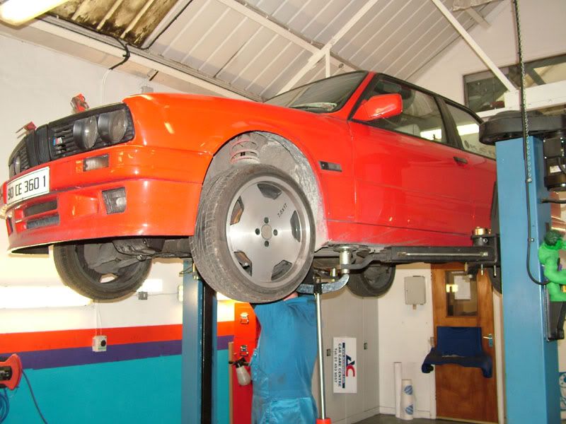

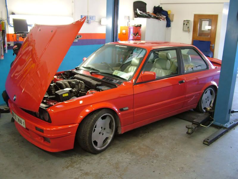

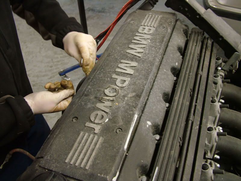

So i Bought an S50b30 engine, box, ecu, all ancillary's needed from the donor car to do the conversion and its currently up in AC cars getting done by Dicko a genius at these conversions, hopefully soon enough ill have it back done and dusted:D
Progress so far:

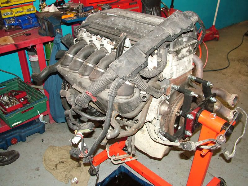

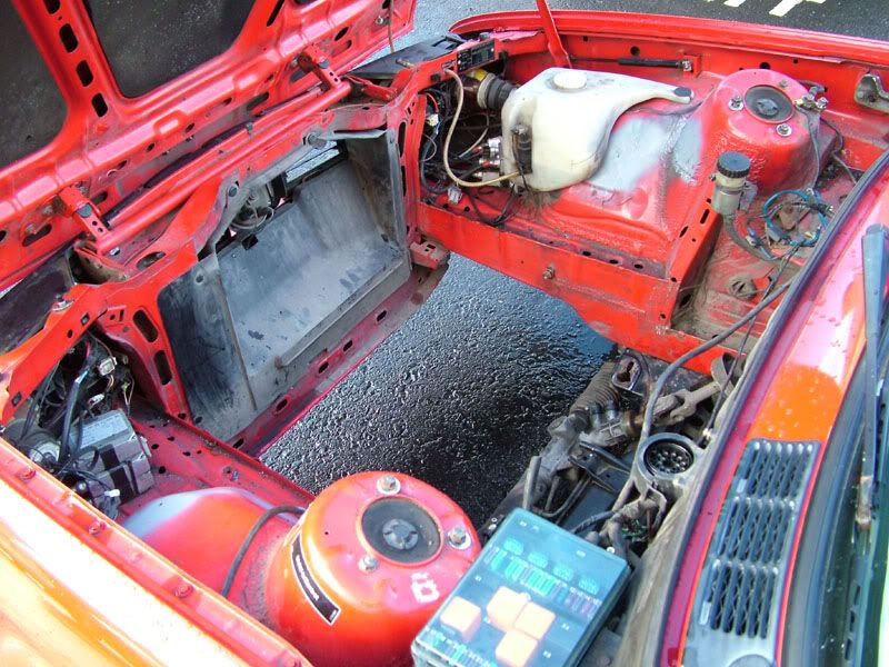

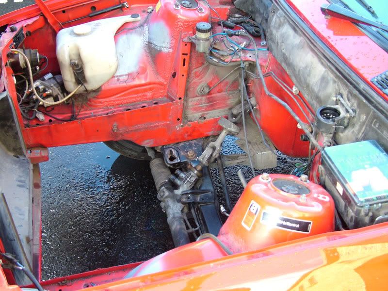

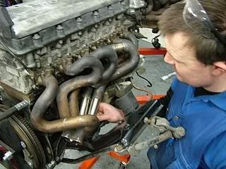

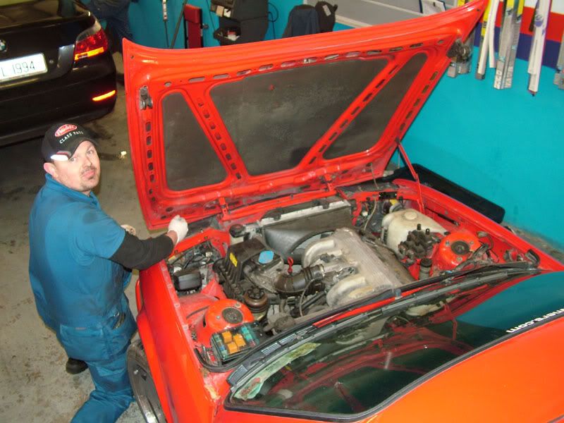

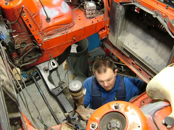

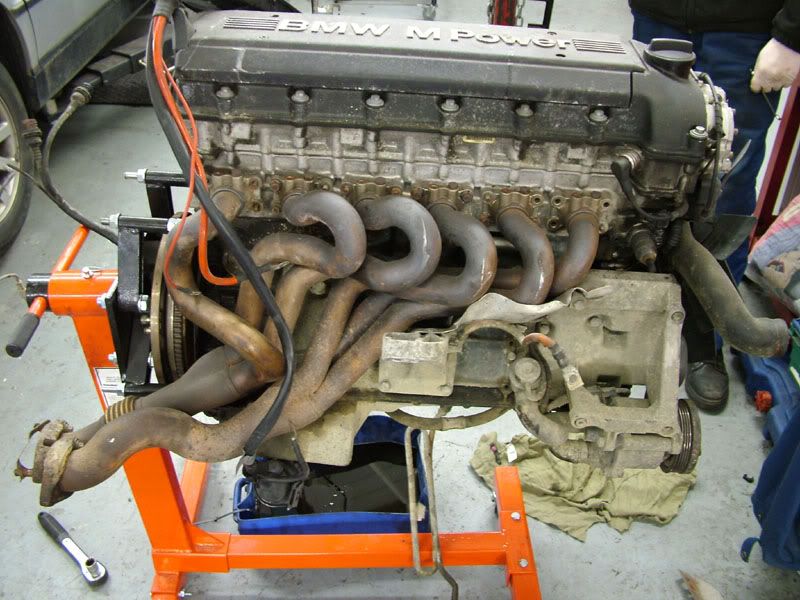

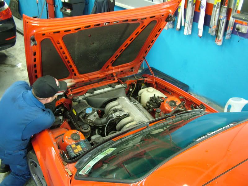

Old Engine Coming out,

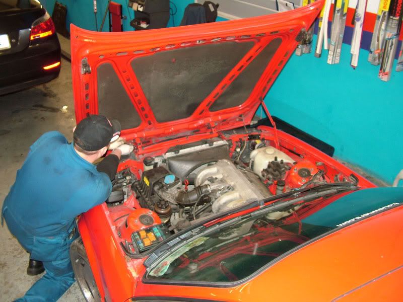

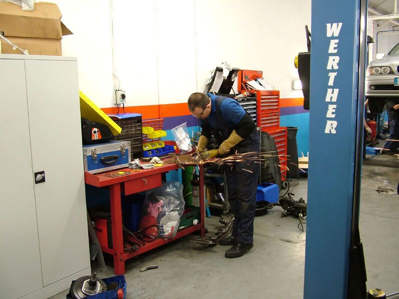

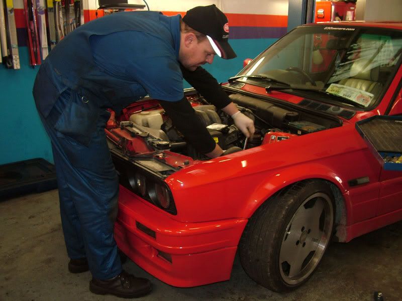

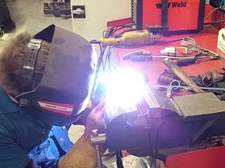

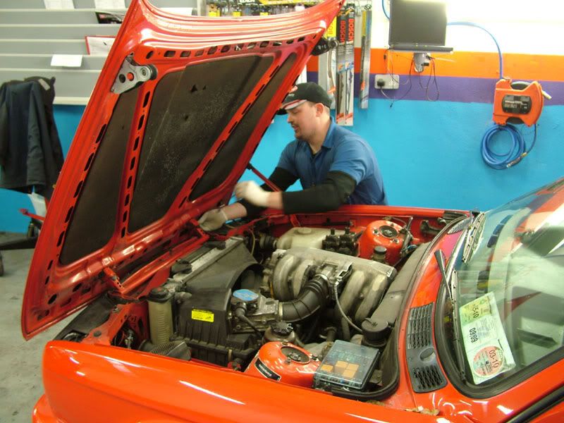

Dicko Hard at work:D

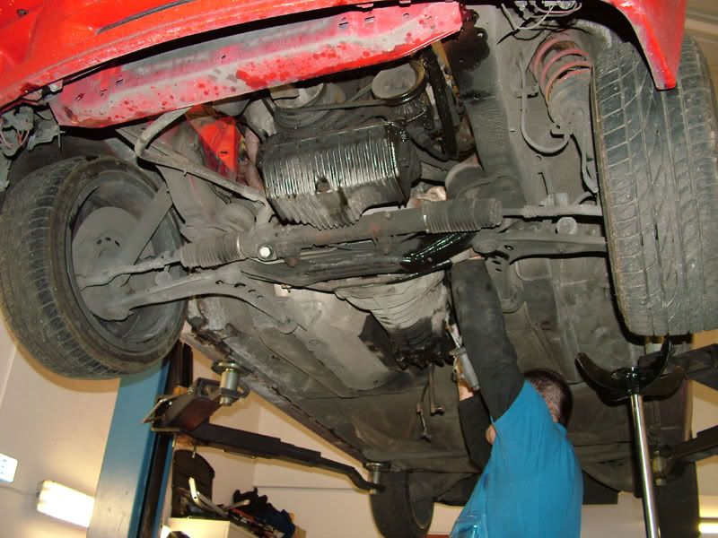

The Car is Filthy, ill have to keep it off building sites after this:o

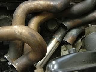

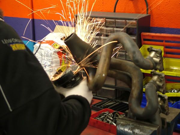

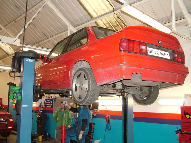

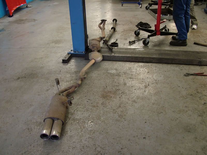

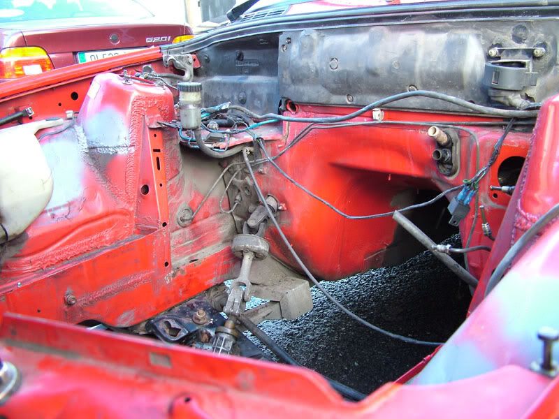

Old Exhaust system off

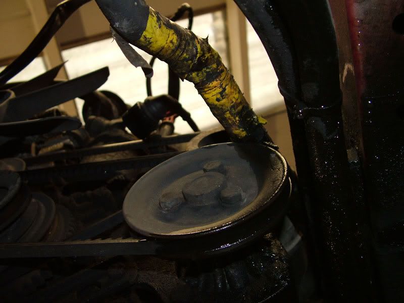

DIY Rad pipe fixing,

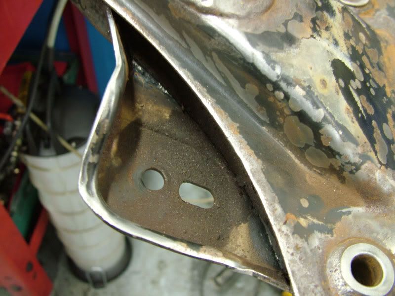

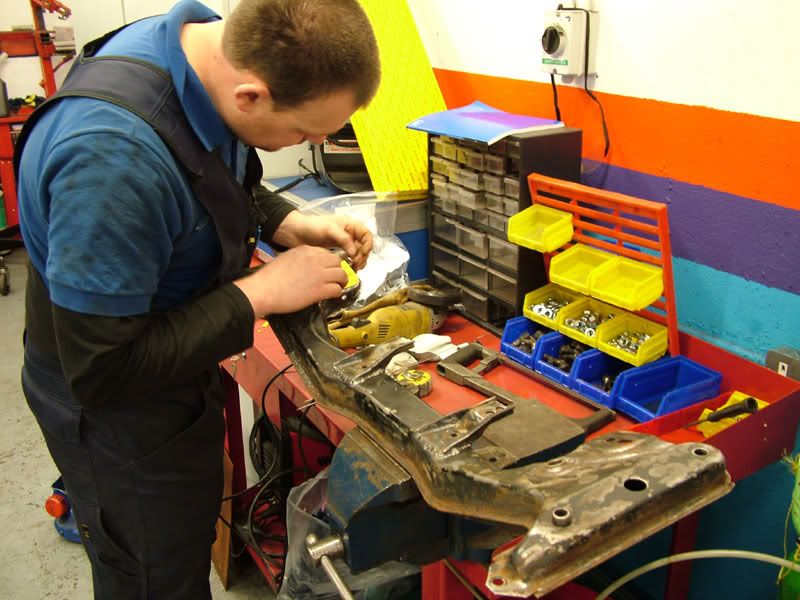

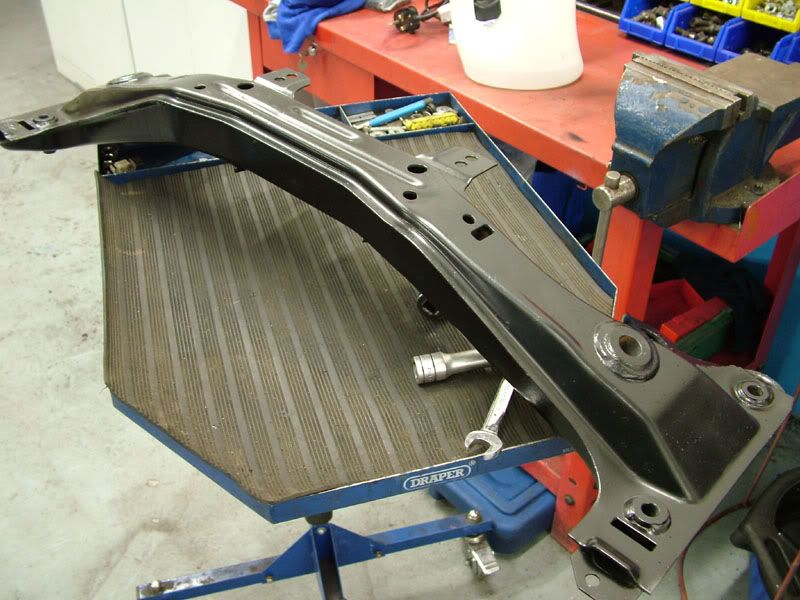

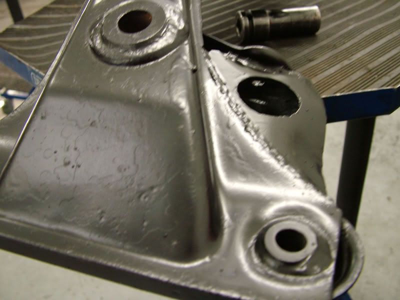

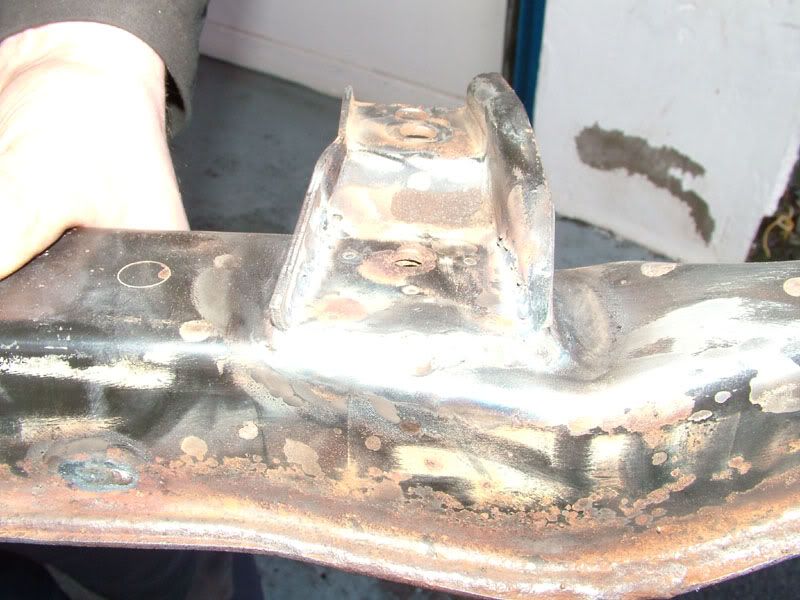

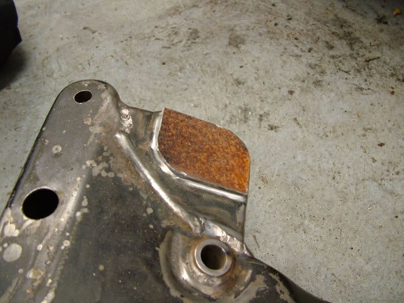

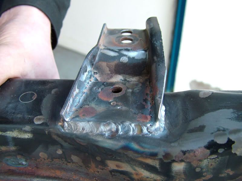

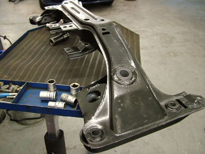

My own subfame was badly cracked seems to be a problem with 4 pots, so I Got another front Subframe from a 6cylinder car and dicko set about re-enforcing it, as when a 1.8 can pull engine mounting points thru a subframe imagine what a 3.0l could do:eek:

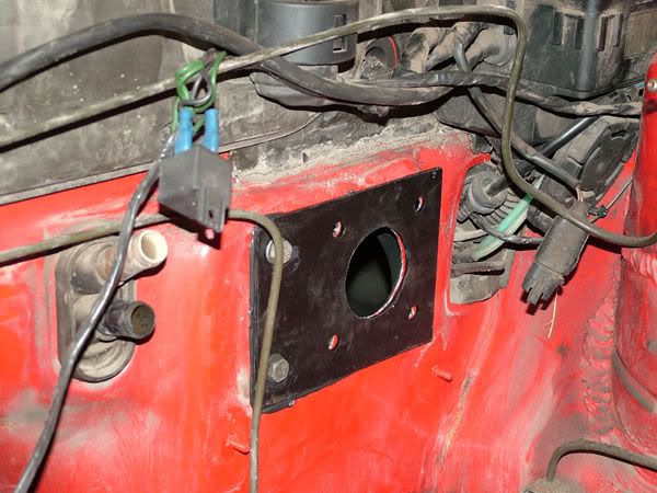

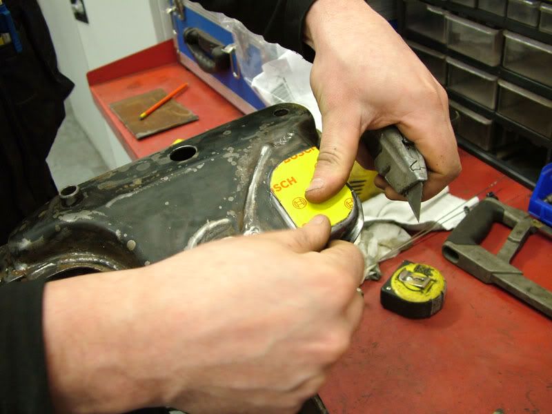

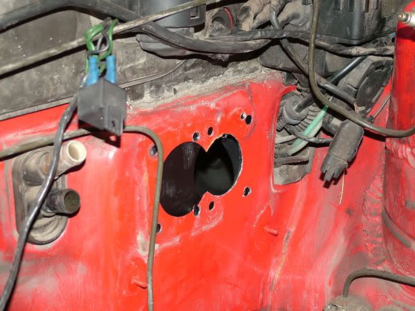

New Brake Servo, smaller dual diaphram unit from a Renault Clio, smaller in size but will have good pedal feel, the servo also needs to be moved to the left on the bulkhead to clear it inlet plenum on the s50

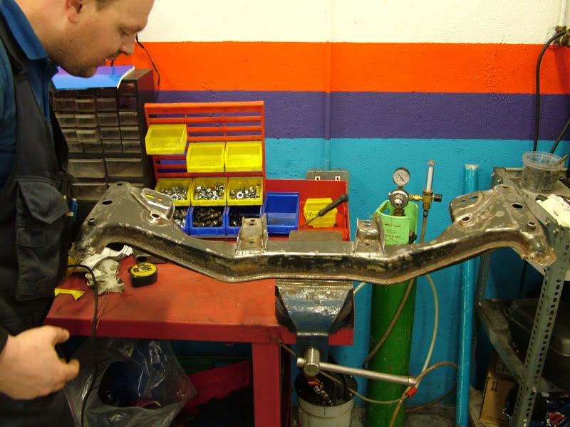

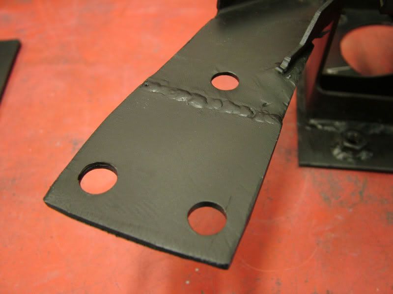

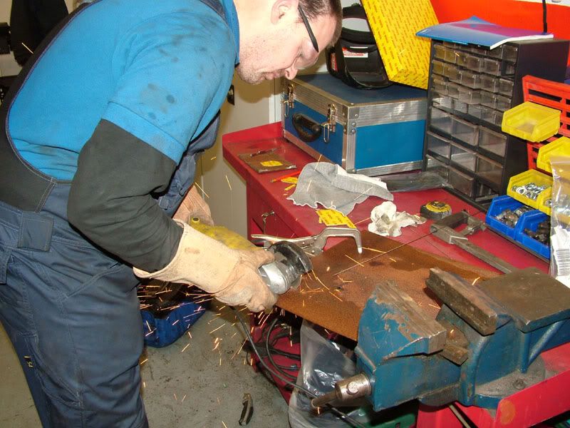

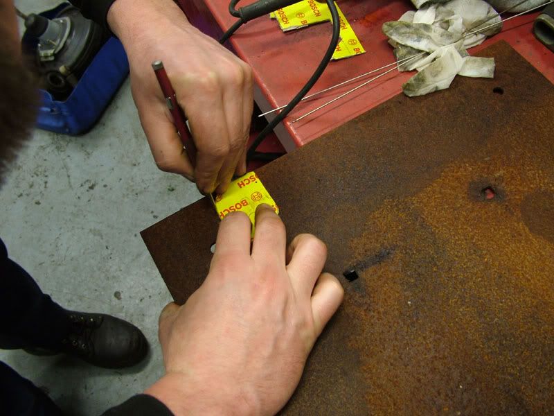

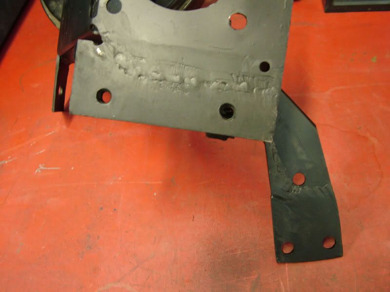

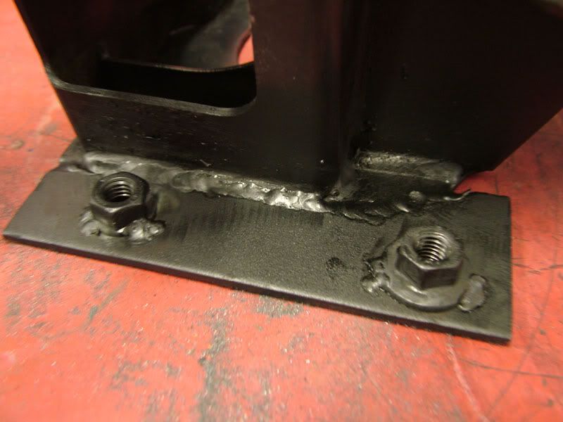

Making the re-enforcing plates for the subframe

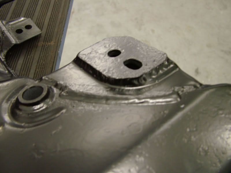

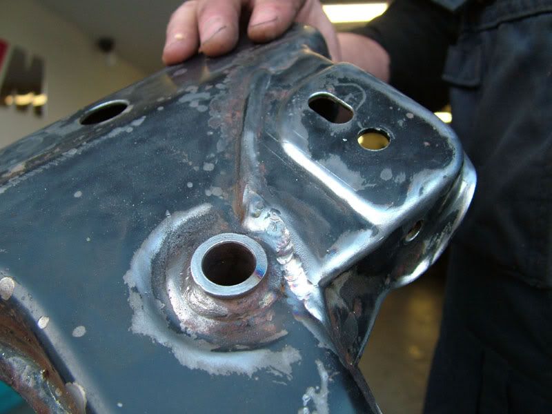

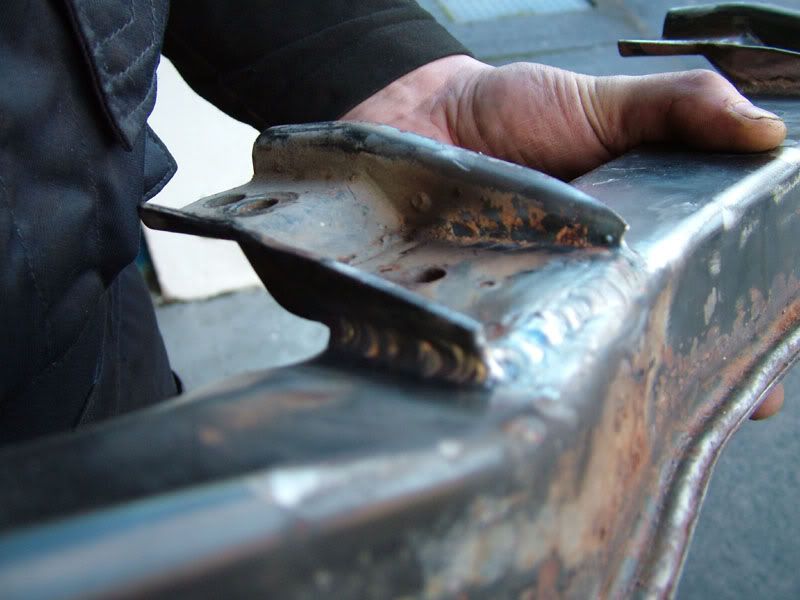

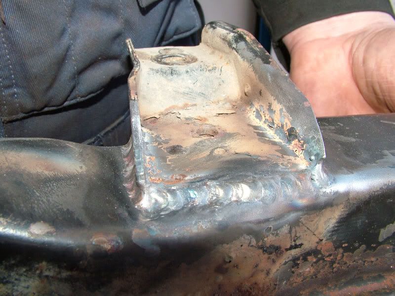

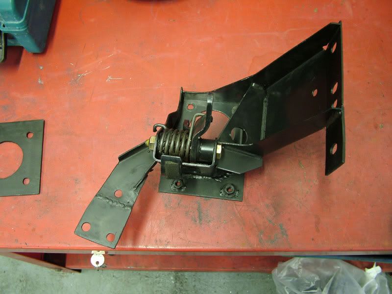

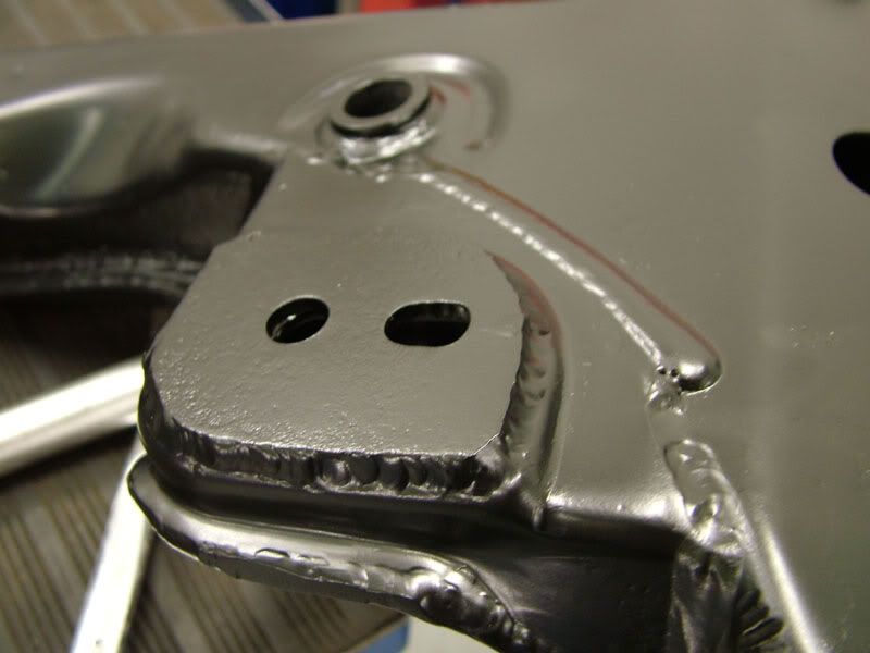

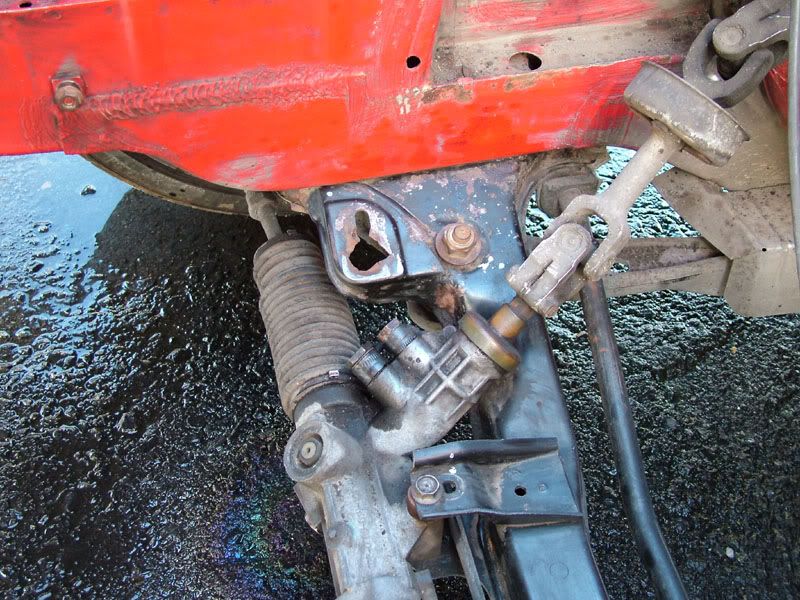

The Power steering mounts only come with 3 spot welds on them from the factory, so Dicko decided to seam weld them all around
Old Engine mounting points on the original subframe:eek:
All Brackets and fixing that were no longer needed were removed sanded and in primer waiting a lick of paint
Subframe finished awaiting some paint:D
