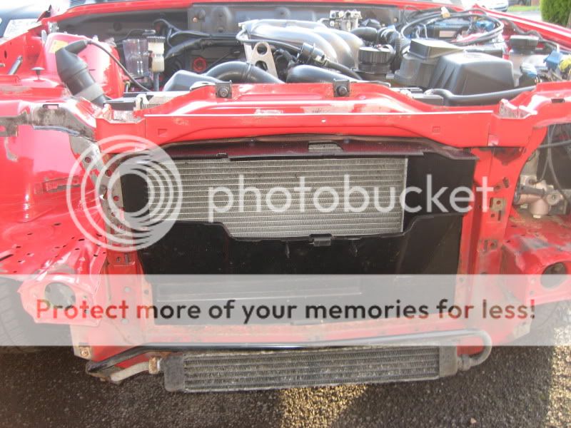

Update ****25/10/09****
Had a couple of hours today to have a play, so a little more stripping in preparation for the upcoming paint.......
Not going to remove shadowline trim from doors, just gonna get masked and painted, after taling advice form others on the zone.
Unfortunately both roof gutter trims corroded/chipped so will need to be replaced.
So far the list is looking like this, rear panel needs some attention around the top fixings for the black in fill numberplate panel, around numberplate lights is all good, rear arch lips need some attention and some areas on the bottom of the sills where the stonechip stuff has come away as well, bottom of front arch needs a little new metal grafting in, all in all i'm quite happy, could have been worse.
Took the front wing off, inner bottom a little crusty, looks like mostly surface stuff, mind i' let Bearymatt decide if its worth saving or not.........
A few pickies :D :D
Front panel needs some surface rust attended too as well.....

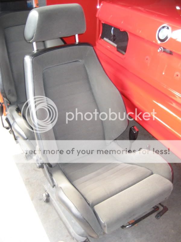

PS any idea what i could do with these E28 Recaro's winkeye winkeye

Recaros are in a nice trim, id get the worn bits replaced with pieces donated from a scrapper and put them on the bay with a reasonable reserve 8)
djk
Posts: 2389
Location: Hertfordshire
Mon Oct 26, 2009 12:38 pm
Do they fit e30s then? In the henna?
Posts: 28646
Mon Oct 26, 2009 12:46 pm
No good for an E30, much too wide
