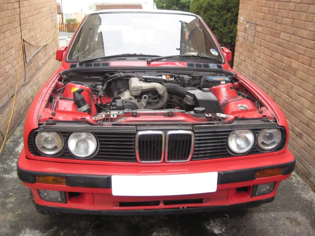

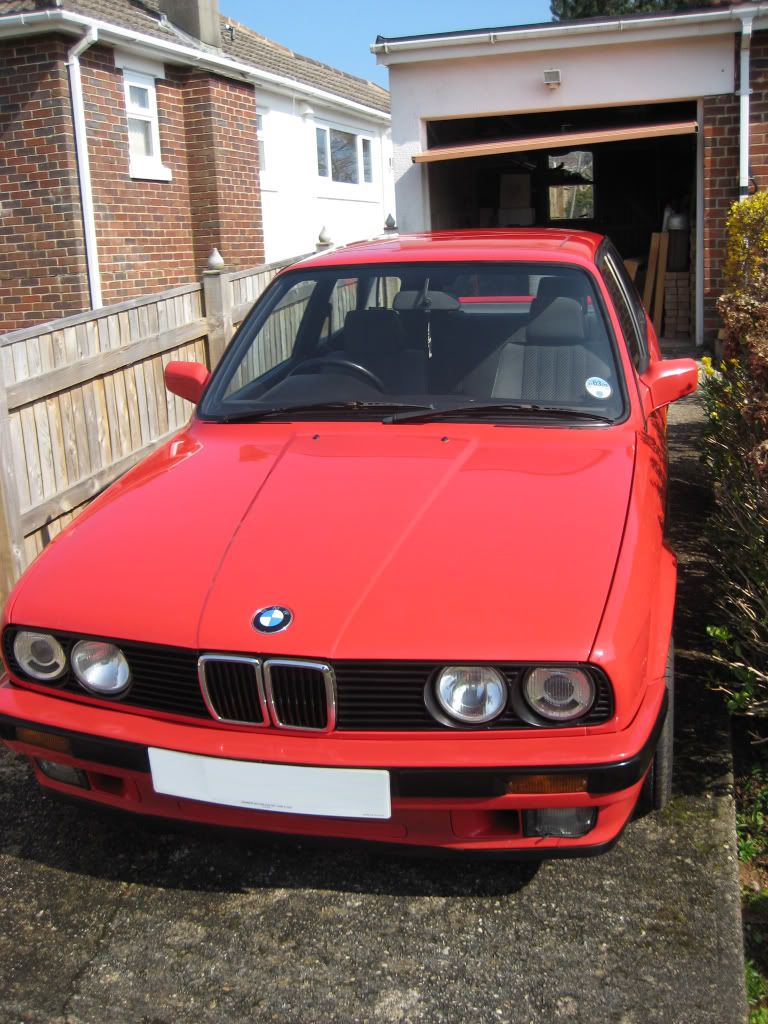

pictures when i first got it in need of a wash:

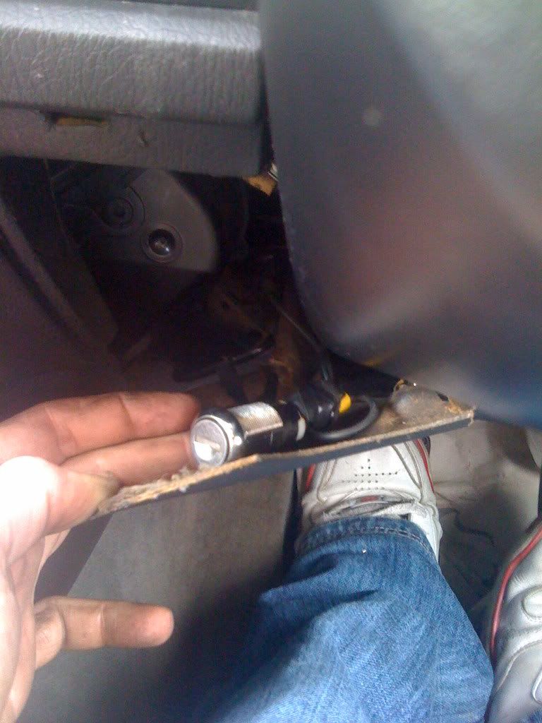

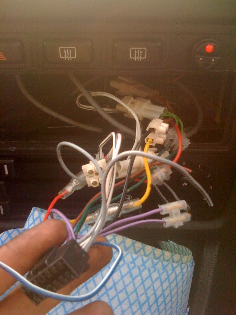

butchered stereo wiring + mutilated panel
The 2nd ignition barrel :? disconnected it, wired the wires together and the car started... (with the keys obviously!)

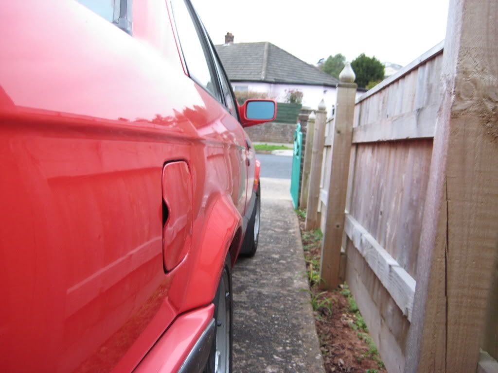

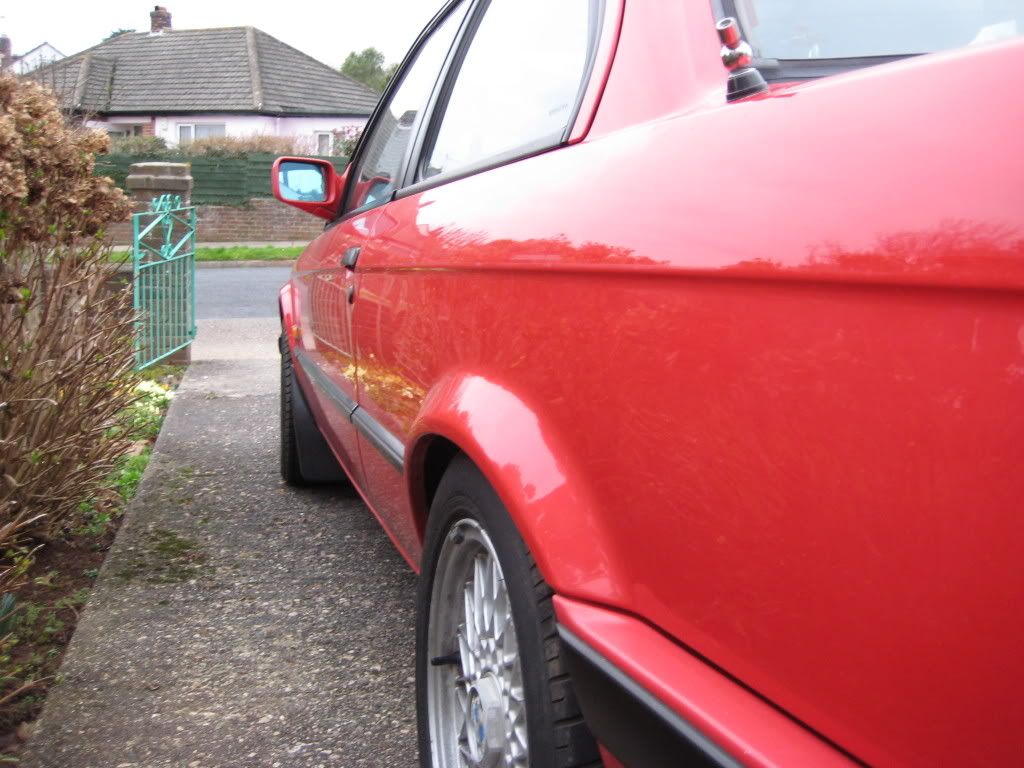

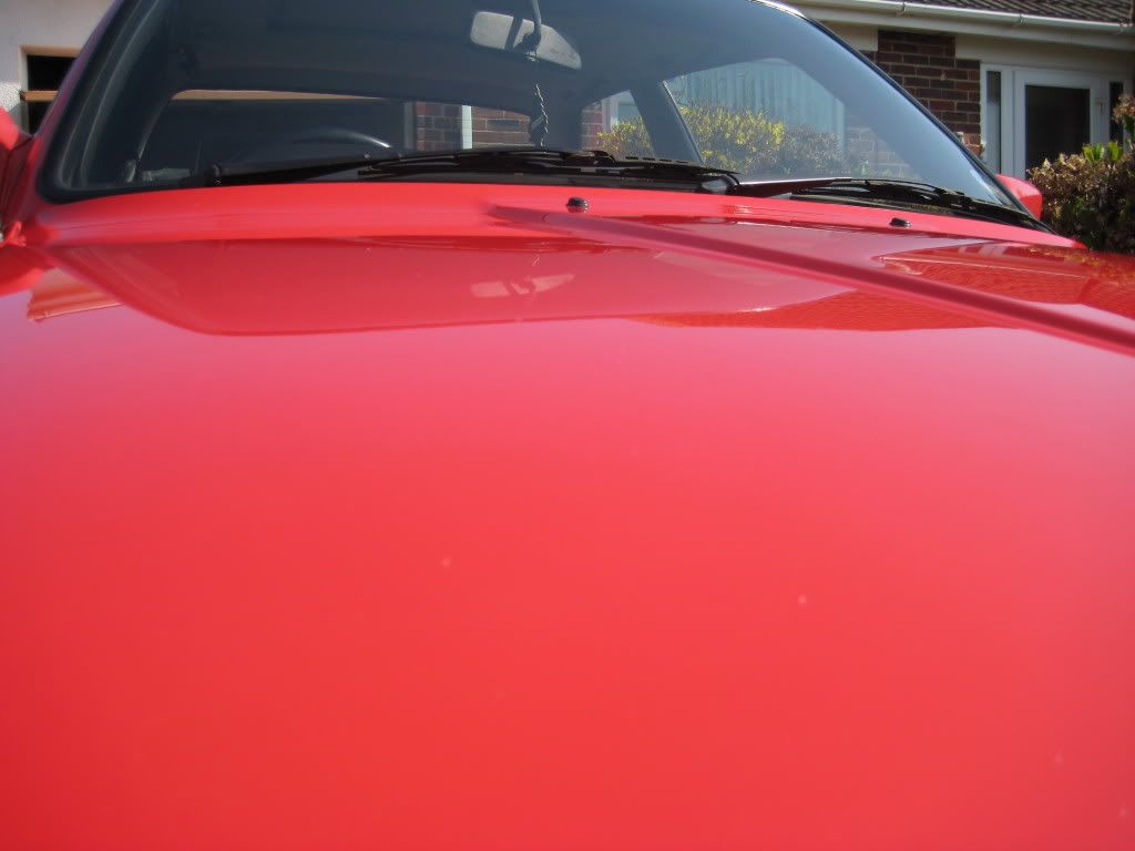

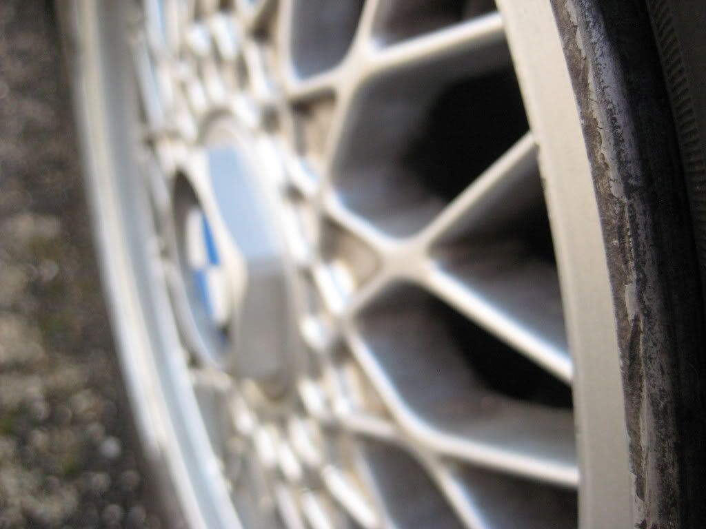

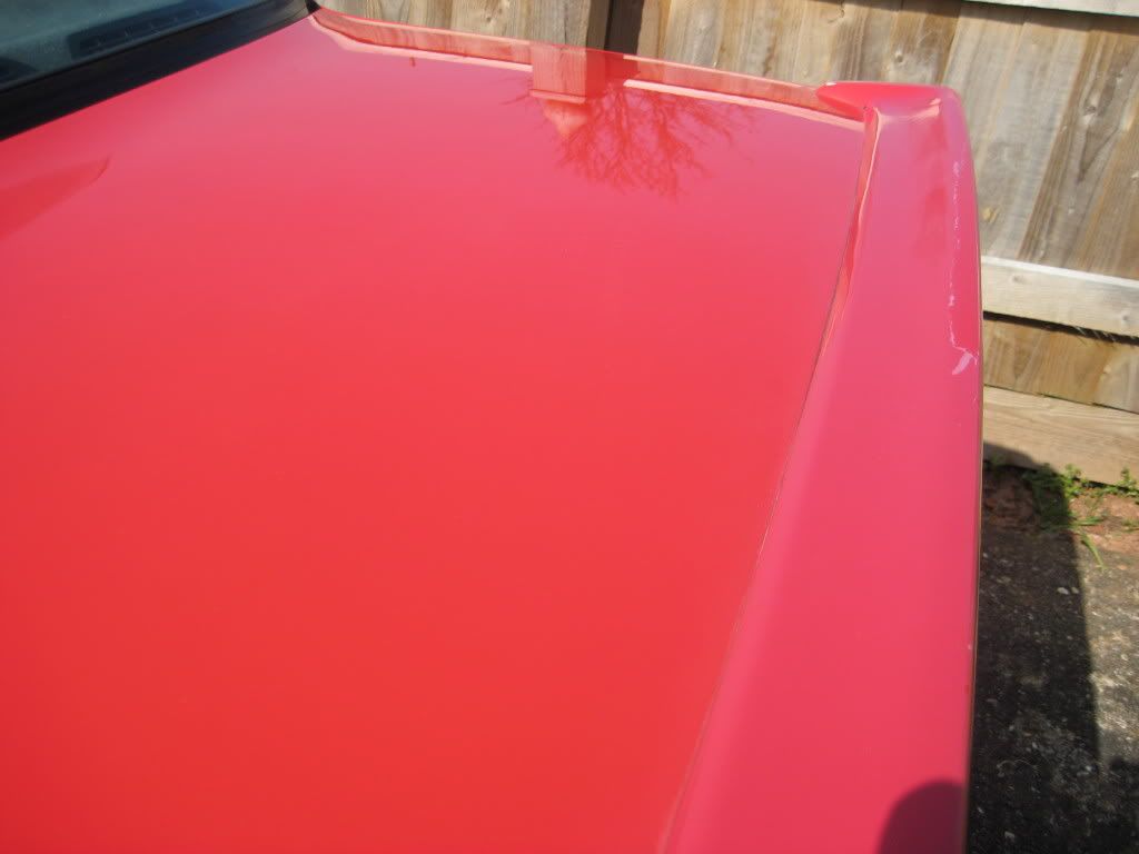

One nice day i gave it a quick wash and a polish. When its actually on the road, i'll be taking it over to my mates to mop it :D
Looking into a spoilerless boot eventually anyway

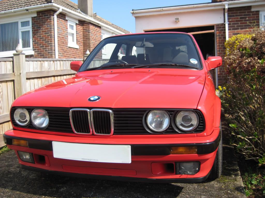

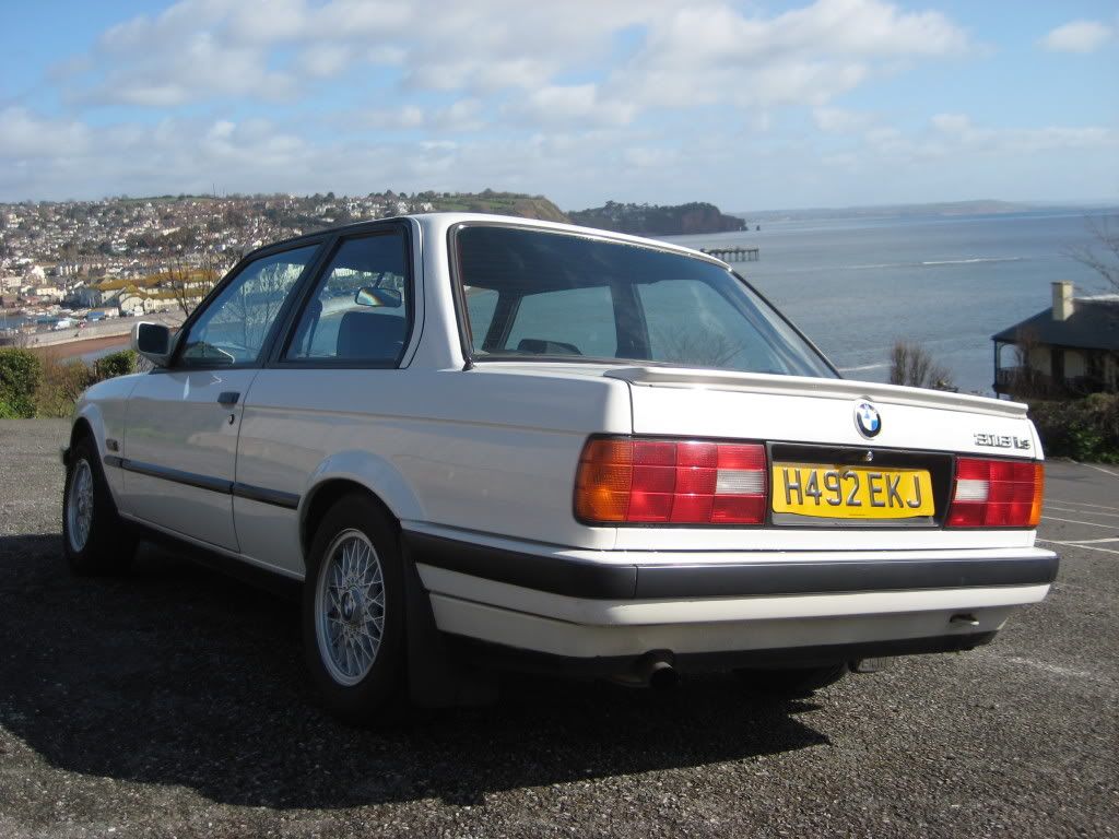

Spot the iS

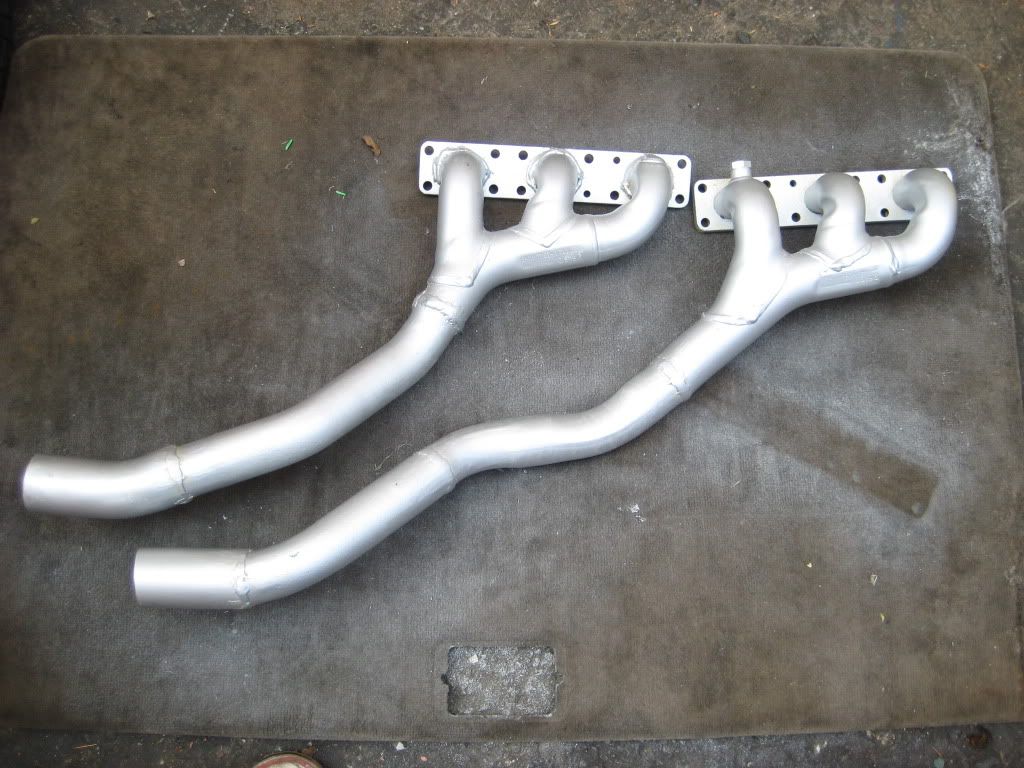

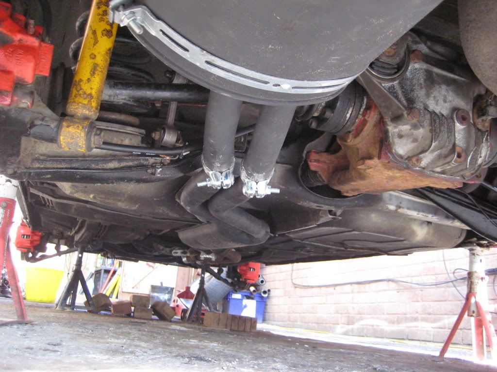

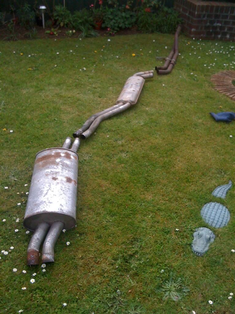

Sprayed the exhaust system up

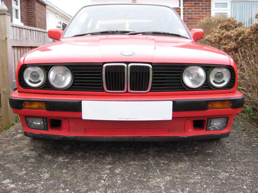

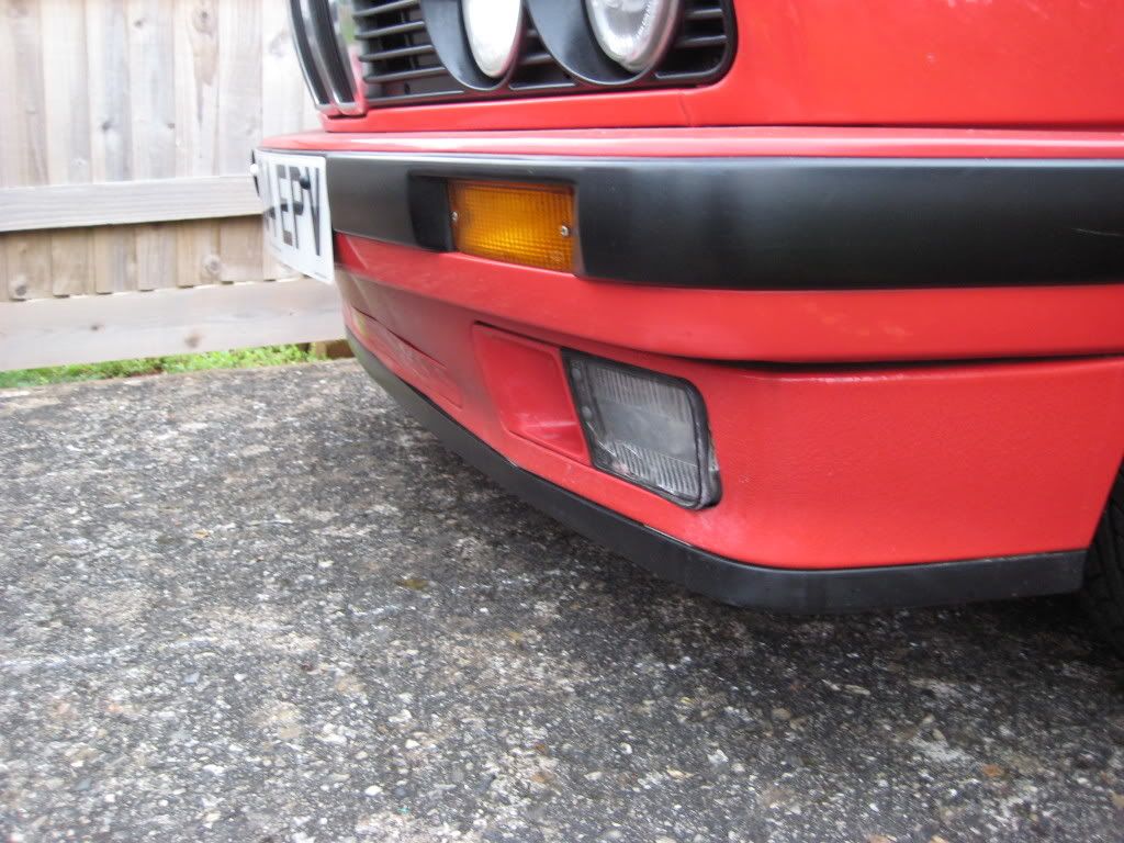

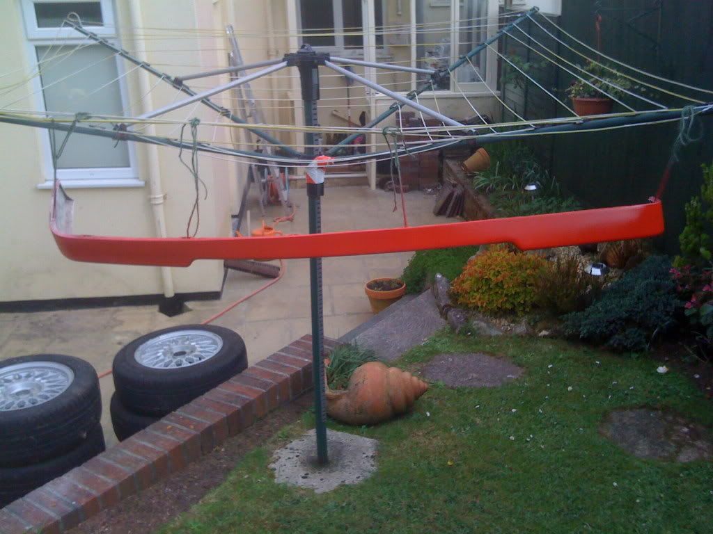

My £7.50 genuine iS front splitter on my rotary open aired paint booth:p (note the 15" bbs's + 1 14" that has been sat there for over a year since i bought the 15"s off eko :o:

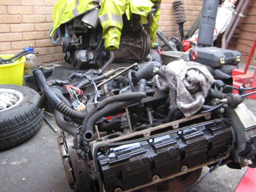

Got a quote of £70 for powdercoating the rocker cover... out came the rattle cans again!

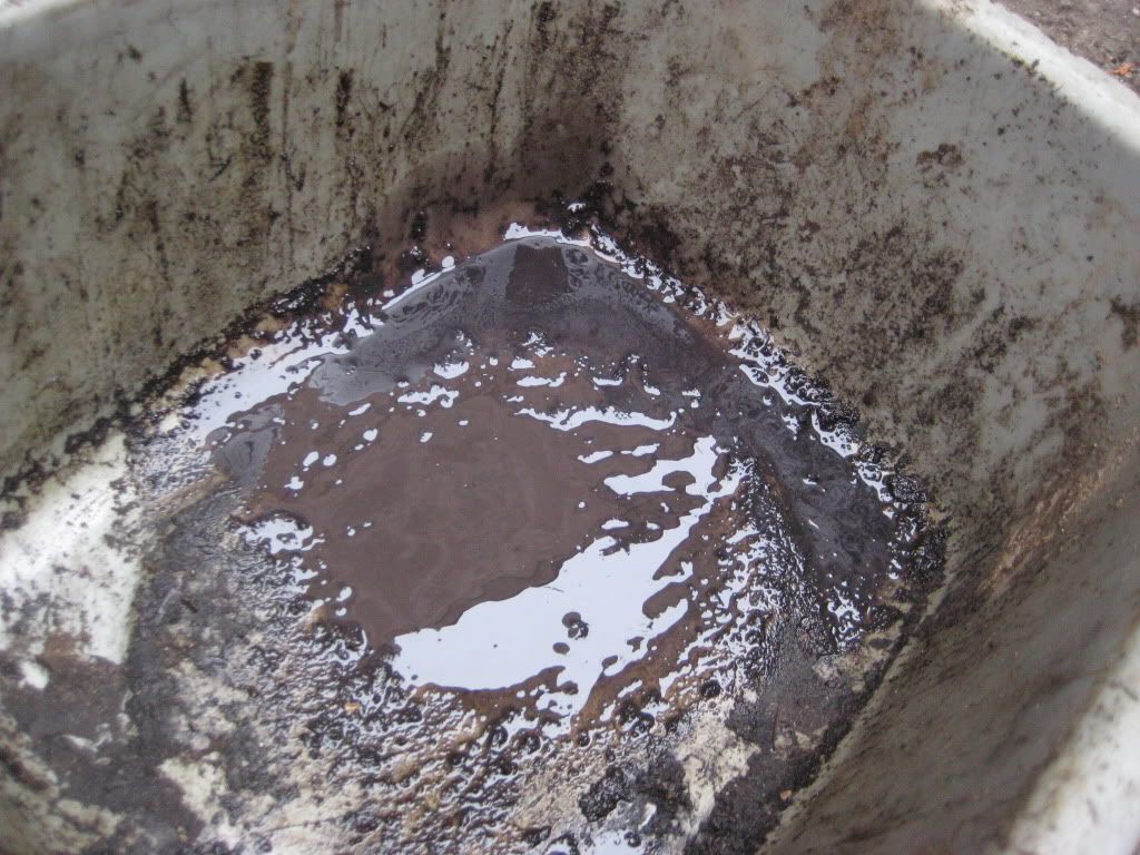

The 316i had a broken power steering rack... this was all the fluid left in the system!

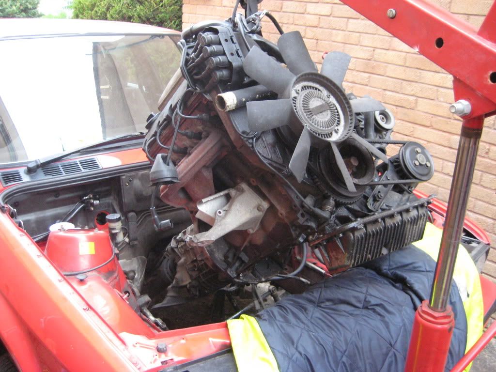

Engine stripped with some bits to flog on :wink:

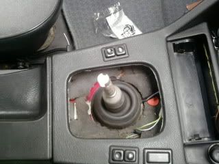

Using the 320i linkage, mount + z3 shortshift:

Gearlever sitting in the middle of the hole,very nice!

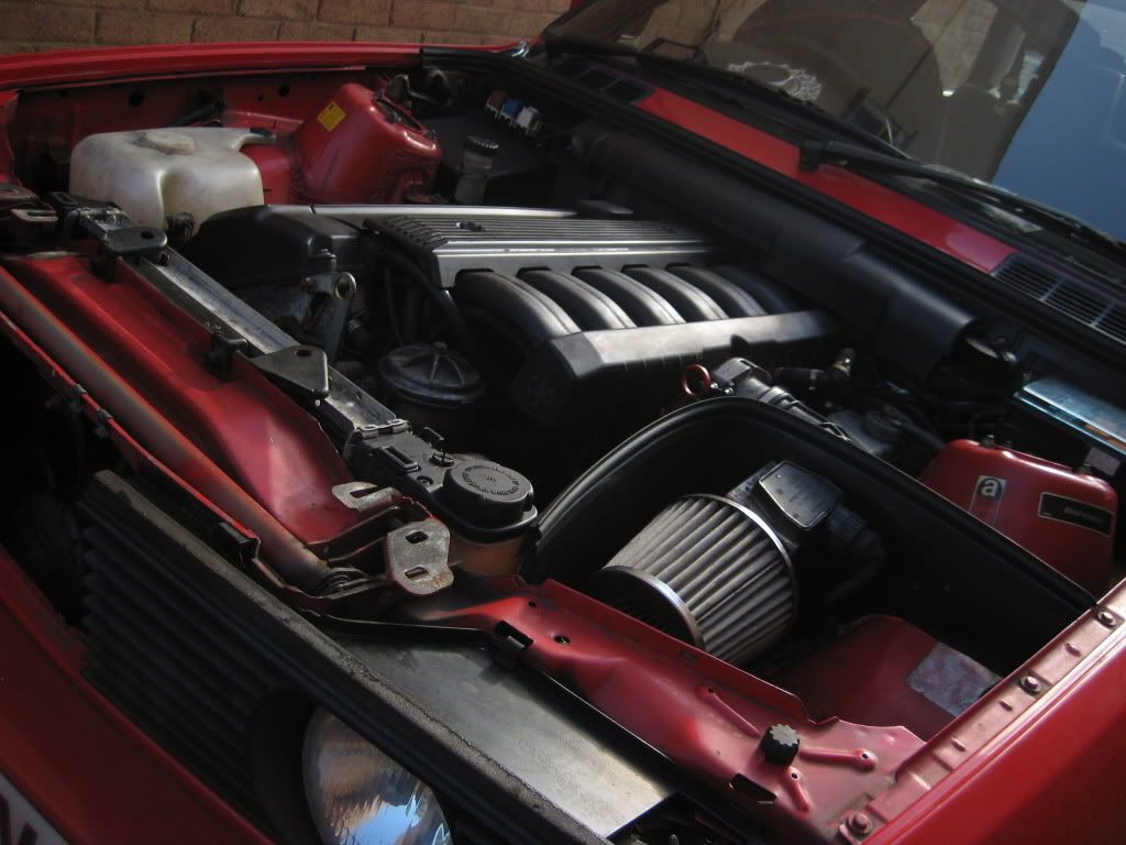

The fan is off a 328i iirc, it only *just* fits! :D The exhaust manifold is the m52 item, benjy and eko are sorting it out as i speak (only popped on to get some part numbers - need some new rear topmounts too :( )

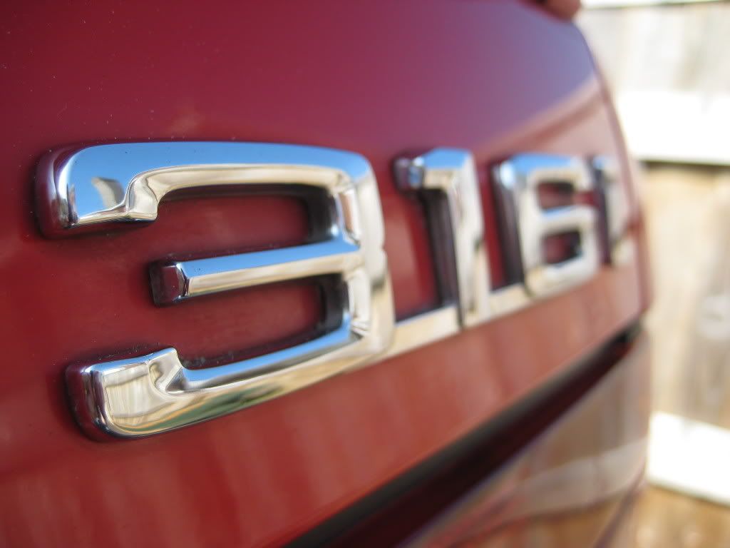

I can't wait to get it on the road, im leaving the 316i badge on too :twisted: I'm tempted to get a sticker made to put next to the 316i badge, either :twisted: or :gay:

Right, another update!

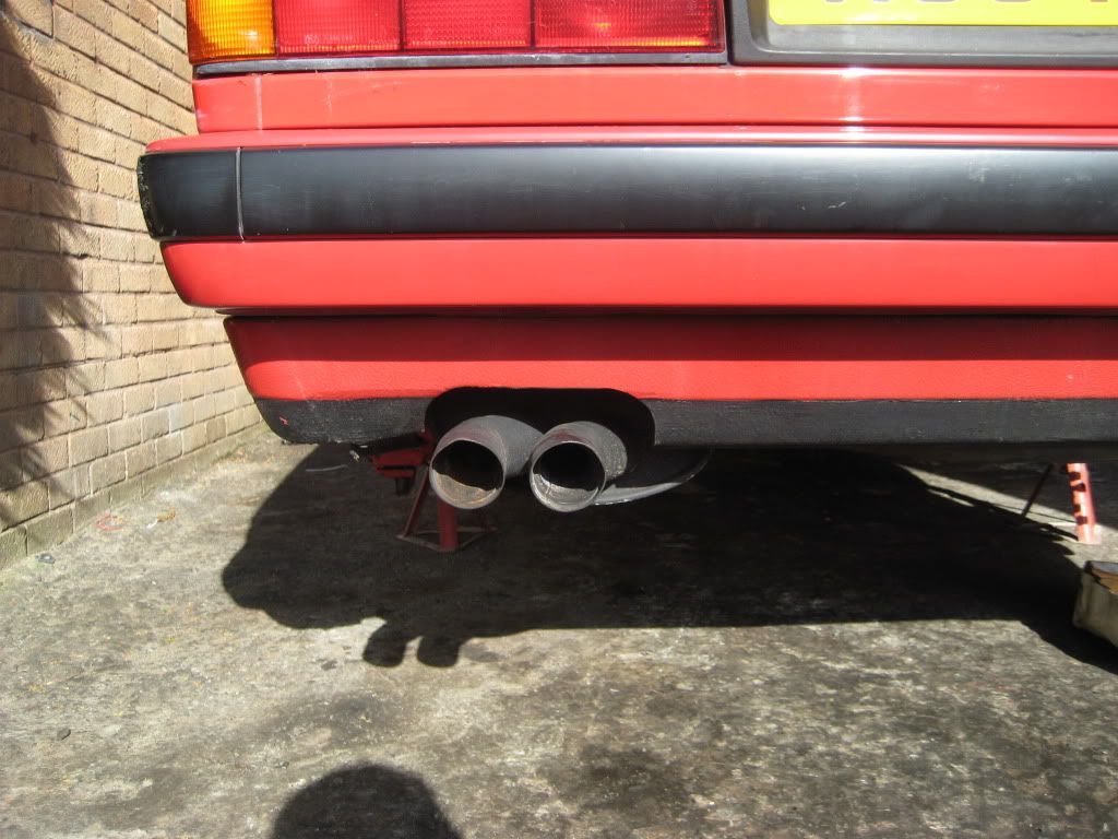

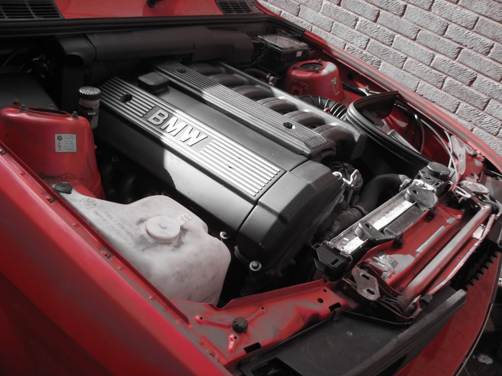

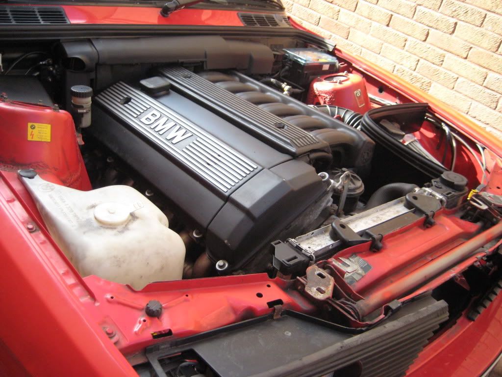

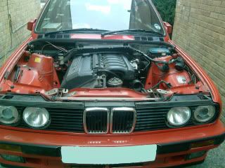

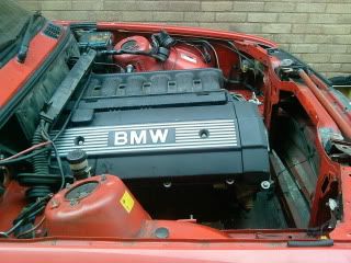

Exhaust system is pretty much done, the engine is all wired in, got the e36 powersteering hoses for the e36 rack, horn wiring has been lengthend becuase you need to relocate the horn, the rear beam and trailing arms are off the car and is part of the way through having the new bushes put in. My 325i shocks arrived yesterday morning too... they're alright, could be better though really but they'll do until i get a lowering kit. Braided flexi brake hoses are on now too! The top mounts were shagged on the shocks so a quick trip up to westerly bmw and i now have a pair of e46 m3 rear top mounts :D The only standard parts really are the prop bearing, prop guibo bush and front topmounts (got my eyes on some adjustable jobbers )

m52 tubular exhaust manifolds to m20b25 3 piece exhaust system,

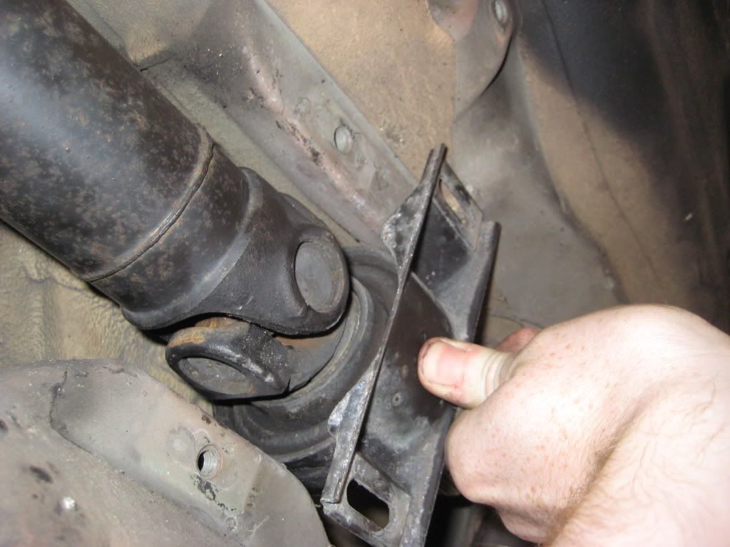

Only a quick update because i've got to nip out again in a minute!
Fail!
The m40 prop doesnt fit :x How did you manage to get yours to fit daimlerman?
Big thanks to Glenn for sorting me out with a new one.
M52 manifolds cut down and rewelded with a bit of paint.

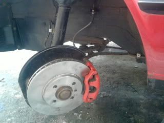

Better picture of the front brakes

Mon Aug 31, 2009 8:44 pm
you need an M20 prop my friend
Cook318IS
Posts: 4587
Location: Torquay
Mon Aug 31, 2009 8:45 pm
E30BeemerLad wrote:you need an M20 prop my friend
Exactly what glenn has sorted me out with. Cheers fella :thumb:

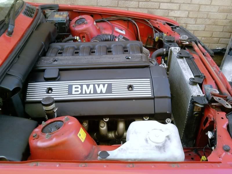

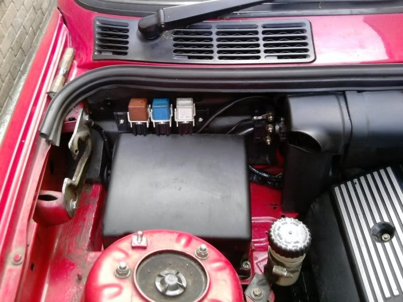

All credit to eko:

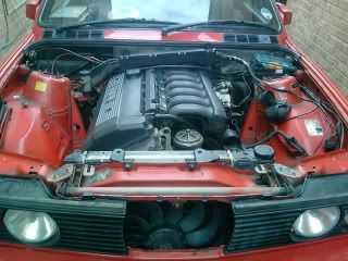

e34 ecu box, chopped down to fit - need an m3 wiring cover to fit over the relays still.
And in eko's words:
Wiring all done under the bonnet and covers fabbed up and fitted.
Oil and filter now done,antifreeze done.PAS pipes are done now which was a dirty mission.Dipstick with new O ring now fitted.
Manifolds are back on awaiting the exhaust.

Lambda needs sorting, fan needs finishing off, exhaust needs connecting, all the fluids will then be rechecked :D

Sounds rough as a dogs arse in the video mate although the exhaust was bloody loud wasnt it 8O
Dropping the coupling off at Chris`s work in the morning,probably get him to weld the Lambda nut on too to be honest.
Fan is almost wired in,just got to finish running the wires through.

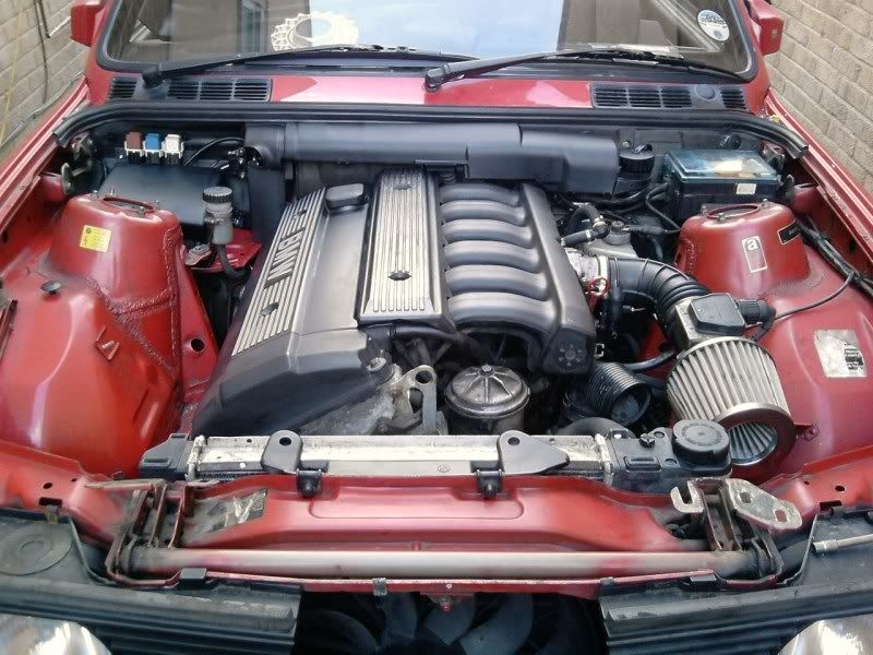

Did you make the heat shield for the cone filter or buy that in?

Made it but dont think the local tax payer would be happy if I said what it was made out of :D

The car is basically finished now :D :D :D Just need a new rear caliper, bleed the brakes and possibly a bit of fiddling with the brake servo. The lambda is in the exhaust, the exhaust is all connected up, the steering joint is all done too. All in all, its only taken about 5 days in total with most of the car now new. Completely rebushed and rear discs conversion too :p
The car sounds fecking awesome now :banana: A mate of mine popped around too to have a ganders and have a listen to it. All he keep saying was how "factory it looks, like its supposed to be there" and "jesus that sounds nice!" :P

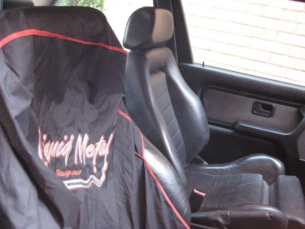

Recaros winkeye
(messing about with the settings of the camera)

Sounds lovely now doesnt it Paul :D
Put the wheels back on after you went and turned the car round(on the handbrake).
All seems well although it does sit like a 4x4,should settle a little over the next couple of days though.
Keep me informed of the caliper progress.
