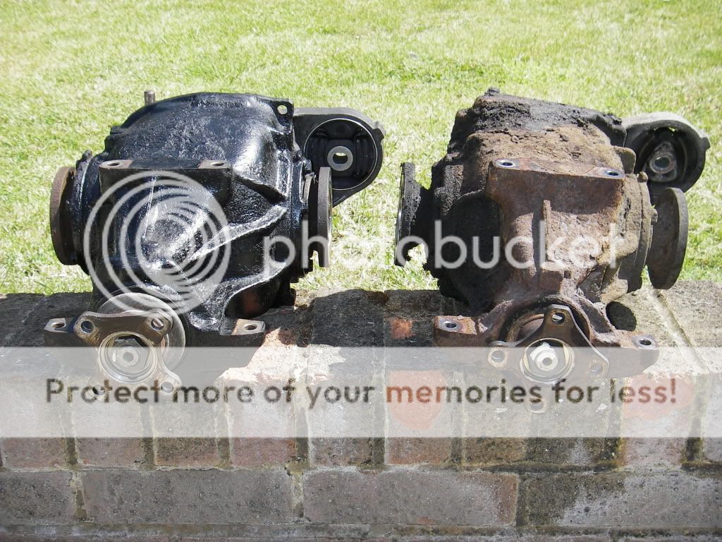

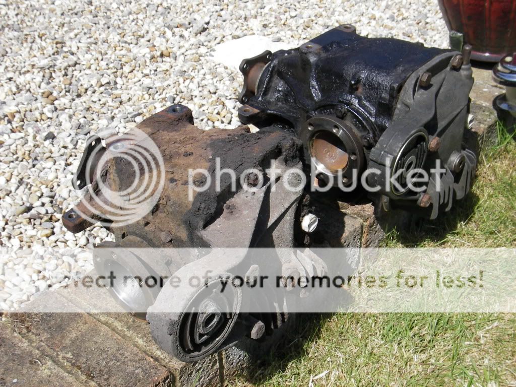

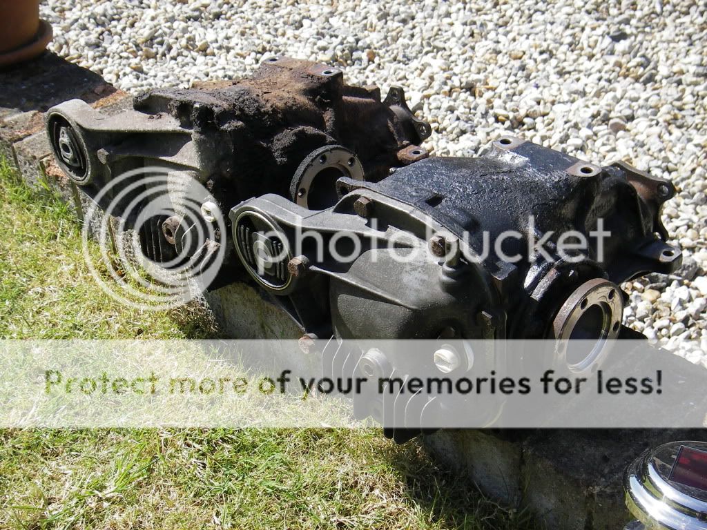

I swapped my small case diff for a medium one over the weekend and took a few photos for comparison. Thought I'd post them up as they might be of use to someone:

Good to see the M Coupe bush used :) LSD I hope? :)
clarko74
Posts: 1581
Mon May 18, 2009 9:30 am
it is indeed, with 40% lockup.
