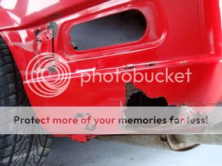

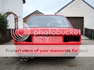

I am Planning a Restore on my 1990 325is - Have had the car since 1999 and have let it down badly - Sitting out in the rain for the past 10 years and off the road for the past few years cos I just couldnt look at it - Its now in my garage and have decided to do most of the bodywork myself as its gone in all the classic spots - how bad - I don't know yet.
I've been inspired by a few of the guys I've seen on here and the skill demonstrated with fabrication and welding. I have never welded in my life but am awaiting a MIG welder from ebay - so should be a steep learning curve.

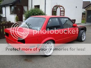

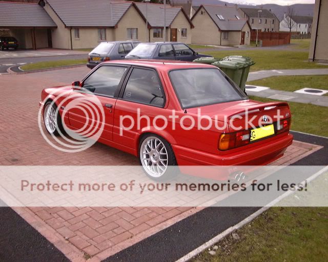

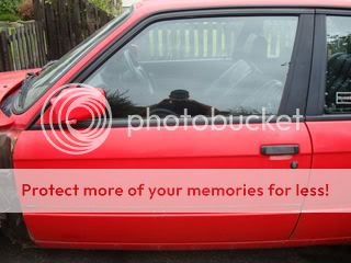

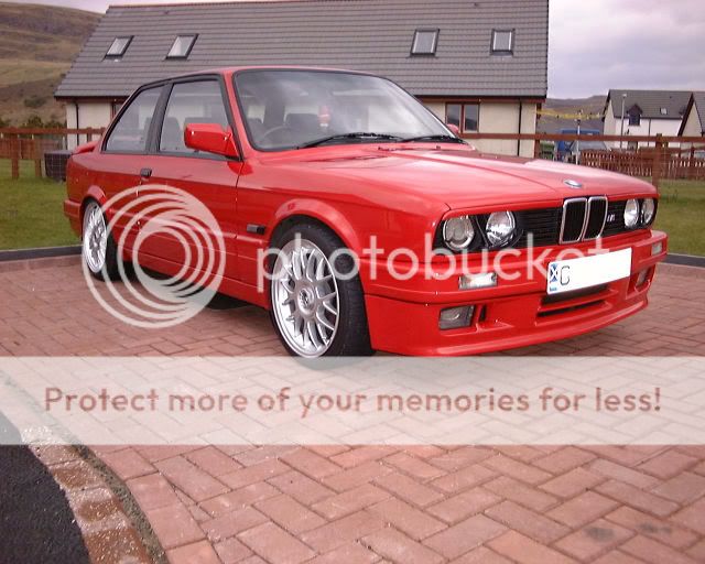

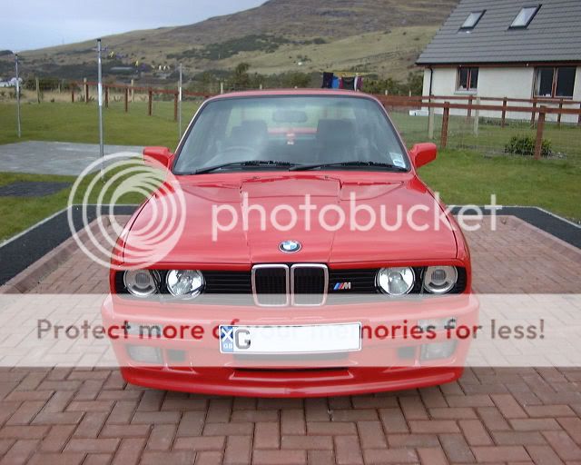

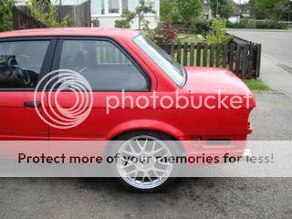

Anyway here are some pics of the car back in 2000

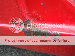

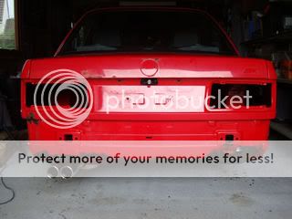

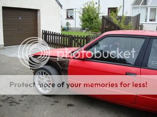

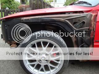

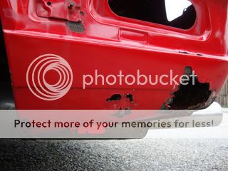

And Here it is now .........Hmmmmm !

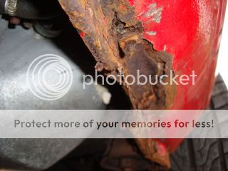

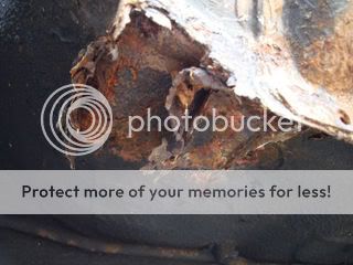

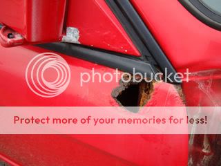

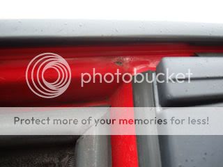

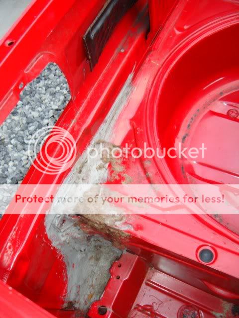

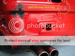

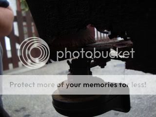

I Don't know what to start with - considering replacing the rear panel - Any advice welcome ??

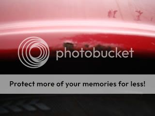

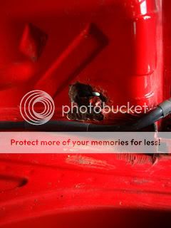

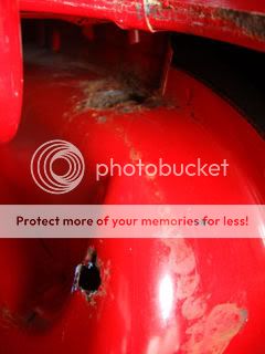

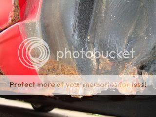

Rear Inner Arches I thing Need Done - Have been rolled back and I'm not sure yet the extent of the rust.

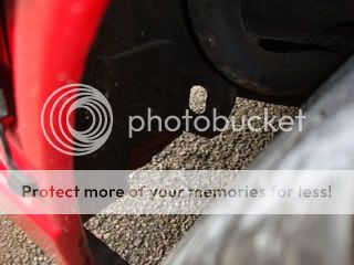

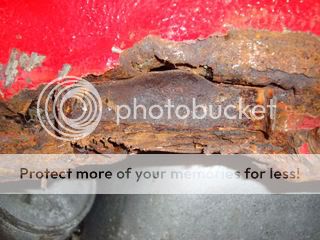

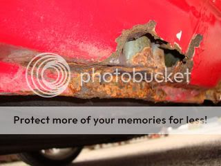

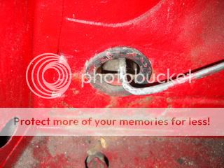

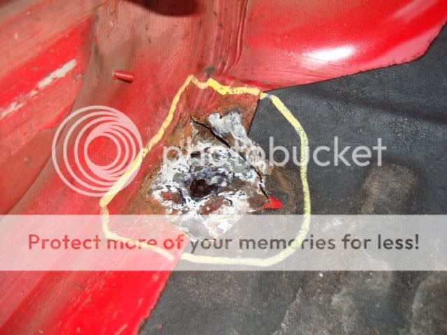

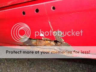

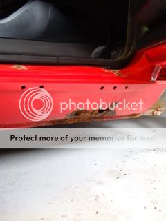

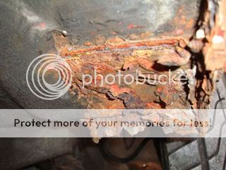

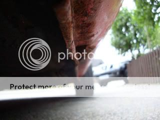

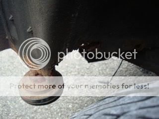

One of my main concerns is the front 2 jacking point - they will need replacing - also they are distorting the top of the sills - see the two pictures above.
I'm going to wait to get the welder and then maybe get started

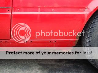

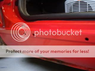

I would strongly recomend you replace those rear quarters, as they will need so much patching otherwise. I would also recomend new outer inner rear arches and rear panel. It is essential that this is done properly though, or they will rust out at the seams in a few years time. All joints between panels must be very well done to last in the long term!
Find some good used doors, they are cheap and its not worth welding rusted ones. Same goes for front wings and valance, either get good used ones or new ones but they cost about 160 per wing and 150? for the front valance. Same goes for the wing mirror - not worth grinding back.

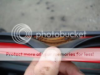

Have you pulled down the headlining on the roof to check the sunroof tray? They can rust in here. Get the dash out and check the bulkhead also.
Great work by the way :) They always look so good with the kit on ay!

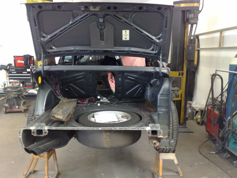

Here are a few pictures of my sport with the rear and front panels off last summer for some inspiration, your car is saveable but its going to be a huge ammount of work!
Best of luck with it.

Holy sh1t...that does have a wee bit of the rusty stuff!! As Paul(bmwe30mtech) says make sure you check the bulk head incase there's some rust up there aswell, this is mine...
Also have you thought of a reshell?? I know It would mean your car wouldn't be a true Sport but it may be cheaper and easier?? Josh Hocking is selling a red two door at the mo not sure if it's worth a look? A bit ironic coming from me considering what I'm doing but just a thought.

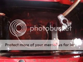

Battery boxes are available from BMW not that expensive I think,
As for the reshell, yeah using a second hand shell, it may not have as much wrong with it needing fixing so therefore an easier solution, but no there's no difference between Sport and non-Sport shells, just when you change shell the chassis number will change and won't be a Sport one, making it not genuine.

I don't think there is going to be much left of your shell by the time you chase the rust right back from the obvious holes.

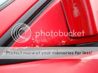

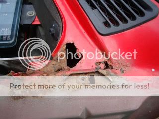

You have your work cut out,ive never seen a rust hole under the wing mirror before!

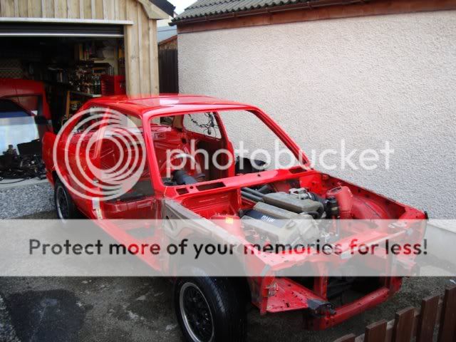

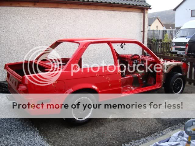

Got a new Shell !!!!!!!!!!!!!!
Thanks Oakey ! - Great guy to deal with and a Bargain.

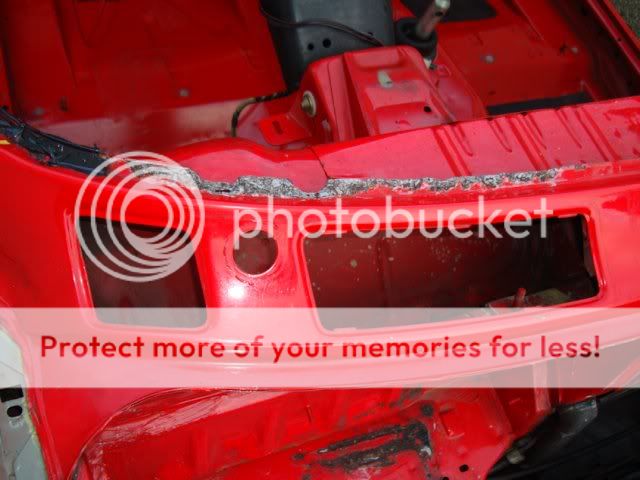

After a 1300 mile round trip NW Scotland >< Surrey Left Tue Morning back wednesday - Hired a car Transporter Trailer.

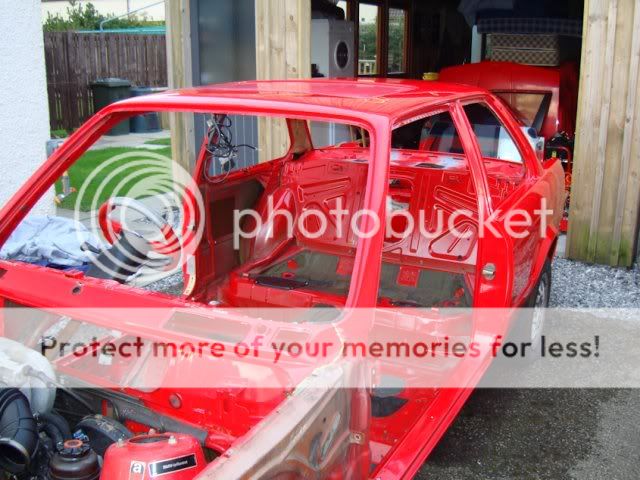

Shell is in much better nik than mine. Started stripping it wednesday.

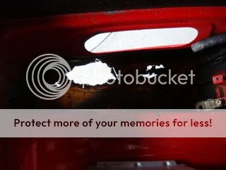

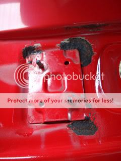

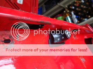

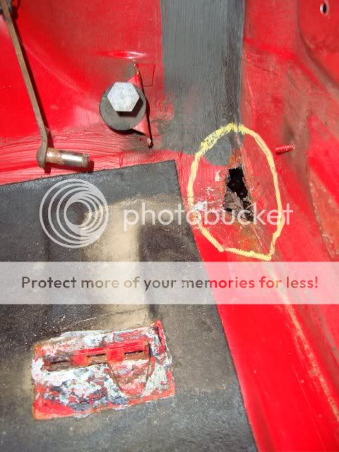

Pretty impressed - Just a few bad bits :
Going to be replacing the scuttle !!

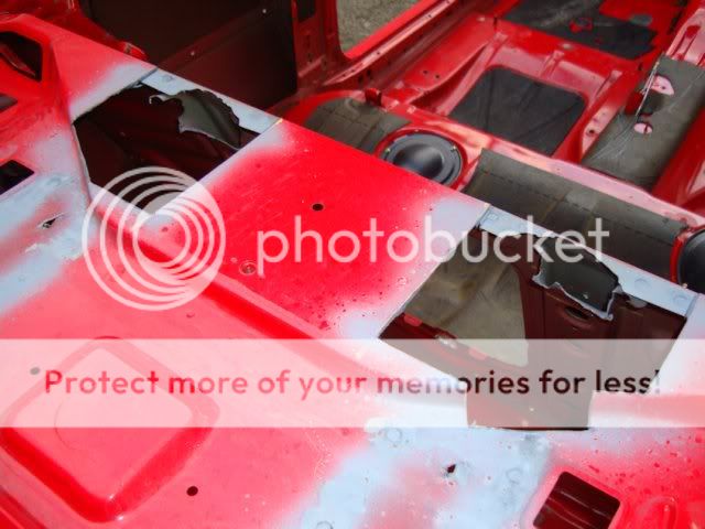

Parcel Shelf panel was cut out for speakers - badly !!! Sorry no before shot - was too quick with the angle grinder - tidied up ready to replace with patches and parts from my own car.

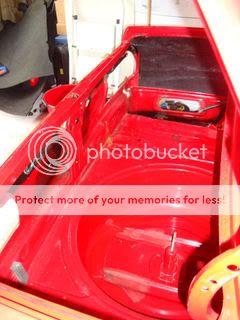

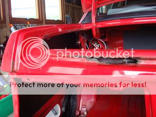

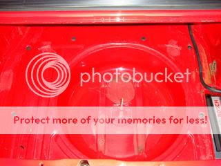

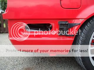

The worst bit is the rear end - was damaged in an accident badly repaired the whole D/S rear is pushed in by about 1/2" and chassis leg has been squashed - Rear panel is completely out of shape - so ordered new rear panel and will cut back chassis leg and part of floor panel and replace with chassis leg and patch floor from the original car, so that new rear panel will actually be in contact with something when I replace it.
I need some serious advice on the removal and refitting of rear panel.

Nice I'm glad you went with the reshell option, as you would have had one hell of a job on your hand other wise :mad: This shell seems much better, just the usuall places of rust, good luck with it, i'm still trying to find a body shop :roll:

Glad you got it back ok! I didn't realise all that crap on the boot floor was part of a repair 8O I thought it was some crap that was spilt in the boot :?
I'm also surprised at how gone the "jacking points are" they looked good at a glance.

Defo think you've chosen the easiest option there mate. I'm on a welding marathon and believe me it does get a bit tedious after a while. Especially if like most of us you don't have a workshop full of metal fabrication stuff.
Keep us up to date with pics, doing a very good job so far :thumb:
