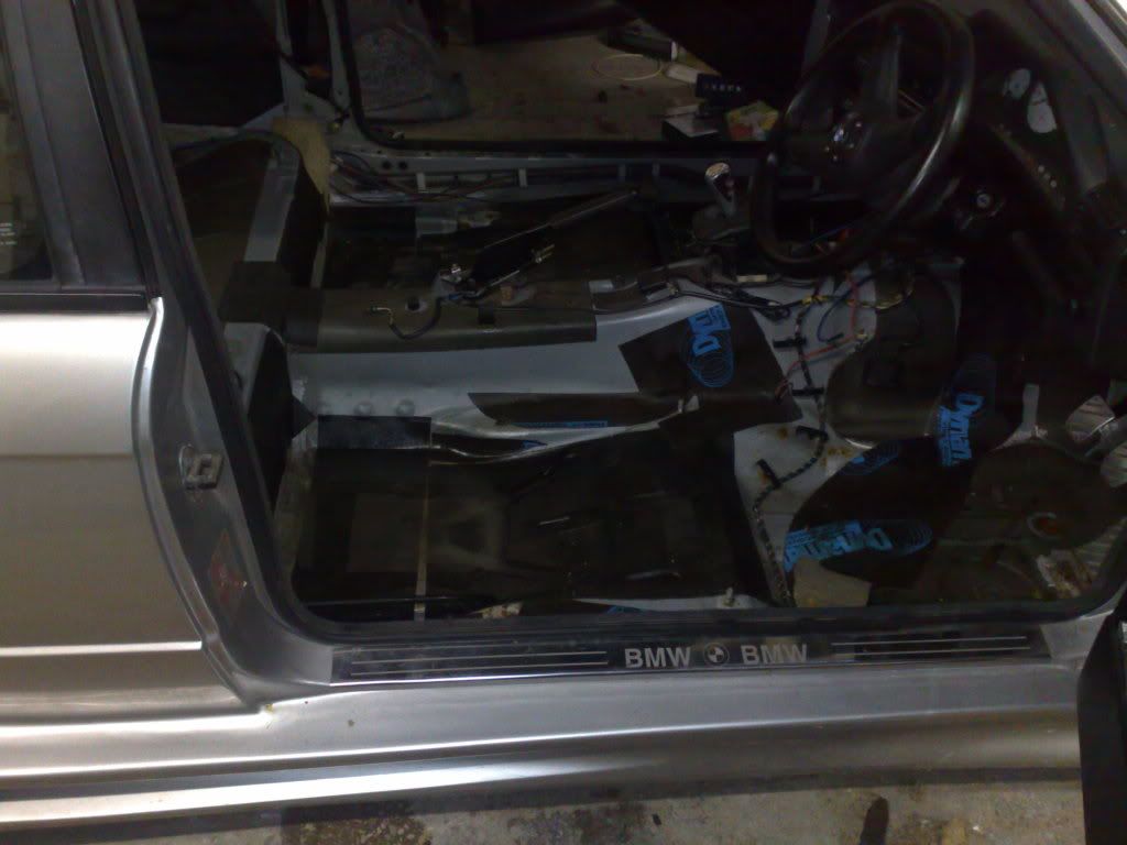

I am lucky to have a barn to carry out some work on the car and pushed it in there last week so that at the very least it would not let any more water in.
I managed to get a day off work today so I decided to get started and try to minimise any damage caused by leaving a large puddle of water in it.

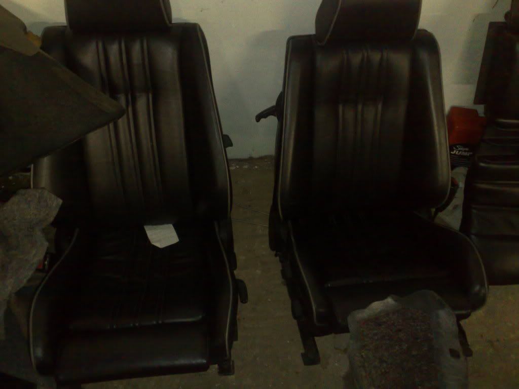

It does have a very nice interior and I'd like to keep it that way....
So out it all came.....

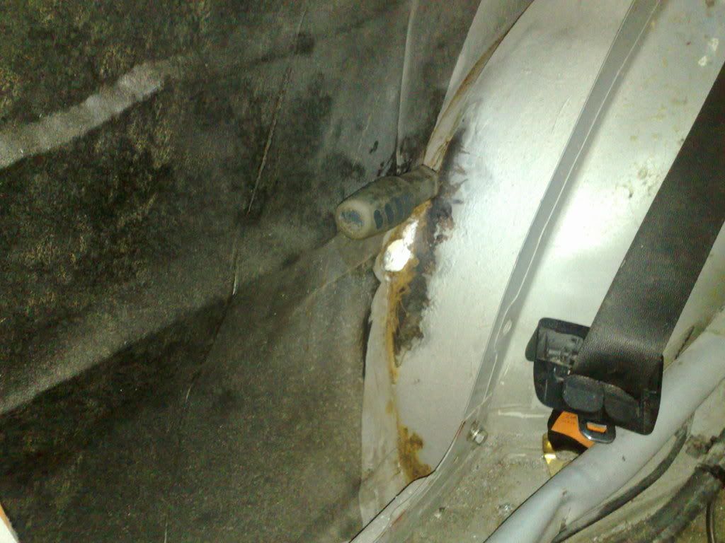

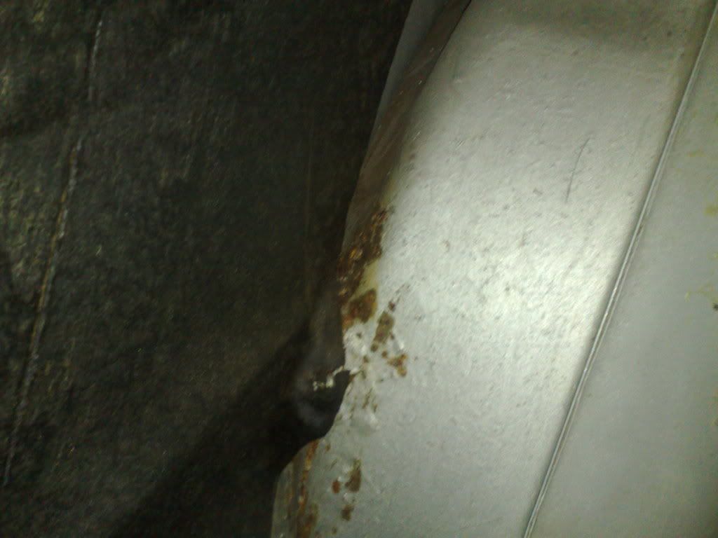

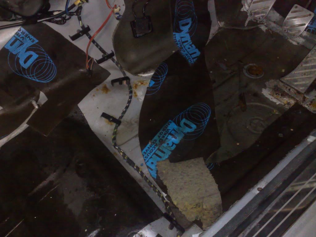

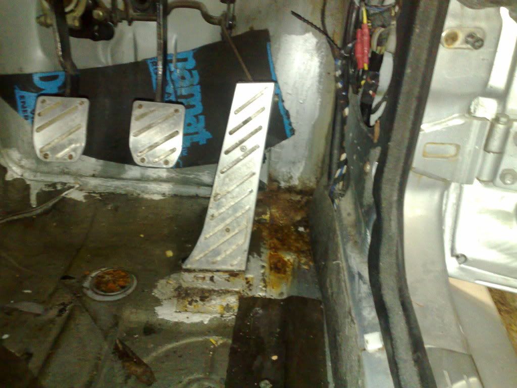

With the interior removed out came the centre consol, and then the carpets. I was expecting to find quite a lot of rust and although I found some, it was not nearly as bad as I thought....
Nearside footwell
Drivers side

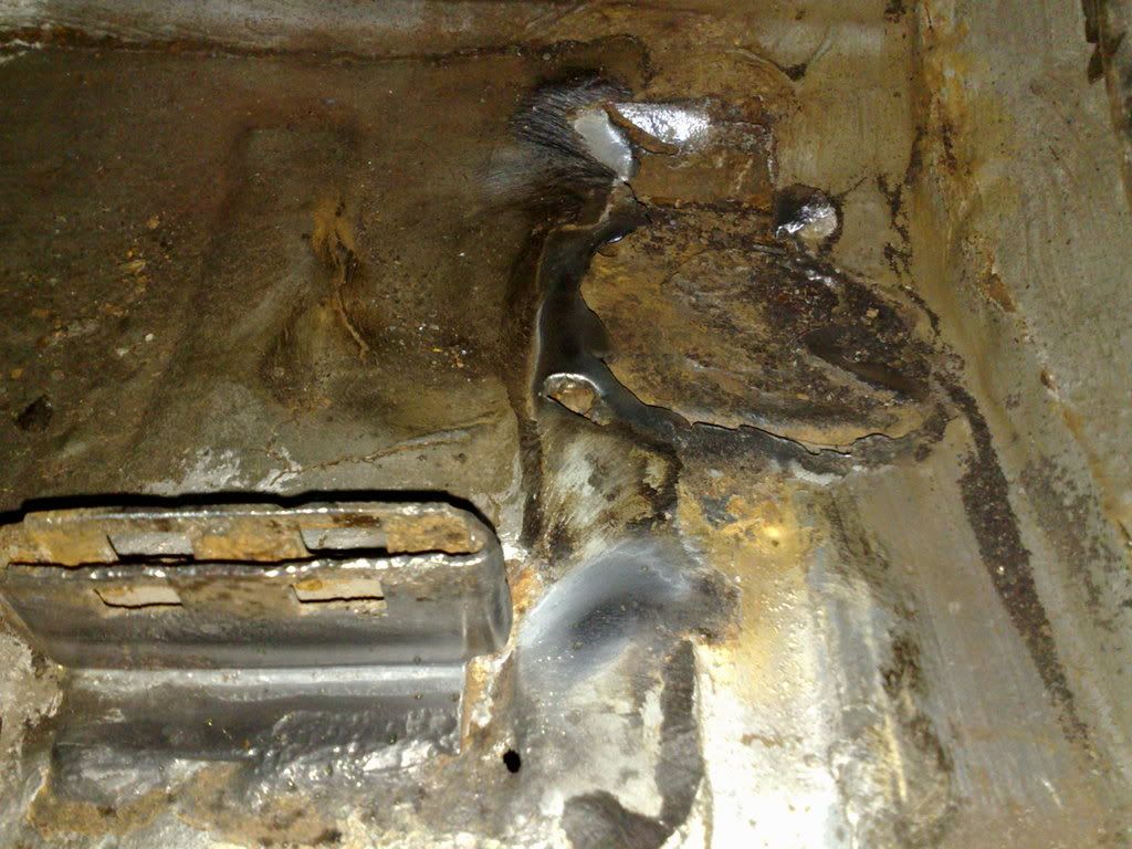

I think the rust next to the accelerator pedal looks worse in the photo than it actually is. Without too much prodding it still feels fairly solid but certainly requires some attention.

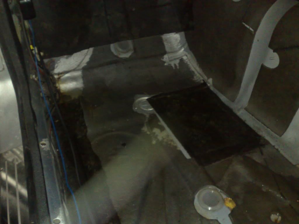

Not sure if you'll be able to see it but there is about a litre of water sitting behind the drivers seat in this picture which has now been removed. I thought it was coming in through the sunroof but after removing the parcel shelf I noticed the corner of the back window was dripping.
My next door neighbour has a caravan repair business and is a dab hand at repairing stuff like this so I'll need to have a chat with him. It looks to me as though water has been coming in through the back window and over the wheel arch because this was the worst bit of rust I discovered...
There is definately a hole here and although I'm no welder I'm guessing that this is going to be a swine to patch because its right on the edge of the wheel arch.

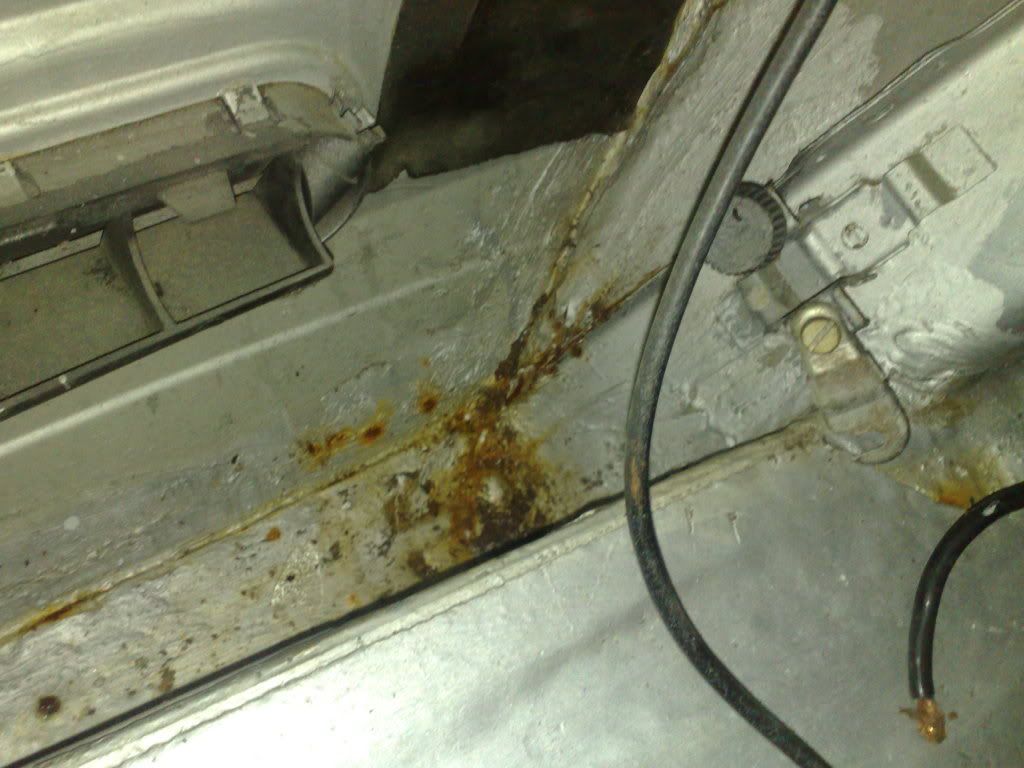

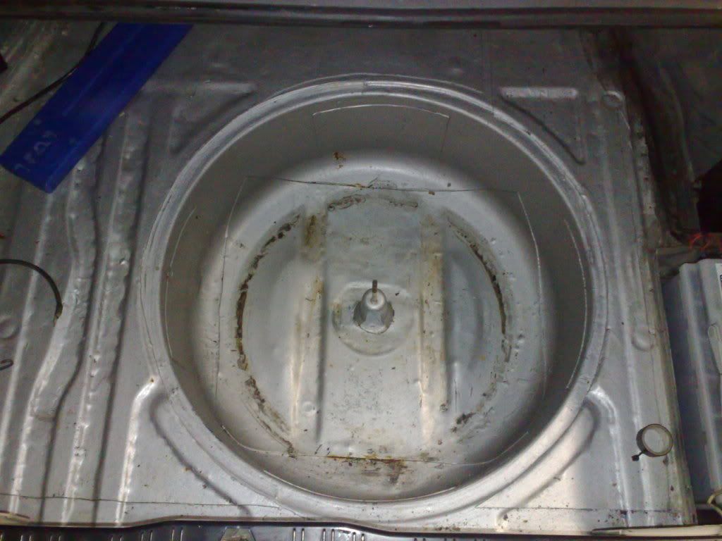

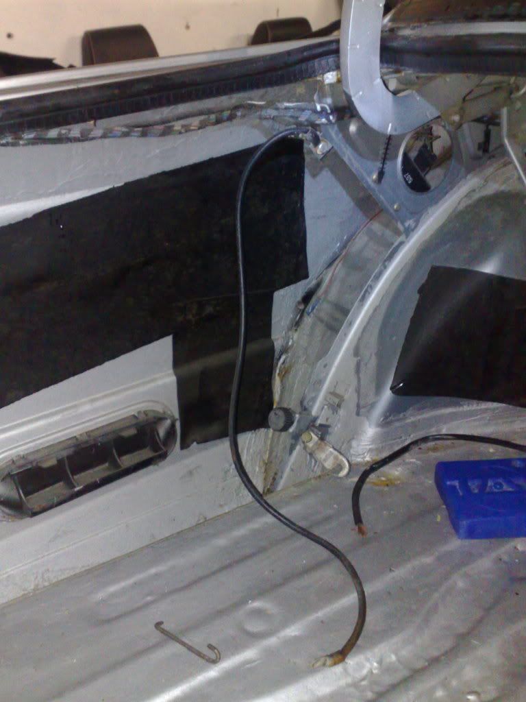

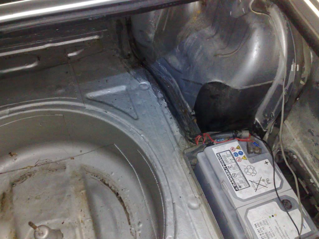

The boot looks pretty good really. There is a little rust in the usual spot in the well where the jack is but I've seen worse

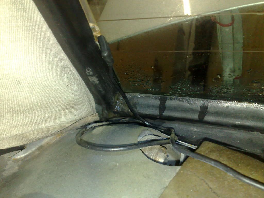

The electric ariel has been removed and the hole sealed up. I found this wire tho and suspect it may be from the ariel but I'm not sure. It looks like an earth wire but it's not connected to anything.

Just been trying to learn a bit more about the areas of rust I have encountered. I believe the spot in the drivers footwell originates from the jacking point. Any tips on fixing it would be appreciated. I'm going to rub the whole area down soon to get a better idea of the extent of the rust.
By the way what is the best way to get the soundproofing off the floor?

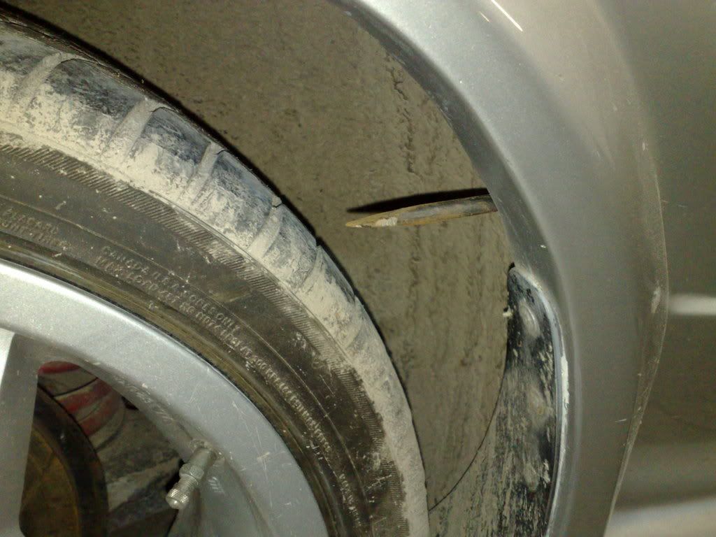

Also has anyone repaired the inside of a rear wheel arch or know if it can be done without removing the outer skin?

Check your sunroof drain tray, pull back the headlining and check for rust up there, it's probably the more likely cause.
I think a heat gun is the best way not too sure though.

A heat gun or blowtorch and a scraper of some sort lifts the soundproofing off the floor no bother.

The wire in the boot looks like it's an old earth wire for an amplifier. My money's on that.

I think that maybe the water got in through the aerial. I was sure that was what had happened on mine as my replacement and my old one had a hose runnign off the motor, which was direclty above the scab in the wheel arch!
Your litre of water in the rear footwell is what I get on mine, but on the passenger side. I dont think its coming from the back window though.

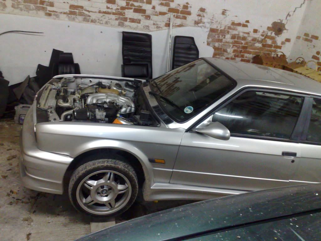

With a whole week of E30 maintenance looming in the near future I decided to tidy the barn a bit. I Manged to clear off an old table perfect for storing the bonnet on. I asked the Mrs for an old sheet to wrap the bonnet in to avoid any scratches etc. She happened to give me an old duvet cover which I slipped over the bonnet before removing it from the car. Worked a treat. Any job I do on the engine now will be so much easier.
I think getting the starting problem sorted is going to be my first point of attack. It would make it so much easier to move about onto stands etc. I'll also be able to move it outside so I can use a hose to determine where it's leaking in water, and then look at how I'll fix that. I have a spare battery which I'm charging tonight. If that doesn't work I'll test the starting circuit and see where the problem is coming from. I fear it may be the actual ignition barrel which has seen better days.
I thought about doing the welding myself, but it's a skill I need to aquire first so instead I will be seeking the services of a local welder.
I had a brief look at the brakes too. I was pleasantly surprised to find that it has been fitted with drilled & grooved disks front and rear which, other than a little surface rust seem to be in near new condition. winkeye The brakes were quite spongy last time it was out but some new pads and fluid could do the trick.

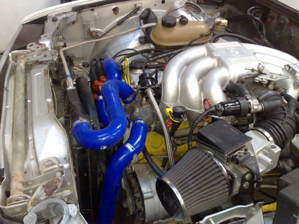

I had a good look at the starter issue today. Now that the bonnet is off, I removed the AFM assembly and was able to get a better look at the starter motor filled with dread thinking I might have to remove it. I've read that it can be a right pain to get the top bolt off as you can't get a spanner or socket on it. This is what I found:
The blue wire which appears in the photo to be joining my yellow block is in fact meant to be connected to the starter solenoid. I popped it back on and problem solved. Don't you just love simple fixes like that?? :D :D

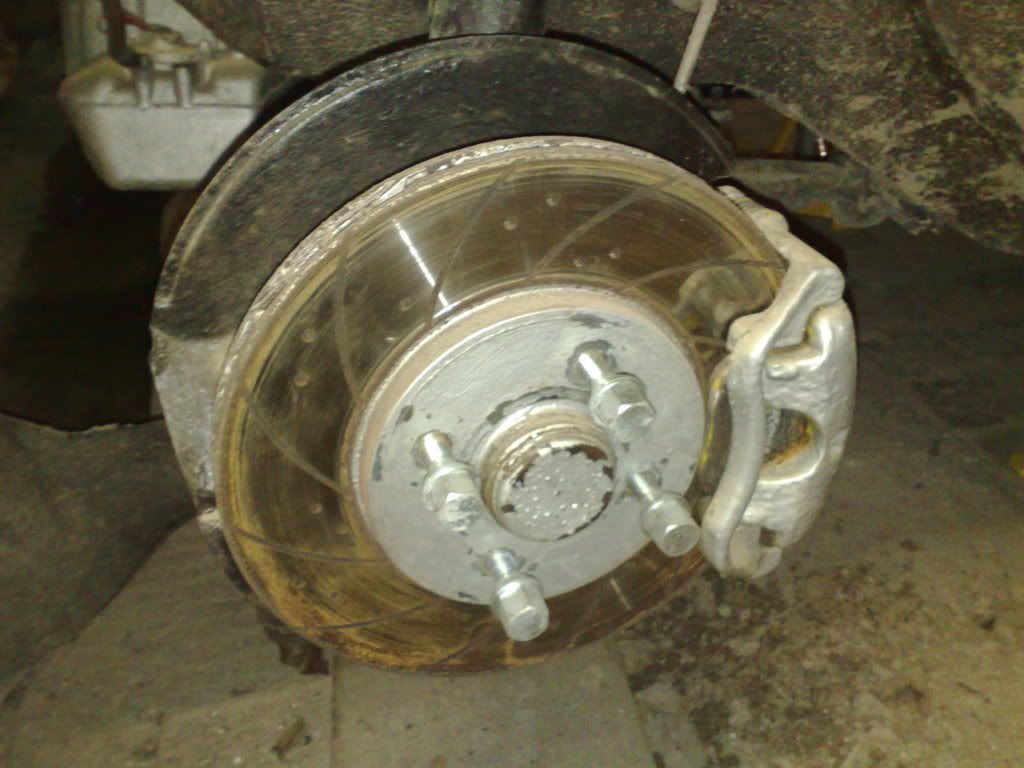

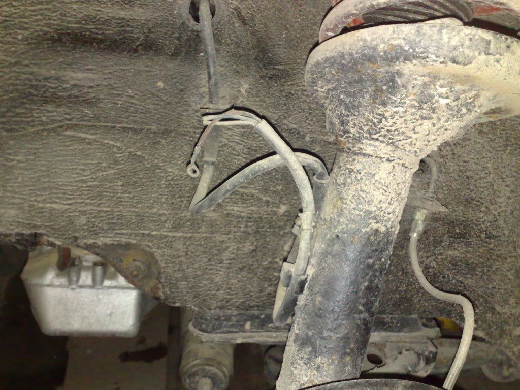

With the car now running again I shifted it about and got it onto axel stands. Not as easy a job as on most cars because of the skirts and how much its dropped. I got the front wheels onto a plank of wood, put a small bottle jack under and then trolley jacked it.
Took one of the wheels off and noticed that the wheel housing trim was missing :( so I spent the next hour or so removing a small mountain of mud from the inside of the wing and the back of the arch.
Had a better look at the brake pads and they look fine too. So I'm just going to put some new fluid in and bleed them. Whilst looking for tools this evening I found a set of brake pads which I bought for my last E30 (also a 1986 325i) but never got around to fitting. - Result! :D

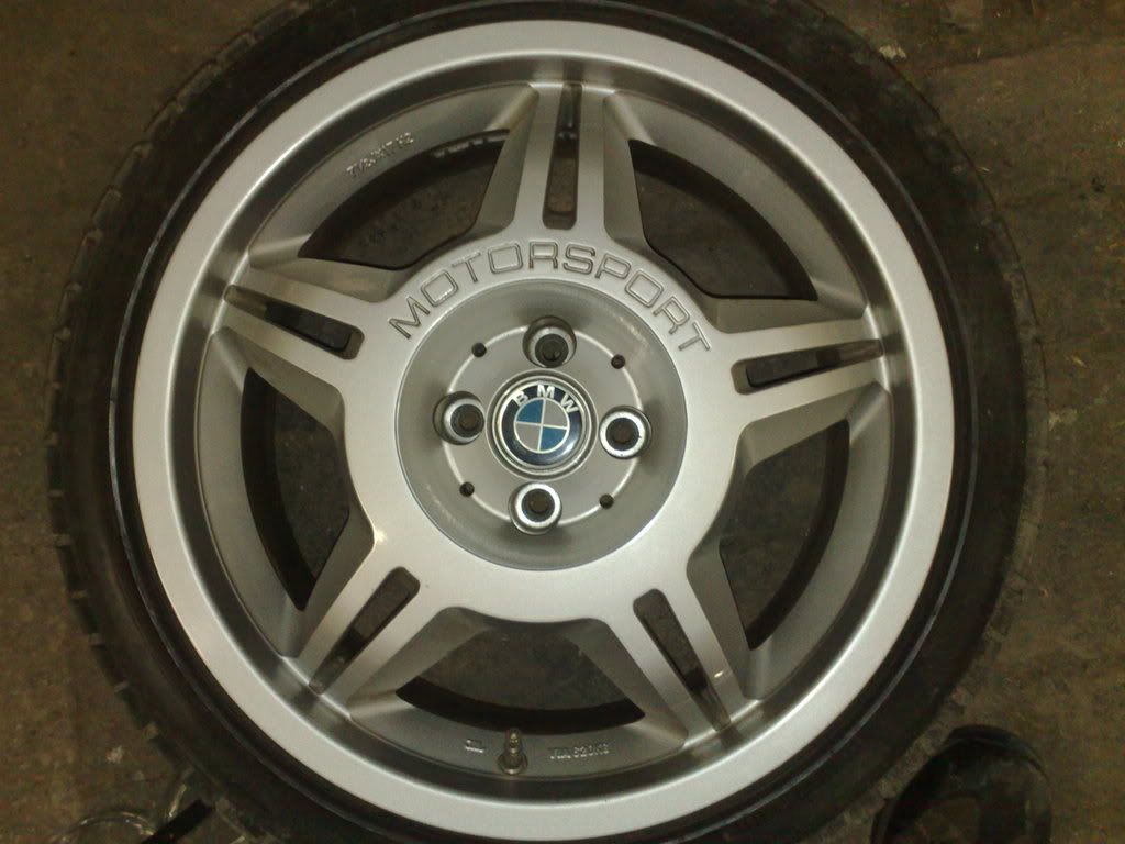

Love 'em or hate 'em there's no denying that these are mintyer than mint motorsports so they will defo be staying on the car.
Pad sensors seem to have been disconnected at some point. Not really too bothered by that.

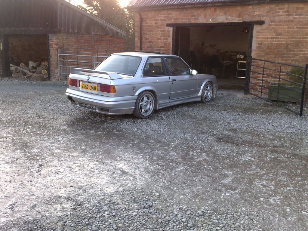

Cheers Bud. Have a look at the photo of the car on stands. If u Look closely at the wall behind it there's a big crack running diagnally down it. If the wall goes its taking the whole building with it! It could all end in tears!! It's not costin me anything but I don't like the idea of leaving it in there for too long!

Hmm, now thats a bit of an interesting issue! that does look rather dodgy to say the least!

I must have picked the coldest week in years to work on my car. Sod's law isn't it? We had some rain the other night which froze and covered almost everywhere round here in a sheet of ice. You can make out what I mean in the picture below. I fell over twice walking to and from the barn. :cry:
Is that the chaviest back end ever or what? rieger bumper AND a DTM exhaust. Lol.
Still undeterred by sub-zero temperatures I soldiered on and made a little progress....
I found a cable had come off the back of the heater controls so now warm air is flowing again to the foot wells. There is still not much air coming out of the vents leading to the windscreen, and the cable is still attached. I haven't got to the bottom of this yet but will have a scan over the various heater issues threads.
Fitted my new Samco hoses. The old ones were quite perished on the ends and had some nasty braiding around them which splintered into the ends of my fingers. Also fitted a new petrol hose from the filter to fuel rail, removing the in-line filter I fitted to monitor petrol entering the fuel rail. That was before I decided to replace the petrol tank, and now I'm happy it's all good.

However, not so good is the hole in the rear wheel arch.
You can see the handle of a screw driver, and yes the shaft has gone right through. Someone has clearly tried to bodge this with some filler in the past.
That's it popping through the other side.
My question is Can this be repaired somehow without removing the rear quarter? I have no welding skills and have never attempted something like this before. As much as I like the Chav, I can't see that it's a car really worth going to this much effort to save. Can some sort of patch be applied from under the wheel arch that would get it through another year or two? The other side seems to be pretty sound.
I fear I already know the answer... :cry:
Oh and another question, would it fail an MOT because of this hole?

i want them motorsport wheels :(

I doubt it would fail the MOT on this as I don't think it's structural. Someone else will have to confirm this though so please dont quote me on it! The hole by the accelerator pedal is pretty similar to the entire floor of my old metro :eek: ! And looks perfectly doable!
The hole with the screwdriver is what usually gives me nightmares, there's pain on the other side of what needs welding. I can't see any way of repairing that without needing the paintwork being removed and repaired. You could (shhhhh!) fiberglass it from the inside (if it's not structural) that way you are guranteed it won't rust again ;)
