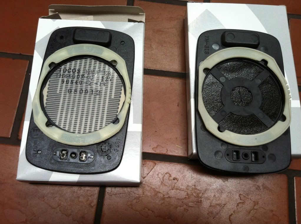

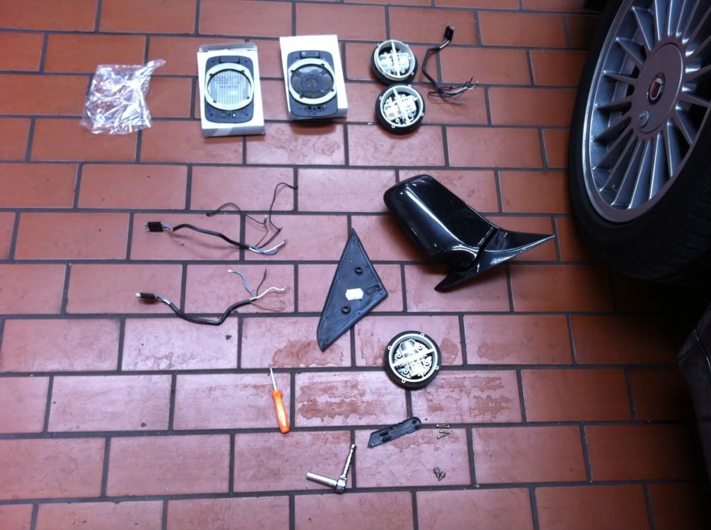

First up was another OEM option or should i say part of it. The Heated mirror, washer jet and drivers door lock pack which would have cost you £86+Vat in '89. The part of the pack i have fitted is the heated mirrors which is a very easy upgrade!
The only parts needed are the mirror glass for each side and the specific wiring loom for each mirror. With some careful soldering and crimping you could modify an original loom as the only difference is two wires as seen in the pic below.
This also means no painting needed as you use your original housings.

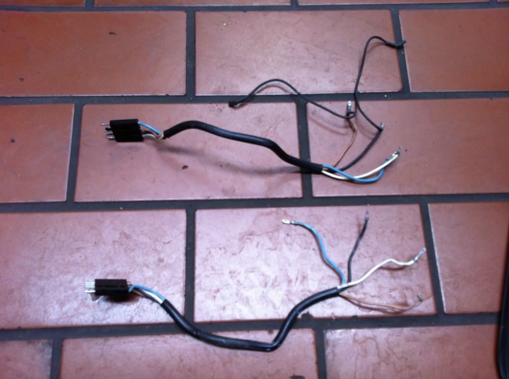

As i had removed a pair of heated mirrors from a breaker, i striped them and removed the looms but unfortunately the heated mirror glass from them were both open circuit so in the bin they went. A new pair were ordered up and for those of you who want to know the difference see the pic below, you can see one has a heated element on the back of the glass.
Here is a pic of the mirror stripped.

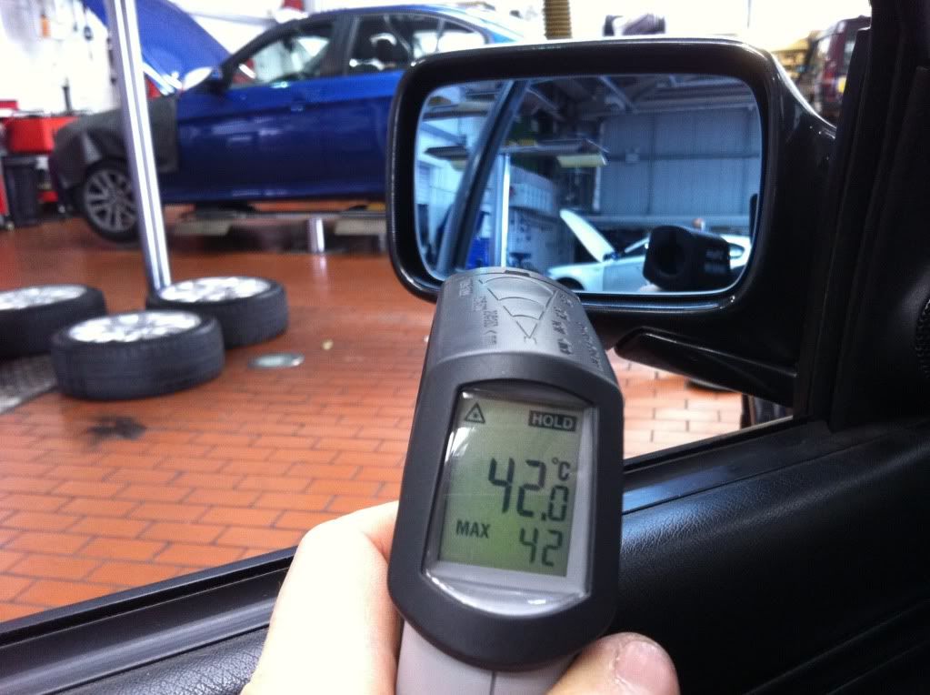

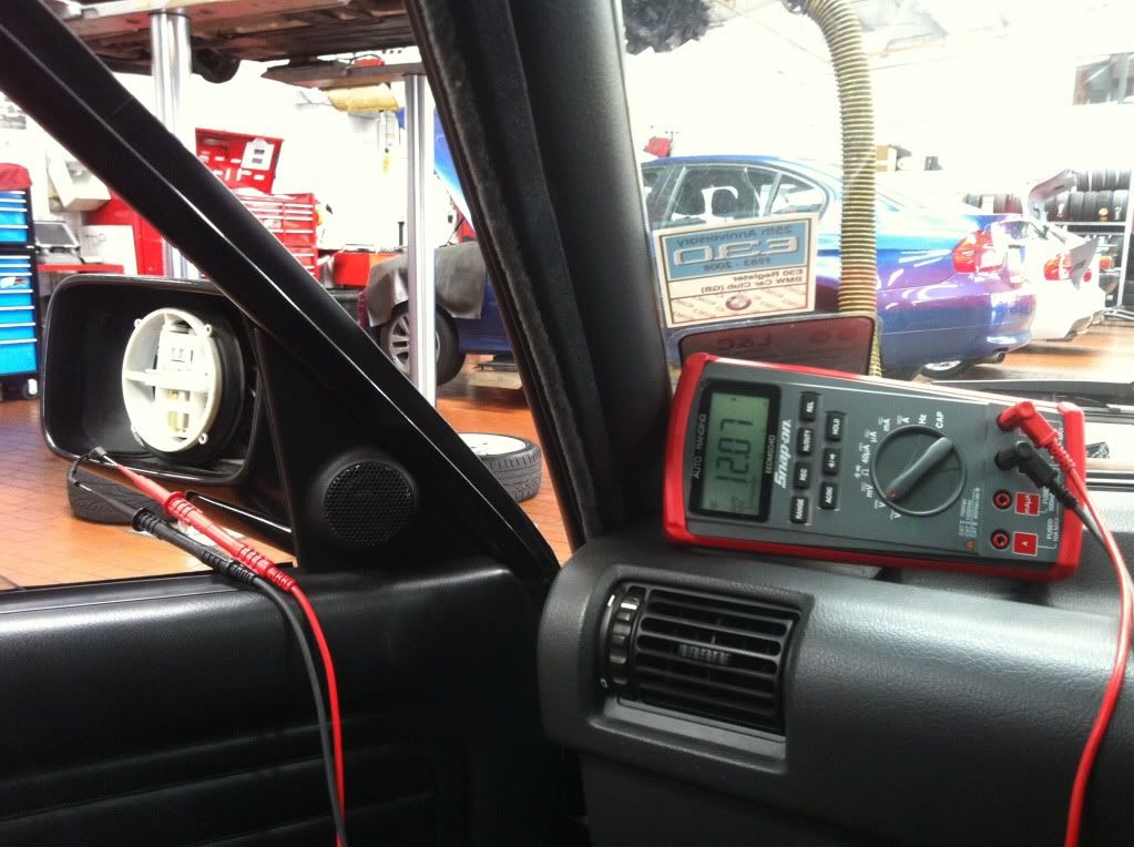

With the mirror housing refitted and wiring plugged in it was time to check power to glass connections. With terminal 15 switched on (Ignition position 2) we have battery voltage present so we were good to fit the glass.
Once fitted, with the terminal 15 on switched on for 5 or so mins with have the temp seen below.

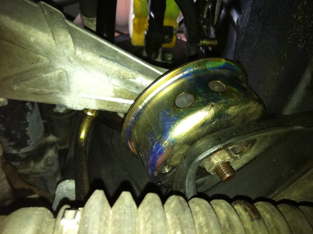

One of the other parts i got round to fitting was a pair of engine mount "Stoppers" which are basically metal cups for the rubber engine mounts to sit in. Now every M20 engined E30 i have had plus various others i have worked on have not had these. I dont know if they are some kind of technical update or what but judging by their design, they limit movement of the rubber.
Here is the nearside one.

those cups came in years ago, i've never bought a genuine set of engine mounts from the dealer that didn't come with them.
nice reflection steve da man,
Wed Jul 06, 2011 10:28 pm
Yes, guessed they would have been a modification early on possibly during production.
I ordered new mounts from the dealer back in 2008 and they didn't come with them, probably because a gave them the part numbers for rubber mounts and the cups have a separate part number.
They do not even say "in conjunction with" on ETK.
