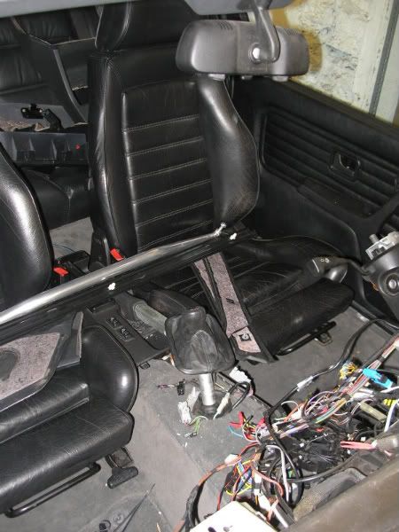

Another update which ties in with the thread about wasted journeys and 325i sports.
An unpleasant but extremely necessary job was carried out today. The much maligned/revered tech 2 body kit had not been off since the car was painted in July '07 and the car had been used on a regular basis up until sept '09 in all weathers so i thought it was high time i removed it to take a look, clean and re wax oil the relevant areas prone to rust.
Last winter/spring i had already removed all of the interior and boot trim so areas like the sills and boot wells, inner arches were wax oiled then and also around this time i replaced the front valence for an Air con type in preparation for the Air con retro fit. During this time the front end of the car was in bits so all this area was cleaned and waxoiled so this just left the the rear of the car to do.
Rear bumper and all side panels of the tech 2 kit removed.
As you can see, the beather pipe cover thingy is covered with surface rust and looks skanky but over all, relatively clean in the arch with no thick lumps of mud like most cars.
So with the vent pipe cover, splash shield and fuel vent tank removed it is was time to get wet and dirty! Jet wash to begin with then a nail brush and hose with some TFR to scrub inside both rear arches and along the sills.
Then afterwards back on the ramp. On the return lip of the wheel arch is were wet mud builds up and sits which in turn seeps into the seam and then rots the arch from the inside out. Even after a thorough clean out as described above, there was still a layer or mud right in the crease of the arch so i set to with the nail brush, a tooth brush and some brake cleaner to get the remaining mud out as its pointless applying waxoil here unless it is spotless as spreading waxoil over the mud will just lock it in and defeat the object of preserving your arches!
And the result of all the scrubbing was this, spotless beige factory underseal!
This is where the vent tank sits and on a lot of E30's have holes here, some big enough to fit you fist through!
Nice wheel arches!
Behold! An end of sill/wheel arch thats still there! Note the slight bubbling of paint here.
New vent pipe cover, vent tank and splash shield cleaned and back together.
The whole of both arch lip returns were waxoiled after they were spotless.
So, after a thorough inspection and clean up, no rusty surprises to be found thankfully but there are a few bubbles in the bottom of the arch lip as shown so a job to be done soon is to rub down the whole arch lip, rust treat then blow some localised paint in.
One thing this has made me want to do even more now is to do the whole underside of the car peado style as in remove everything, powder coat, paint, passivate where necessary along with all new fittings as this is now what is letting the car down and all other areas up to scratch.
Back together and on the deck.
Tune in nxt time for some Old Skool audio action!
