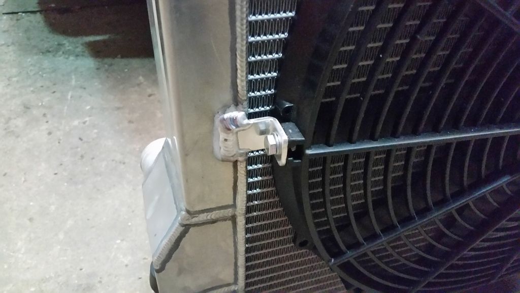

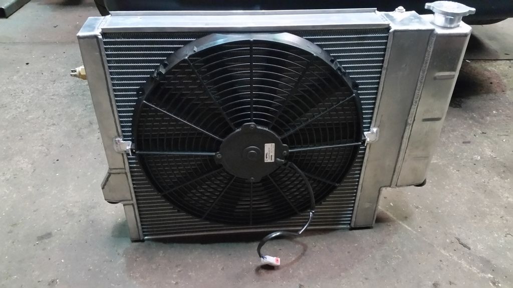

The direnza 55mm core alloy radiators are currently out of stock with most places.

P_VIDDY wrote:The direnza 55mm core alloy radiators are currently out of stock with most places.
Looks like dan has done a great job on the engine 8)
That's what I tried to get hold of but no luck and no word on delivery dates. I used Pro Alloy in the past but they're mega bucks. The other option is for Dan to get one built.

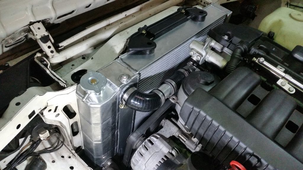

Posts: 28646
Thu Sep 03, 2015 1:37 pm
Yep, and the only reason it has a 34mm core is they are cheap and readily available!
Might end up welding two 32mm cores together at the moment as even a 50mm core is proving hard to locate in the needed size..

Radiator porn.....Dan is a legend!

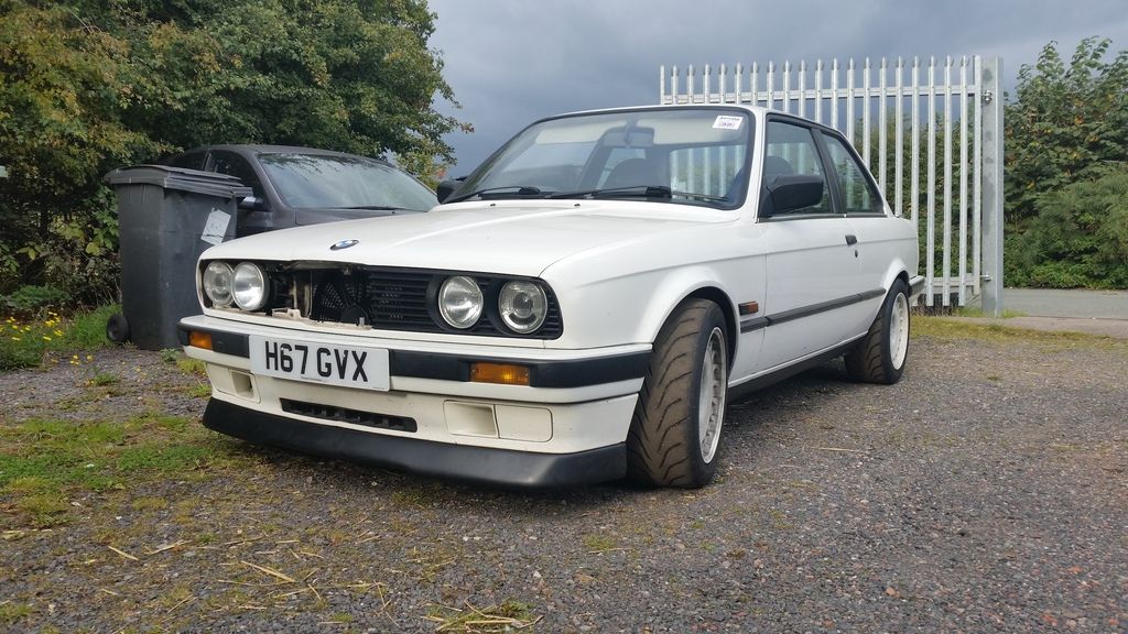

Muzz2676
Posts: 353
Joined: Wed Dec 24, 2014 11:00 pm
Sat Oct 24, 2015 11:44 am
Picture from a few weeks ago, still needs white wing mirrors and SE Skirts adding
