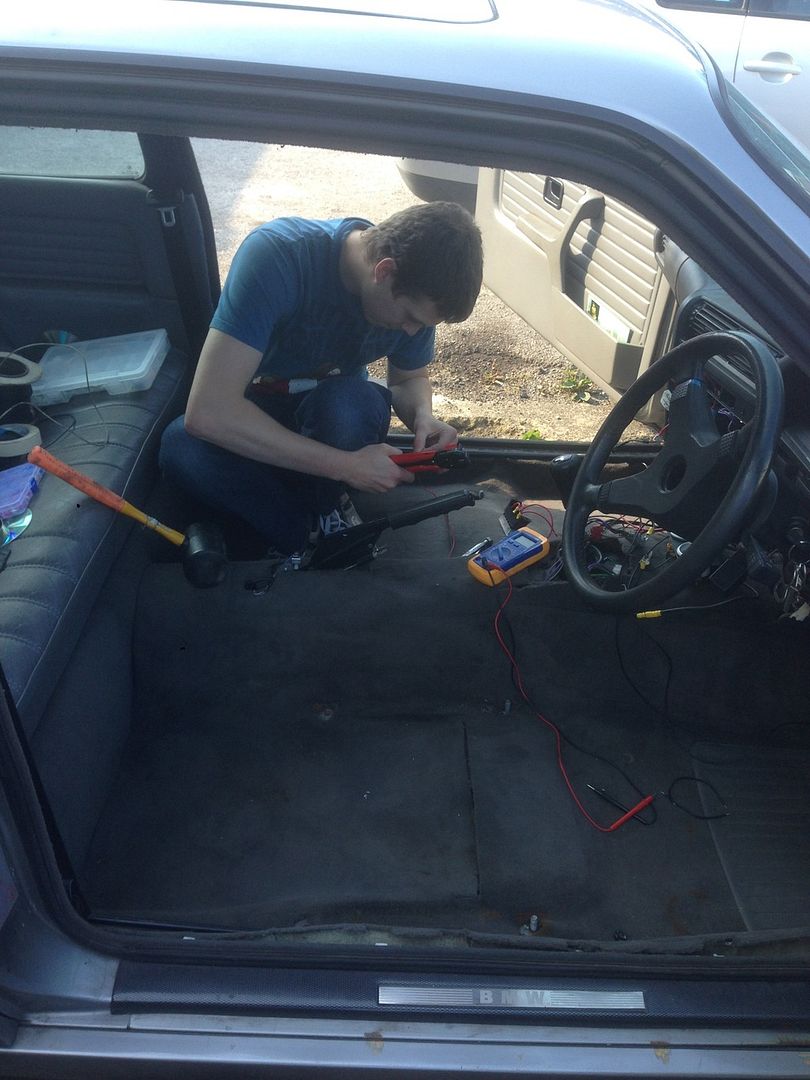

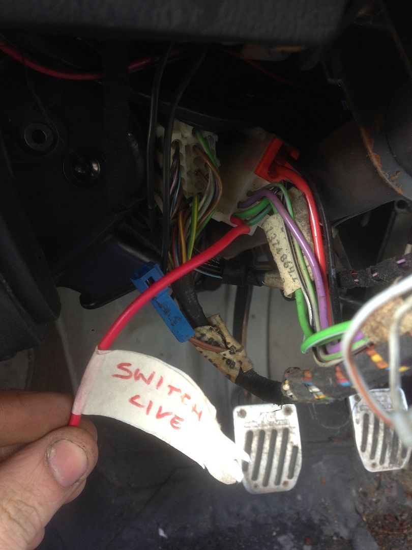

Did some more wiring for gauges and the Megasquirt
Finding a switch live was a ballache but a few mins with a multimeter found one on the ignition barrel, follow it back and "T" into that (it's a solid green wire coming from barrel of anyone else needs one"
Also did the lives and earths for the that voltmeter gauge and USB port I got

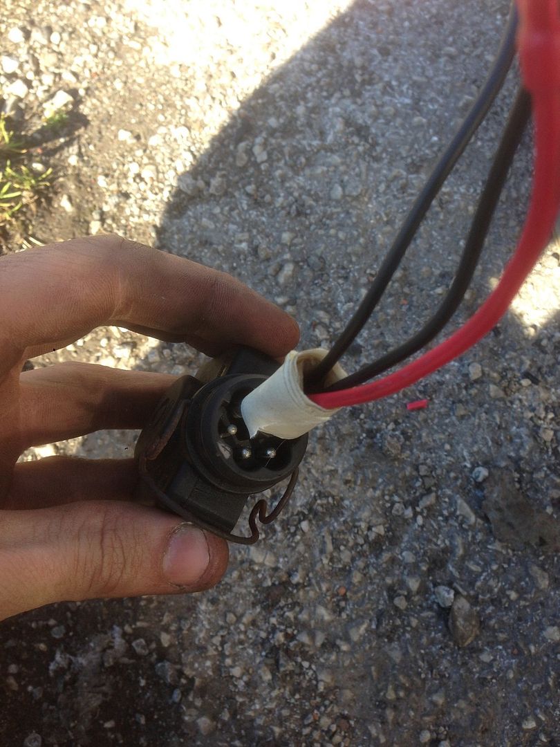

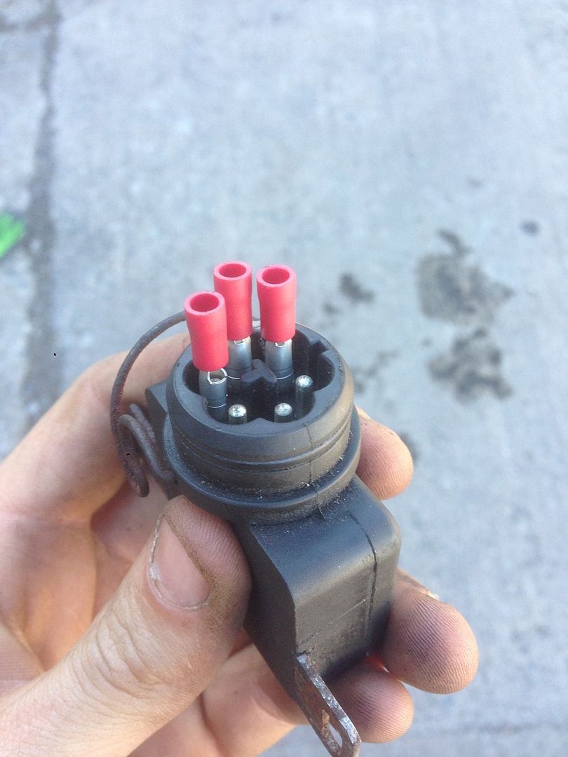

Onto the MS wiring, I didn't have a plug for the m20 auto tps socichad to get creative

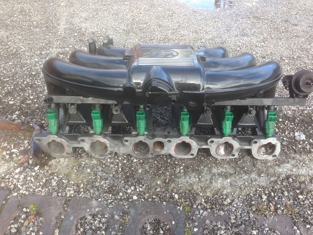

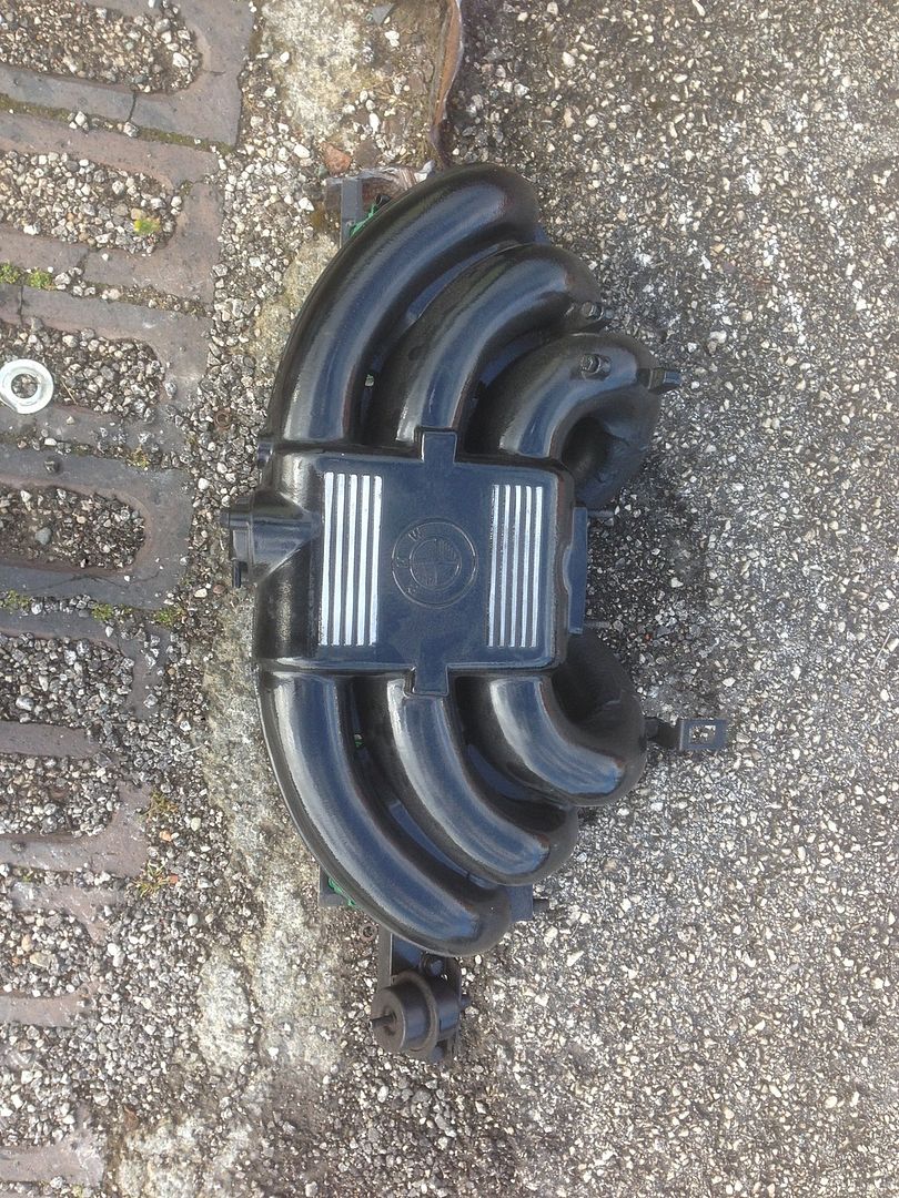

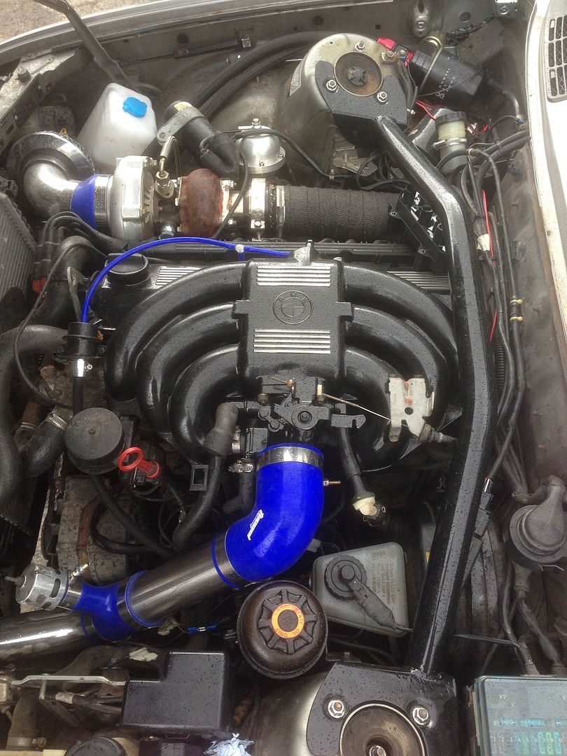

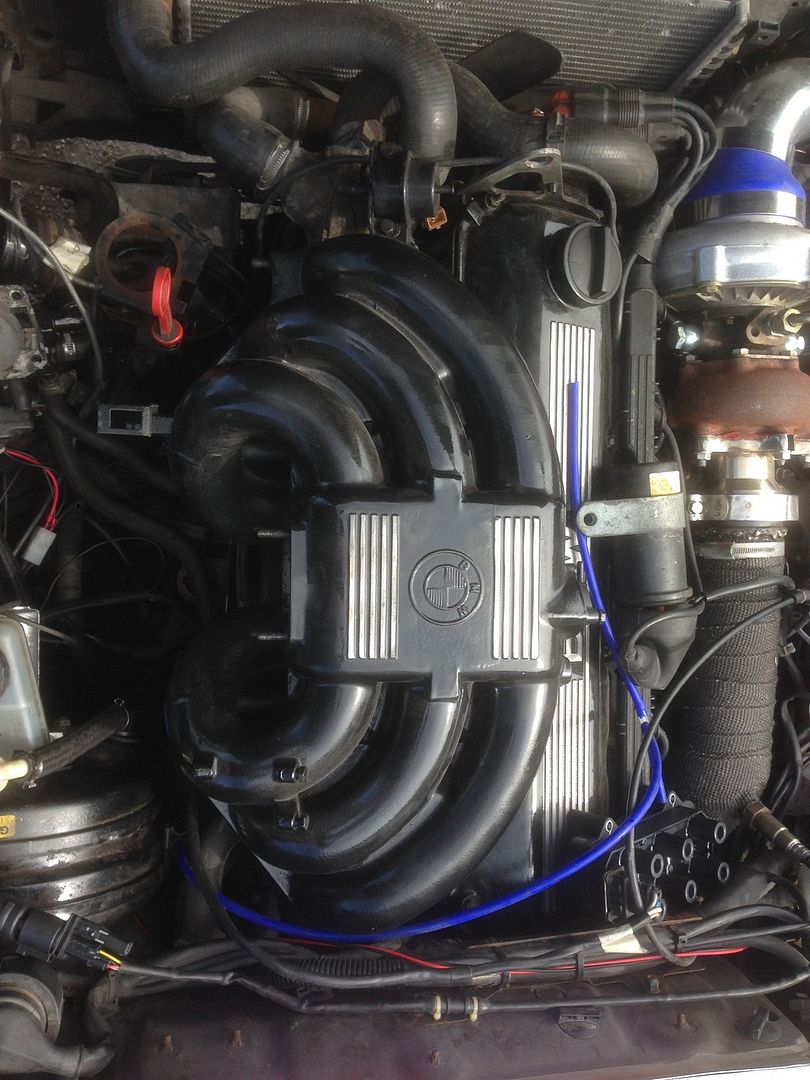

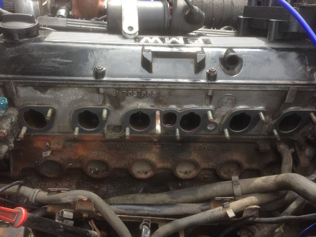

Thought I'd also change the inlet mani over for the black one I painted a while ago and put the new 440cc injectors in

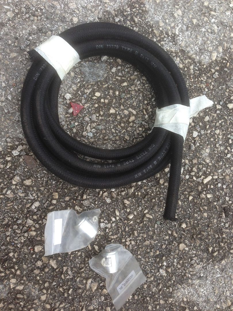

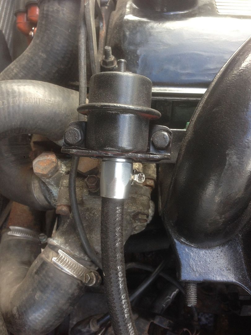

Also changed the two fuel pipes for braided items (heard of a local e30 that the fuel peed rubber pipe burst and set the front end on fire)
All done
Just need to finish a few touched of wiring in the glovebox and then the carpet can go back in (again) after being cleaned, my mate has given me a map he was using on his m20 turbo so I'm going to load that up and see how she handles Untill I can get it down to the mapper for a custom map to be sorted

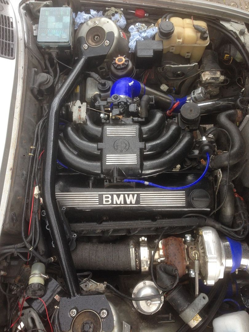

Long overdue update but yesterday was the day of days for me
Finally got it running on the Megasquirt and its running boost too a˜„ I'm beyond happy

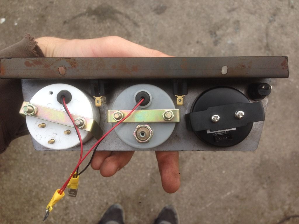

I think my oil pressure gauge is a bit faulty
When it's not powered it reads just under 20psi
Then I attach a live and earth to the + and - terminals and it instantly jumps to max (over 100psi) the signal wire from the sender doesn't change this reading at all

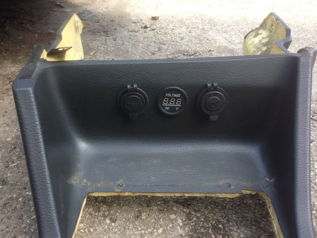

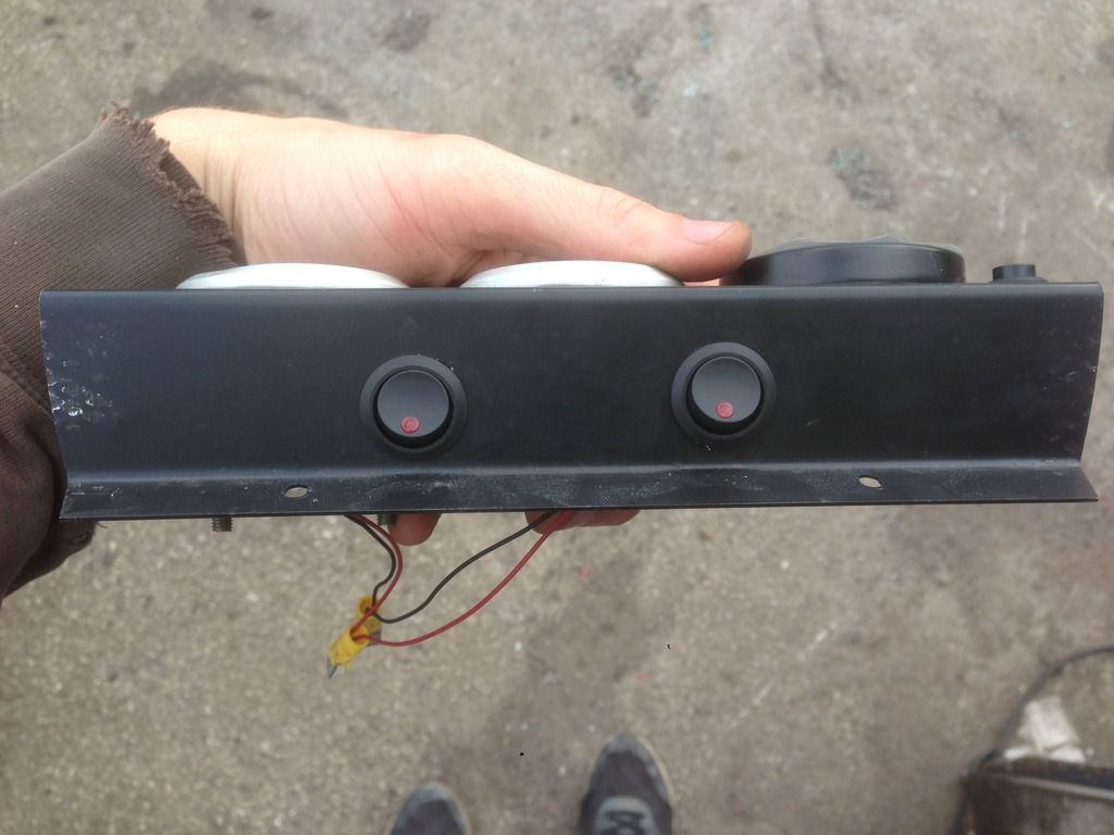

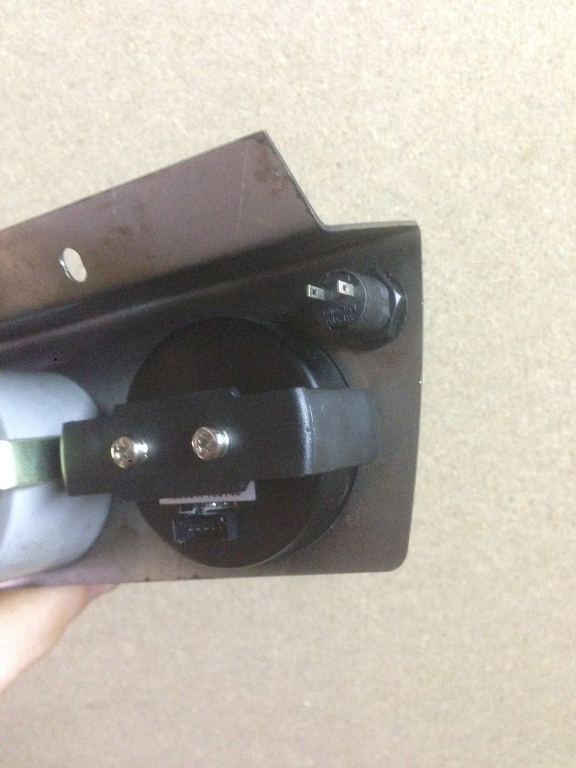

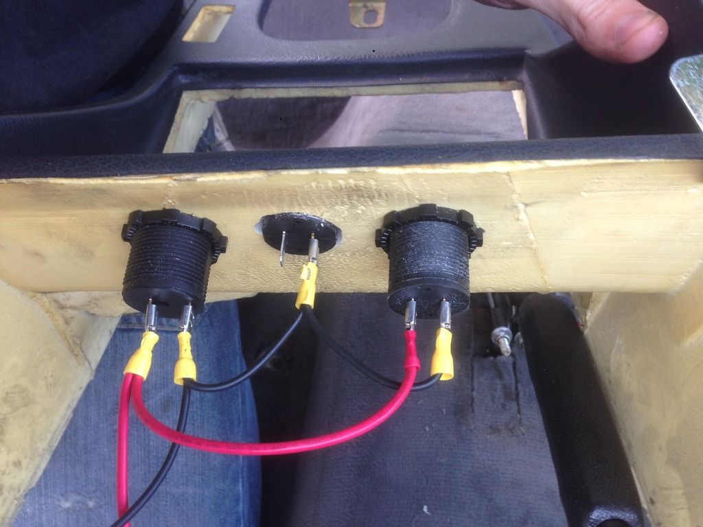

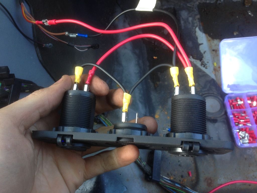

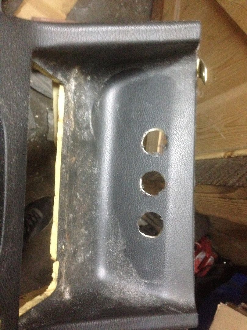

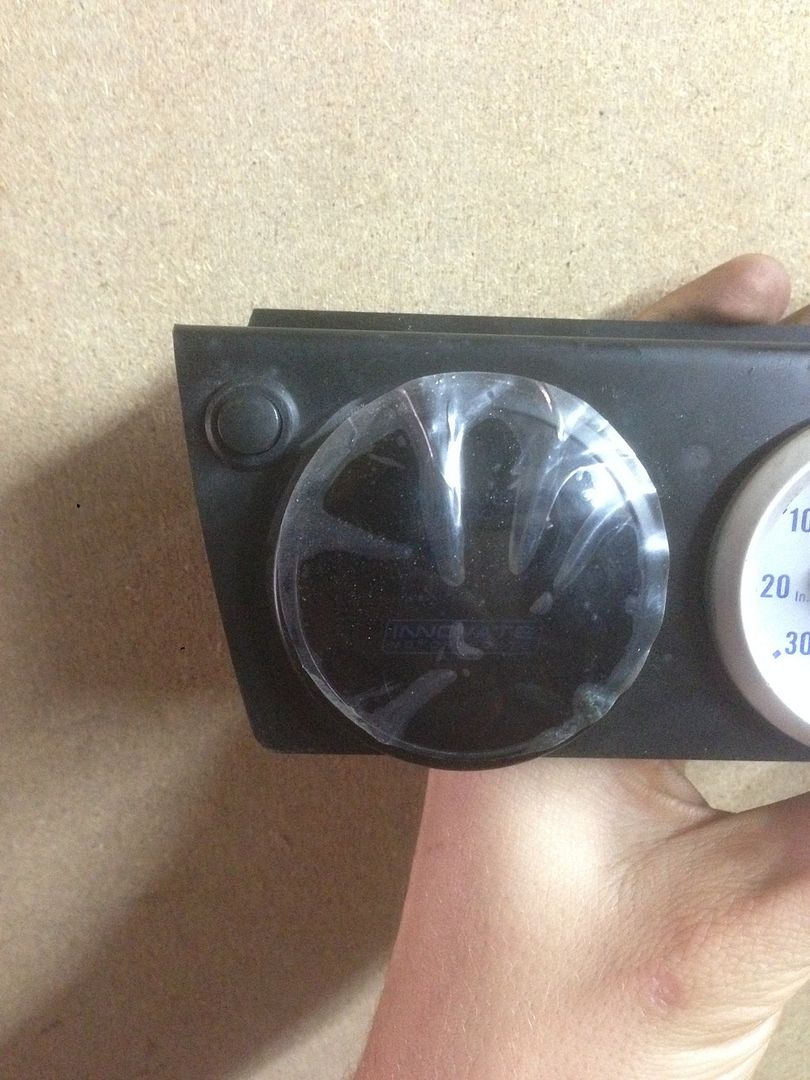

Doing some finishing touches to gauges and started to fit that volt meter, USB port and Ciggie lighter socket
Felt terrible drilling into a mint center console but needs must and I have a spare one incase I revert back to standard
Then did some mods to the ashtray gauge pod
Switch for the lambda calibration
Then switches for a few other bits and bobs
Nice and tight behind there now
Handy when you have a mate who's good with wiring and can keep me calm

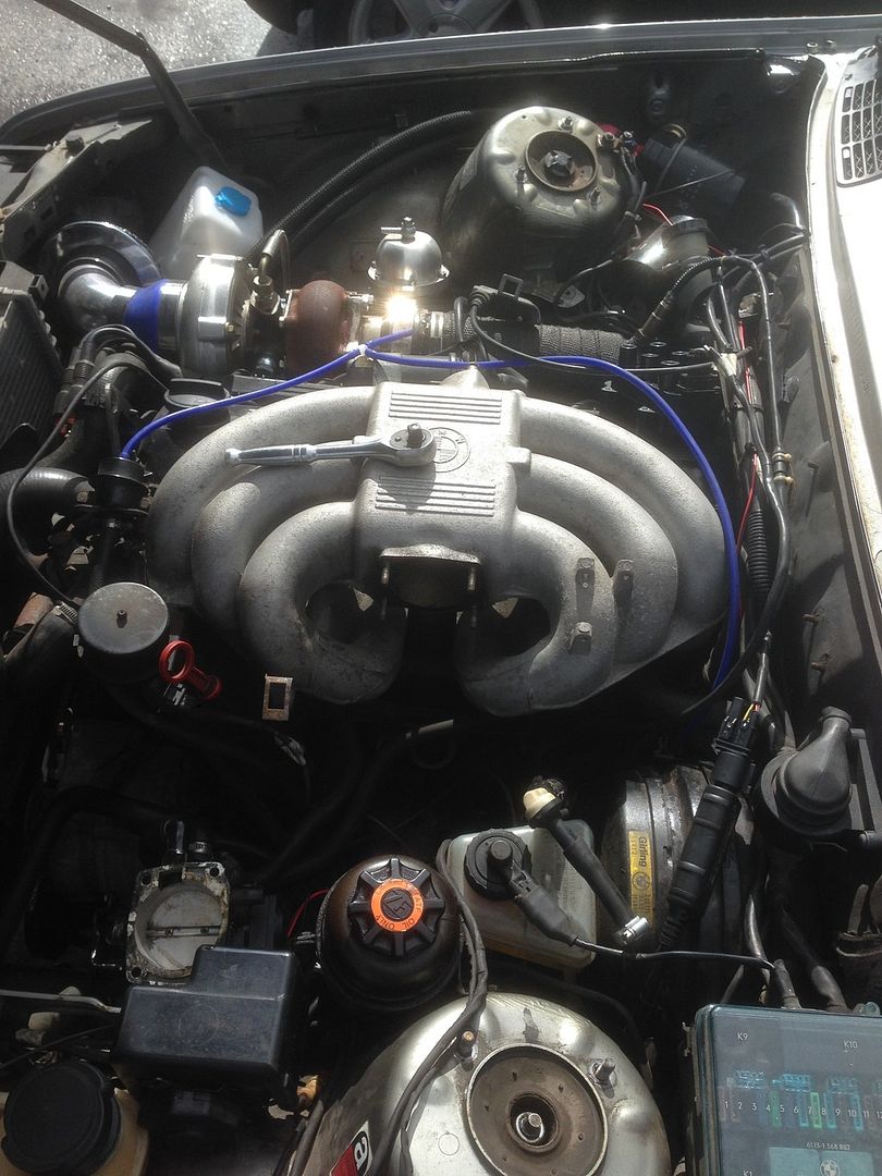

Yeah it runs again but it's too rich so it's needs mapping professionally
The boost gauge is tee'd from the vac line going into the Megasquirt ecu
That goes through the grommet that is behind the glovebox that the main loom routes through

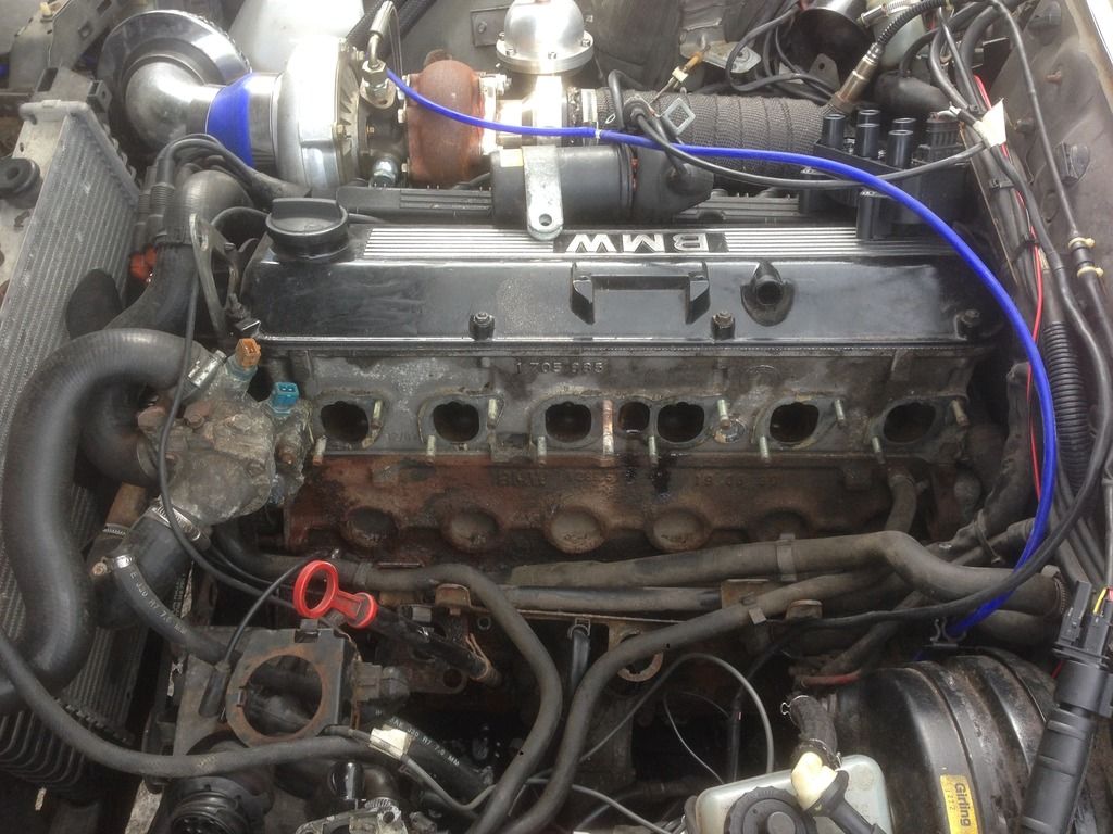

Yeah it's nearly ready for the road but the engine has just started knocking and I think it's the big ends so that's delayed me a bit
I bought 5m of the stuff from Ebay for £5
But yeah its budget from some people's spec but so far a rough calculation is just short of £6k
But that's entirely what it owes me, turbo parts, suspension, brakes, welding repair, consumables, all the little fittings and clamps etc so it does add up
