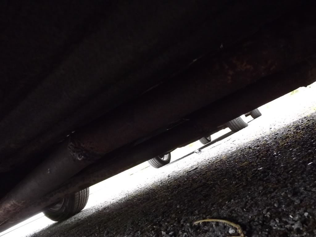

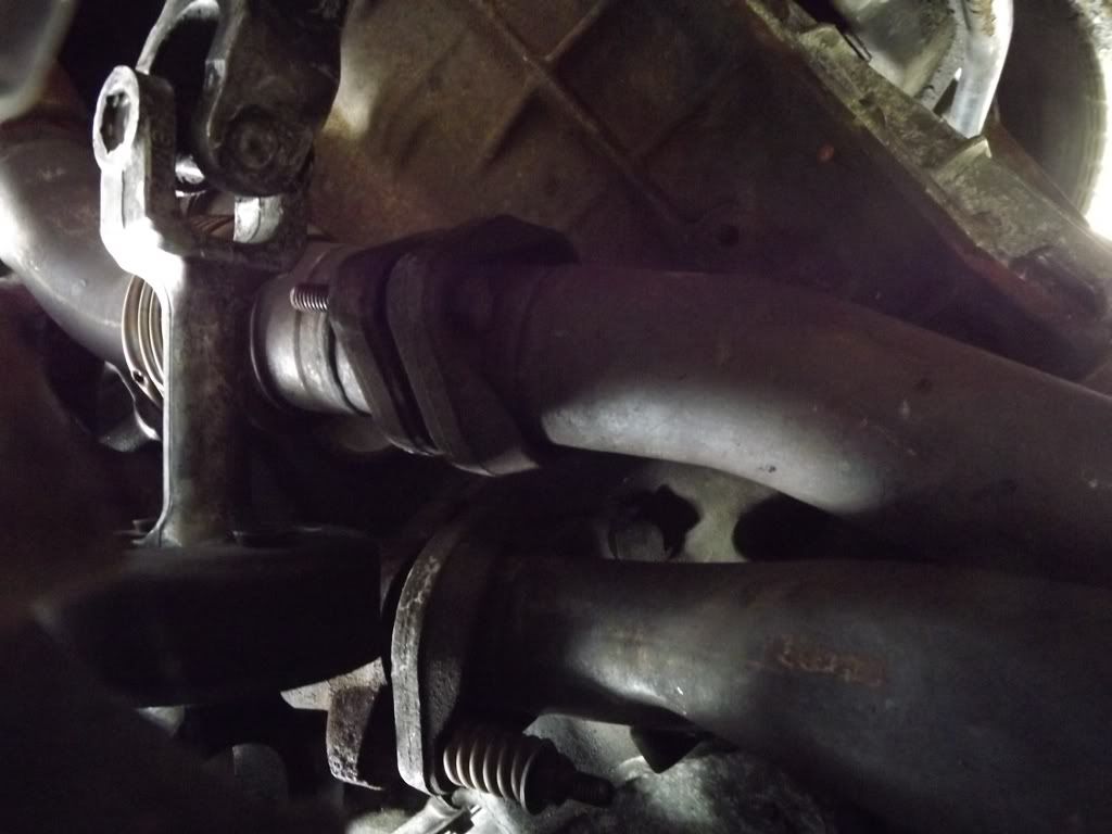

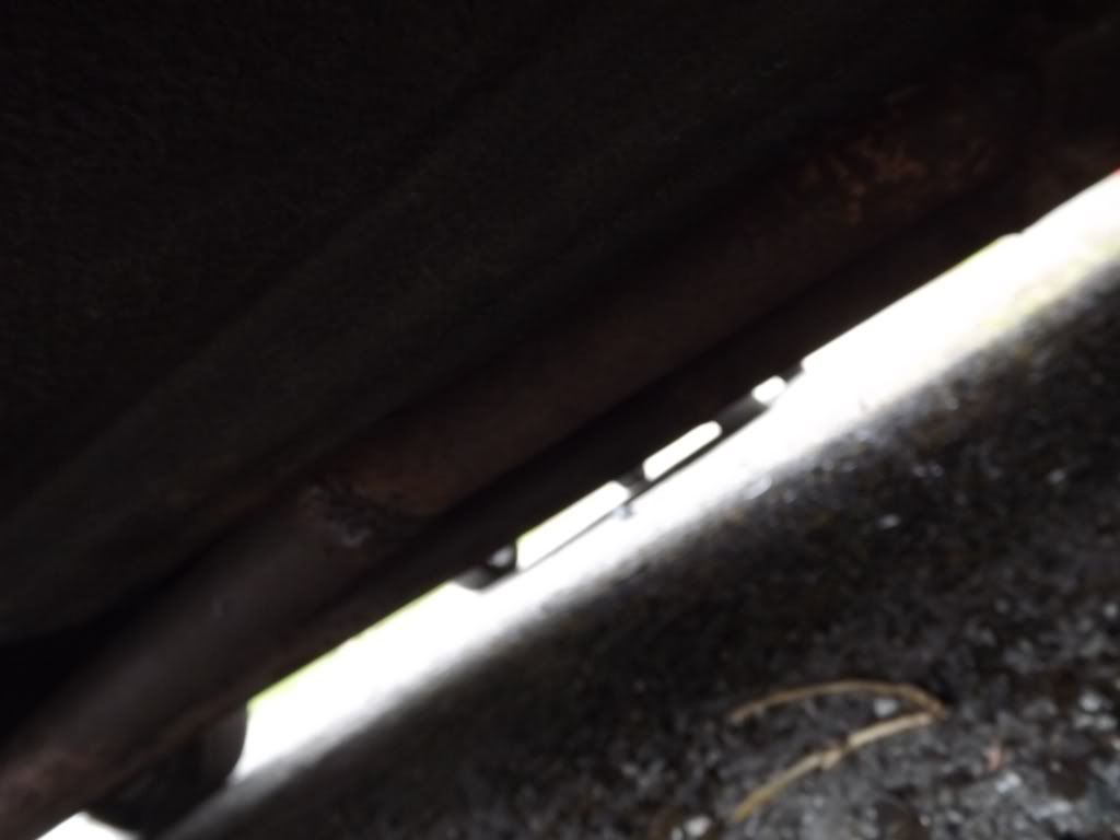

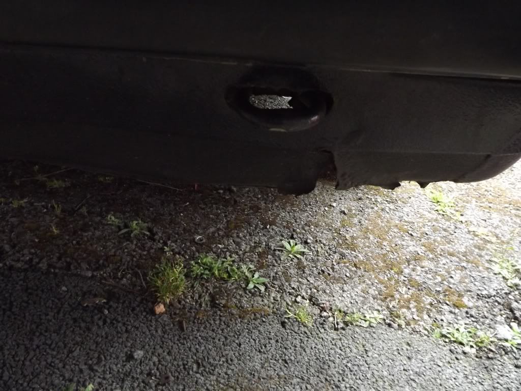

Went to fit the rear section of the exhaust however when the seller said the exhaust system was bodged to get it to his house i thought it was the cable ties holding it up however the whole thing is an epic fail. Basically its a 2 piece system thats been made longer for what reason i have no idea :S its a right mess so i need to get the front section re done. i'am no welder and cannot afford hundreds of pounds worth of manifold etc so your opinions welcome here. As i dont know how to get round this. Ideally if someone has an"off the shelf" manifold down to a 2 piece system sat in the garage i will buy it
I expect plenty of critasim but i wont loose any enthusiasm

Will a 2 piece exhaust fit upto the current manifold and sit in the right place or does that need altering

dont think there is to be honest, Do you know if the standard 325i exhaust fits them flexi bits on the manifold

Was the front section before the welds part of the m30 engine or 325i exhaust

the front was m30 i beleive alex. from the weld back was only to get the middle silencer on to get home mate

You can easily mate a 325i system to M30 downpipes,

M30 downpipes are 50mm E30 325i system is 46mm so they slide in nice and tight.charlE30 wrote:To mate the standard M30B35 manifold to a standard 325i system easily you'll need to get hold of some more E34 downpipes chop them and cut a couple of slits so it can be clamped up on the 325 downpipes.
Chopped E34 downpipes
325 downpipes clamped into the E34 pipes
Chopped 325 downpipes

Sorry Alex, just read your PM, bacically as Lee has posted, it's easy mate, nothing to it.
These downpipes are fromt he E34 sliced and welded onto the 325 exhaust.
I've done the same.
I've done the same.

Cheers Rav, ive been worrying thinking i need to spend a couple of hundred pound getting something fabricated
- E30 Zone Meets/Events Team
- Posts: 27978
- Location: Mad mad mad
More like about £50 Alex.Alex wrote:Cheers Rav, ive been worrying thinking i need to spend a couple of hundred pound getting something fabricated
- Posts: 22665
I may even be able to salvage the ones ive got so all i need is a front section from a 2 pieceRav335uk wrote:More like about £50 Alex.Alex wrote:Cheers Rav, ive been worrying thinking i need to spend a couple of hundred pound getting something fabricated

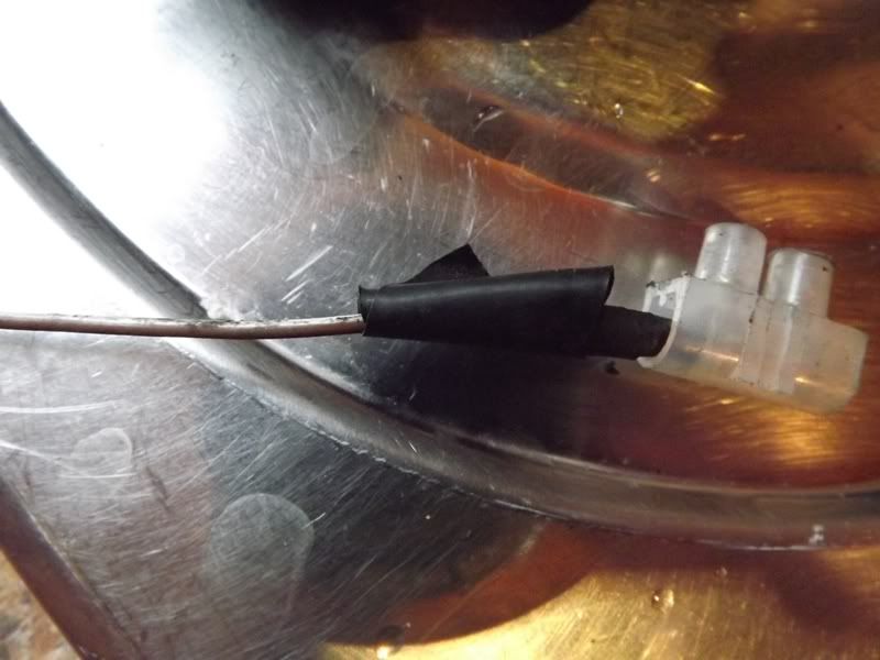

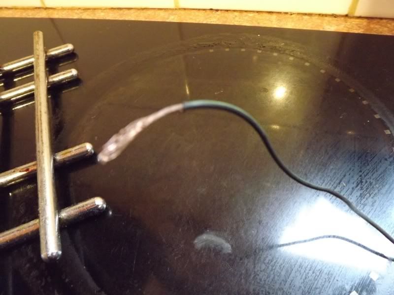

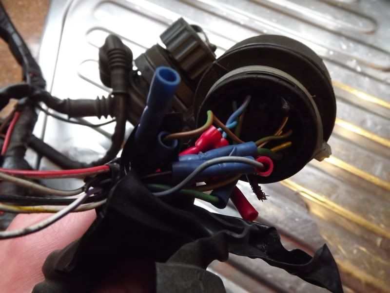

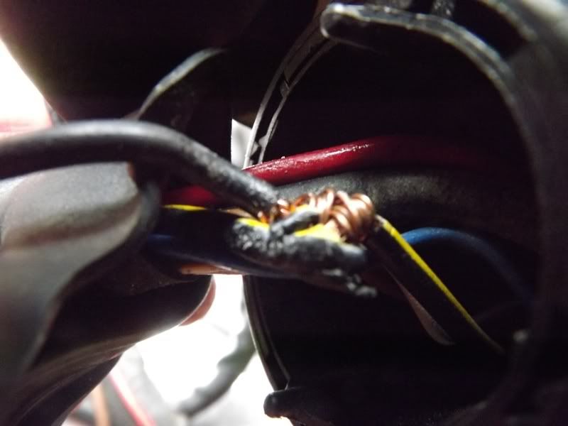

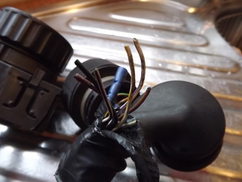

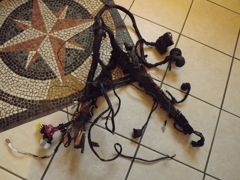

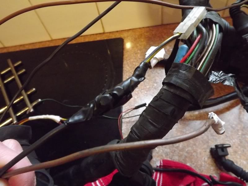

Whipped the engine loom out today.

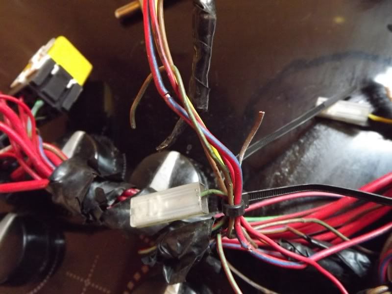

Not sure whether to fix the loom with heatshrink and solder or to get another, not sure why the starter wire has been cut in about 3 places
It was a bastard getting the loom through the bulkhead but managed in the end.
this was the starter and fan control
Removing loom
Loom out
Starter wire cut
Dont understand why all these have been cut and put back together but hey ho
More starter wire chopping

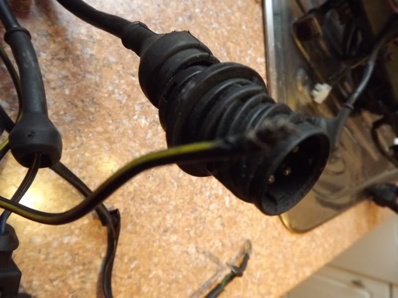

Can anyone tell me what this is suppose to be connected to? its brown and white and goes to injector loom?
am i right in thinking these are normal on m30 converted cars?
green and black wire ??? whats the suppose to connect to ?
Is this normal ? aircon perhaps ?
Bought a Danthe fan loom, and got a 324td washer bottle on the way from the dealers along with m3 battery tray wiring covers and lots of other odds and sodds
Ive also sorted a minty beige interior
Removing loom
Loom out
Starter wire cut

I think there was a wiring diagram listed in one of the build threads Alex.
- Posts: 22665
Ah yes, i remember someone posting something up actually
is it the same as the m50 one ?
http://www.e30zone.net/modules.php?name ... c&t=158933
in that case the green/black is the underloader relay? whats one of them
Not sure what brown and white is ?

Didnt realise the loom was that rough
in your shoes id sack it and get another.
Its in the thread you started Alex.Alex wrote:Ah yes, i remember someone posting something up actually
- Posts: 22665
I cant find the threadleeparkes wrote:Didnt realise the loom was that roughin your shoes id sack it and get another.

- Posts: 22665
Will this do the job?
it looks the same as mine
