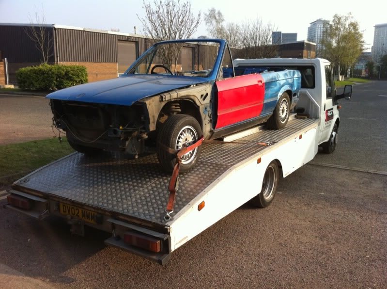

Well, here it is got collected at 6 last night:
Its now over to Matt for him to do some work.
