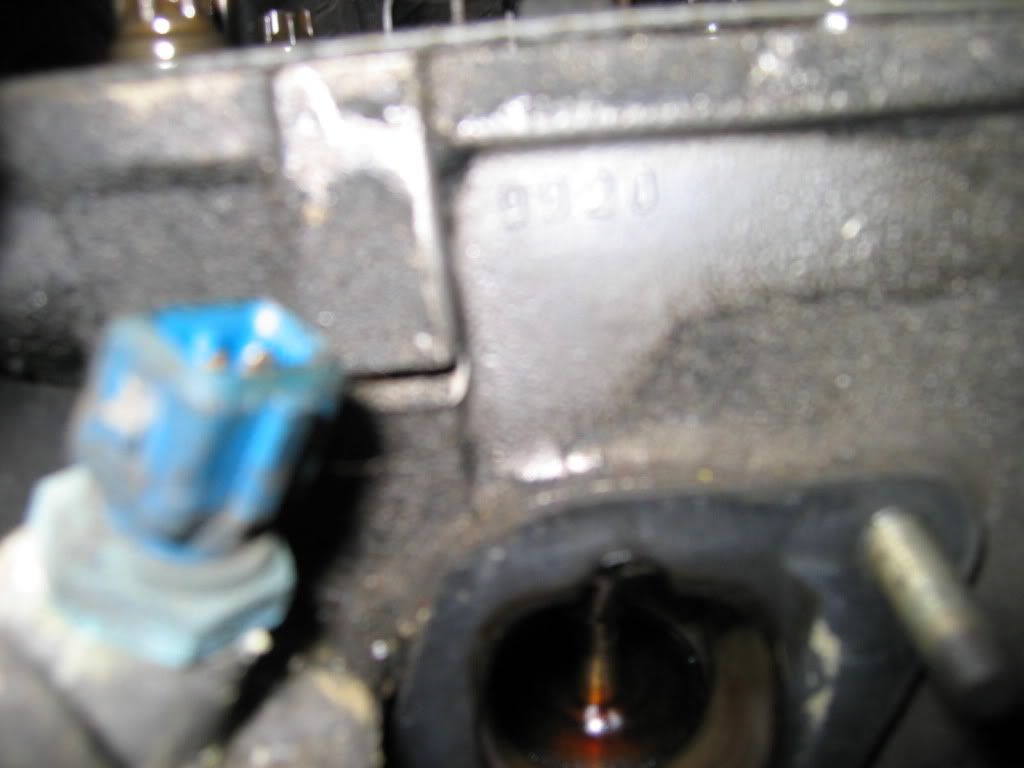

So far i have stripped the head down, had it pressure tested, light skim and a couple of broken studs removed.
Its a genuine Alpina head with the correct numbers stamped as shown:

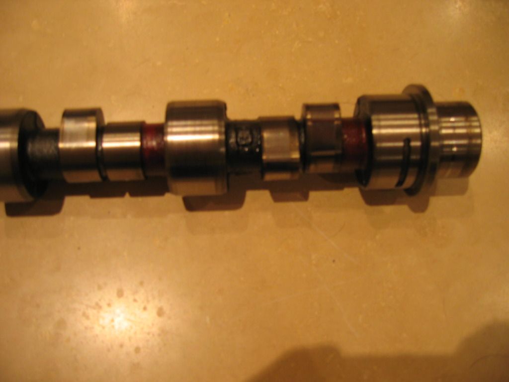

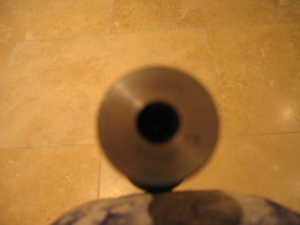

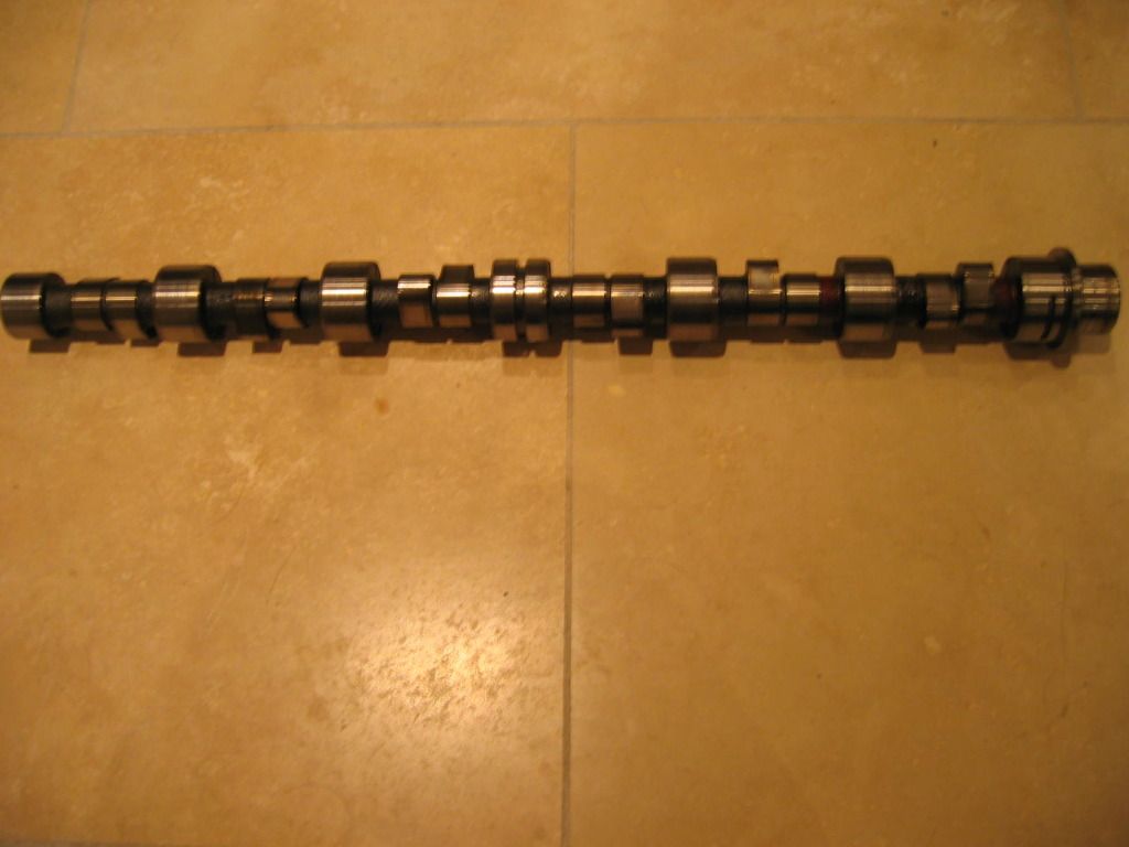

What i need some help with is an identity of its camshaft.
Its in excellent condition, no wear at all, and all the followers etc are genuine bmw, so no pattern parts appear to have been used at any time.
It has two seperate red bands on it, and the following numbers cast into it: 264, and B3
On the end of the cam other numbers are visable:
05601, e5, 7200
Sorry about the poor photos:
Any alpina experts help tell me if its a genuine c2 2.7 shaft?

Can anyone help me identify this camshaft?
05601, e5, 72000
Any help much appreciated.
05601, e5, 72000

here are the pics again:

I gather that the 323i had a 264 degree camshaft. Being an early chromie Alpina, maybe your engine is based on the 323i mill?

Thanks for the reply, thats an interesting point about the 264 stamp, but my car is a C2 2.7 based on a 325i.Speedtouch wrote:I gather that the 323i had a 264 degree camshaft. Being an early chromie Alpina, maybe your engine is based on the 323i mill?
I will try to find out more about alpina's cam spec.

After another look the 6 in the 264 might be an 8, giving 284.
Does this bear any more fruit - 284 degrees maybe?
- Posts: 24532
- Location: London/Surrey
Alpina Cam's are 268 degree.
284 is a schrick ratio if i remember right?

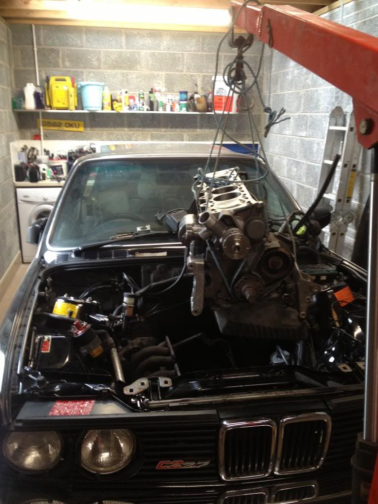

Time for a bit of an update!
Went to the e30 owners show in Athlone last year and a nice chap took these arty pics:

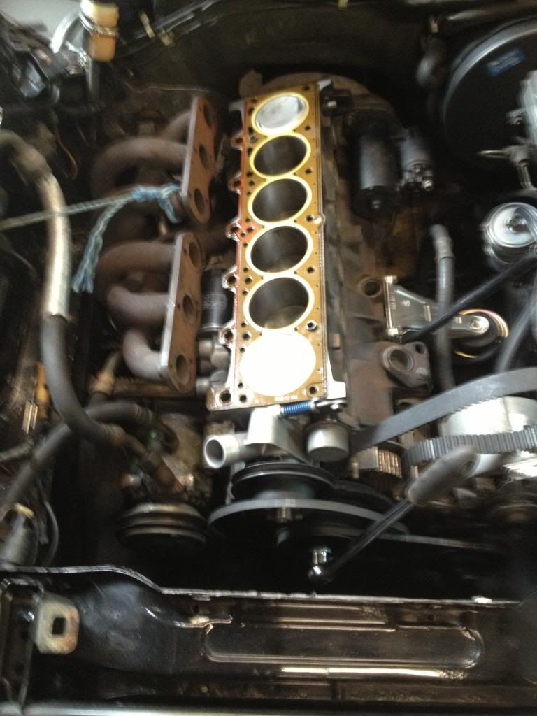

In the mean time ive been busy rebuilding its 2.7 lump, it was looking rather sorry for itself:
The bottom end all measured up within tolerance, so bores got honed and the crank got a polish.
New mains/ends/small ends and rings were fitted along with the usual oil and water pumps, new oil seals etc, and i lightened the flywheel.
On its way back in:
And home sitting at TDC:
Im now working on the cylinder head. Its been pressure tested, skimmed and had the obligatory broken exhaust studs removed. The valves are lapped in and fitted with new stem seals and im deciding on which camshaft to use. Either the 'original' one pictured above or possibly a schrick...
On its way back in:
