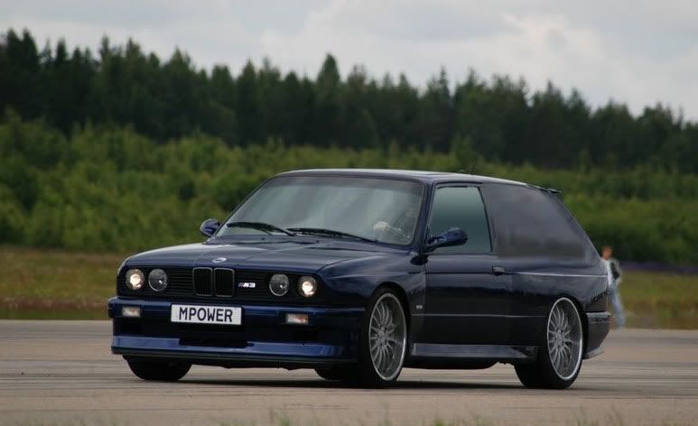

It looks more like the back end of a Lancia Integrale evo to mechris_335 wrote:errr no looks like the back end of a golf
I was thinking the same TBHRav335uk wrote:It looks more like the back end of a Lancia Integrale evo to mechris_335 wrote:errr no looks like the back end of a golf
beardymat
- E30 Zone Squatter
- Posts: 1979
- Location: sheffield, city of steel, and rust apparently
either way its fookin hideous,lol
think the first one might be a little off too making the glass look a little longer than perhaps it will be. Been toying with keeping the pillar and standard touring rear glass with a small filler glass in the gap to the door. Wish i had photoshop and knew how to use it so i could mock a few ideas up
that had been the idea we were having aswell as our thoughts were this would keep the shell nice and stiffbeardymat wrote: Been toying with keeping the pillar and standard touring rear glass with a small filler glass in the gap to the door. Wish i had photoshop and knew how to use it so i could mock a few ideas up

well the pillar wouldnt be cut out whilst last so at least i could knock up a piece of glass and try it to see how it looks before i comit, would probably add the stiffening beams in any case since s50 e30`s especially like going sideways and there is very little strength in the side of these, i pointed out on another thread how the quarter panel moves slightly on a two door when you slam the door
could keep the pillar and use one piece glass which is blacked out where it goes over the pillar......

Now this is a 'proper' Daimler earning it's keep!DaveyB wrote:Silver tourer above
Blue tourer with m3 arches
Only just found this thread,Matt,but an awesome idea.
Would retaining the saloon 'C' pillar with an extended roof work?
Youth is wasted on the young.
How about a convertable shell & have a removable touring roof, could also be a pickup.
(\__/)
(='.'=)Simon13 wrote:
323's were dangerous this will un drivable in the wet!

Basic snag with this idea is that the convertable has a double bulkhead between the pax compartment and the boot....adds strength when the roof is chopped off....mattG wrote:How about a convertable shell & have a removable touring roof, could also be a pickup.
As a complete aside,the convertable appears to flex mainly around the area of the 'B' post,rear of the door shuts in the cills needed repairs on project cabbie on both sides.

IMO the 2 door C pillar grafted in would make it a lot better at the back, could do with beefing up the B pillar alsobeardymat wrote:either way its fookin hideous,lol

me and a mate are considering doing a 3 door touring so im watching this for good ideas
beardy we have discussed leaving the rear pillar in and blacking it out with a full length piece of glass going over it think it will look good that way and minimal strengthening work needed
Doing that though will mean you'll be stuck with the Touring front doors, Matt is moving the B-pillar so he can fit longer 2 door shell doors as per an M3.jonny323i wrote:me and a mate are considering doing a 3 door touring so im watching this for good ideas

well ive got rid of a little more of the rust up front this weekend, and also removed all unwanted bracketry. i still need to do a repair on the offside inner wing where some alarm fitter drilled a few extra holes and didnt protect them at all
i also need to sort the servo location on the bulkhead and repair the jacking point corners and then the bay and outside of the inner arches can be painted ready for the engine swap, will need to thin out the wiring to remove the abs loom as im taking it off but on this car the abs loom is taped into the main loom so i can see that being fun. more pics.

two reasons really malc, mainly to make room for the standard e36 airbox and secondly whilst i could relocate the abs to the battery tray or higher up the inner wing and move the header tank to the battery tray i realised that i have never had the abs cut in on an e30 so it seems like hassle for no reason.
I did a test in the recent snow on my passat where i let the abs try and stop me and then stopped myself using the old fashioned method and i was quicker than the abs.
Dont forget that the E30 for me is a hobby car not a daily driver so whilst it will still get used in poor weather it probably wont be going out in snow and ice.

it should look like the red photoshop job on page 3 but with nogaro centres to the wheels, although im thinking the rear quarter glass might look a little better proportioned on the real thing but if not i have a couple of other ideas floating around the old grey matter.

I'm not really into these 'projects' but as a test of your skill it will be good fun.
You cannot lose the C-pillar dude it looks like a hearse without it.
I've seen a 4-door one with M kit that looks good, the M3 rear arches were fabricated into the rear door and the metal work was epic. Only way forward I think. It's on here somewhere - someone must have the link...
And just for a laugh.

Oh yeh - fab the M3 rear screen into the tailgate if you're 'ard!
