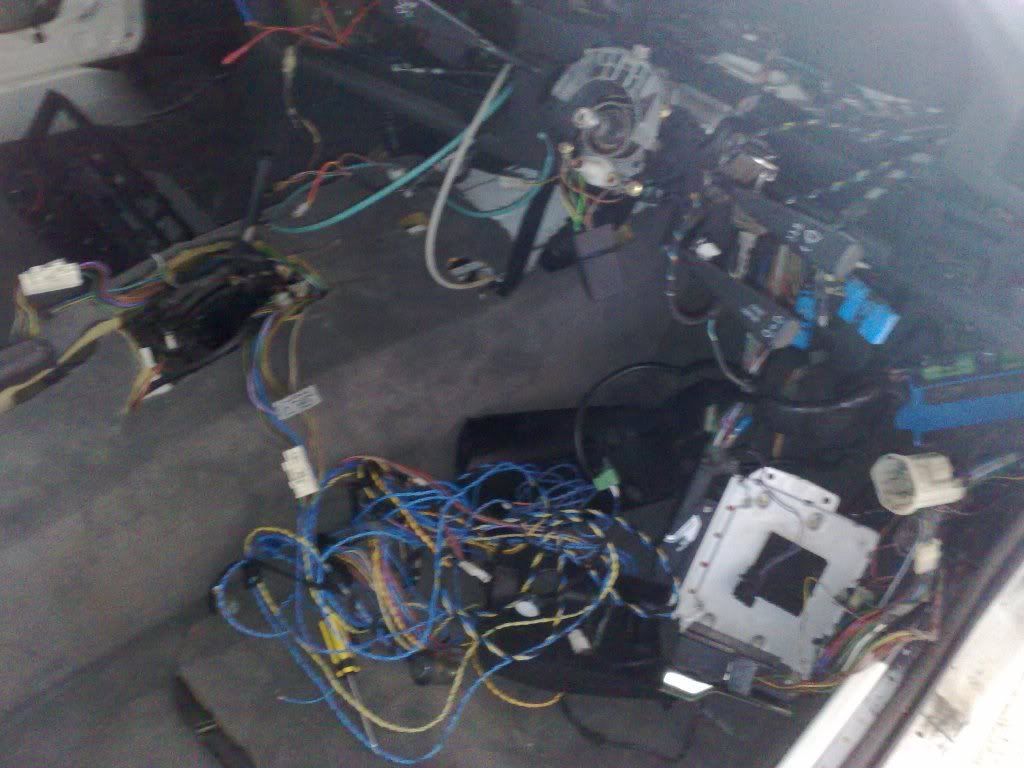

sorry for crap pics, was quite fun with the wiring

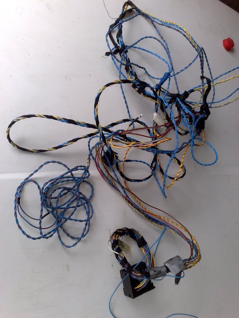

removed an old immobiliser, plenty of crap that was no longer connected and fixed wiring where it had been sliced into, such as the hazard light switch which looks like it was supplying power to a radio
fitted this nice radio loom

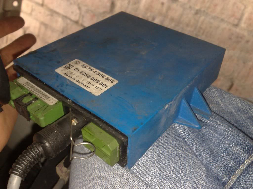

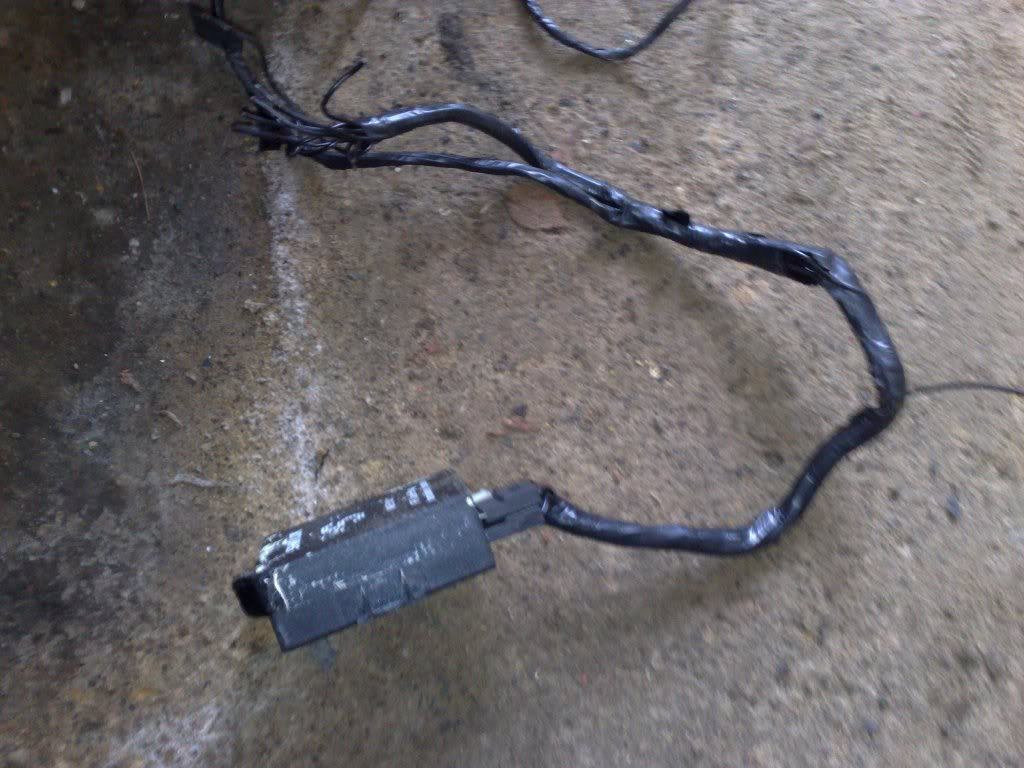

anyone know what this is???? is it part of the bmw cabby alarm, i removed it and the car would no longer start so i connected it again.

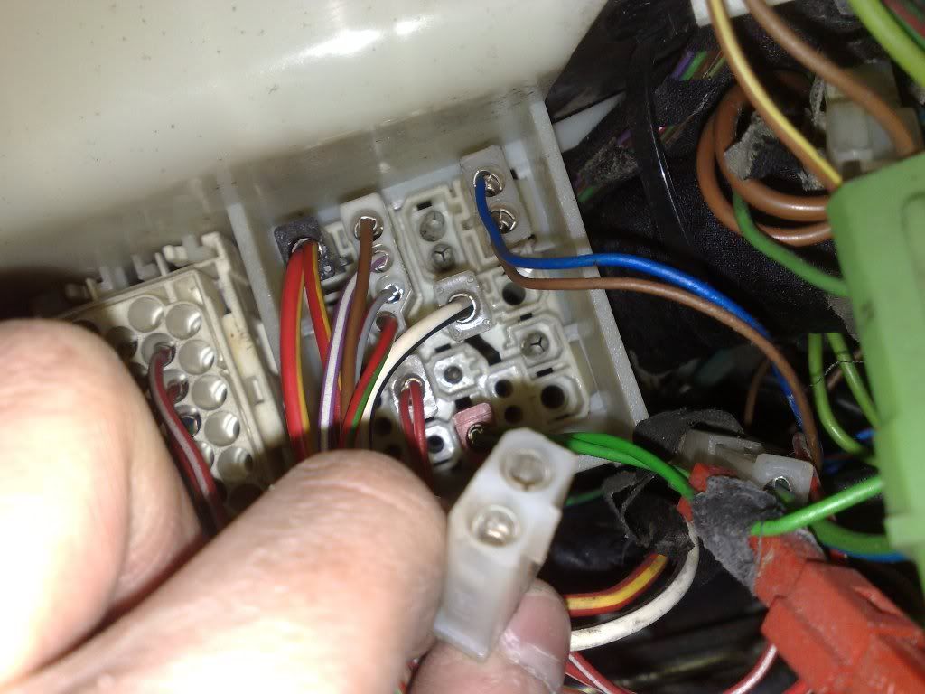

whilst fitting cruise control i couldnt fit the socket into accessory socket, it will fit in the one where the blue/brown wire at the top right is but the one next to it is a different shape and the little lug on the plug wont fit in.
does anyone know where this goes???? do i remove the blue and brown one?????
Removed this and a load more wiring

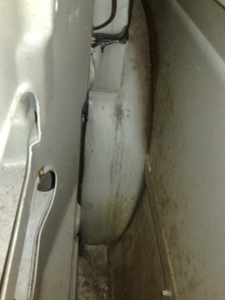

Inner arch

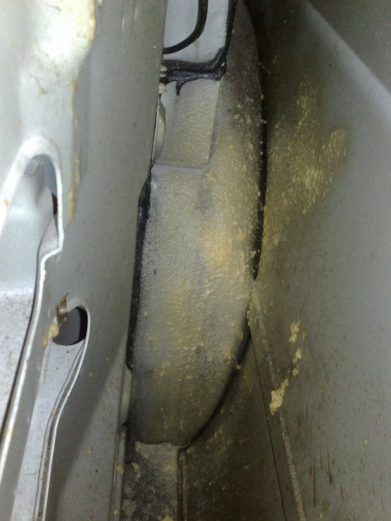

Inner arch all waxoyl'd
need to pull the window mech out the other side to have a good look and waxoil.

That loom is out of that late bmw touring i broke so the rear speaker connectors will need cutting off and spade connectors will need putting on. 1 plug in the accessory socket and then all you do it run the wires round the car.

with the radio conector where it should be (behind heater panel) and accessory socket plugged in the speaker wiring goes down the passanger footwell where the passanger front speaker goes, then to the rear passanger side then across to the drivers side rear speaker. and the driver side is suppose to go across the transmission tunnel and up where the speaker is with the wiring loom that goes across but i ran that behind the dash pushed right to the back.
I used tye raps to secure the loom to the rest of the cars loom and used the fabric tape where needed

Alex, the Blue ECU has to stay, as it has something to do with the imobiliser on the cab only, if you install a OBC, then connect it to this.

- Posts: 22666
ive got a 13 button obc on its way, so this would connect to the spare connector on this and i would do away with the OBC immobiliser ecu??Rav335uk wrote:Alex, the Blue ECU has to stay, as it has something to do with the imobiliser on the cab only, if you install a OBC, then connect it to this.
