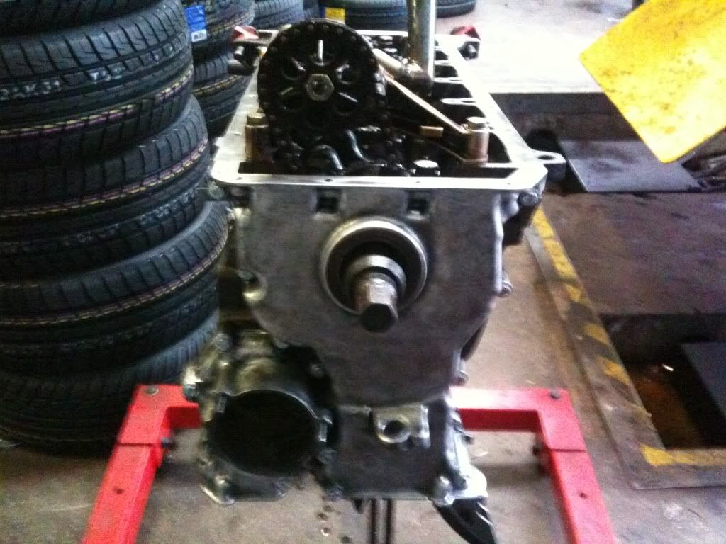

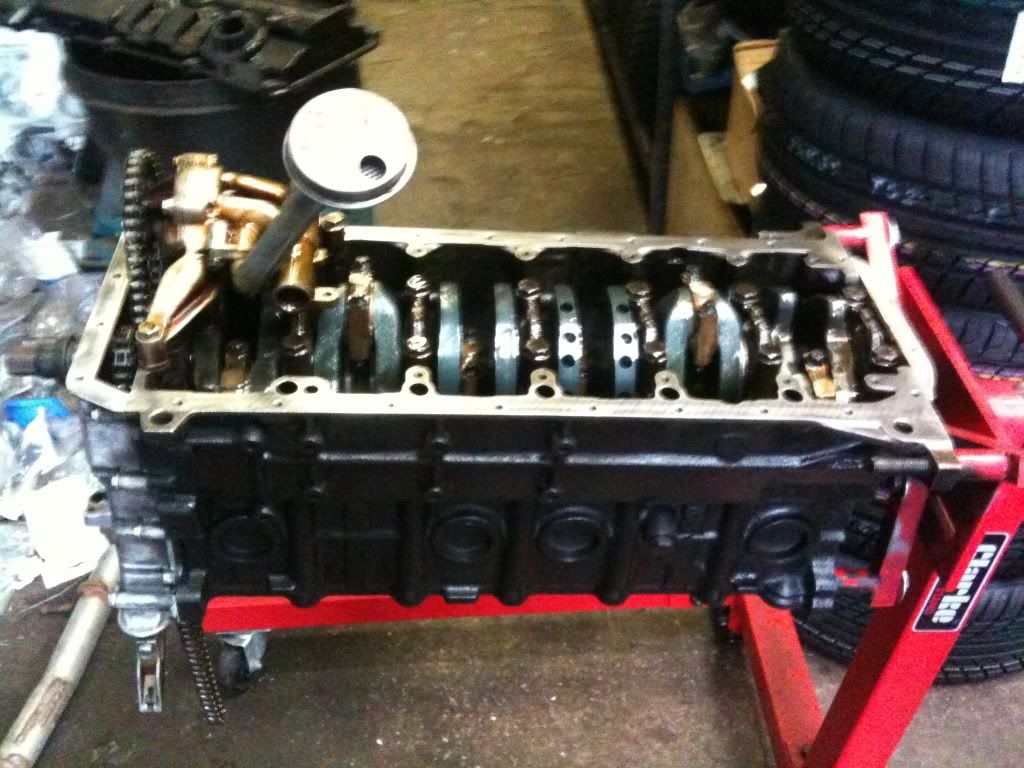

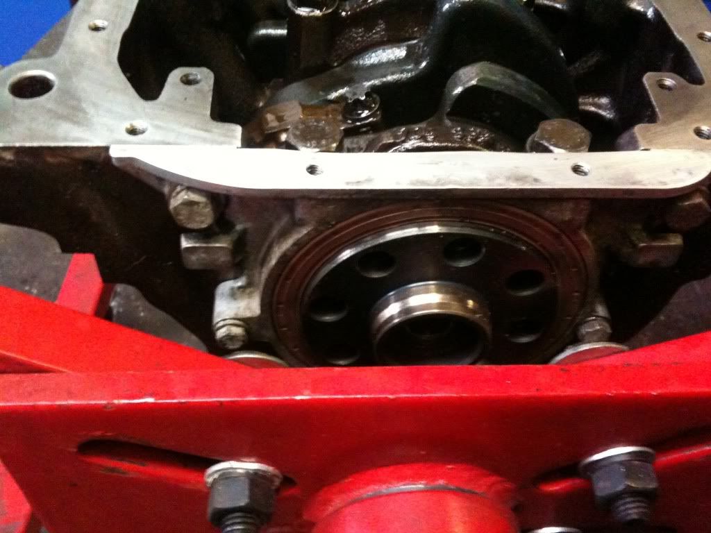

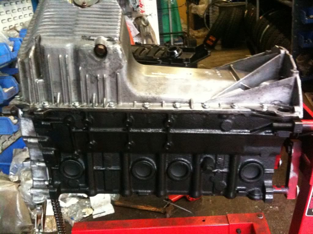

Post Fri Feb 05, 2010 7:48 pm
Slight progress today. Everything is torqued down. Oil pump and E34 oil pick up pipe fitted. New oil seals fitted to the end plate and flywheel seal. All old gaskets removed. Faces cleaned ready for the sump to go on tomorrow. End plate gaskets, do they need gasket seal or can I just use greese?
Tomorrow hopefully I will have this biatch ready for the head to go on. Getting a pan handle just thinking about it. :o:

Post Fri Feb 05, 2010 8:53 pm
Gaskets should be fitted dry, you only need gasket sealer on the joins to the chain cover and rear oil seal carrier

I was ment to be working but managed to do a little bit today. Just need the head now and we will be there there abouts :D
Bottom end all torqued down, fitted oil pump and E34 pickup pipe.
Cam chain cover and flywheel seal.
Sump fitted too
I know it just looks like a normal M50 block and its been seen 100 times but finally getting somewhere :woohoo:
Just need the head on now and we are in business :cool:
