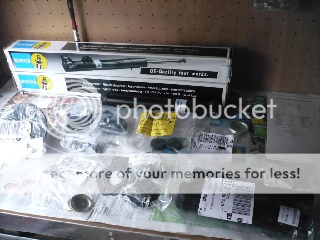

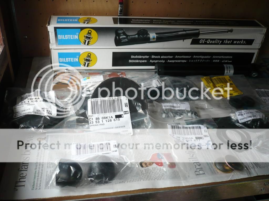

Ok folks, as promised, here's a bit of an update....
So I was thinking that it was time for another E30 project and I really wanted to get back to my roots - a 2 door saloon, having spent a bit too much time with Tourings recently.
I always regret selling my 320is. It was a pretty special car, and I spent a lot of time on it. It ended up with full M3 running gear and it went so, so well. I loved the subtle look (especially on the 16'' Sport Evo wheels) and it got me thinking that it was about time I pulled my finger out and started to think about building something similar....
So I heard about this chromie and that it might be for sale, but as a rolling shell. I've never had a chromie before and I do like the look a lot. The original engine, transmission and running gear had gone and there wasn't much in the way of paperwork, so this car's originality is long gone. A perfect blank canvas then! I'm thinking along the lines of a very standard looking car with a few choice tweaks here and there - but using genuine BMW parts as much as possible. I'm a big believer that the best modifications are those that were produced at the time by BMW but not necessarily fitted to all E30s, so I'm going to try to stick to that.
I happened to have a complete set of E30 M3 front struts and trailing arms hanging around that needed rebuilding. Part of the deal on the 325i was that the running gear was only to get it moved and that it would be sold on by the previous owner, so there was an obvious solution.....
I started to strip and clean up the struts, along with working out what I needed to start the suspension build. Quite a lot as it happens...
So the look I've decided on for the car is probably not to everybody's taste - as standard as possible, but a touch lower. I'm not a massive fan of overly lowered cars, so I ordered a set of M Technic front and rear sport springs to match the Bilsteins that I already happened to have. I've got a set of 15'' and 16'' M3 BBSs as well as a set of Alpina B6S 8x16s, so I need to decide which ones I'll use. Either way, I don't want it too low but I'm not looking for the standard tractor spec ride height!
I started with the really easy bit at the rear:
And the finished article:

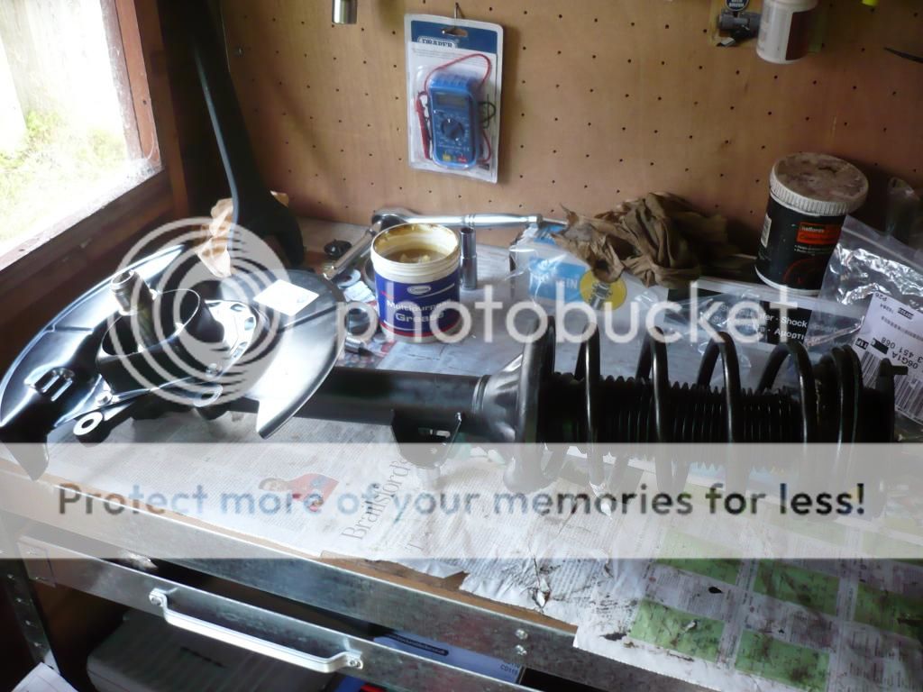

So moving on to the front. I've sanded and scrubbed down the struts, masked up and started painting - more to follow soon!
anothere21323i
- E30 Zone Camper
- Posts: 1203
- Joined: Mon Oct 31, 2005 11:00 pm
- Location: Colchester

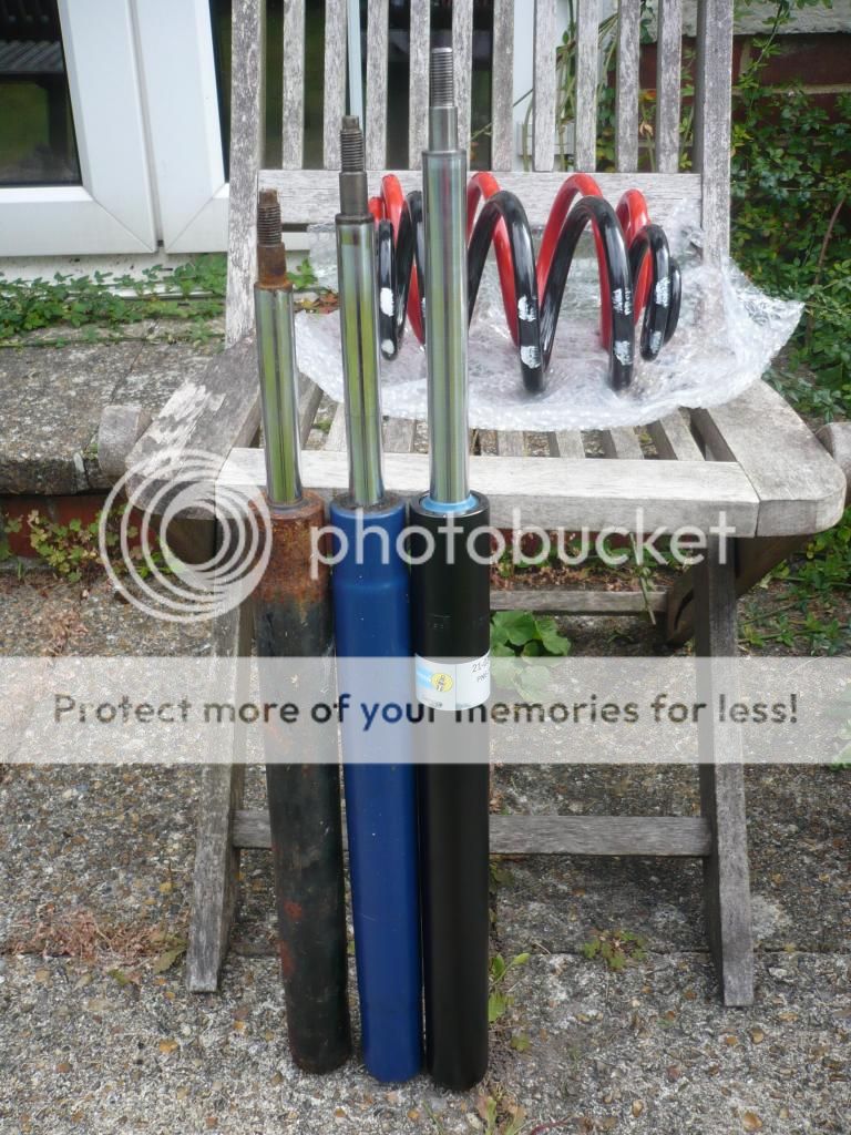

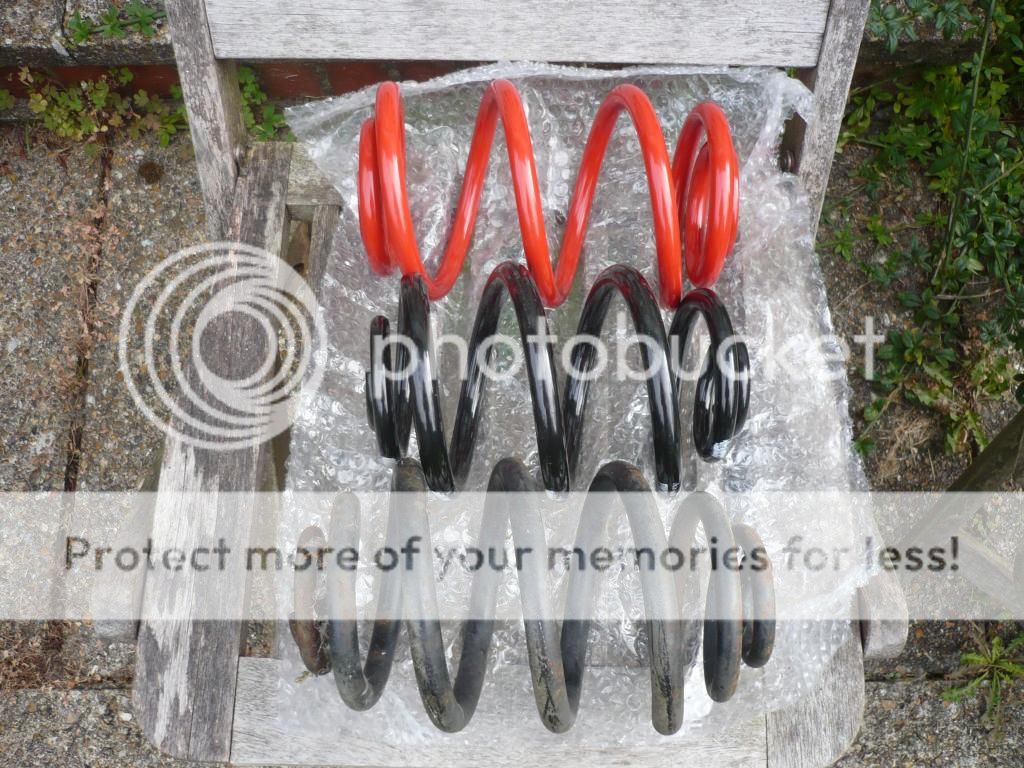

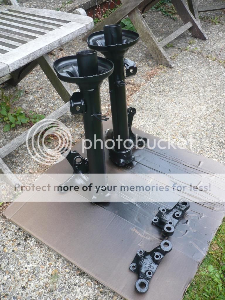

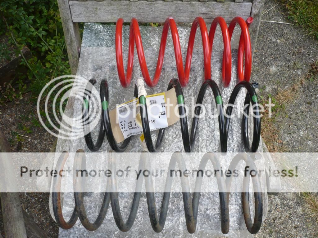

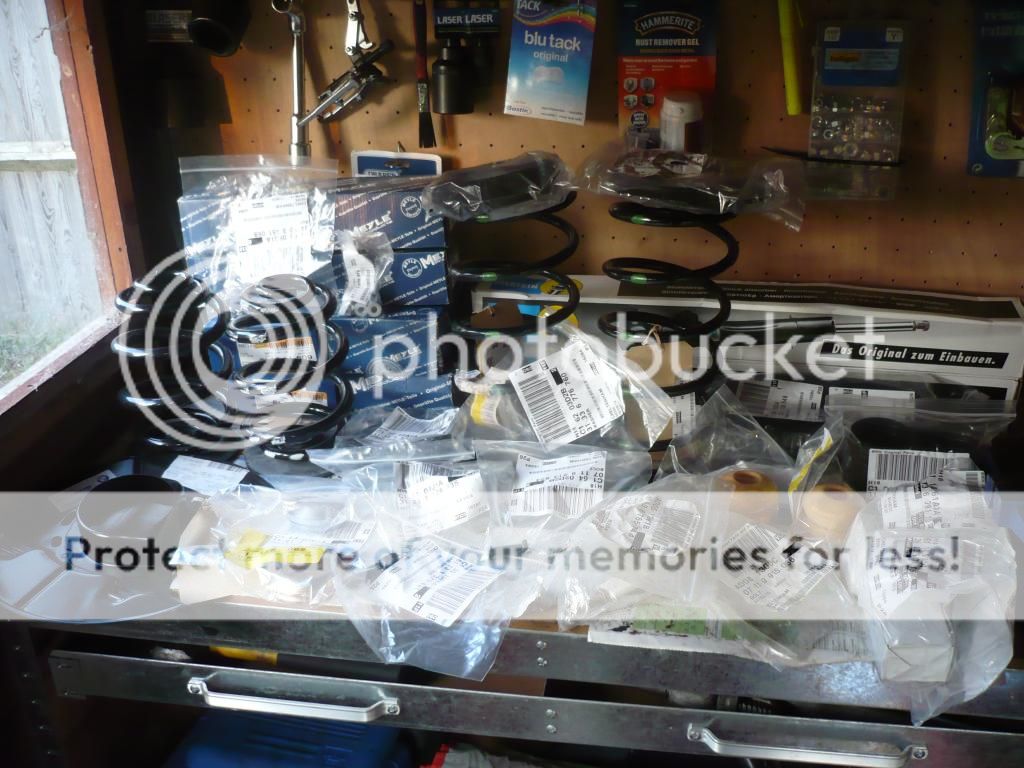

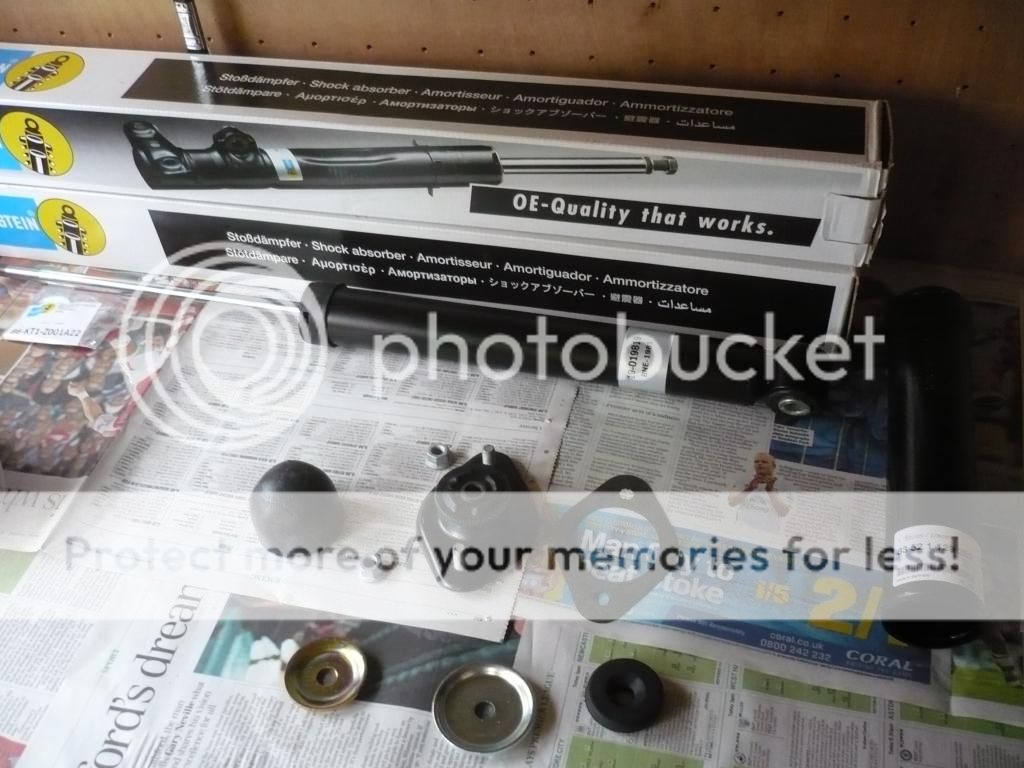

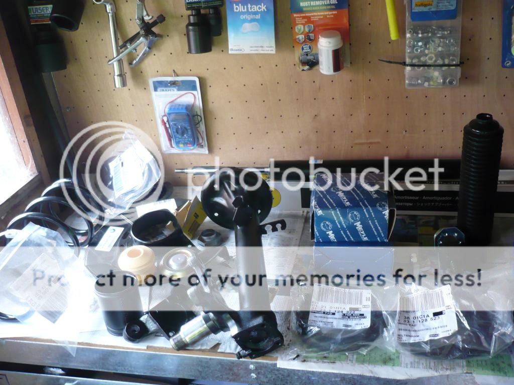

Got loads done today on the front struts. Just out of interest, I thought that I'd do a bit of comparing, starting with the dampers themselves. On the left, there's an old Boge 325i shock absorber, with a Boge M3 item in the middle. The new Bilstein B4 shock is on the right. I certainly didn't expect the standard 325i shock to be the shortest:
Similarly, I compared the new M Technic spring against an H&R one and a standard 325i item - this was a bit more what I was expecting - the M Tech spring is roughly somewhere in between:
But on the rear, looks like the new M Tech spring is slightly shorter!?
Anyway enough confusing myself. Here's some nice, newly repainted M3 front struts:
And all the new bits to go on:
Taking shape:

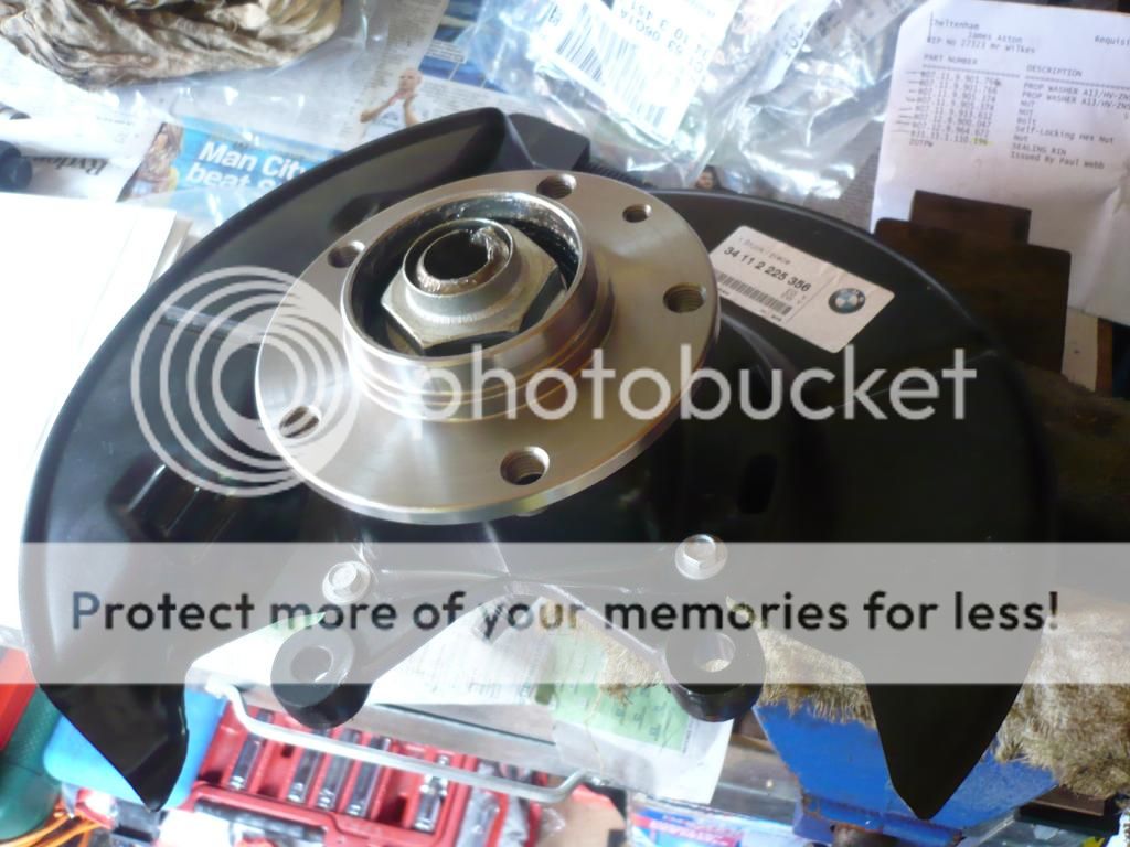

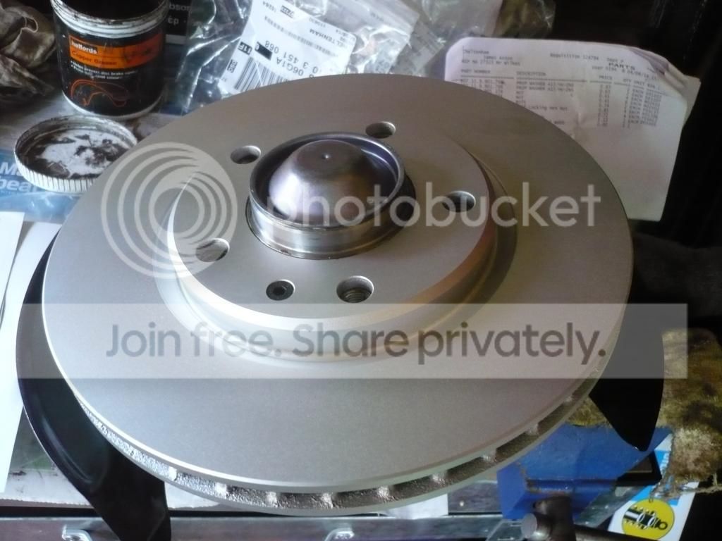

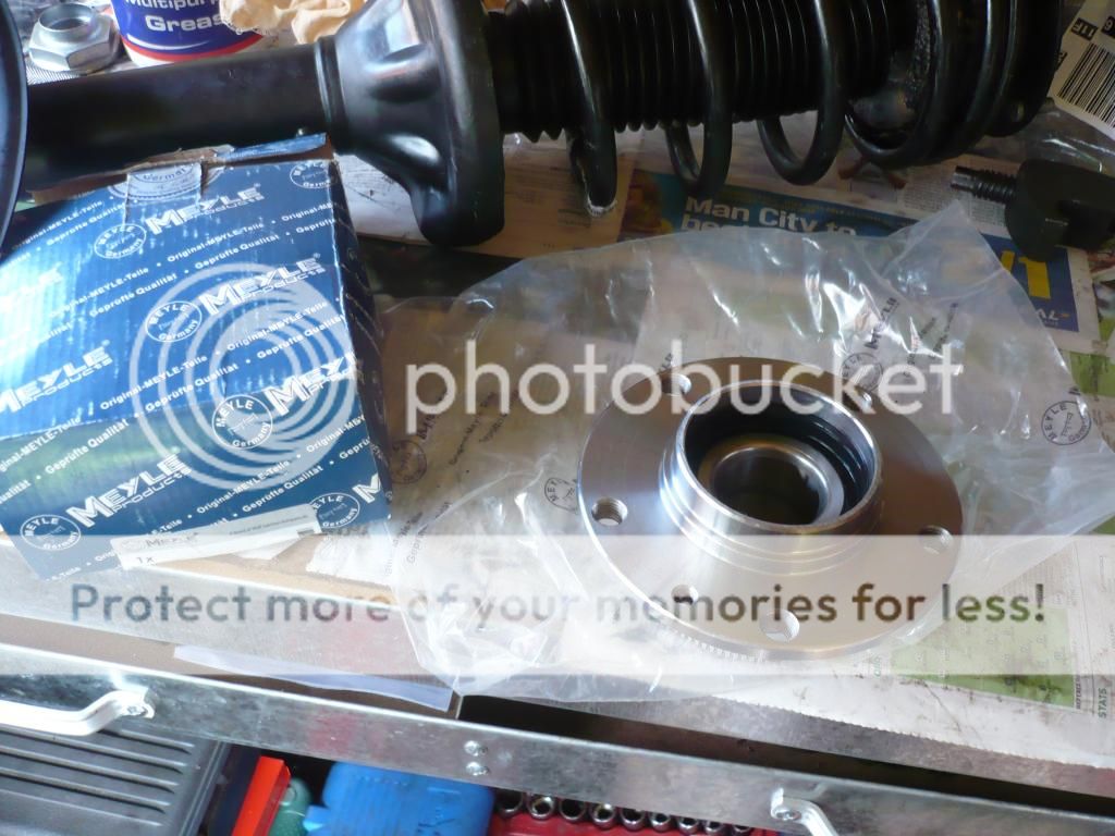

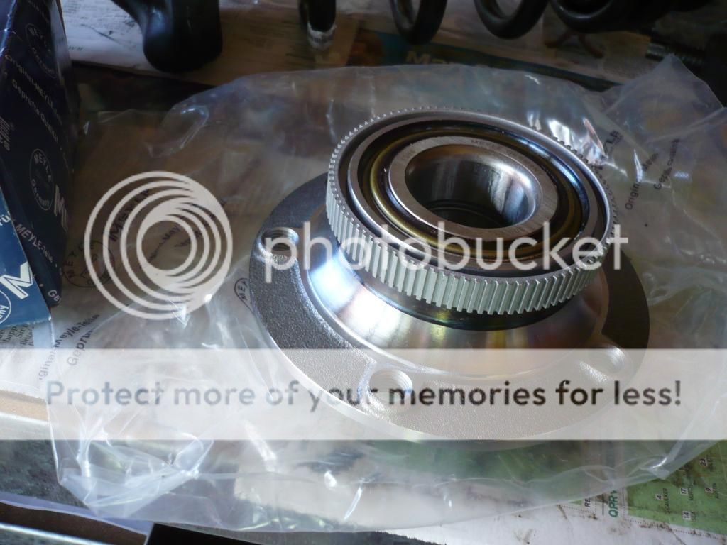

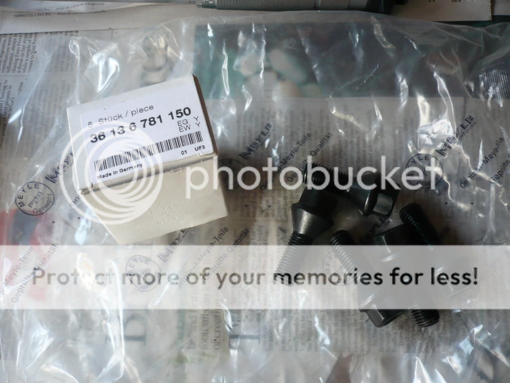

Now, very fortunately, this car doesn't have ABS fitted, which meant that I could order some E24 front wheelbearings rather than M3 items. A pair of these Meyle bearings were a fraction of the cost of one M3 bearing - always nice when that happens.....
And with the new brake back plate. Unfortunately I'm still waiting for the other one to arrive (mega back order in Germany
New disc:
And new studs to finish it off - I ordered 20 new ones...
Tomorrow's job is to start on the rear trailing arms.......

The standard damper will be partially collapsed, you will be able to pull the rod out of the tube a fair amount to get the true length.

Funnily enough I pulled it out as far as I could!DanThe wrote:The standard damper will be partially collapsed, you will be able to pull the rod out of the tube a fair amount to get the true length.
