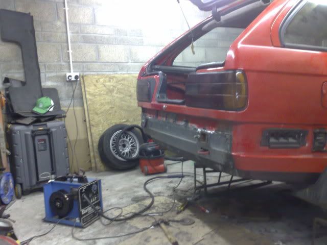

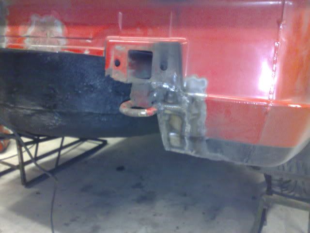

Not alot done today but every little bit helps.

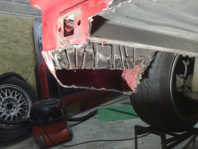

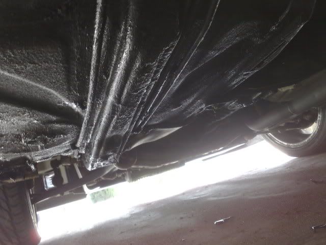

Started cutting out the rot on the rear end and made a start on the undersealing,got about half done .
What a messy job that is.

Welding just about complete :D
shedrool83
Posts: 4395
Location: Dundee Scotland
Sat Aug 22, 2009 6:50 pm
The welding is complete :banana:

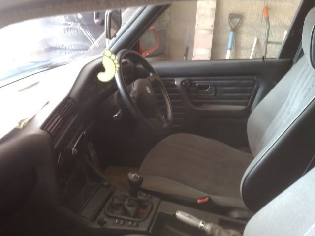

The interior is now complete but does need a good clean.
I'll be finish off the bodywork and underseal and hopefully get it mot'ed next week.
Then the 2.5 can go in and i can get it resprayed.

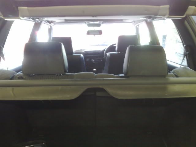

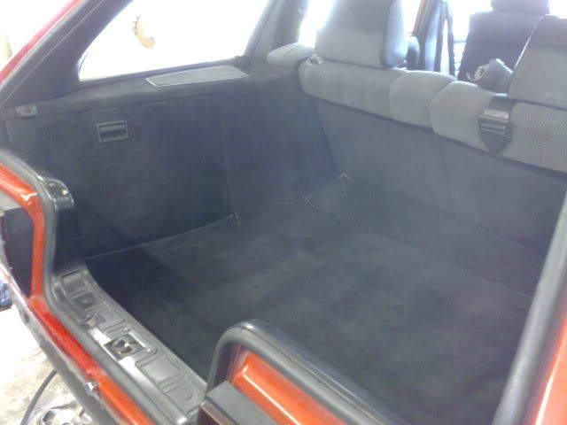

replacement drivers seat
rear headrests fitted

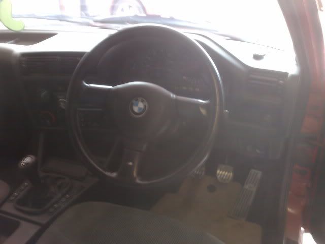

Tech 2 steering wheel to replace the tech 1
Boot trim now black to match the carpet

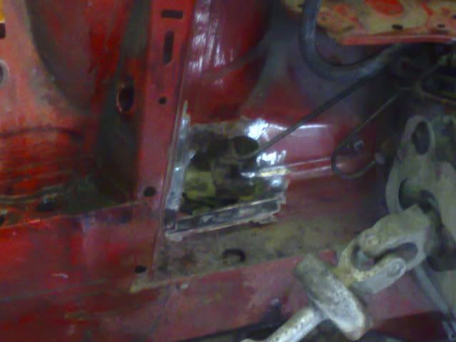

Glad that the welding is nearly done, just one more plate while the engines out, where the driver side brake pipe enters the engine bay, common place for a wee bit of rot to take hold. Looking forward for the test drive with the high comp m20 2.5, with a lighten fly wheel and late management and loom, should go as well as it looks.

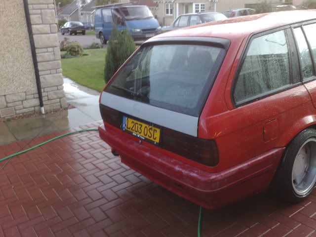

Fitted the tech2 rear bumper tonight and gave it a wee rinse as it was covered in dust from all the grinding.
It all ready to go for its mot and then the engine can go in before going to be be painted.

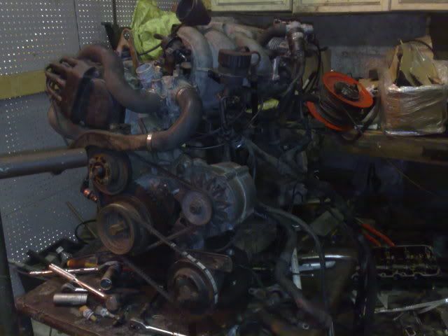

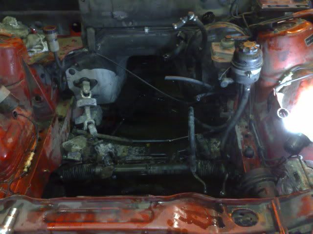

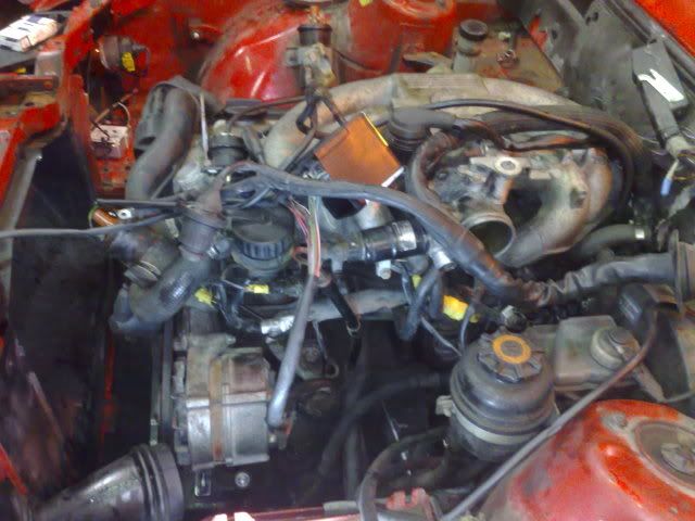

The engine has now been fully serviced with new timing belt,facelift water pump,tensioner,belts,brown/blue sensors and the spark plug, oil filter.sump gasket and rocker gasket will be fitted before its dropped in.
It has also had the facelift loom fitted woohoo
The flywheel is in the machine shop being lightened atm so hopefully should have it back for Friday.
shedrool83
Posts: 4395
Thu Sep 03, 2009 11:46 pm

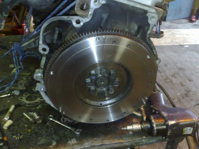

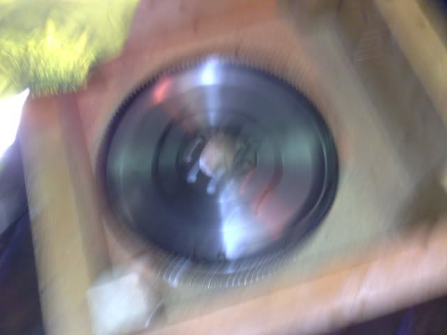

Tonight seen the sump gasket ,rocker cover gasket ,plugs fitted.Also the gearbox was split from the engine ready to fit the lightened flywheel.
Hopefully get the lightened flywheel tomorrow and get the 1.6 removed.
shedrool83
Posts: 4395
Fri Sep 04, 2009 11:41 pm
Bit more done tonight woohoo
We got the lightened flywheel and replacement clutch on and refitted the box c/w new slave and braided hose.
Also got the 1.6 oot
a wee bit to do in the engine bay tomorrow before we can drop the 2.5 in but with a bit of luck we can get it in and running tomorrow.

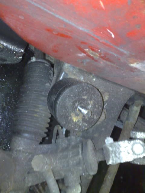

Final bit of rot cut out and plated

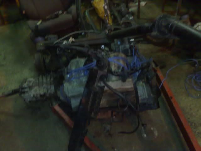

A pair of rs2000 engine mounts ready to recieve the lump
The lumps in woohoo
We're about an hour away from starting it still got the rad to fit and the oil and coolant to fill.

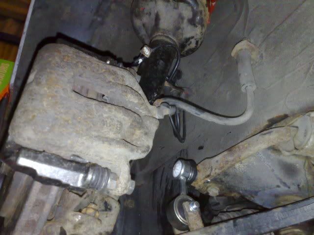

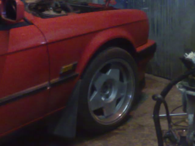

We changed over the front suspension last night to shorter boge gas inserts and gmax -40 springs.
Also changed the two rear front wishbone bushes and the droplinks.
The car now has a good stance and hopefully handles alot better now as one of the shocks,lolly pop bush and droplink were totalled .
Not much to do now just tack a bracket for the header tank and dme in place and refit the bonnet and hopefully it will be mechanically sound now as well as rust free.
We should have it completed by tonight depending on when i finish work.

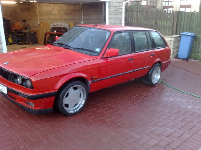

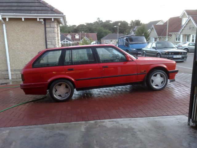

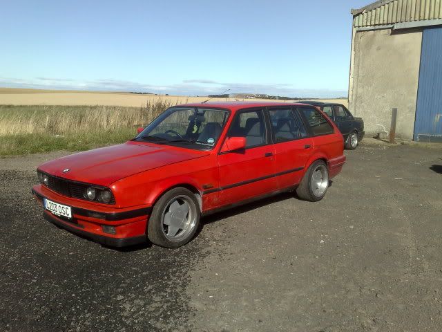

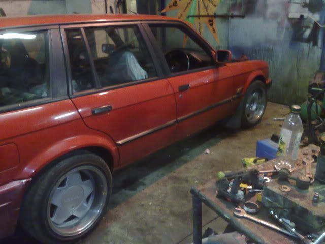

Finally its done(barr painting) woohoo
Got it out of the garage today and i'm over the moon with how it go's.
The suspension change seems to of sorted the handling issue.Still doesnt handle like the 4 door which is poly bushed but it handles ok.
For a 2.5 it can fairly shift pulls very well in all gears but 3rd is the best ;tounge; and sounds good to with the dtm scorpion back box.
The lightened flywheel has made a great difference imo as the 4 door wouldnt have a hope on a drag strip with it.

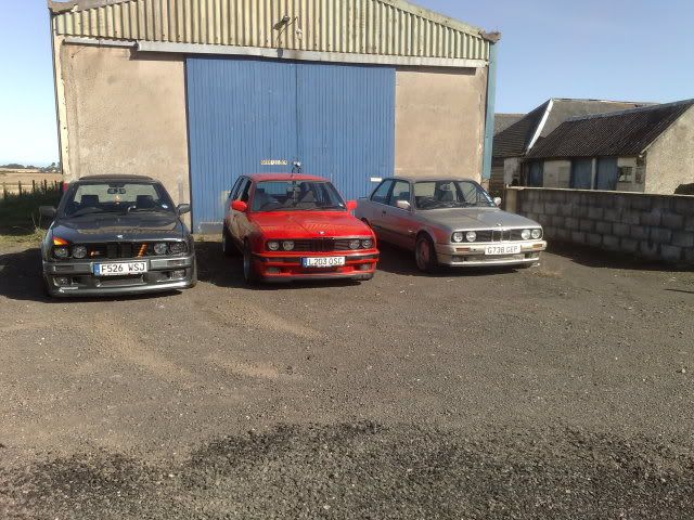

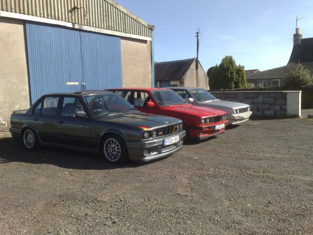

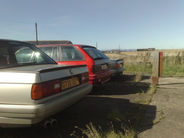

Anyway as usual some pics for your viewing pleasure ;popcorn2;

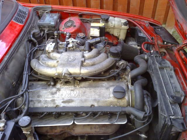

Engine bay just requires the metal bit that holds the loom to the bulkhead and the black clip the expansion bottle clips into.
Not a bad stance ,didnt want to go to low as it will get used more than the 4 door plus the wife is on the insurance LOL
Some pics of the touring,4 door and Gaz's 325 which is far from standard and has the best brakes i have had the pleasure to press on an E30(until baddaves are finished LOL )
I must say a massive thank you to Gaz(gcs325i) without his help this touring would have been scrapped.
So thank you Garry and i will be there all the way when you start your m50 conversion to pay back some of the free labour i'm due LOL
