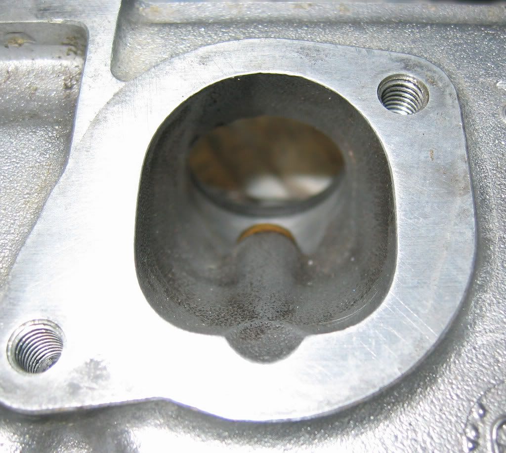

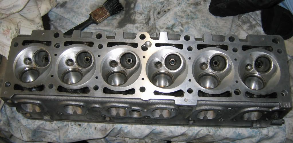

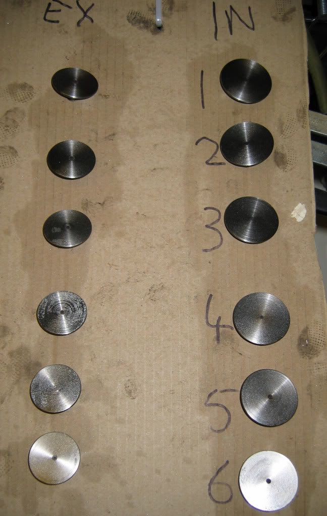

And so just for jhonno heres some more oily photos. Only they ain't oily. Today i've spent a VERY cold day in the garage cleaning bits ready for the parts when they arrive. I hate this job, especially the head but it has been worth it. One thing I can never understand is when people build an engine or replace an engine and leave everything dirty!!! I want the oil to stay clear between oil changes and my hands to stay clean when i work on it in the future.
I still want to lap the valves in to give them a nice seal (theres no sign of any burning so they should lap okay) but once thats done, it's ready to start reassembly, of the head anyway. I still have to hone the bores and sort that sump bolt out but I finally feel i'm getting somewhere.
More to follow VERY soon, starting with the valve reassembly etc.

You going to get the inlet/exhaust ports cleaned up Trevor?

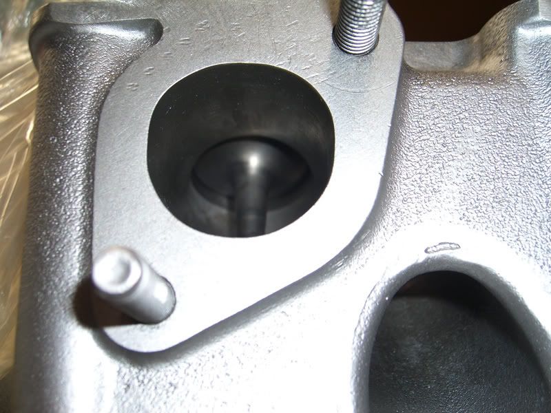

Jhonno wrote: You going to get the inlet/exhaust ports cleaned up Trevor?
Like this-
Why does this look so different to yours?^^^
Mon Jan 05, 2009 11:36 am
Like this-
Exactly like that!!
Trevor's looks like it was taken straight from the mould without being finished after..

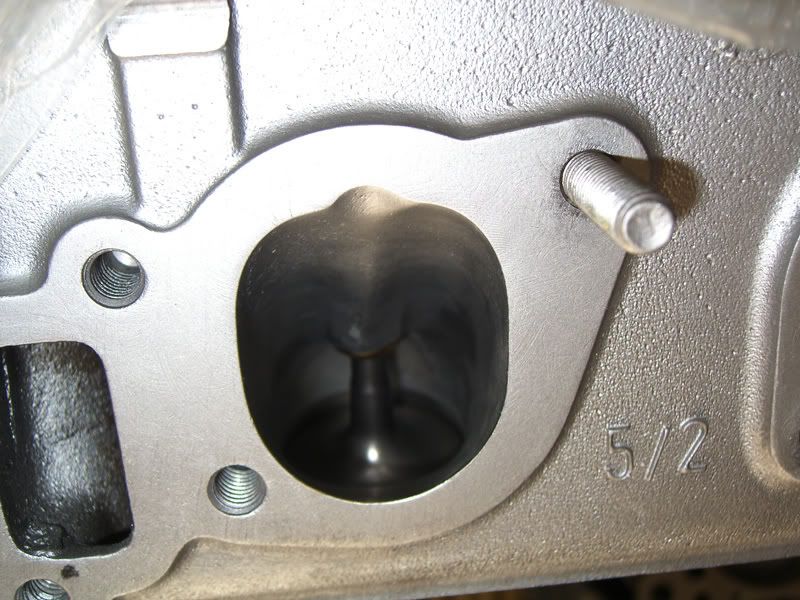

Did you get that done to the head Dave?
Mon Jan 05, 2009 11:39 am
S50 inlet shot for comparison

That does look the nuts Oakey. I may well have a go to be honest. Mind you it's damn cold out in the garage!!! What are the REAL benefits of the extra work though? Really..... There was an argument I heard some years ago that the polishing the ports actually benefits very little. In fact the opposite side of the coin was that rough ports were better as it created turbulance and therefore a better mixture 8O . And now here ensues a debate :evil:

B7 wrote:That does look the nuts Oakey. I may well have a go to be honest. Mind you it's damn cold out in the garage!!! What are the REAL benefits of the extra work though? Really..... There was an argument I heard some years ago that the polishing the ports actually benefits very little. In fact the opposite side of the coin was that rough ports were better as it created turbulance and therefore a better mixture 8O . And now here ensues a debate :evil:
Oakey's aren't polished.. They are still slighty rough, which is what you want, and what you are referring to. Yours looks like it was cast using pebbles, and left as done :)
Compare Oakey's to the factory finish on the S50 ports.. It is the same
The REAL benefits are probably feck all tbh :P Maybe 1bhp winkeye
An argument for smoothing the ports is that most tuned or performance cyl heads have smooth ports- ie Jhonnos pic of the S50 ports

See what you mean now. So basically, de-nib them?
Mon Jan 05, 2009 3:41 pm
Yeah, just clean them up, you aren't looking to port it, just smooth it
probably worth a few bhp and some torque, makes sense whilst the head is off etc 8)

The exhaust ports on my head are smoother than the inlet ports. Which is opposite to the standard head going by your pics B7. May be worth some consideration?
My head was done by MiniSport who I have been told by people, who have heard of them, that they are very good.
Posts: 15846
Mon Jan 05, 2009 3:46 pm
oakey wrote:The exhaust ports on my head are smoother than the inlet ports. Which is opposite to the standard head going by your pics B7. May be worth some consideration?
Which actually makes a lot of sense to me. Thanks for the pics. I'm going to bite the bullet.
That is how it should be again!
Smooth/polished exhaust ports as you aren't worried about mixing, just getting the gases out as quick as possible!! None polished inlets to help with mixing and therefore combustion
