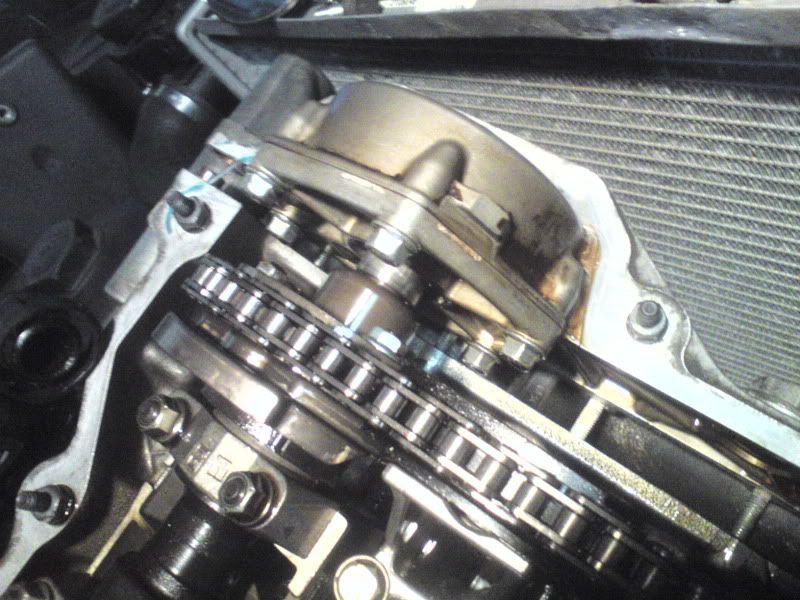

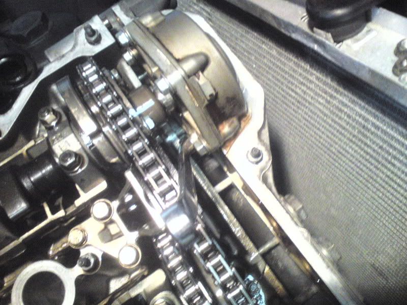

Took the cam cover off this afternoon and as suspected the exhaust cam has slipped on the sprocket and is retarded, at least 5 degrees, inlet is still bang on the mark with the crank.
Will be rebuilding this with loctite, never known one to slip before :?

iirc the torque setting isn't very high on the nuts at the end of the cam. From when i had the head off.
Wed Jun 06, 2012 6:54 pm
You might want to give them a bit more if you followed the torque settings!
Thu Jun 07, 2012 10:41 pm

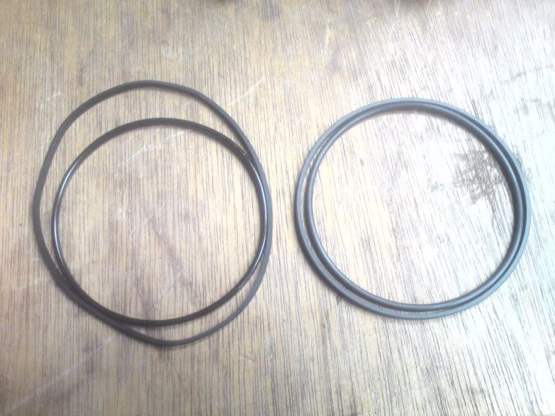

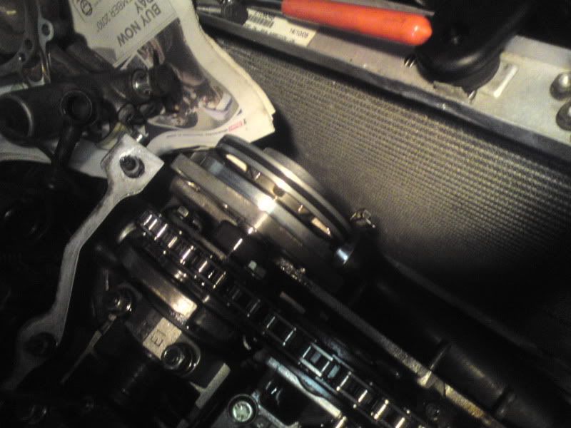

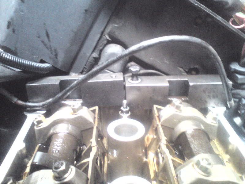

Swapped the vanos seal and put the timing right today, thought I would have a go at monkeys method, straight forward and doesnt affect timing.
With the vanos unit un-bolted there are only 5 bolts to remove, most difficult one is at the bottom
Still plenty of room to get a proper spanner on though
Rags at the ready as the unit is still full of oil, but once removed the job is a doddle
Old stretched outer and hardened inner Vs new
Didnt get any pics of the exhaust sprocket but its now bolted up to the cam with loctite and an extra tug on the cam bolts. Will wait for tomorrow before starting to give the loctite chance to harden

Floating sprockets Lee, its just the clamping force of the bolts that holds the timing.
No need for standalone at all, nothing wrong with the Siemens on these and they are very exploitable in the right hands.

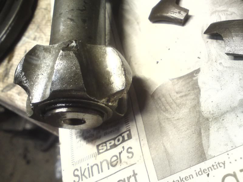

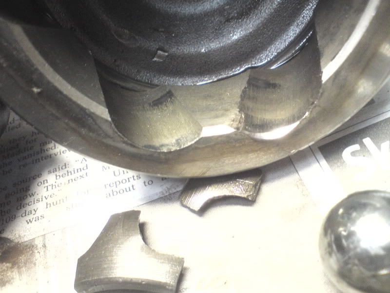

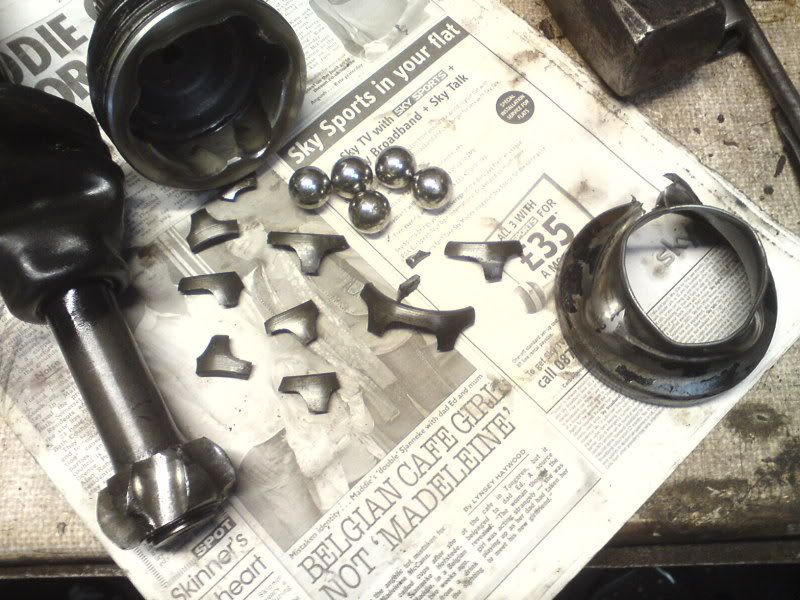

The left outer CV joint failed yesterday at Santa Pod, so I took it apart and cleaned it a bit today to see the damage, right mess! :o
Chewed up good and proper, will be looking for either a pair of new outer CV joints or one very good second hand to replace with.
Thanks to Andyboy for driving me to the scrapyard for a replacement driveshaft :thumb:

The yellow drag prepped E30 also did a CV joint on the run before mine, he said he'd done two in two months, so it sounds like a bit of a weak point in the drive line, better than a broken diff though!
When we got back from the scrappy there was an E36 compact stranded, also broke a CV.
Will be taking a spare or two next time I go drag racing :D

It's the launching that kills of the shafts. Saying that I've done more diffs than shafts
