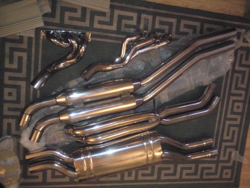

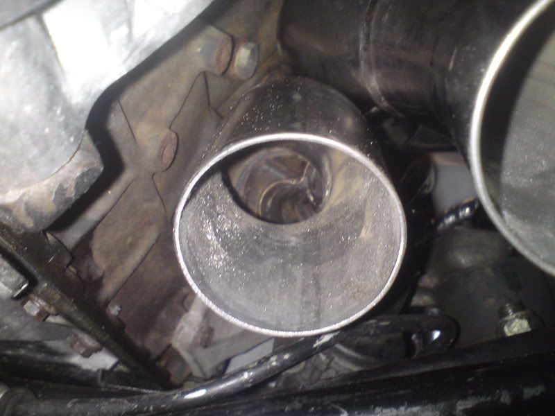

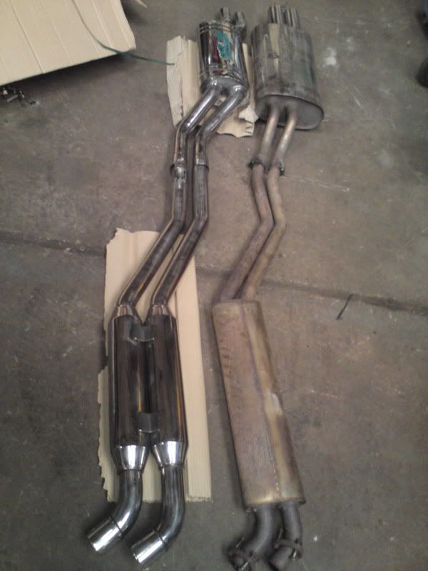

About October time last year the exhaust had a bit of a blow, turned out the Scorpion middle box had split open for some reason, so after a few phone calls and a workshop visit I had a large box land on my doorstep which contained this -
Big thanks to randomdave for his help 8)

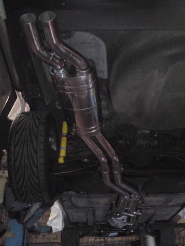

Its a Fritz M50 exhaust, twin 60mm pipes and straight through boxes, perfect for 3200cc :D

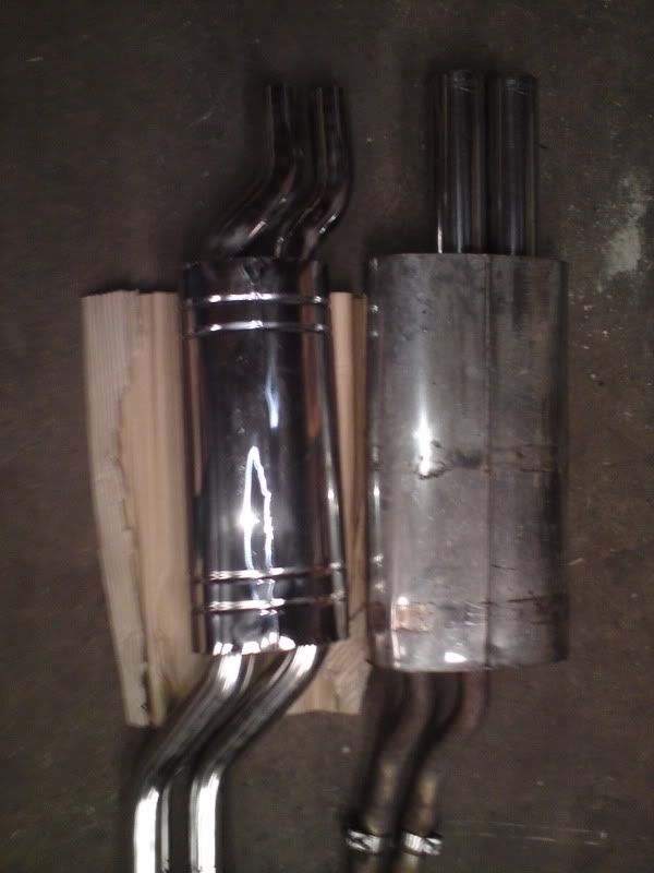

Next to the 325i Scorpion system
Backbox is smaller/neater which I like very much due to the high valance of the chromie
Internal examination shots

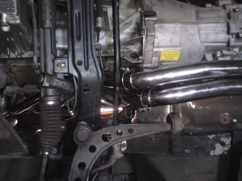

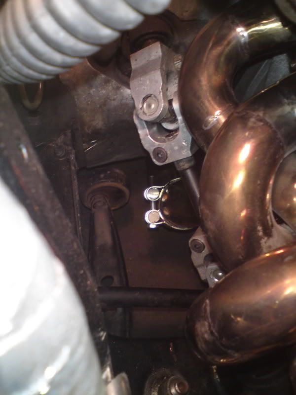

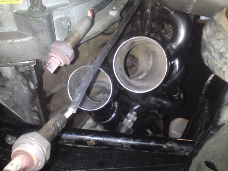

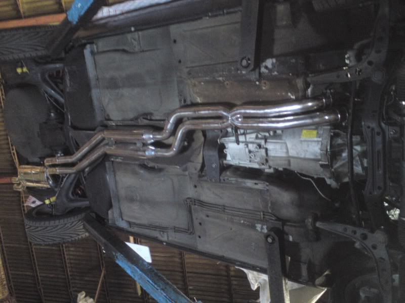

Fitted

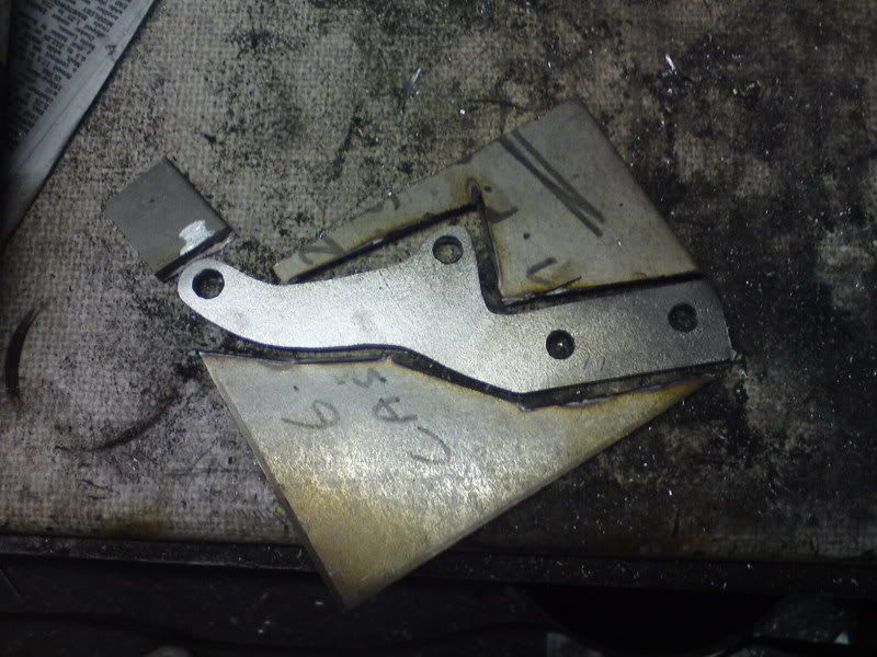

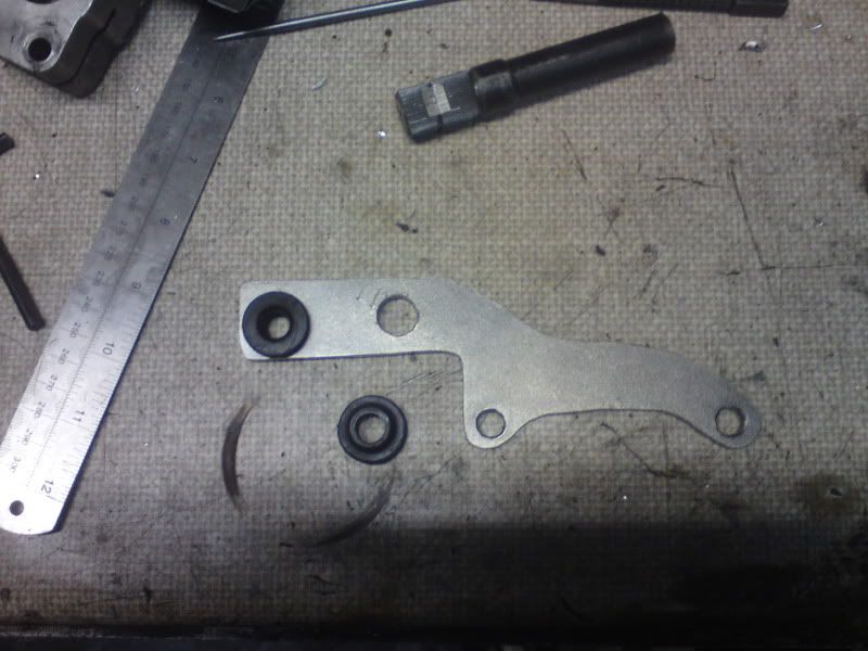

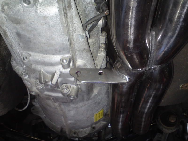

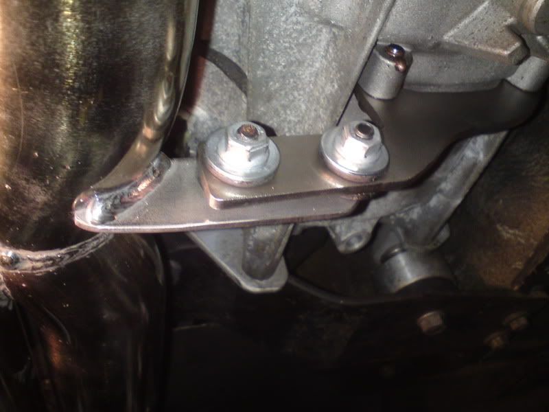

There is a bracket on the frontpipes for hanging
So I chopped up a bit of stainless plate
And cam cover bolt rubbers
to bolt it to the gearbox

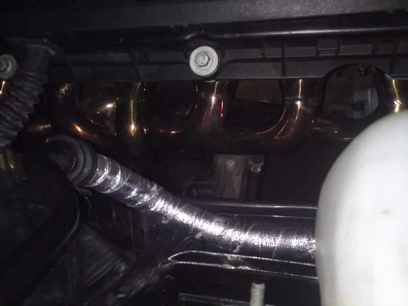

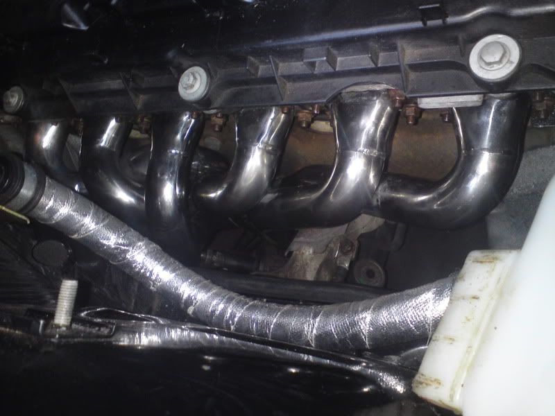

Manifolds in their last shade of silver
After 10 minutes of engine running
They are a nice gold colour 8)

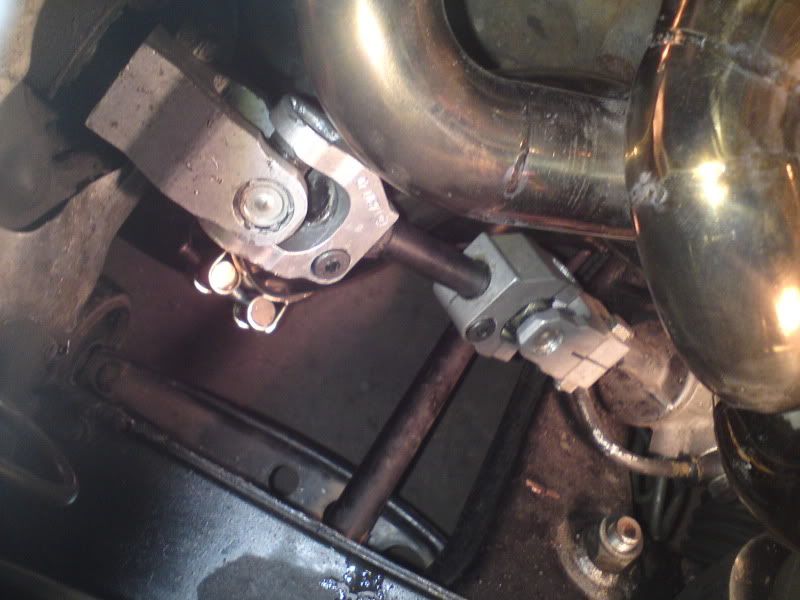

Bolted a proper linkage in there too
Its louder/more anti-social than the Scorpion 325i system, but at full chat you just have to smile! :D

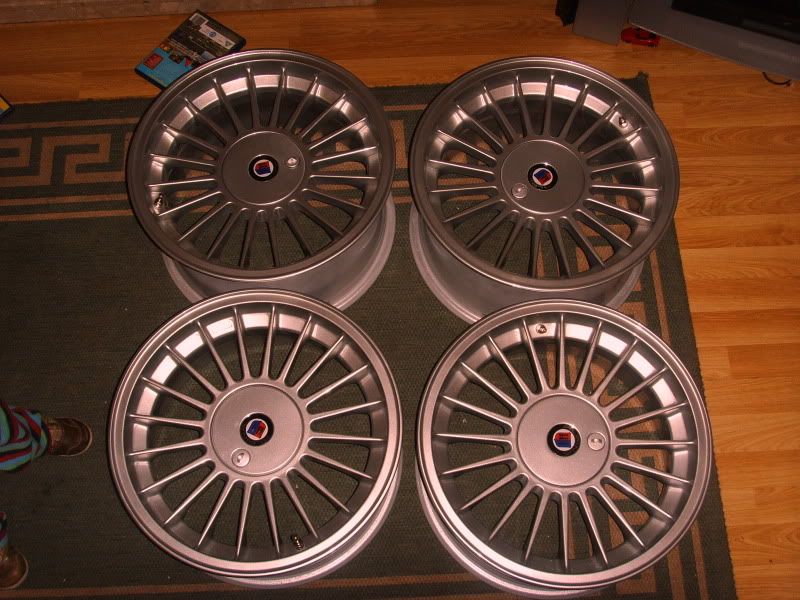

Now I have a matching Alpina engine and ECU I couldnt resist when these matching, freshly refurbed rimz came up for sale
But will they clear the brakes? 8O
Mon May 07, 2012 12:08 am
You might find the Alpinas won't clear the brakes Dan :( as the internal radius is way smaller then the Hartge.

The Alpina spoke/drum radius is indeed way larger than the Hartge - only about as much (4-pot caliper type) room as the 15" BBS.
You might get away with sliding calipers, not sure...
Mon May 07, 2012 12:26 am
I'm sure i measured you calipers on my alpinas with the pdf drawing, and it was tight with your calipers. :?

Yup - total PITA, 280mm fits but 298.5mm doesn't...and most 16's are fine for 300mm-ish or more.
Alpina seem to have designed them to clear the Alpina brakes and not anything else (which I suppose is good business sense in a way, but not useful to us years later!).
