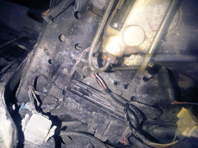

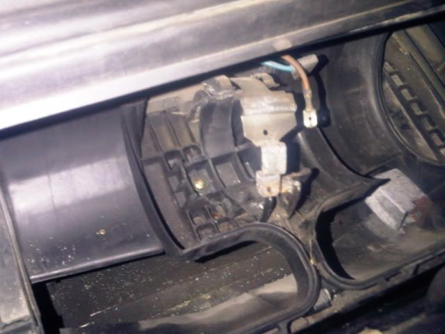

Removed coolant reservoir - currently soaking in hot water & detergent - its fooking horribly filthy inside - I may have to replace it :x
HLWW on this side not even connected up :roll:

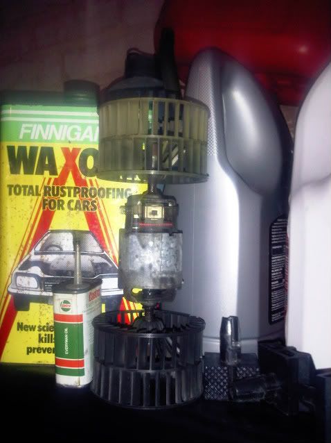

decided to get the blower motor out and properly lubed :eek: as when I did it last time I did it in-situ with WD40.
Stood on end, bit of oil down the bearings
Spring clip was a pig - not looking forward to getting it back in :x
Gonna get the vac in there before it goes back together and then douse it with aerosol waxoyl.
Cable tidy very rusty - wire brushed & smoothrited from the never-ending tin :D

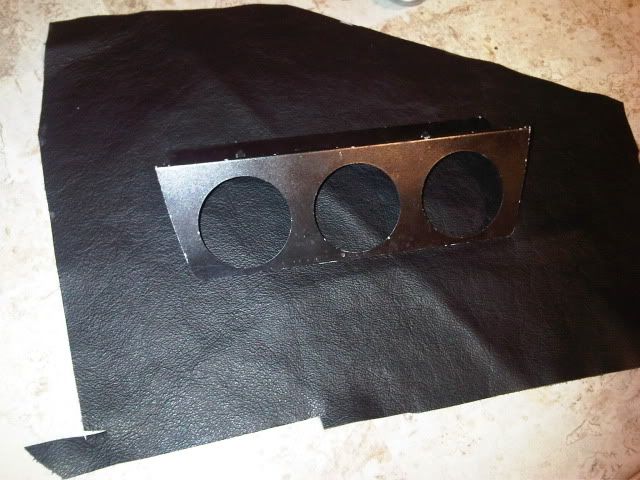

Going to the trimmers tomorrow to try and scrounge a black leather offcut & some foam backing.

That clip for the blower motor goes back on much easier than it comes off :wink:

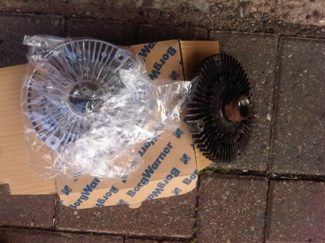

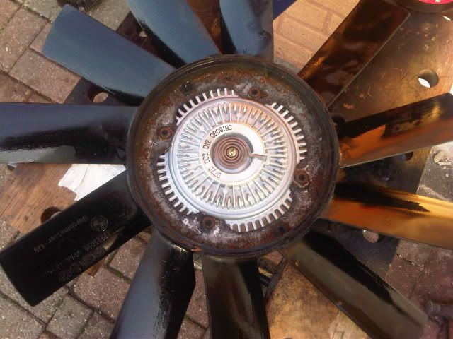

Fitted new viscous :
No overheating issues with the old one but the action felt very graunchy compared to the smoothness of the new one.
Old one is a Sachs stamped '97 so looks like its been replaced once already and was due again anyway.
Refitted the blower motor which I removed and oiled up last week - spring clip was a lot easier going back on than it was coming off - motor is much stronger now 8)

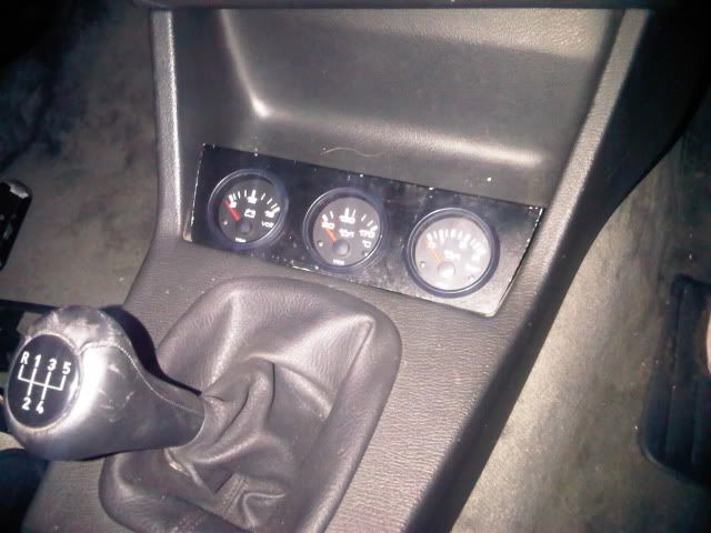

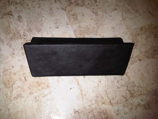

Then tackled the gauge pod
Covered the upper surfaces first in a thin layer of foam-rubber, then the leather :cool:
Going to leave it overnight to completely dry and then cut the holes out.
Looks like I will have clearance issues with the carpet behind though - may have to slice out a square under the hole to allow room for the backs of the gauges & wiring :(

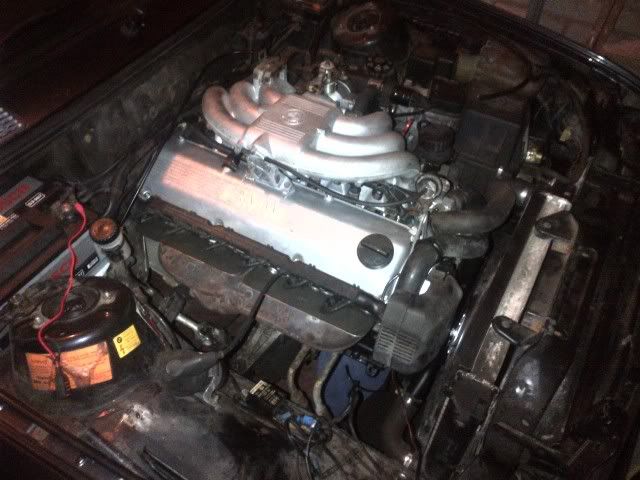

Well - she lives :twisted:
town325i came round this afternoon and we got it all back together.
Had a right fookin ballache getting it to run - the cause - plug leads on the wrong way :banghead:
I swear every fookin time I swap them over in the order they came off and theyre never fookin right first time :x
But - it now starts and runs as it should bar a slight misfire at idle which I'm hoping a good blast once its taxed & road legal should clear.
Top end is now nice and quiet just the ticking of the injectors which I hope will quieten down as they bed back in.
As predicted bleeding the system was fun - did get some air leaks despite being careful to fill it slowly but all sorted now - heater hot, needle on gauge where it should be, hoses as they should be 8)
Now that I can start it and move it before I put it back together properly I need to get it down on the road whilst the bonnet is still off and TFR/degrease the engine & bay and then jetwash it - maybe later this week - although I really need to get some proper money earning work done soon :o:
