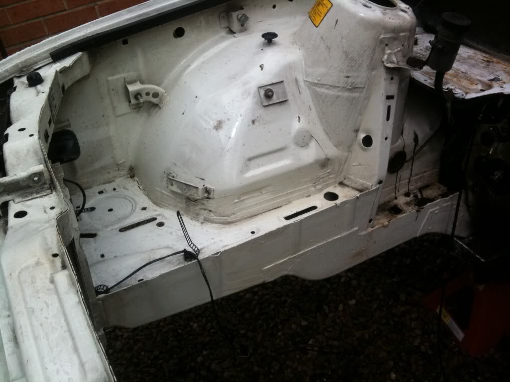

Right managed to get an hour off so got a little more done. :D
Crossmember, shocks, bottom arms and roll bar out
Then as is my way a little clean. (still needs a T cut) :o:

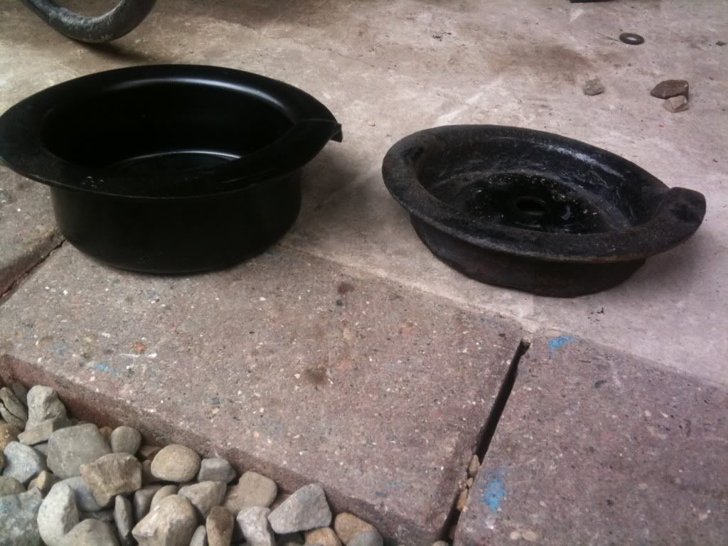

Then I fitted my -15mm tophats ready for the re build
That's about it put all my new antiroll bar parts in the van with an E30 rack, Z3 rack, rollbar, and crossmember. Should have the complete unit ready to bolt up when my steering UJ's are back winkeye

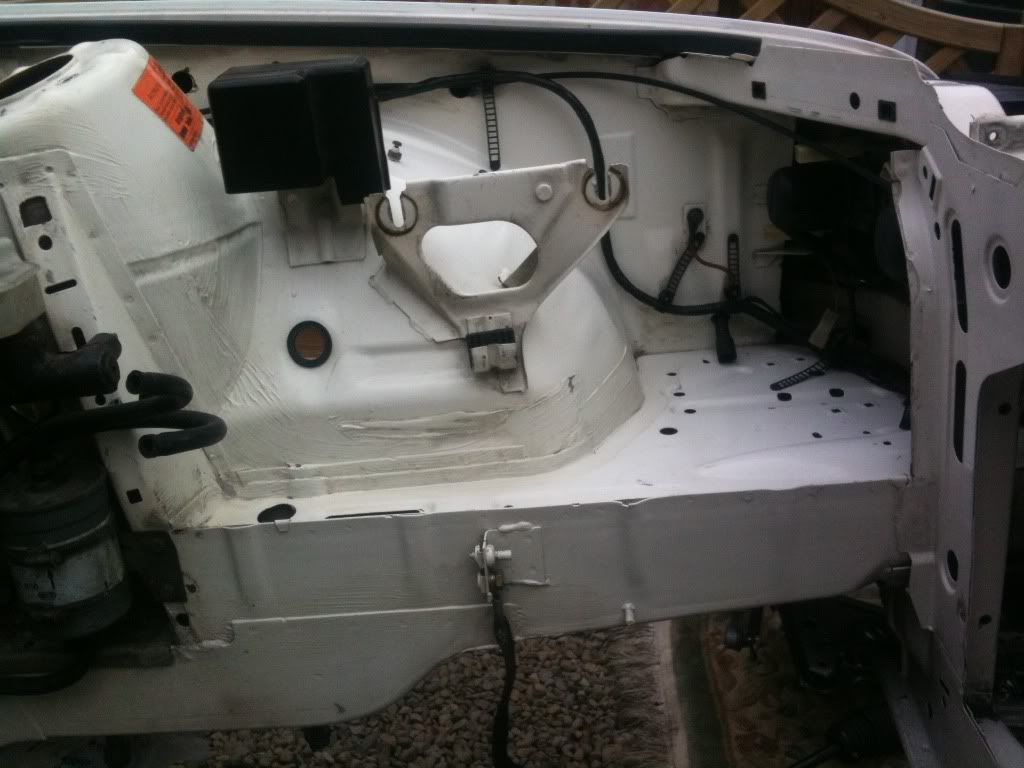

Look's good under the bonnet so there is no nightmares to fix. Just bolt shine bits in and we are away. :D

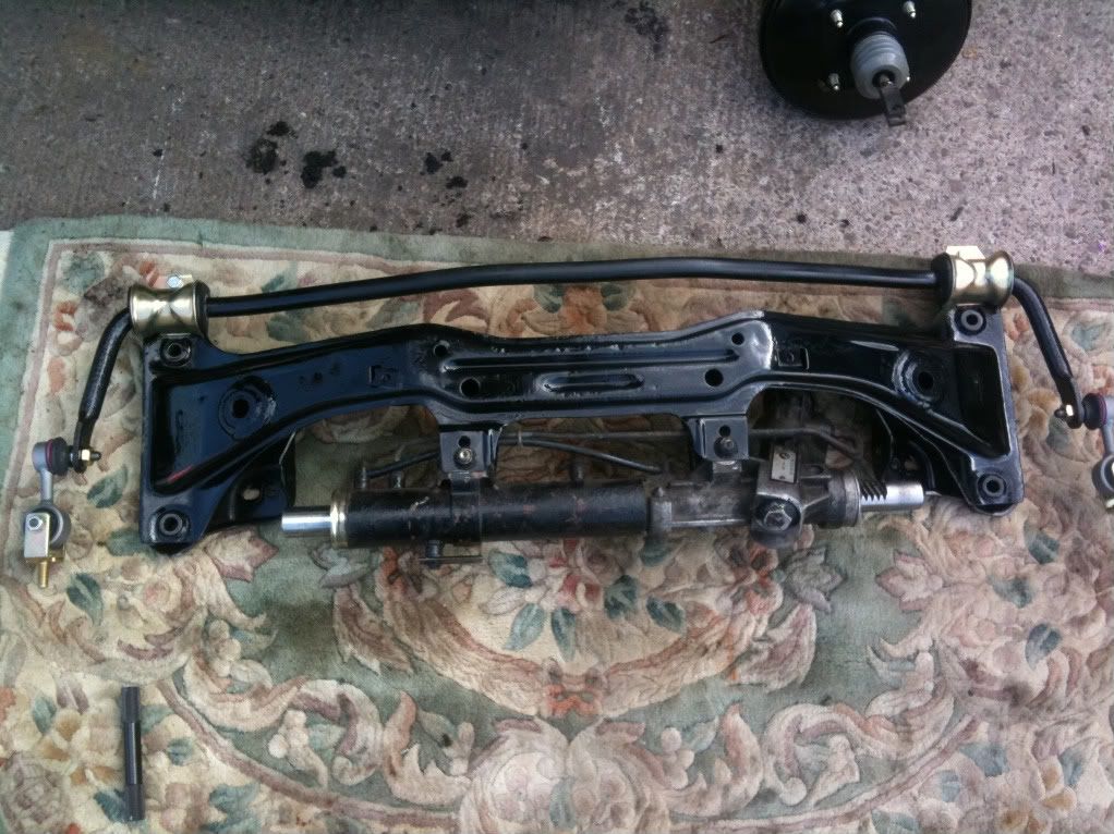

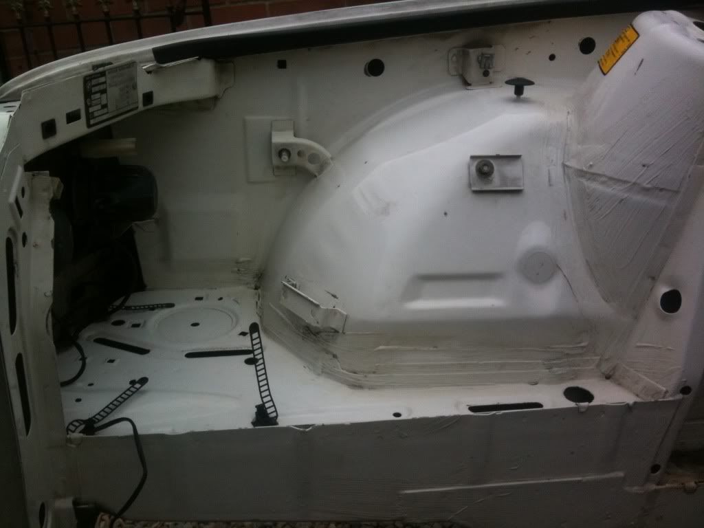

Right a quick snap for you. Been busy at work but have nearly sorted crossmember out. I think it will be back on it's wheels thursday. New bottom arms, trackrods, M3 bushes, lower tophats and crossmember DONE
Polishing innerwings is for homo's. I started tonight and gave up after 15mins. Will have to finish now though :cry:

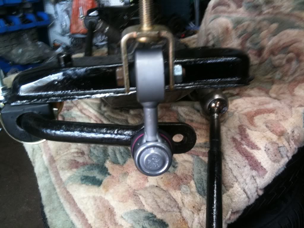

Tue May 18, 2010 9:51 pm
That ARB is not in keeping with CR24v rules brother :)
Tue May 18, 2010 10:19 pm
Needs re-drilling to come into spec :wink:

Re drilling Dan? How far back from the first hole?
What they like to drill?
Lee I will raise the spec on them as soon as ican be bothered. Uprated are on the list. It's a long list though winkeye
Wed May 19, 2010 8:05 am
You can grind the bar flat but I just drilled it as far back as possible, they are easy to drill TBH, I remember one of the M30 girls whining about how difficult it was to drill but you know what theyre like :gay:
No need for uprated, 21mm bar with an extra hole each side is enough 8)

Thats good enough for me dude. Thats getting done today. Wish i new that before i put the crossmember together :cry:

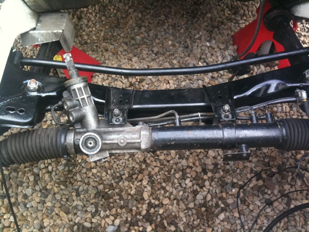

Modified ARB
Why anyone would find that hard I don't understand. That's a 10 minute job including removing and refitting the tie bars

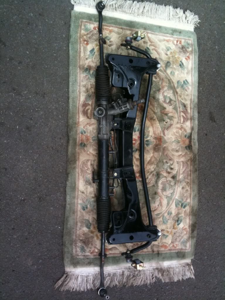

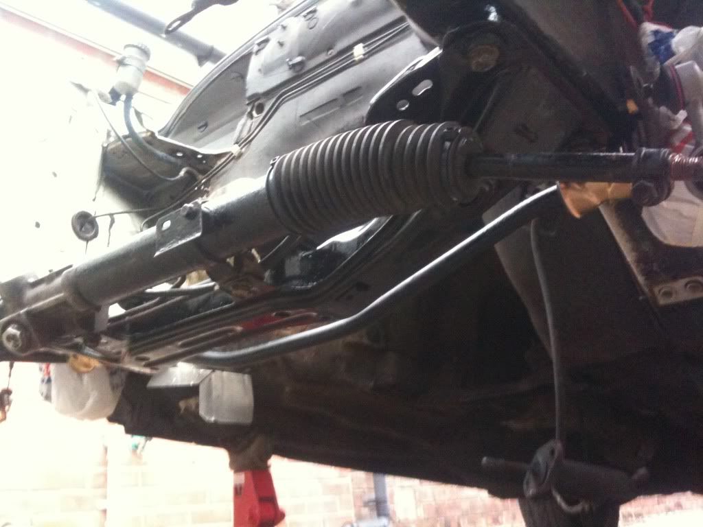

All built up with Z3 rack ready for fitting tonight.
I will finish G3ing under the bonnet and have it back on it's wheels tonight/tomorrow.

Got an hour free tonight when I got in
Finished polishing inner wings etc

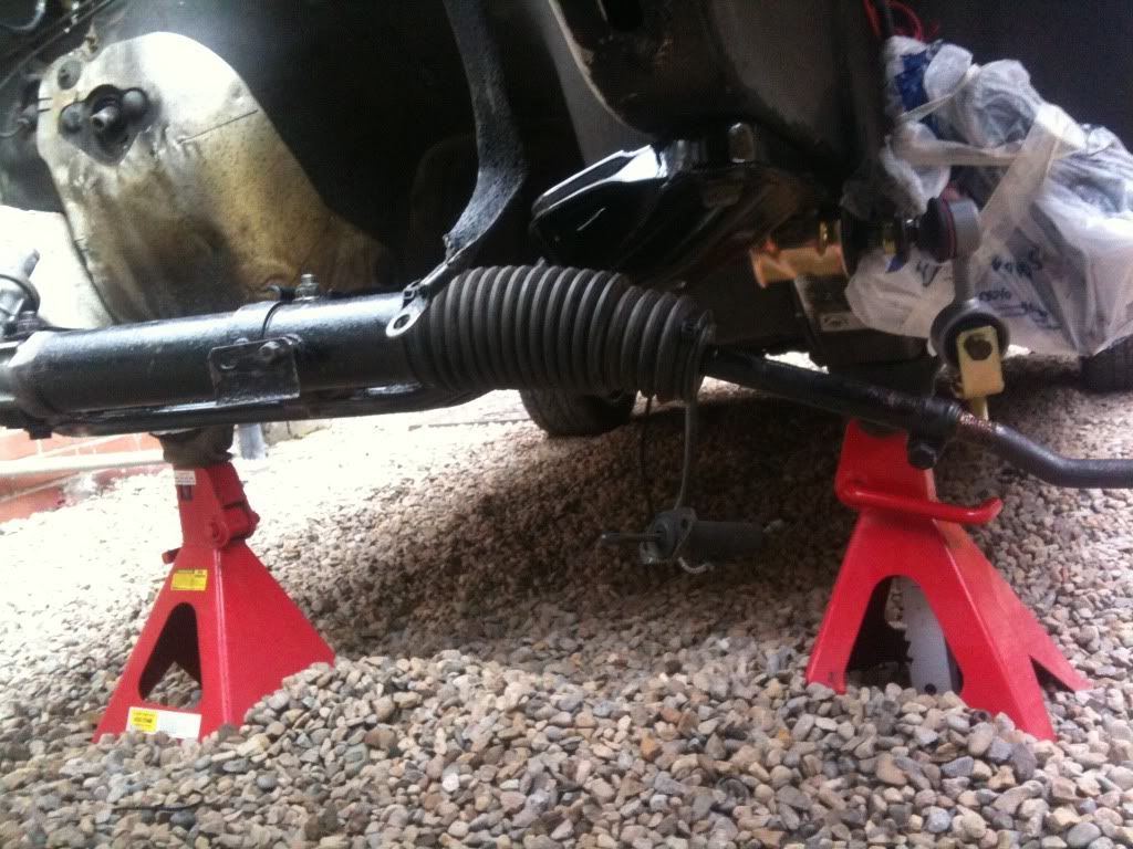

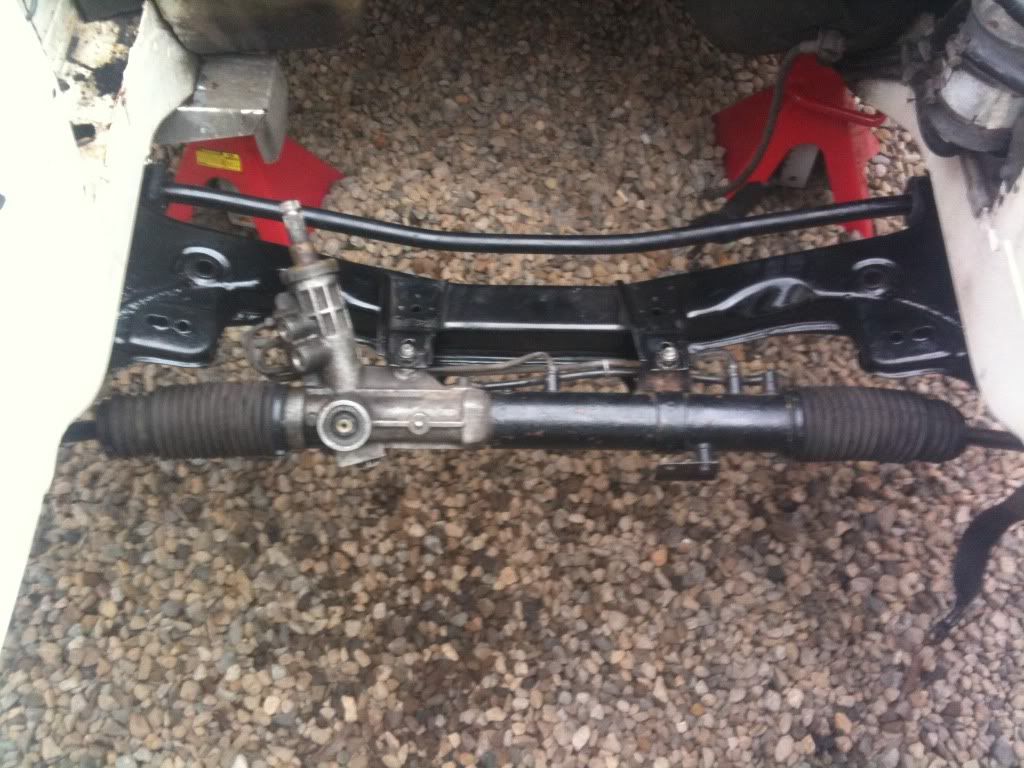

Fitted Crossmember
Wed May 19, 2010 8:24 pm
You got the rack in the wrong holes bruv 8)

Front holes ftw no?

can i ask what the reason for drilling the anti roll bar is. i am currently putting a m52b28 in my e30 and really admire the work the three of ye do especially lee the poor bastard i nearly cried myself when i heard he crashed it

The reason for drilling the arb is to stiffen it. It's something I had read about but Yoda said I had to do it so it got done. :D

Dan I fit the Z3 rack in the front holes on the red car. As that's where the E30 linkage works. Is it better inthe rear holes with your linkage?
Wed May 19, 2010 9:42 pm
Reduces the length from the pivot, therefore makes it stiffer
Dez, the manual rack mounts in the front holes, power rack in the rears 8)

Right mate I will sort it tomorrow.

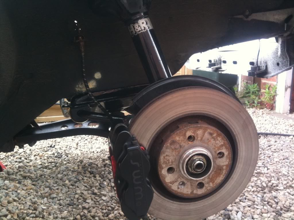

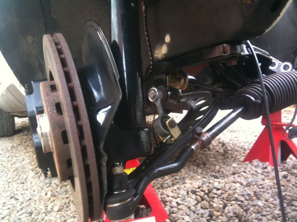

Been out this morning and done a bit more.
Dan said rack in the back holes so in the back holes it went. Then onbwent bottom arms etc. WMS and disc's back on and back on the floar. :woohoo:

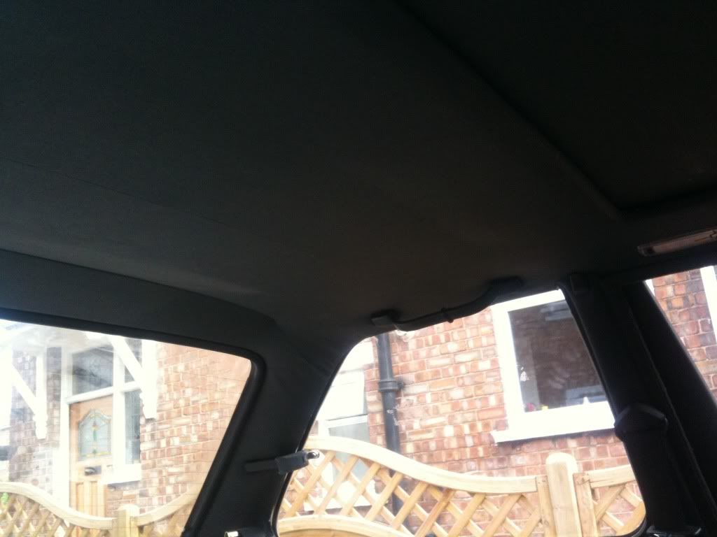

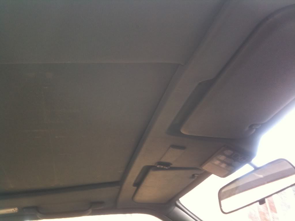

Firstly can I just say a massive thank you to Beardymat. What a fooking hero!
9.30 this Sunday morning up here tools and black headling in hand ready for chromie rapage.
It's been high 20's all day up here and it's been graft for him.

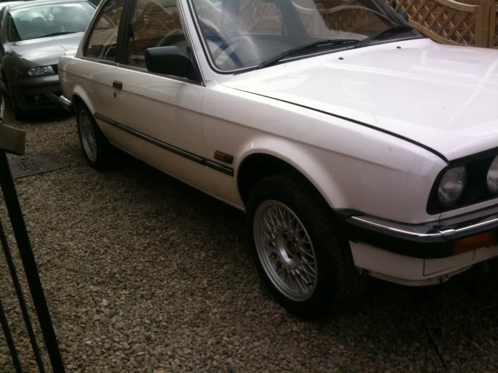

Fit the black headling and visor pannel out of busters S50'd sport. Also got rear pop outs now. Electric sunroof too. Check out my options
Also fit new chrome around windows, what a difference it's made. The car is minging and the wife is twichy so can take pics of chrome.
I phone pics arnt the best but this is all I have.
Thanks to our Lee for popping up and lending a hand too. I am over the moon with the difference.
Thanks Mat. What a top guy nice to meet you :cool:
