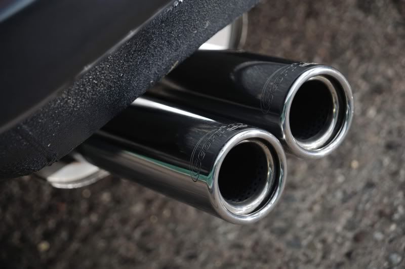

Looks great. 225 tyres give it nice stance. The only thing is I think slash cut exhaust would look better.

The small Tech 1 wheel I bought will be going on it Dave
Im not that keen on the angled tail pipes TBH, I was considering a Scorpion with the STW tailpipes but I like the Le-Mans pipes for now

I think the Lemans pipes look fine on it.

Dont look bad for 8 year old tailpipes do they! Its the same system I had on my old 4 door which I did over 50k miles in with the non vanos M50

the older Le-mans pipes are far better than the new one's,DanThe wrote:Dont look bad for 8 year old tailpipes do they! Its the same system I had on my old 4 door which I did over 50k miles in with the non vanos M50
my M50 blew the stuffing out of my new Scorpion back box

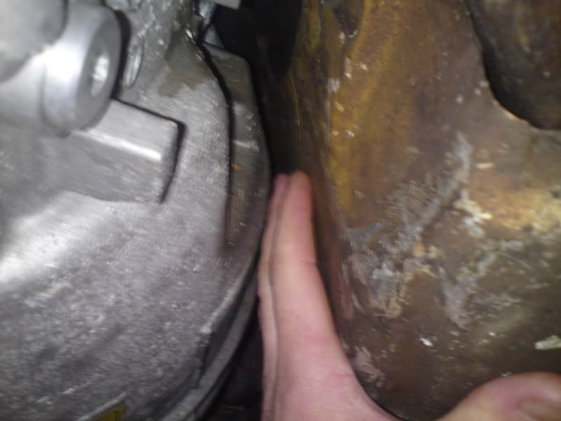

Today I fitted some AKG engine mounts which didnt turn out to well...
Will have to see if they settle a bit, if not I will modify a subframe to use some landrover mounts.

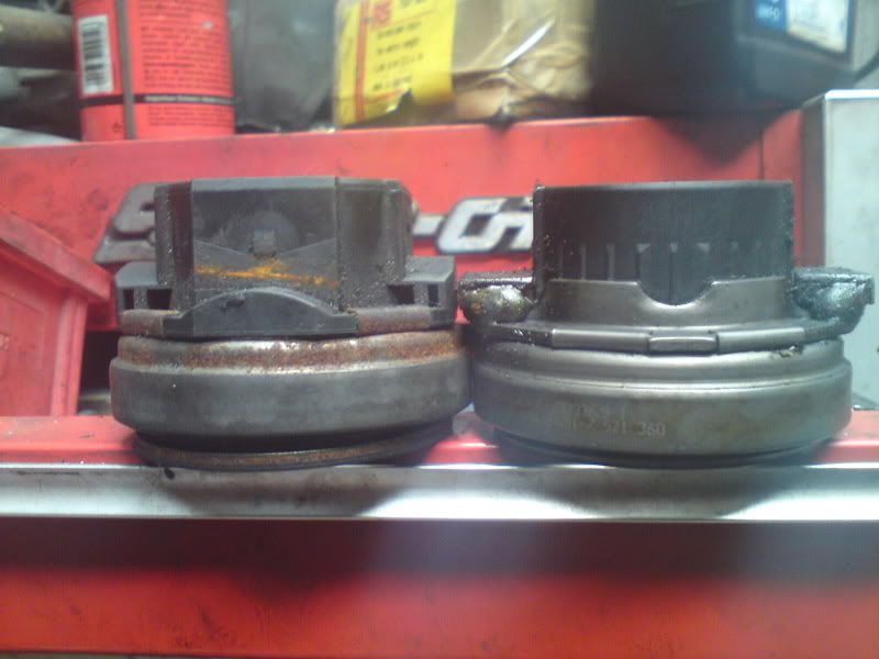

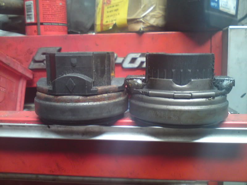

I managed to get hold of a late release bearing which is fantastic
Here it is next to my modified bearing
Ive fitted it in its highest setting and with the box back on there is only the slightest amount of slack between the fork and the cover plate, less than a millimetre, its perfect!

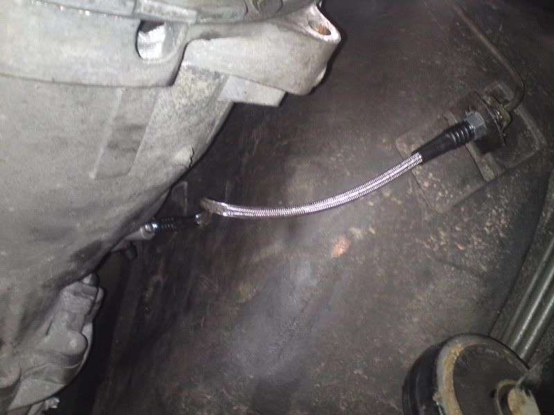

Also fitted a braided CR24v-tm spec clutch line

One last pic of how tight it is in the tunnel
