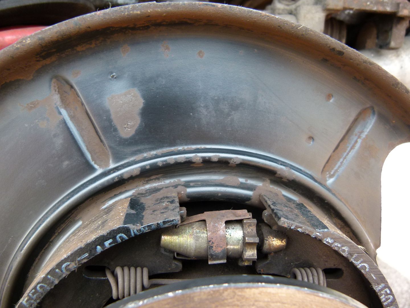

Update time peeps!
Got to replacing the diff yesterday as i dont think the original small case 2.0i Auto diff was up to the job
lol
What it is being replaced with:
And in!
And while i was at the rear i decided to freshen up the brakes..I considered painting the calipers but not planning to keep this brake setup for too long so didnt see the point!
Fresh backing plates
Just waiting for the front springs to come then the front end will be overhauled aswell
And in!

Im considering it as i used to recondition calipers in my old job and im no stranger to them, i was just thinking more of a straight swap..Speedtouch wrote:You could always get a caliper repair kit. Try soaking the caliper in vinegar for a couple of days - this de-rusts them quite nicely, and may free off the piston if it's stuck...
But now im going to be waiting for arms to get delivered (the arms are much cheaper from CarParts4less) i might aswell look into it

Anyway in the meantime these will keep me busy!
got the m3 bushes to go on the arms too and i thought while im there might aswell get the A.R.B links too!
Like my dad always says "If your going to do something do it properly or not at all!" Thats my motto in life lol
