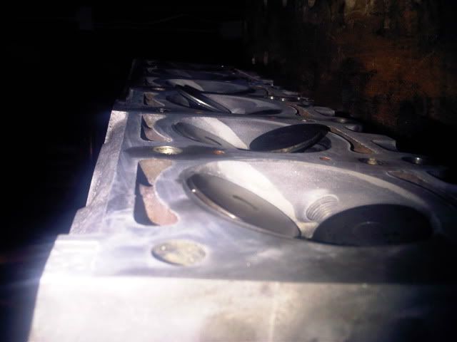

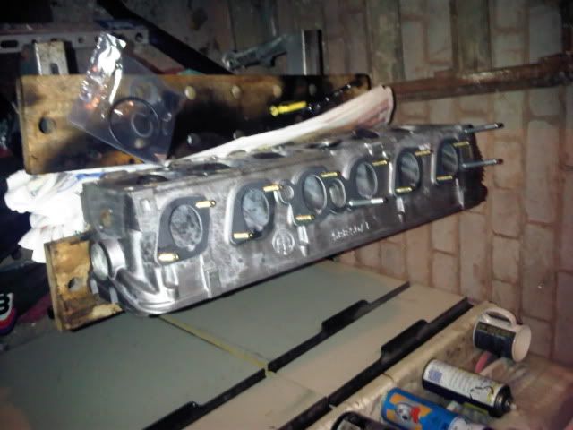

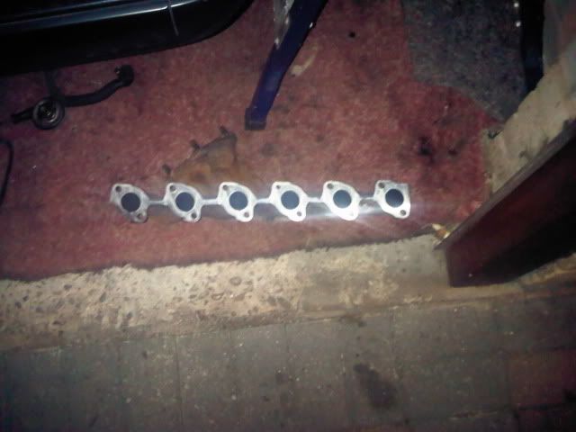

Head is done - told me the had to skim it but didnt have to take much off which is good.
Apparently its cleaned up very nicely so looking forward to seeing it.
Exhaust manifold apparently bent like a banana but they have now agreed to sort it despite saying it will be a pig to do in view of how much they will have to take off it to get it back to flat.

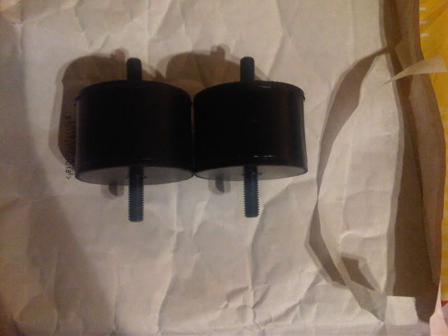

Ford RS engine mounts from Burton - we'll see whether these are any good :)
They can't be any worse than the floppy originals that are on there now :eek:

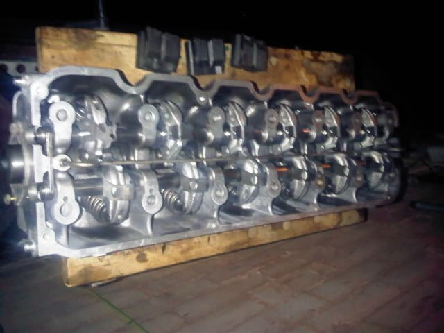

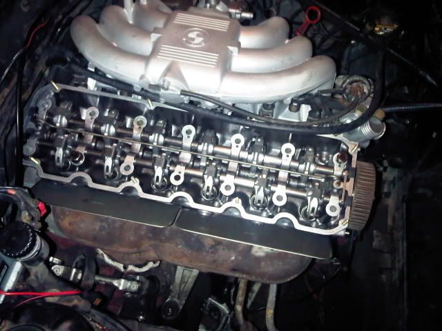

Fresh !!
And a lot cleaner than it was a few days ago !
New febi rockers, new stem oil seals, guides sorted, light skim and cleanup. Cant wait to get it back together.
Sorted exhaust manifold - no longer banana shaped :eek:

Good stuff their Rob, how much did the head cost to get sorted? I've got a spare head sat in my brother shed I ought to do something with.
Looking forward to seeing the vapour blasted parts :cool:

The machine shop work which was basically to strip, clean, pressure test and skim the head, sort the broken studs, sort the valve guides and then put it back together with the new rockers & stem seals I supplied was £155 then another £35 to get the exhaust manifold back to flat. That was a "cash" deal - if you want to pay by card it has to go through the books so would be 20% more with the sodding VAT.
Using the same guy diddler went to for the soda/vapour blasting.
Although he did say he's done a few m20 rocker covers and they don't always come up brilliantly - but its got to be better than it is now :mad:

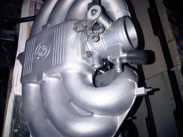

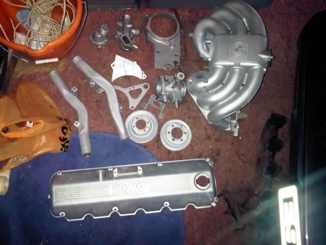

Collected my soda/vapour blasted bits :
Inlet has come up absolutely superb :cool:
Satin black
Fitted up with brand new BMW studs & Nuts
Throttle body coolant pipe delete option 8)

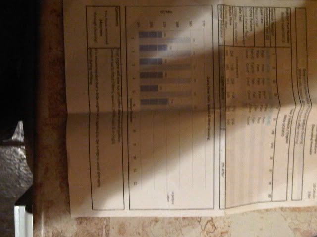

Injectors back from injectortune
They were pretty fooked beforehand by the look of it 8O

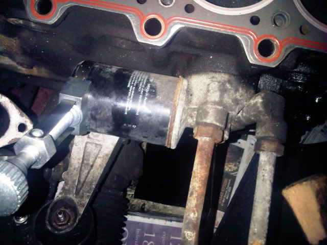

Also fitted my new engine mounts and the steering coupling from the Bronzit - another MOT advisory sorted 8)

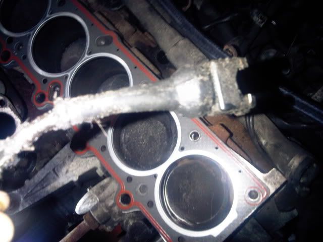

Cleaned up the face of the block pretty good - just need to make sure the pots are spotless before the head goes back on hopefully tomorrow :D

Well impressed with the soda/vapour blasting - Throttle body & inlet are now like new :cool:

£80 all in
Not that cheap but a lot less fookin about than trying to prep and paint it - and better results IMO - would never have got the throttle body that good by normal cleaning.

Cracking turnaround from injectortune - posted recorded delivery monday night - done and back to me Yesterday :thumb:

Don't know about lacquering it - as I understand it they were bare alloy from the factory ( apart from that horrible yellow factory wax ) so just gonna try and keep it all as clean as possible.
Kedge
Posts: 7698
Post Fri Jan 20, 2012 8:49 pm
Right, that's it. My throttle body is getting this treatment!! :cool:

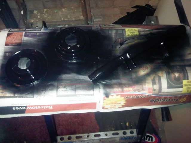

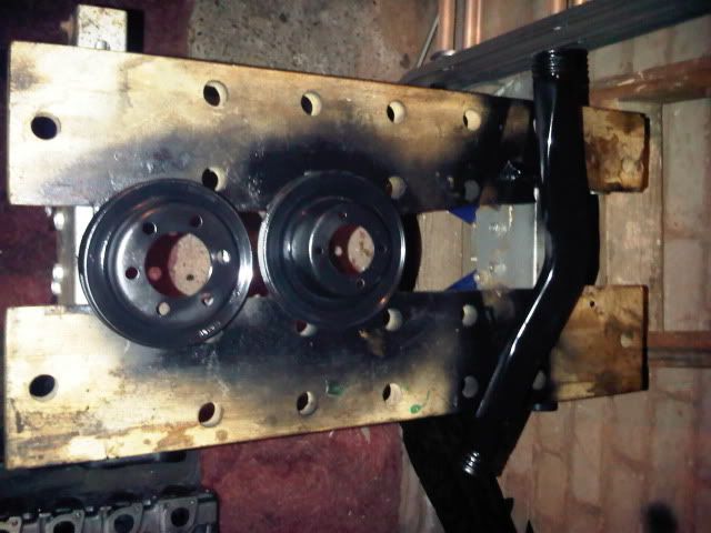

Started today by giving the pulleys and front coolant pipe a second coat of satin black - these are now looking great and ready to go back on :D
Then dropped the horrible cheapshit 20/50 tar out of the sump :evil:
Genuine filter but you would never have got this off with a hot manifold in place it was that tight - would have been a fookin screwdriver through it :twisted:

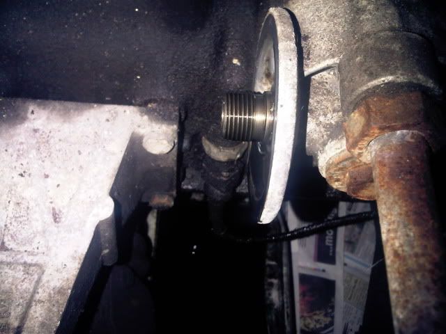

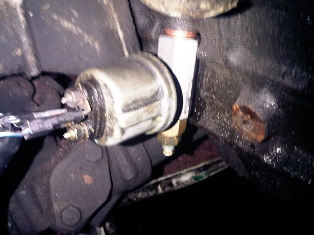

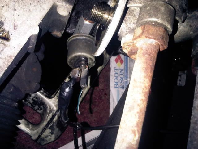

For people following the VDO Gauge thread this is the OEM sender - ideally you need a 24mm cranked ring spanner to get it off
This is the OEM plug to it - unfortunately this has to be chopped and fitted with a standard spade connector to fit to the VAG pressure sender
I've chopped it and left a bit of wire free so it can always be grafted back on and the OEM sender replaced if necessary

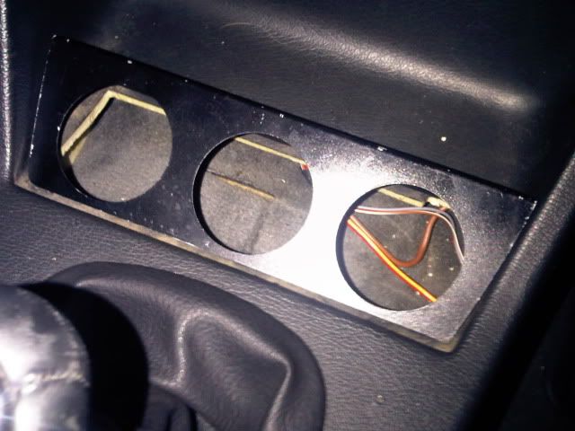

New VAG Pressure/Temp setup
Just got to run the sender cabling via the existing looms and tidy it up now
Inlet back on - head in place but stopped before bolting it down today.
As I don't smoke I don't need an ashtray and this saves me cutting the OEM console.
Just got to get a piece of black leather to trim it with before the gauges go in :cool:

May be an idea to do the 320i upgrade and delete that un-needed oil cooler!
Make oil filter swaps so much easier... :D
