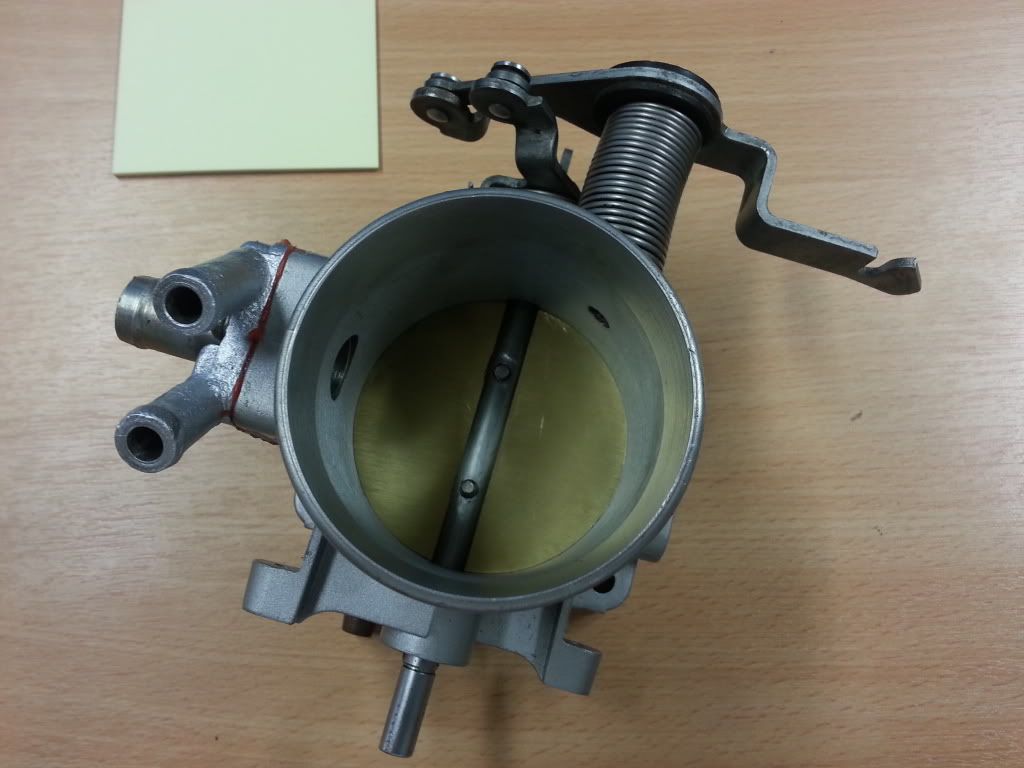

New shiny throttle body arrived today, thanks again to Maggspower! :D
Just waiting on the gaskets and seals for the inlet to arrive, and new caliper carriers.
Found a local German car specialist we deal with that offers live remapping so as soon as the cars rolling again I'll be taking it there to see if they can remove the mystery ECU box.
The TPS - is this adjust by loosening the screws and twisting the switch until it clicks soon as the throttle is depressed?

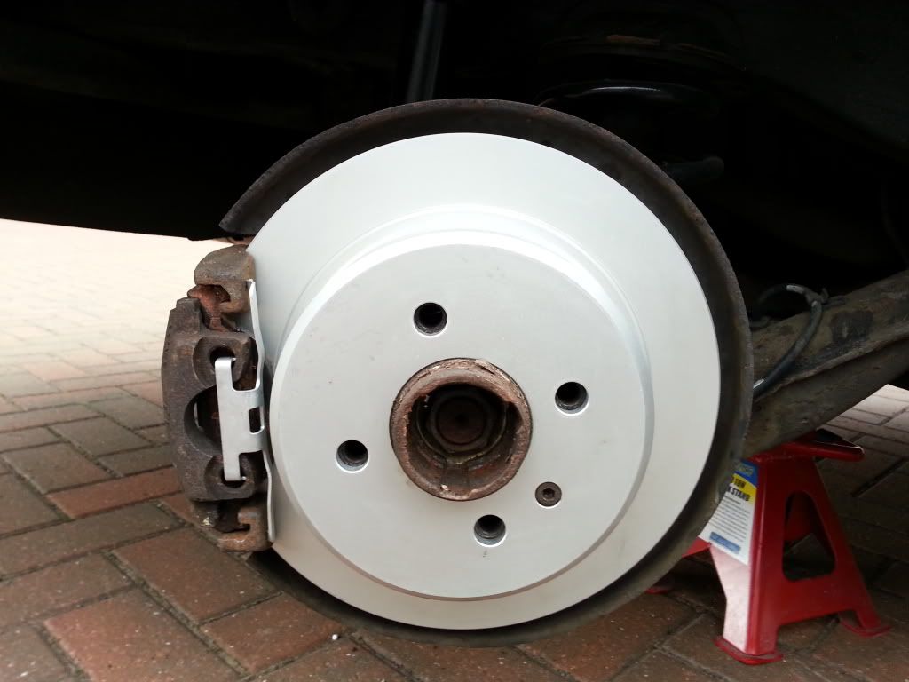

Meatballs82 wrote:On a different note my O/S handbrake shoes started rattling about last week so I bought some shoes and a fitting kit just in case, glad I did now as once again I found evidence of bodgery by John Hurst, the BMW Specialist I trusted to do my welding last year :cry:
When I first got the car I took it there, He said I needed rear discs and pads so I sent them down along with new shoes and asked him to fit the lot. I stripped down the brakes today to find some pretty old looking shoes, and one was held secured by cable ties... Dodgy Bast*rd.
So now the spare time I had saved to fit my throttle body next week will instead be taken up fooling around with the brakes, thanks to John Hurst Automotive, Pingle Street, Leicester. http://www.hurstautomotive.co.uk/ ''Keeping you on the right track''

I took the car there on the advice of several BMW drivers that couldn't recommend him highly enough. Didn't have time or knowledge to do my own brakes back then but will be trying to do as much as possible myself from now on!

To be fair, the shoes may have been in perfectly serviceable condition back then, and the cable-tie bodge may well have been done by a previous owner.
I would be more concerned if they were down to the rivets, as many are, including a Tech 2 Sport I had. :eek:

Whether the cable tie was Hurst handiwork or not, when they had the disc off, as a matter of course they should have checked the handbrake mechanism and reported / repaired as necc.

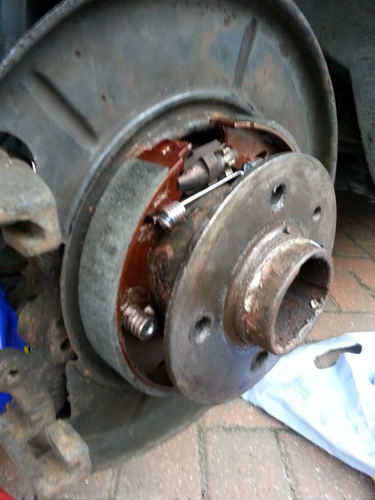

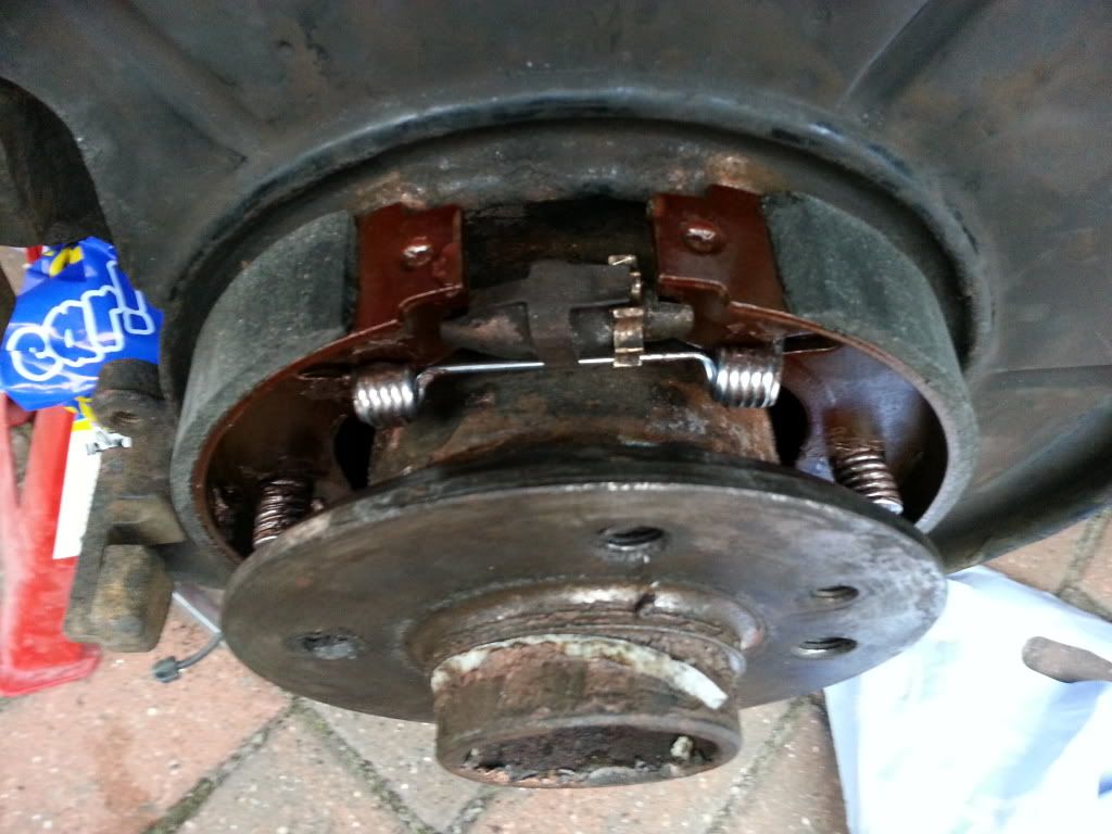

Had a bit of spare time before it got dark lastnight so I decided to have a pop at fitting the new shoes. Bear in mind its my first ever attempt at doing this!
Got the shoes on ok I think, all the springs are properly on and the shoes are sitting correctly in the cable mechanism at the bottom. Tried to get the disc on but it was very tight and didn't feel like it wanted to go all the way on. The adjustor is wound all the way in and sitting fairly loose between the top of the shoes, and I double checked that the cable was slack at the handbrake lever. I tried to follow the wiki guide closely and have gone back over it to check each step. Just wondering if anyone else has ever had this problem, or am I the problem here?!
Posts: 14071
Sat Aug 10, 2013 11:51 am
It looks OK. Quite often with new shoes, they are a tight fit and you may need to chamfer off some of the lining to remove the sharp edges that will be preventing the disc from going back on, or at least, wiggle them about until they fit.
It may be that the beehive springs are causing the outer edges of the linings to bow out slightly, so try applying some pressure to squeeze them in a tad.

I think I'll strip them down again tomorrow and try sanding them a little then. Even if I could have got the disc on it felt so tight that I can't imagine the wheel would have span freely, even though the adjusters wound fully in!
I went out at 5.30AM this morning to have another go before work but decided I was making too much noise when I accidentally booted the old disc across the garage floor! So once again wheel back on, car back in the garage for today with my bottom lip firmly poking out!
And Jim - Thanks for your input! :D
Posts: 14071
Sat Aug 10, 2013 12:24 pm
You'll probably find that once you get over the initial tightness and get the disc fully on, the linings will fall into line and you shouldn't get much binding - it would soon bed in after a few miles in any case.

Got the disc on without stripping it all down again
Nice firm handbrake, 5 clicks to full operation. The shoes were a little noisy for the first few miles but that soon died down once they'd bedded in I guess.
