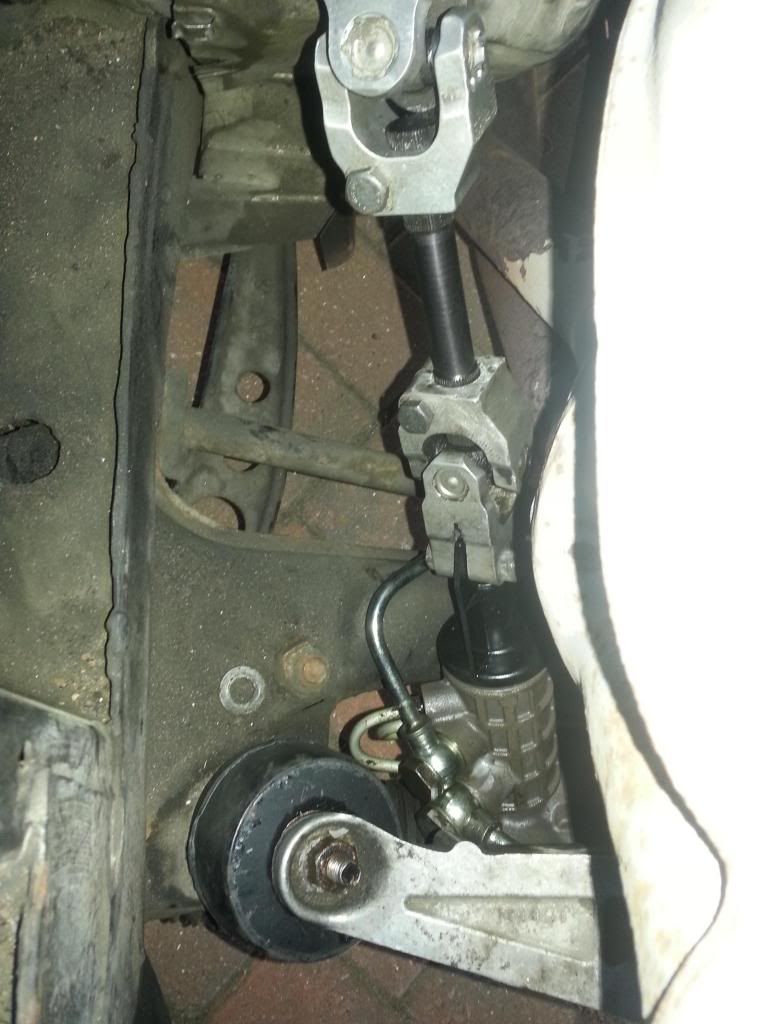

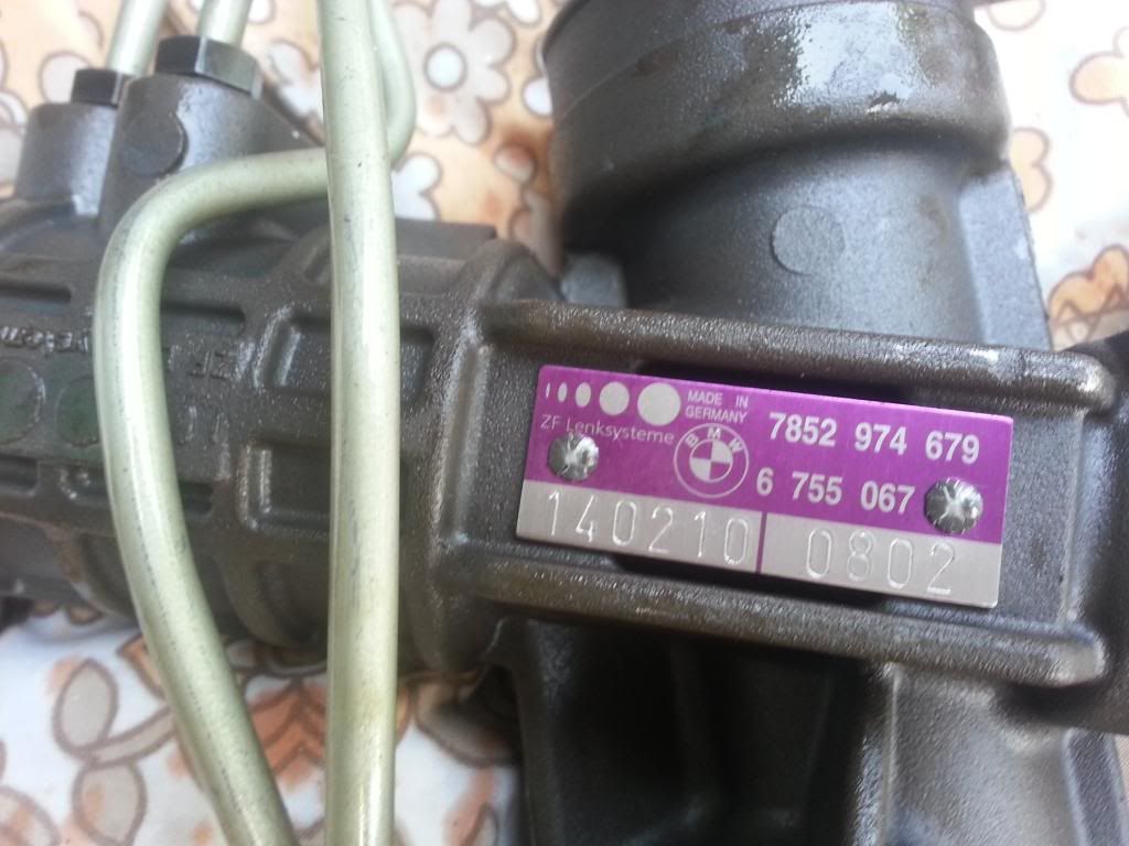

Not updated this thread for a while so thought I'd revive it!
I had the new clutch and lightened flywheel, master and slave cylinders and stainless clutch hose, cambelt, w/pump and thermostat changed, fresh brake fluid and new cap and arm fitted in May - couldn't stop grinning when I got it back from my mates garage! The flywheel has made a subtle but noticeable difference to the way the car responds, I'm used to it now, but all the scaremongering of ''easy to stall'' and ''the car will decellerate sooooo much quicker'' seem to have escaped my car!
Then I took a trip over to Dan's yard beginning of this month to get my 067 rack and pipes fitted, along with new Burton MK2 Escort eng mounts and custom steering linkage. Its so much sharper now I almost scraped the n/s on his gatepost on my way home! Def the best mod the car has had so far - I had to learn to corner the car again its so different! parking up is a breeze now, and the steering has a nice weighty feel to it, chuffed aint the word!
Thanks again to Dan for doing a very thorough job - was good to meet you after the last few years dealing over the phone!
Not got many pics to post, here's some of the new rack in place.
Excuse the filth - this will be rectified over the winter

A quick question about the 067 rack; I got fresh locking washers for the track rods to put in. Yet there was no notch on the rack to house it, rendering them useless. Looking on RealOEM E46 track rods have a bolt on the end. I just put some thread lock on, wound them in and pulled the tight with mole grips.. What did you guys use/do?
Meatballs82
- E30 Zone Camper
- Posts: 1136
- Joined: Tue Jan 11, 2011 11:00 pm
- Location: Northamptonshite
I bought Lemforder E30 track rod assy's which have some sort of lock ring that you can tightenG-Bear wrote:A quick question about the 067 rack; I got fresh locking washers for the track rods to put in. Yet there was no notch on the rack to house it, rendering them useless. Looking on RealOEM E46 track rods have a bolt on the end. I just put some thread lock on, wound them in and pulled the tight with mole grips.. What did you guys use/do?
scott180gtb
- E30 Zone Camper
- Posts: 1251
- Joined: Thu Mar 26, 2009 11:00 pm
- Location: Yorkshire
Thread lock minus the washer. I cleared it with Dan just to make sure.

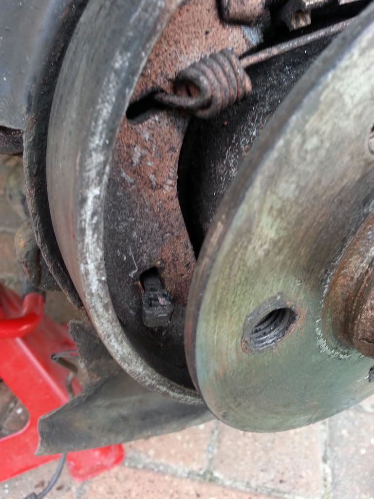

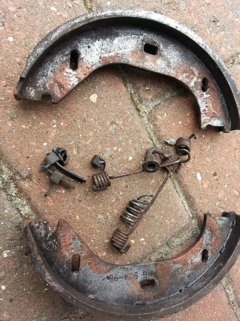

On a different note my O/S handbrake shoes started rattling about last week so I bought some shoes and a fitting kit just in case, glad I did now as once again I found evidence of bodgery by John Hurst, the BMW Specialist I trusted to do my welding last year
When I first got the car I took it there, He said I needed rear discs and pads so I sent them down along with new shoes and asked him to fit the lot. I stripped down the brakes today to find some pretty old looking shoes, and one was held secured by cable ties... Dodgy Bast*rd.
To add insult to injury came a heavy shower of rain and the fact I had snapped both caliper bolts without realising as they had rusted into the thread. I knew the calipers were quite old but didn't get spares so I just cable tied the caliper back on for now to get the wheel back on and put the car away for today!
So now the spare time I had saved to fit my throttle body next week will instead be taken up fooling around with the brakes, thanks to John Hurst Automotive, Pingle Street, Leicester. http://www.hurstautomotive.co.uk/ ''Keeping you on the right track''

The discs and pads are fine, and also Pagid so more than likey the ones I supplied. I guess the shoes went in the bin when he couldn't be bothered to fit them, so he either put the cable ties there or saw them and left it anyway!DanThe wrote:Animals! So what happened to the new parts you gave them to fit?
