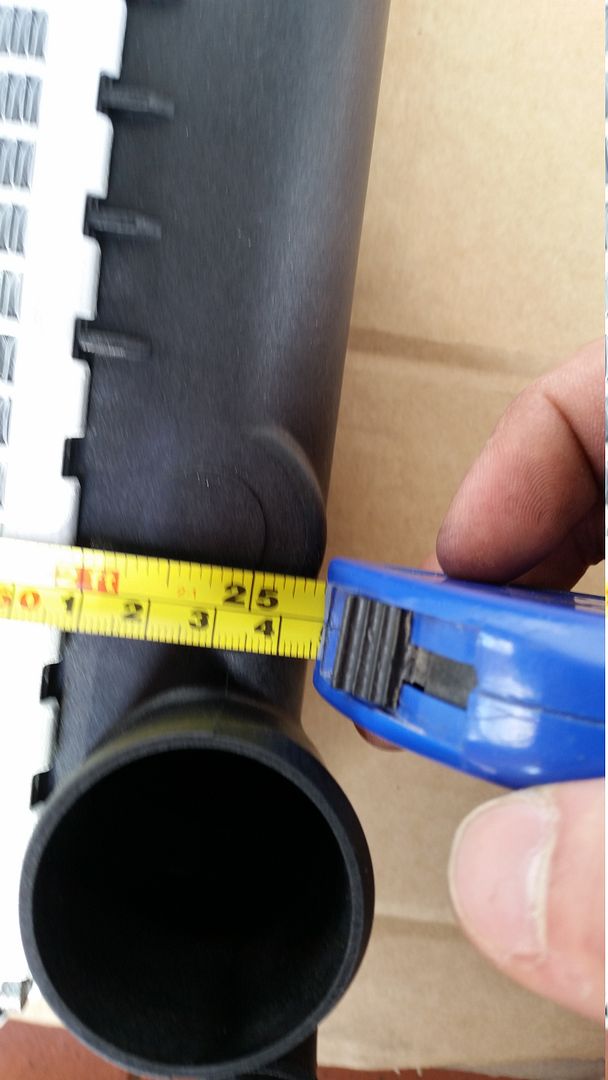

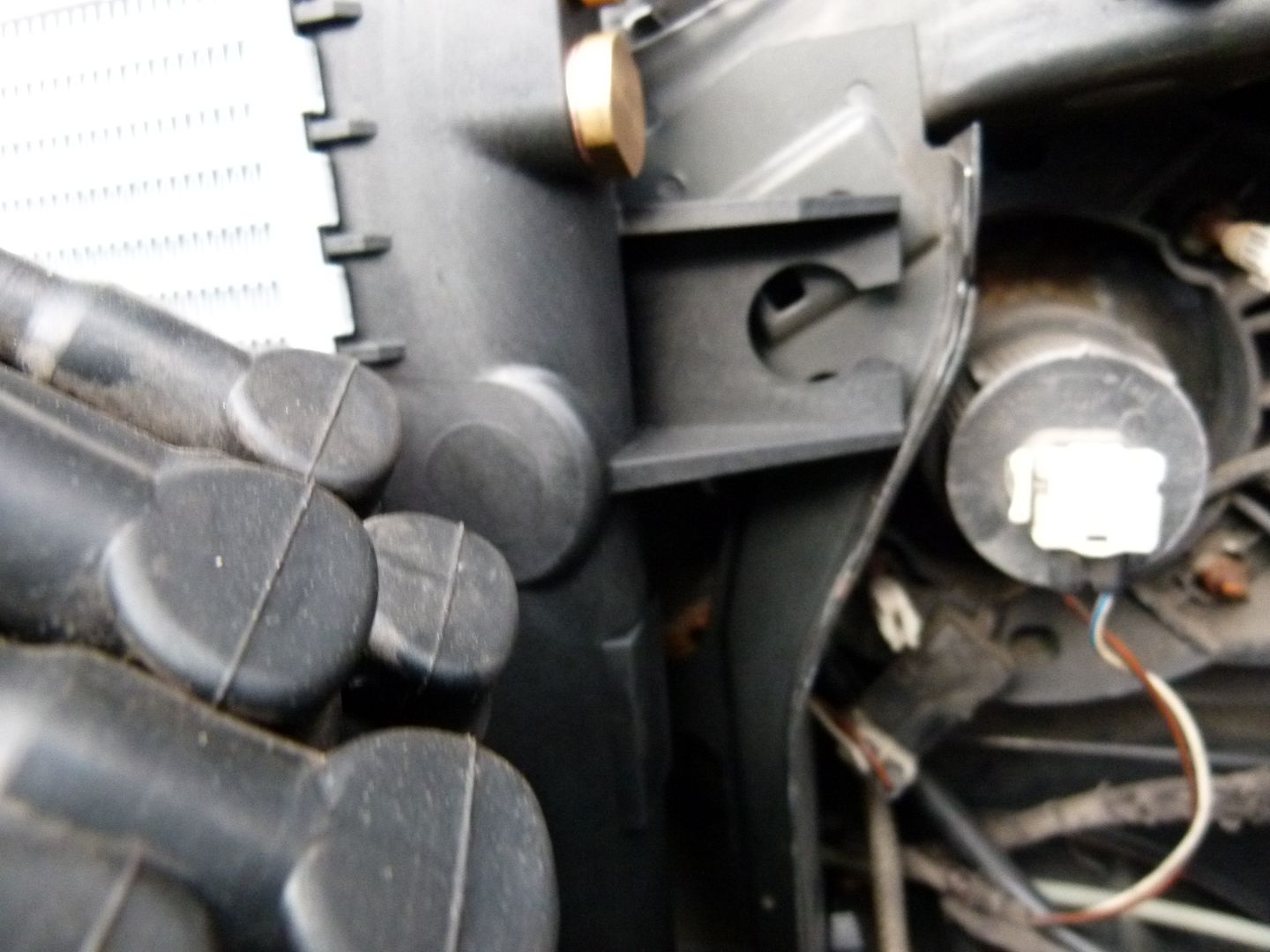

Hey peeps! Im back in business on the beast..going to do a proper update tonight, just a quick q for now

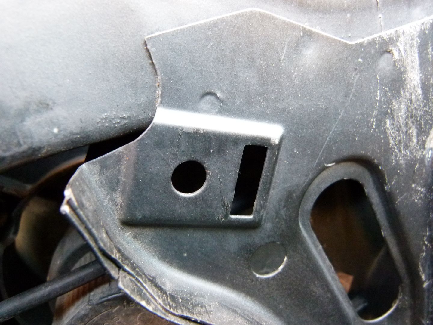

Do you have to cut these out to make the radiator fit? Its only off by about 1-2mm but its not going in..
Thanx guys

I would be tempted to try a bit of club hammer action first...
Cypriotgeeza
Posts: 3055
Post Sun Jun 01, 2014 1:47 pm
Lol i was more thinking of grinding it down a bit..really dont want to resort to clubbing anything :o: lol

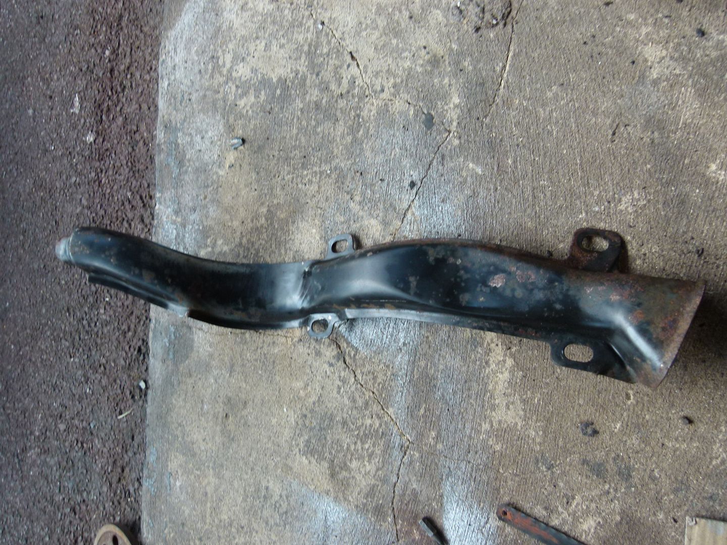

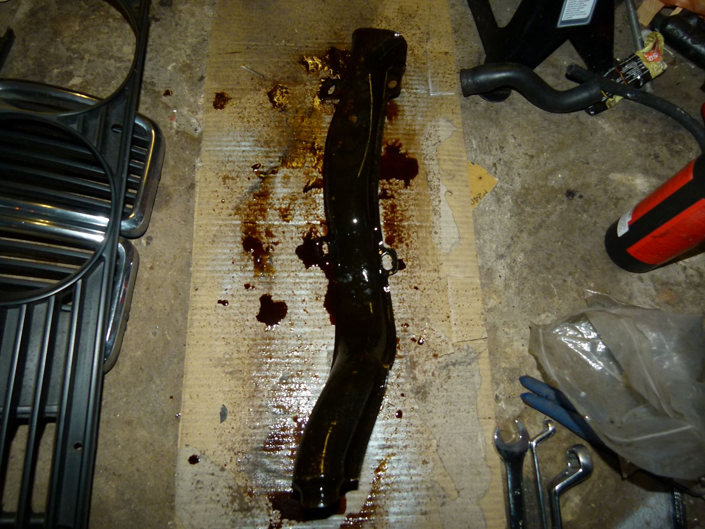

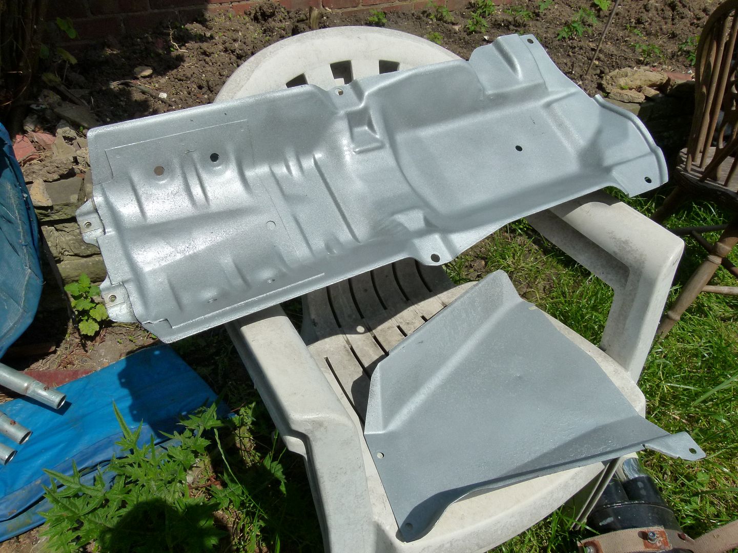

First off i took your advice rav man and cleaned and sprayed up the heatshields:
Went to fit it and its hitting the bottom of the prop bearing..Problem number 1 :roll: Not sure what bearing is supposed to be used as it writes "328 manual" on the prop itself.. What prop bearings do you guys use?

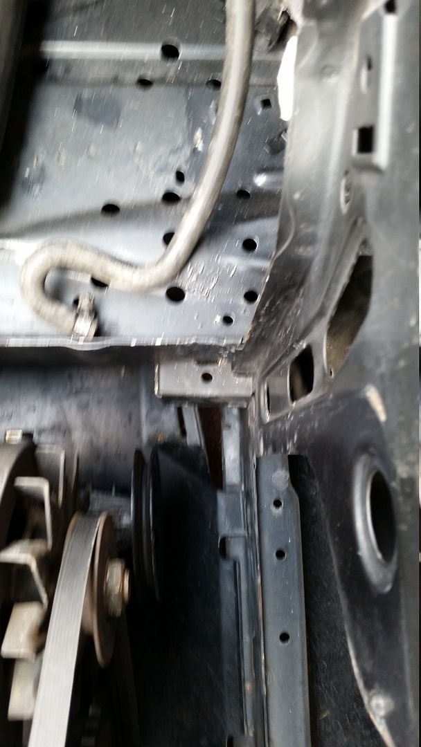

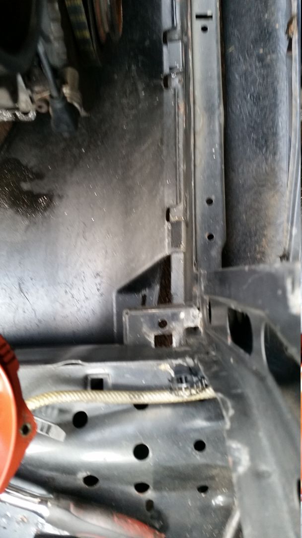

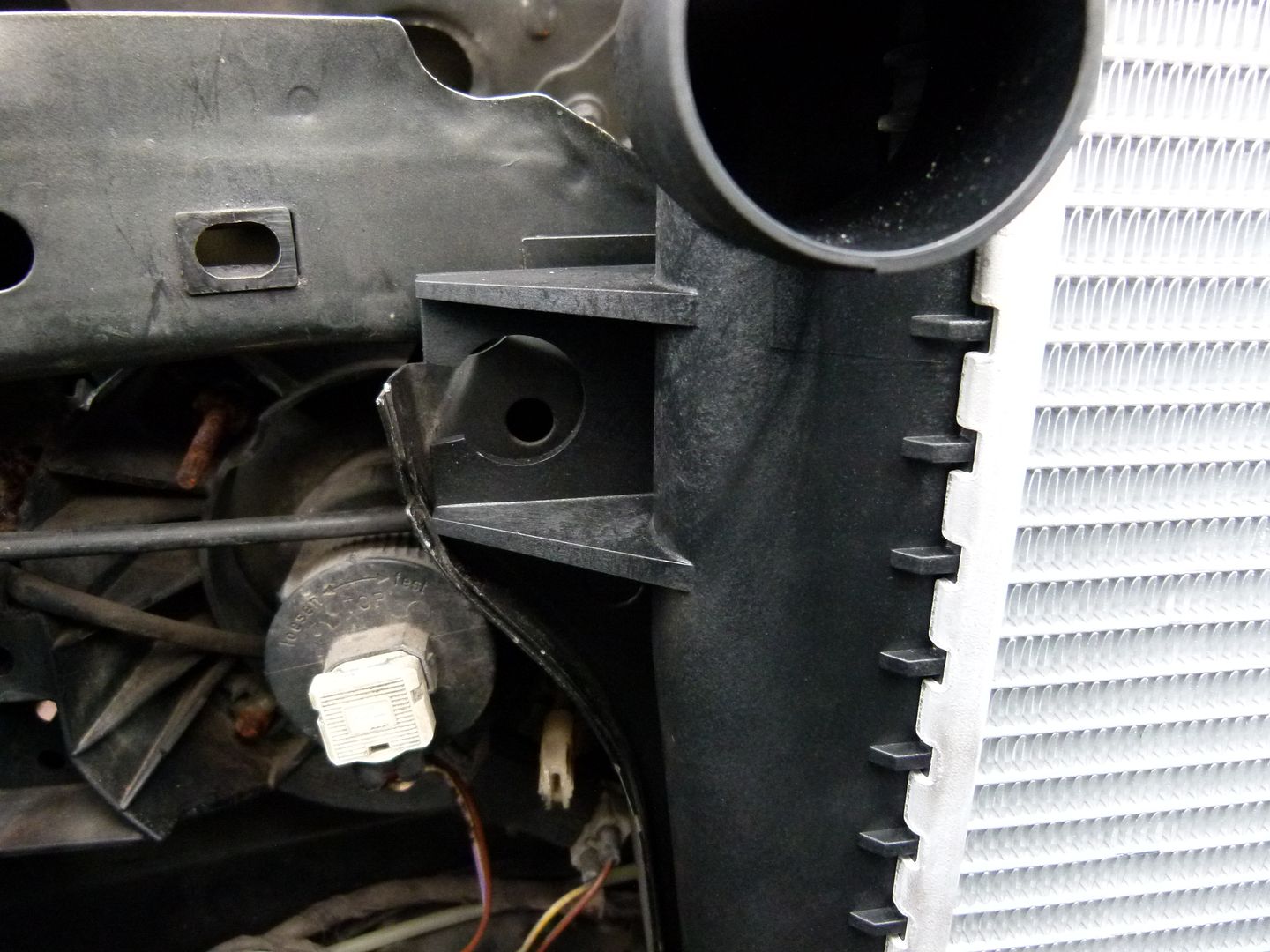

Before i fitted the fan i thought id have a trial fit of the rad itself and here comes problem number 2 of the day:
The original M20 rad bracket sections are stopping the rad from going right down to the bottom, Anyone else had this problem? How did you resolve it? (Without resorting to crude methods lol)

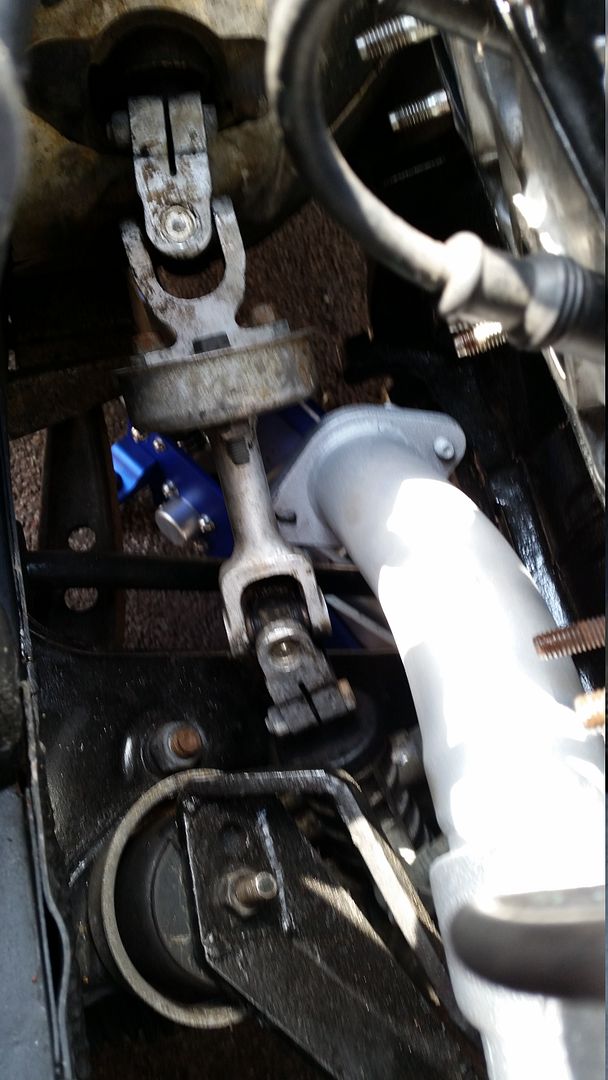

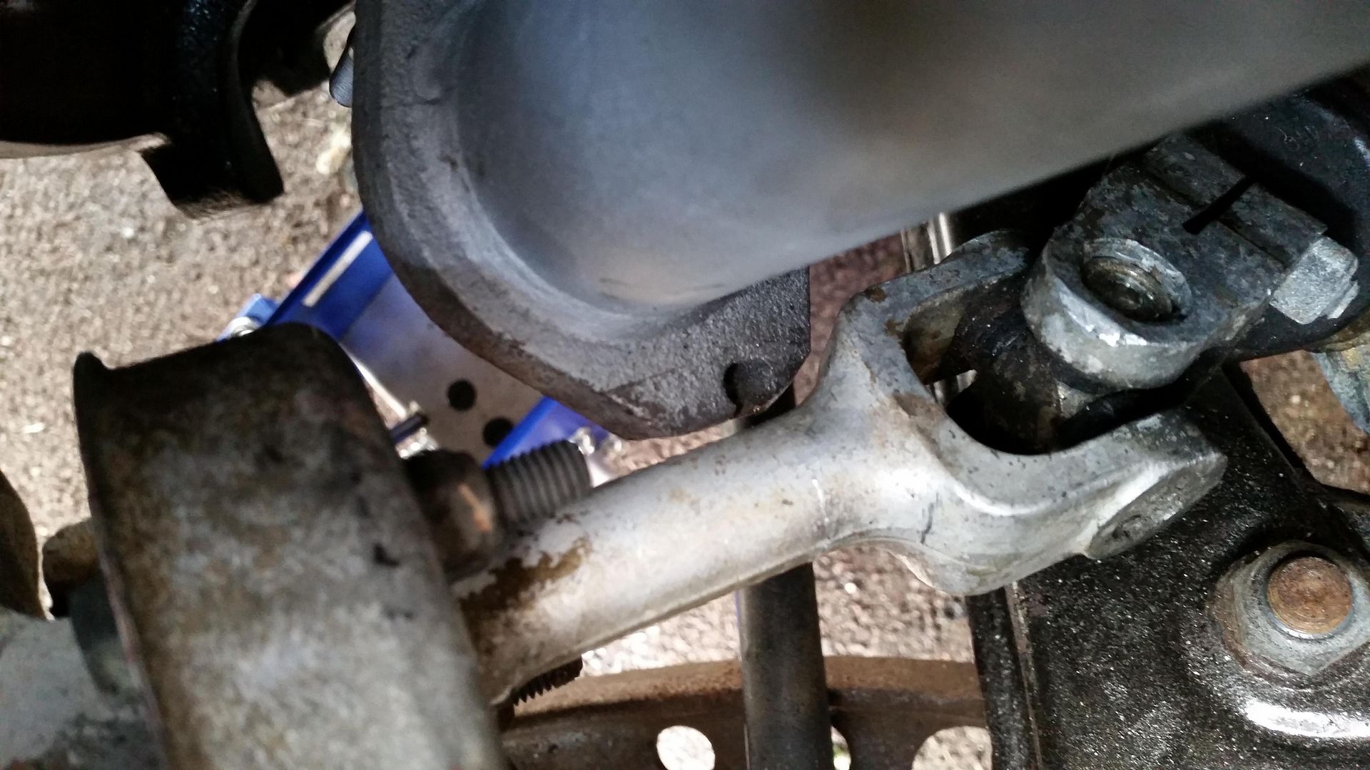

So then i decided to fit the manifolds and found that the front one is hitting the steering linkage...Problem number 3 :roll:
I just ended up using my grind wheel to grind the edge off and it has plenty of clearance now..

leeparkes
Posts: 9535
Location: Black country
Post Sun Jun 01, 2014 11:50 pm
With the rad tabs they do need to be out the way, I cut through one part of the weld then bent them down just in case i needed them back at any time.
Strange with the linkage hitting the manifold though, is it a standard rack you are using?

leeparkes wrote:With the rad tabs they do need to be out the way, I cut through one part of the weld then bent them down just in case i needed them back at any time.
hey Lee, yea im pretty certain its standard, its frankenstein remember, nothing is ever strange to me anymore with this project lol :roll:
Like i said ill get a pic of the downpipes too as something didnt look right to me..but it was a warm day n i was knackered so it might have just been me

Btw ive just had a look in my thread and its only the passenger side rad mount that needs to be out the way.
Good job because this is the nightmare i had :(
leeparkes wrote:UPDATE.
The £20 E28 rad is in but it wasnt without a fight,it took me nearly 5 hours from start to finish 8O
M20 rad was out in 20 minutes,then i slid the M30 rad down to see how it sat and it didnt, i had to chop the passenger side mount off BUT i couldnt get a grinder in there, then i tried the dremmel and failed, in the end cut the weld with a hacksaw blade then lost my temper and belted it down with a two foot iron bar! job done!
Then i lined up the brackets at the top of the rad and drilled the holes to secure it,all was good until i realised i couldnt get the nuts on the back of the bolts :banghead: so the grill had to come off with the headlights to get to the back of the bolts,then i had to make holes in the shell to get the bolts on.
These are the nuts and bolts in question vvv
Then once the bolts were lined up i tightened it up only to realise my leccy fan had to be moved over a touch as the rad was squashing it against the slam panel,so rad out again and bash and relocated the fan so the rad would tighten up flush against the shell,another job done!
Next problem!
i forgot i needed a bottom hose from an E28,so top bodging skills came out,id got loads of bits of exhaust pipe knocking about so i cut 5inch off some 45mm pipe smoothed the cuts then cut the E34 bottom hose and joined with the piece of pipe to extend it.
The bodge vvv
The next problem was getting to bottom hose to stretch over the bottom radiator stub,so had to take the rad out again and it made it easier to stretch the hose over the stub while it was out of the car then wrestled the rad back it with the bottom hose attatched then bolted the rad back up (again)
After this it was plain sailing apart from scraping my knuckles various times trying the get the bottom hose on the stat housing,
top hose went on with no trouble then put my car back together filled up with coolant and bled it (for about an hour) then took it for a spin.
It is keeping the engine much cooler and i now hardly have to use the fan,IMO the m20 rad will work with the m30 and it 'wont' overheat but the fan is on quite a lot so its a good idea to invest in the e28 535i rad.
Ive took photos of the clearance ive got with the e28 rad
Im happy with it :D

I also grinded the tab off on mine, angle grinder FTW :D
Would a DanThe steering linkage help with the manifold problem?

I did the same as Lee with the rad mounts "adjustment" and got the manifold to clear the rack ok with a bit of accurate grinding.

Imy- Yea i was going to do the steering linkage when i did the E36 rack mod

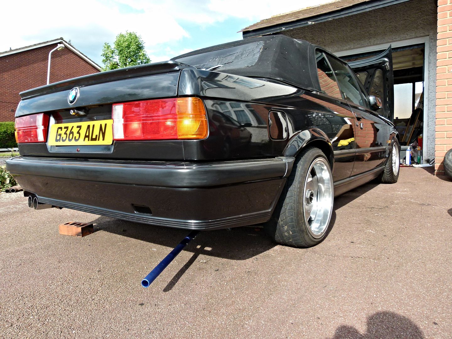

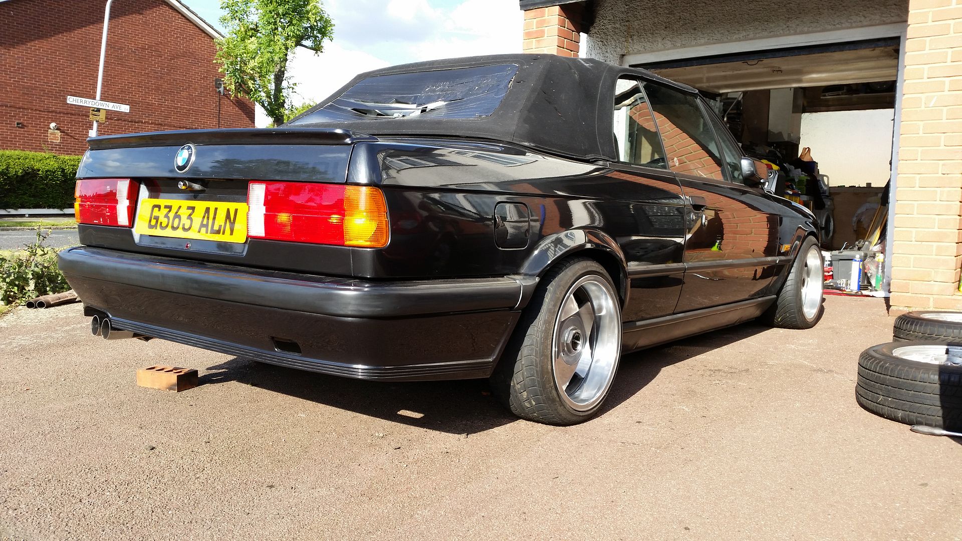

Started off by fitting the downpipes and exhaust..
Now just before i did this i started it up briefly without the manifolds on and recorded it..well i thought i recorded it :o:
Turns out i didnt press the save button :cry: so its gone forever :( It did make one hell of a noise though! 8O My mum actually came out to see if i was ok haha :snigger:

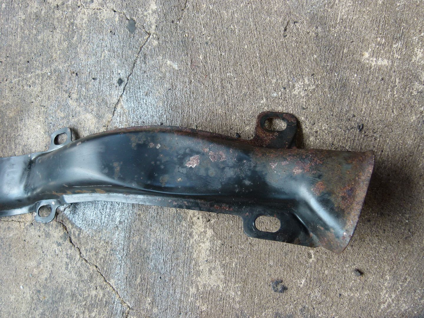

Then i got to sorting out the radiator and clearance issue..
First i did what you did Lee and got rid of the neariside bracket but I wasn't happy with the way the rad was sitting
Ok on the nearside but way off on the offside:
So i got to removing the Offside bracket aswell...then i cleaned up the area where it used to be and Fertan'd the front end:
I let that dry while my mate came over for a look at what i was up to..He has one gorgeous E30!
Now where was i, got the radiator in and was going to do the whole Nut and bolt approach like you lee until i stood there and looked at these slots and wondered if i could do something with them
So i went to the scrapper and got the headlight securing clips and screws and thought id give it a go, got nothing to lose!
and what an idea it turned into as the rad is now sitting perfect! :clap: makes you wonder what these were originally put there for!
and for a bit of precision :roll:
Then i noticed the gap inbetween the panel and the radiator and had a look to see if the original mounting bracket would fit
Nope..i still didnt like the way the gap looked so i got the spare one i had and made a slight modification winkeye
Much better! :D
I then moved onto measuring up the fan
Looking good :D Ill hopefully be securing it tomorrow!
Another thing i did today was to remove that metal cover in the offside rear arch and gave it a good rub down and fertan'd it..going to let it dry overnight so i can spray it tomorrow..

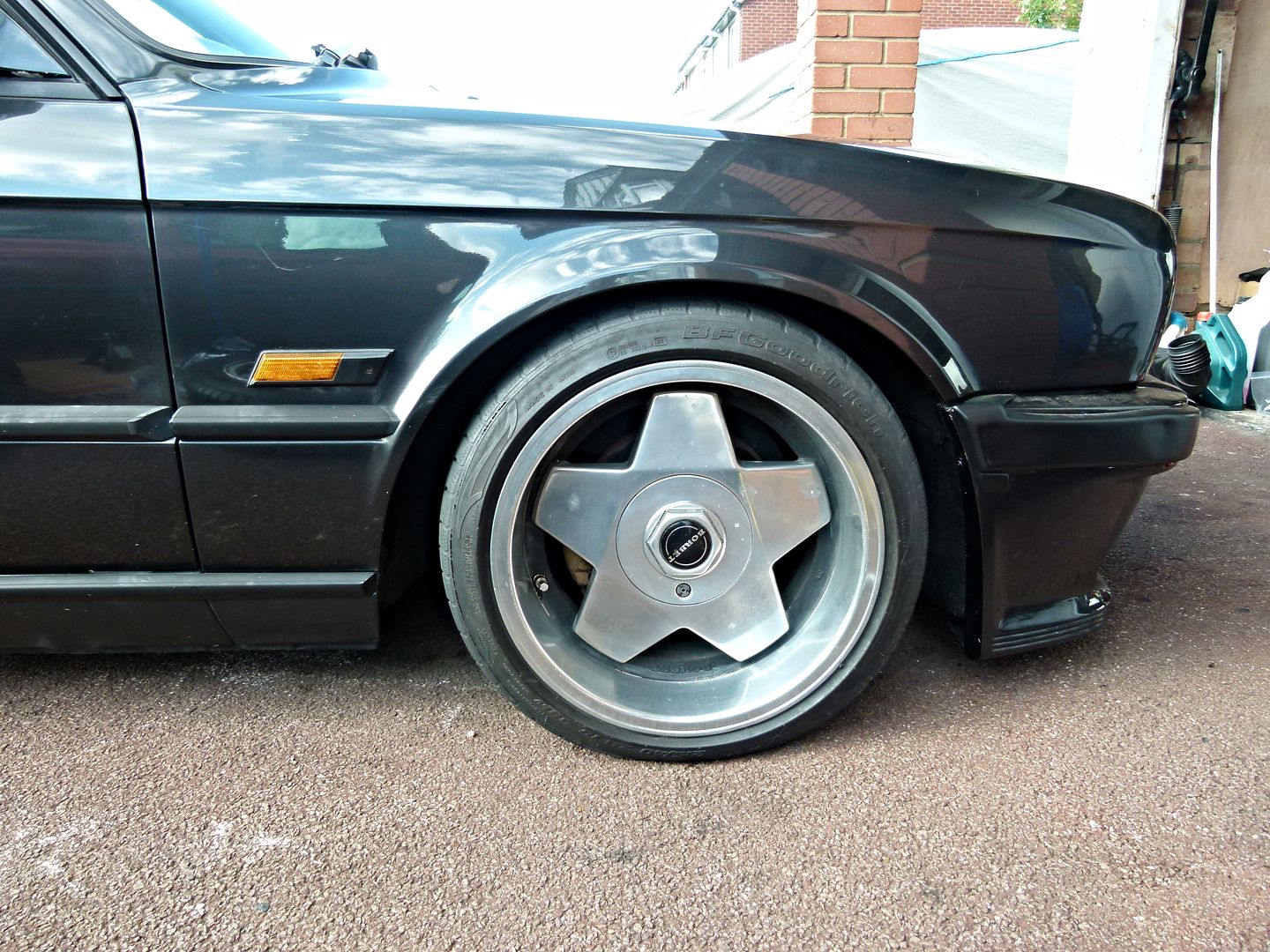

While the wheel was off i decided to try out the Borbet A's and see how they sat with the car this low.. :drool: (car and rims dirty)
and i thought might aswell do the front too lol 8)

I too wonder why BMW put those holes in the shell where the rad bolts to! i used a nut and bolt to start with which was a nightmare in the end so when i rectified my mistake i used a pair of these in M8 flavour 8)
