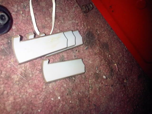

Sunroof mech is back together
Managed to do it without slicing my fingers on the stainless-razor plates - used a wide flat wallpaper scraper to push the cloth into place and then bolted it all down quick.
Used adhesive remover to clean up the front & rear of the aperture then used spray-contact adhesive to stick the flaps in place and then the wind deflector over the top.
Not happy with the corners - had to put small in-fill pieces in - you only really notice if you look for it but I know its there and it could be better
Then had fun pop-riveting the panel liner in place - naturally the rivets didnt go as flush as they need to be first time so a bit of fettling was needed.
Stopped at that point because all thats left is the roof panel - which can go in tomorrow

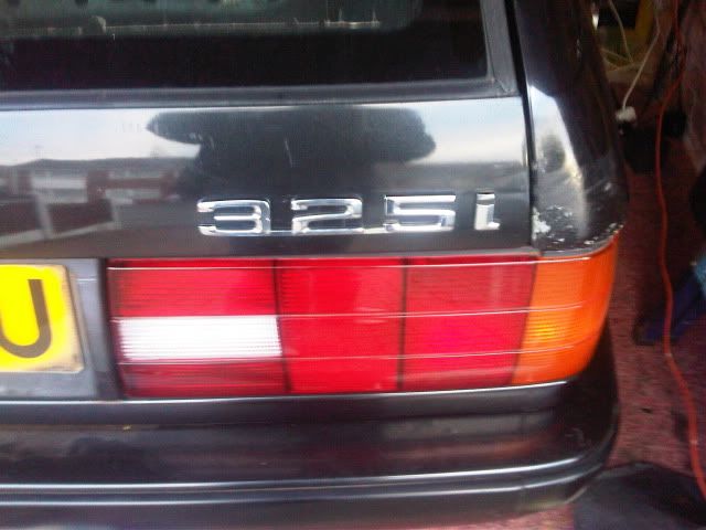

Then turned my attention to the back end :
New light seals fitted - old ones were truly fecked
Un-cracked boot lip trim fitted
Tailgate trim all re-fitted with new clips
Number plate lights re-fitted.

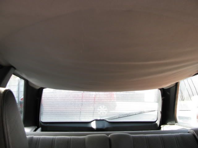

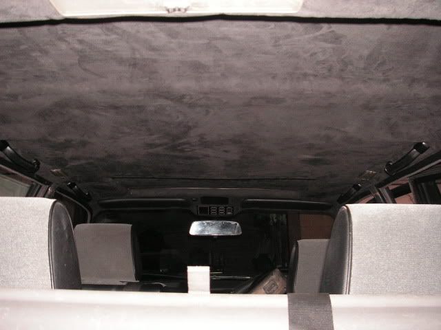

Managed to get one photo on the digital camera as the battery was flat - but its a moneyshot
From this :
Dirty, grubby, sagging
to this :
Made some good progress but found some unexpected bastid rust in the rear panel where it joins the boot floor. I don't think its an MOT issue but it will need sorting.
From this :
to this :

Looks sooooooooo much better with a black headlining. What is the material, suede?

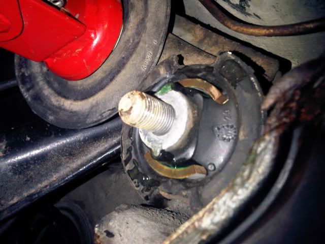

Another big push today :
Cleaned the front arch liners, final dousing with waxoyl under the front arches and liners refitted
Sorted the front tyres rubbing on the plastic trim at the front on full lock by adjusting the front undertray - you have to do this one side at a time, undo the 2 x 10mm plastic nuts, pull it forward and then re-tighten - this pulls the front plastic arch liners which hold the ducts fron the front valance forward and gives enough room to clear on full lock - no more tyre rubbing
Windscreen washers refilled & adjusted
Wipers all checked
All lights checked and working
Handbrake adjusted as good as I can get it - drove it up and down the road a bit with it on to try and bed it in, then adjusted it at each wheel pulling the lever on and off a few times in between adjustments to re-set the shoes. Its not perfect but it holds on my drive which is quite steep a lot better than it did.

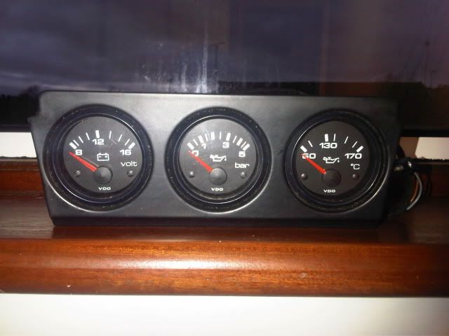

Then took these :
Fitted :
As described by Dan it was indeed a piece of p1$$ - bushes still look like new anyway but a bit of washing up liquid and a few light taps with the persuader and theyre in

Then took these :
Fitted :
Not much to do now
I got them of DanThe one hereparkin10 wrote:where did you get those bush inserts from?
Did you drive her with them fitted, notice much difference? Have a set myself to fit but they are going into new bushes and I've only ever driven with worn ones.
- Posts: 9681
Only up and down my little road to try and bed the handbrake inJozi wrote: Did you drive her with them fitted, notice much difference? Have a set myself to fit but they are going into new bushes and I've only ever driven with worn ones.
Just glad I got them fitted before the bushes start to wear

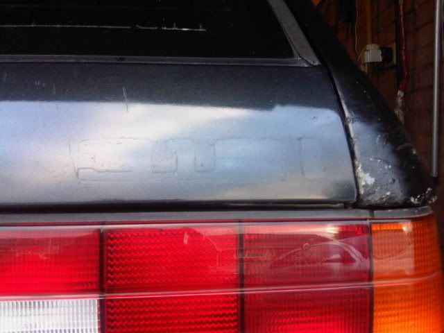

I knew the oil leak would get a mention and I had my doubts about the handbrake to be honest - I thought I had it good enough on Tuesday but it just wasnt to be
The bit on the rear quarter has been damaged and badly painted by a previous owner.
It will need a full blow over really - all the panels have dings in and the rear valance needs chopping out and replacing. That will have to wait a good while though until I can build my cash reserves back up.
Enjoyed driving it today - it feels so tight now and it does shift when you give it the beans
Will be even better when I sort the head and servicing out - I bet replacing the dizzy cap & rotor arms ( look like 144k originals
) will free up some horses
