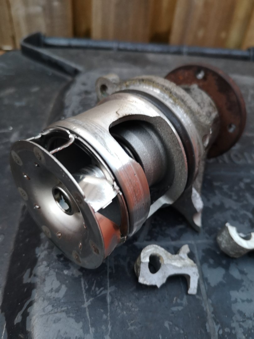

The M44 has been making a "whirring" or grating/metallic noise for some time now. It got to the point where I was worried that something was happening inside the timing chain case that was going to get real expensive. That or one of the pulleys was making a noise.
I don't know how I found it, but I gave the viscous fan a wobble and found a hell of a lot of play in the water pump (which is what the fan threads onto). On closer inspection, rusty water has been leaking out of the pump and has dripped down the case slightly.. Not enough to directly notice mind. Long story short, the pump failed.
I believe that saleri are the oem brand, which use a composite impellor. These are apparently good for 70k-100k miles.
The plastic impellor ones are known to break up.
I had one that's clearly aftermarket, a cheap one at that. The casting broke on removing it.. To remove, you thread two m5 bolts into the pump to use as like a puller. The casting cracked before the thread stripped. Nice. The spot welded impellor is apparently known to suddenly break up and cause all sorts of headaches.
I ended up getting a hepu branded pump ordered last night. These are popular, with a heavy duty metal impellor. Good for 70k - 100k also and about 40quid.
Also ordered an elring intake manifold gasket for itbs.

You should rotate the pump with a large pair of grips to remove it, tightening the bolts in the lugs slowly by hand or a very small amount of torque any time you can move them. The lugs aren't strong enough to lever out a pump from scratch.

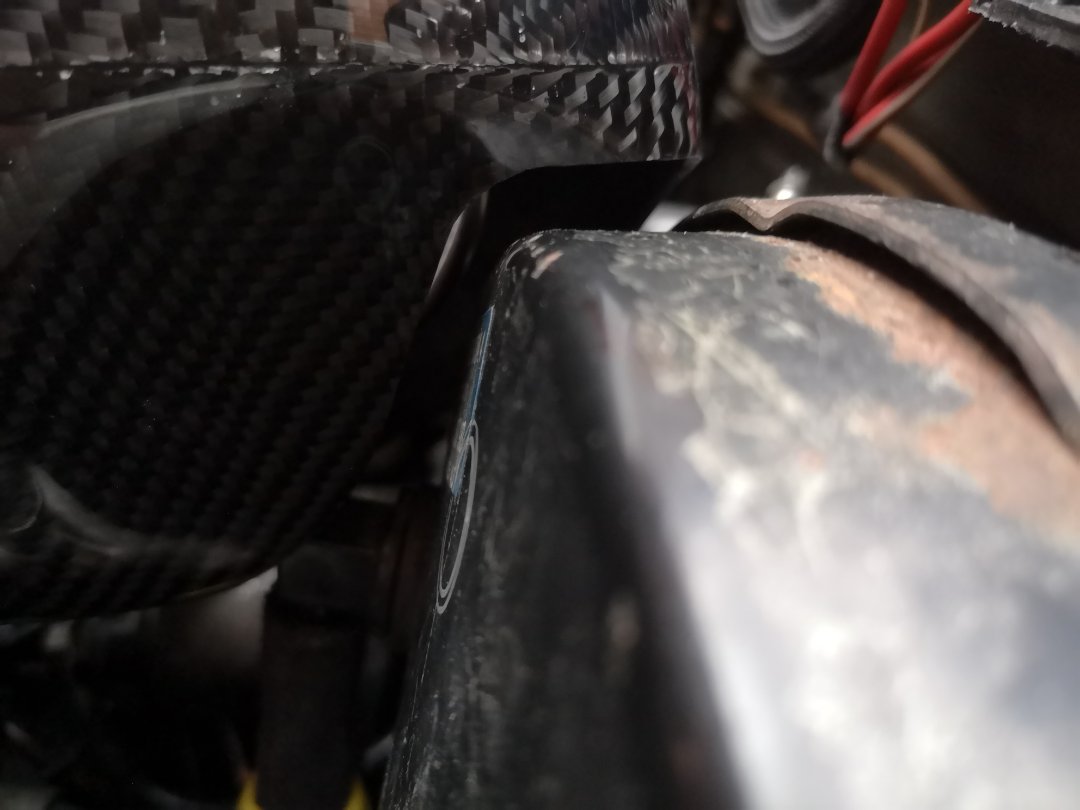

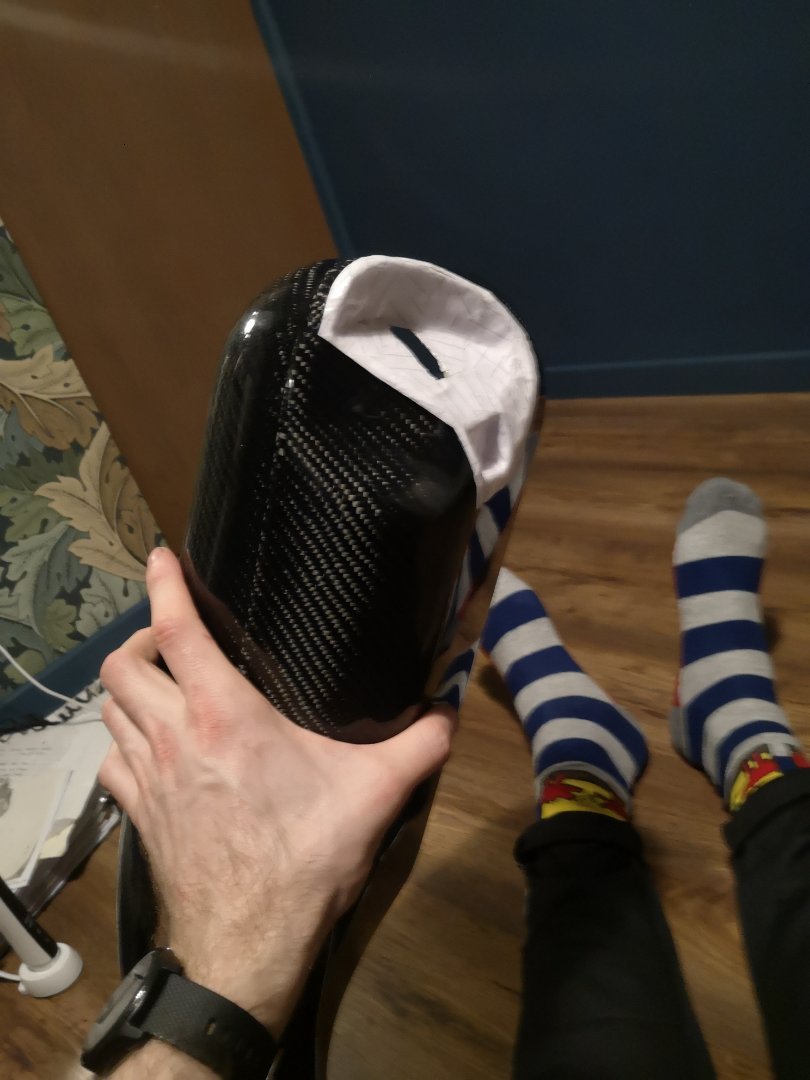

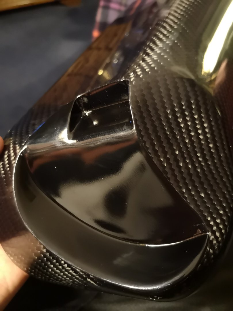

Awesome, didn't know about this servo but I committed to chopping the plenum and I've got it finished. Guess this just compiles options for dingbats like me πŸ˜‚
Anyway. I ended up getting a friend to finish my plenum as this is what he does for a job, I'm dead happy with it. He was telling me about a tvr plenum that he'd designed and made made 25hp gains on the dyno over stock before it was mapped! Said my plenum was a good shape and that the modification to airbox shouldn't make any noticeable difference.
I just have a few bits to tidy up and then it's ready to go.
