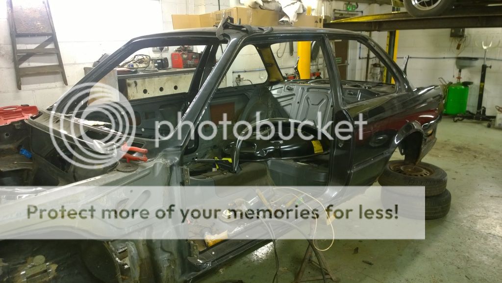

So I went to see my car on the jig today. Discussed the best options for the shell and we've decided to go with a new front panel. I've been told the one on there at the moment is scrap. It's a pattern part, its heavily bent, I've never had straight panels at the front and it has broken spot welds from the crash all them years ago.
The front end collision this car had back in the day, must have been quite serious. The jig only aligns in one place at the front. 8O
It's okay! I'm doing all I can right this moment to source an OEM front panel (BMW parts closed till Monday :( ). I need it asap as these brackets the car is on, are hired out on a weekly bases :|
All in all its good to see some real progress on the poor old girl.

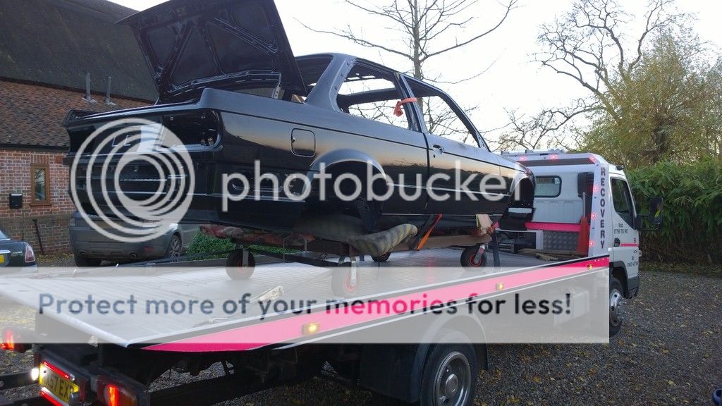

Well done and a great effort in saving another sporting 80's BMW ... here's a couple of pictures of my 89 Tech 2 - we replaced every panel bar the roof and drivers door - it's on a low loader heading off to be refitted after the body restoration - keep your patience - its taken time and a lot of money and i'm still a year away from being finished .... but i'm sure will be worthwhile.... Good Luck
