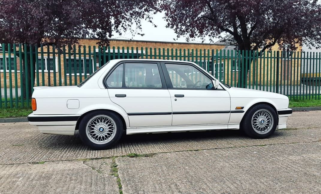

So I'm well back on my routine now after the summer road trip, and as always looking to make improvements to the car. First was a set of new rear tyres, these were legal before the road trip, it shows the effects on camber when lowering the car, and add to that a boot full of gear this is what you get
I matched the rears up with the front so it's running Yokohama Advan Fleva 205 55 15 all round
I've also fitted an oil pressure gauge from jr parts to match the temp gauge. With the oil cooler refitted the temps and pressures are spot on. 11psi warm idle and it builds pressure very quickly.
I also decided to try out a new set of springs, I liked the eibachs but discovering I had the pre facelift version fitted which are for lighter axle loads left me wondering if there were improvements to be had. So rather than going for the correct Eibachs I decided to try a set of Vogtland springs. Spring rates are now 220f and 360r, very close to the Alpina springs rates
Some how it sat higher even though the new springs were shorter, obviously due to the increase in stiffness
As you can see the arch gap at the front was a bit ridiculous so a set of e90 drop hats were ordered
I had to remove the small pressed in piece of metal that doesnt exist on the e30 version. I managed to swap these over without removing the whole strut assembly which was a stroke of luck, I just had to compress the shock and locate the washers and spring hat over the top before it extended again
tha881
Posts: 780
Post Tue Oct 20, 2020 3:39 pm
It's now sitting a lot nicer with the drop hats fitted, heres a quick pic to give you an idea
The ride height is very similar to the eibachs, the front is probably 10-15mm higher which is no bad thing. With the added stiffness it feels a lot flatter, there is far less squat and dive on braking an acceleration. The eibach were better in only a few situations, and that was in comfort not performance. Probably not helped by having prefacelift springs. It really feels good throwing it into a turn, there is hardly any lean or flexing, straight away it settles into the corner.
The other option was h&r 29664 springs which are 200f and 280r, but I feared they would be too soft in the rear. I think some b8 shocks might be ideal with the vogtland springs as that is what Alpina used.

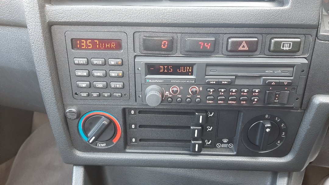

Also decided to upgrade the stereo, the old one only had aux output which was a bit of a pain when using navigation and music on my phone. Now have the choice of USB, sd or bluetooth as you know. The sound still seems better through an aux cable than the other options so far.

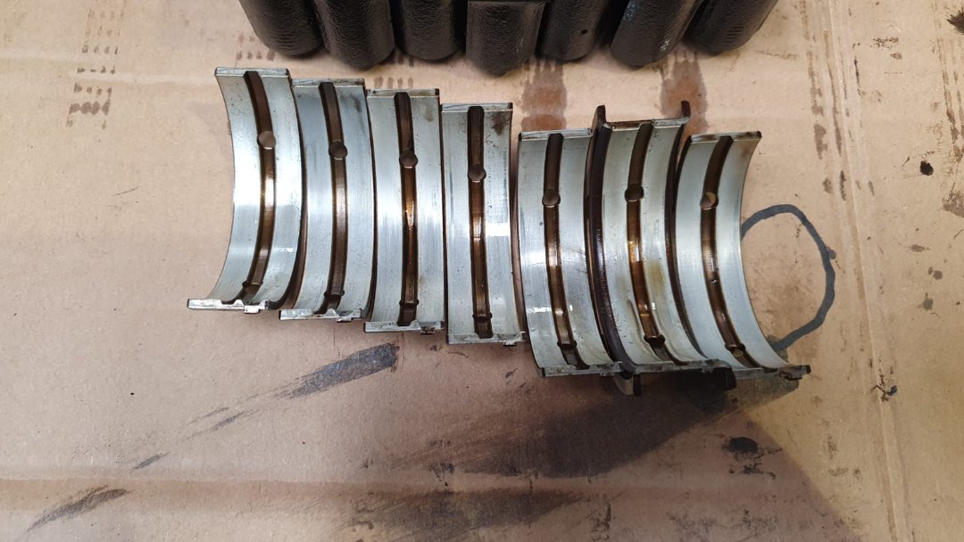

The bottom end was on 140k and probably could have gone on quite a bit longer. Luckily nothing nasty was found, as i expected. So I got them to press on with the rebuild. I just wanted a standard refresh, nice tight engine that will last another 30 years hopefully. The crank was good to go with a polish, new bearings for the rods and crankshaft, new piston rings, hone and skim the block, decoke everything and new seals. They also stripped the head and skimmed that just to be sure. A new oil pump was sourced from Wallothnesch in Germany. The rebuild was carried out by Corry's Motor Services, quite well known on here, I cant recommend them enough
In the meantime I was cleaning up all the parts from the car, ready for the re-assembly

Just out of interest ,what sort of price scale do you believe the engine "re-fresh" has cost you ?
Thanks Mart, I definitely saved a huge amount by pulling the engine at home. If I had just driven the car to a garage it would probably have been thousands
I supplied everything except for the bearings and rings as they are an unknown until you inspect the crank/bores/pistons. Autodoc is very handy for the majority of parts, and some bits you just need to get shafted at Bmw
Rod bolts, main bolts and head bolts from Bmw is around 200
Oil pump 175
Cambelt kit, water pump, gaskets, coolant etc 200ish
Oil cooler 110 (changed for piece of mind)
Then the rebuild and parts that needed inspection bought it to a bit over 2k total, add on the hoist hire and a few other parts it was no more than 2.5k
The head didn't need any parts as it was refreshed in 2019. Clutch was replaced a few years back so that was fine

Well worth the effort, an M52B25 crank and rods would have been a nice upgrade while you were in there 8)
tha881
Posts: 780
Post Sat Feb 12, 2022 11:00 pm
DanThe wrote:
Sat Feb 12, 2022 6:20 pm
I did seriously consider it, but as mine were in good shape I thought it was a safer bet to keep it original than finding good used M52 parts. If he had said the crank was scrap or needed a regrind I likely would have gone that route. I decided it was better to use known parts in the end. I do wonder though how well a 2.5 would go with a lighter bottom end and a fast road cam, I bet it would rip!
