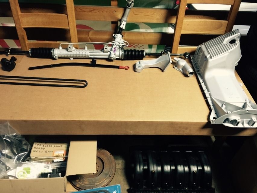

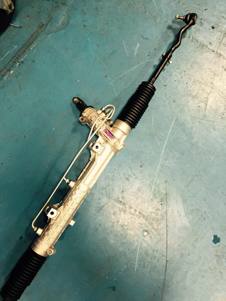

New e46 Clubsport rack acquired and cleaned up. New tie rods, track rods and boots fitted...
Lightened m20 323i flywheel. Just needs a clean up...

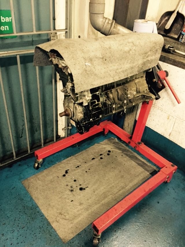

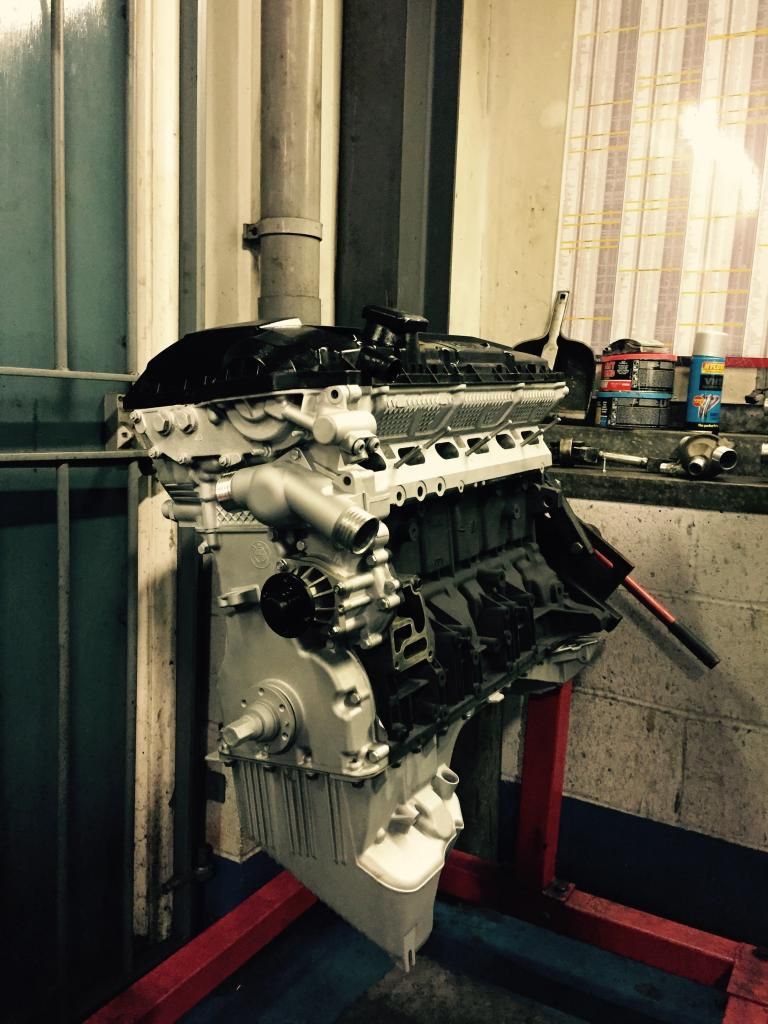

finally removed engine from e36 this afternoon (thanks to Ollie for helping out) and started stripping it down to clean up. Replacing gaskets, pipes, breather, water pump etc along the way...

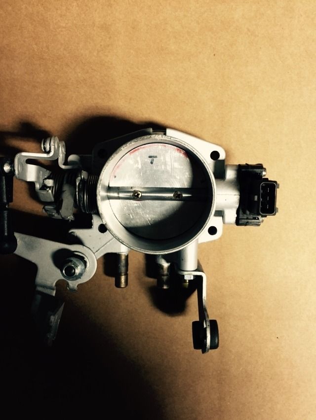

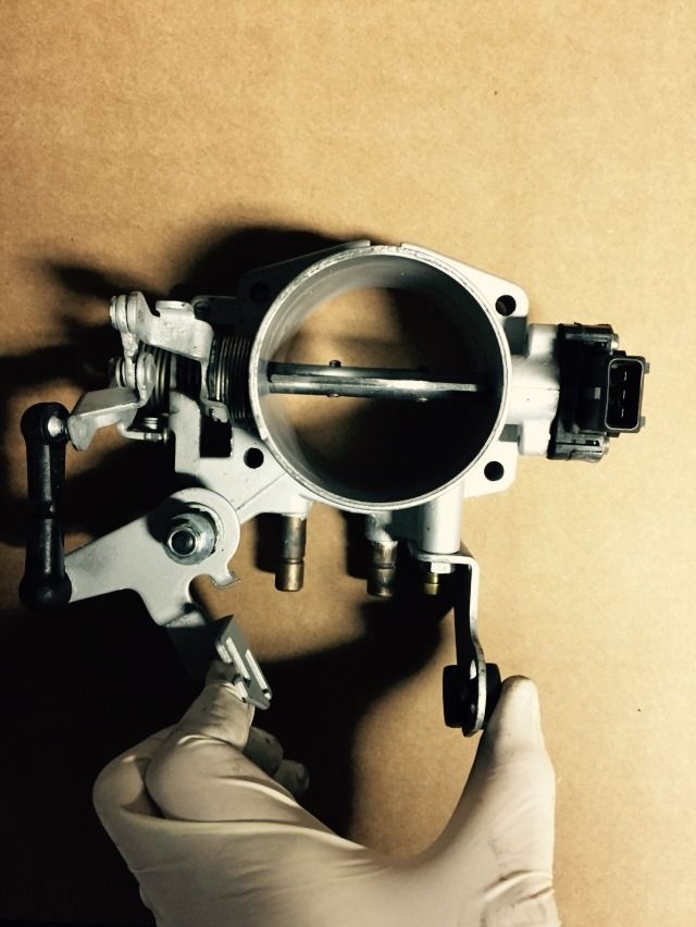

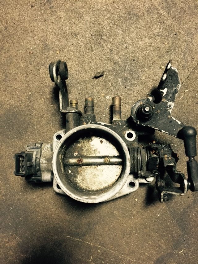

Stripped my m50 throttle body to have it bored out and larger butterfly valve machined...
Then cleaned painted and rebuilt
Managed to bore it out from 64mm to 68.9mm. Inlet manifold is 69mm

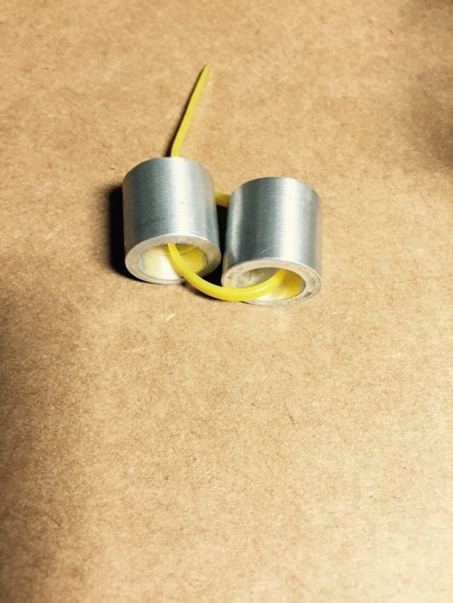

Also had some spacers machined so I can fit e46 Clubsport rack rather then using washers to pack out the bolts...

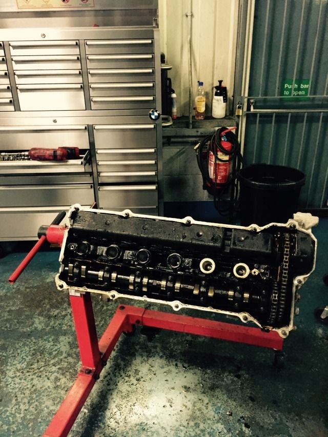

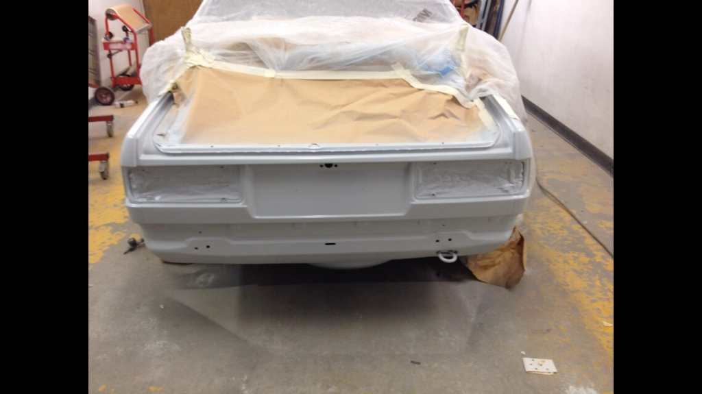

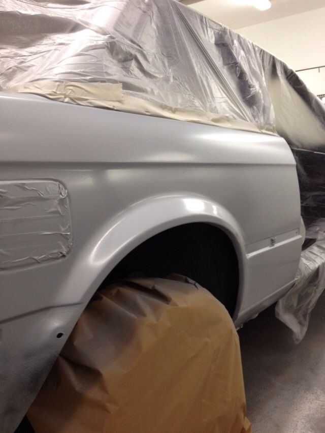

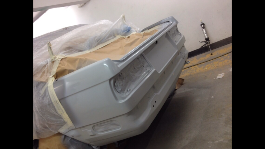

Engine cleaning up nicely...

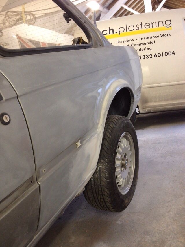

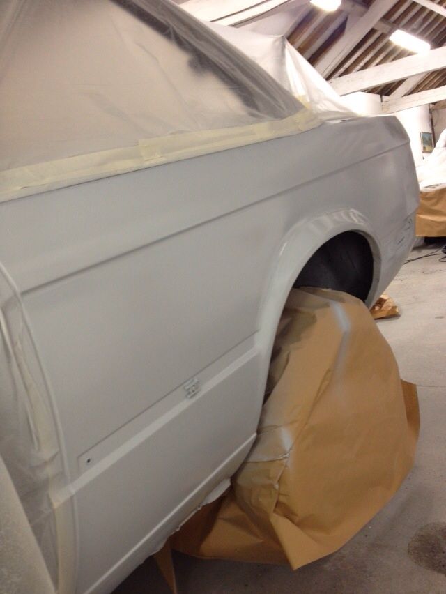

Arches have now had a skim of filler and I'll primed up. Got a good afternoons worth of prepping left then finally ready for paint. Can't wait...

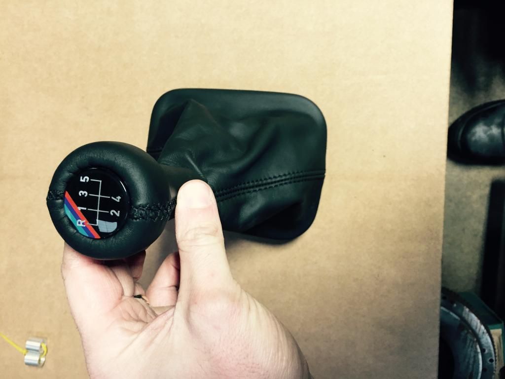

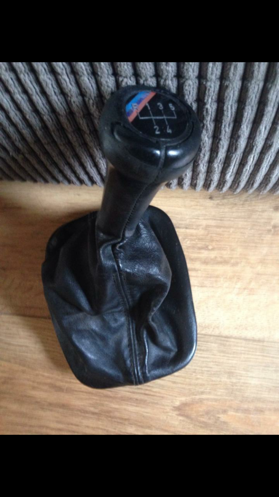

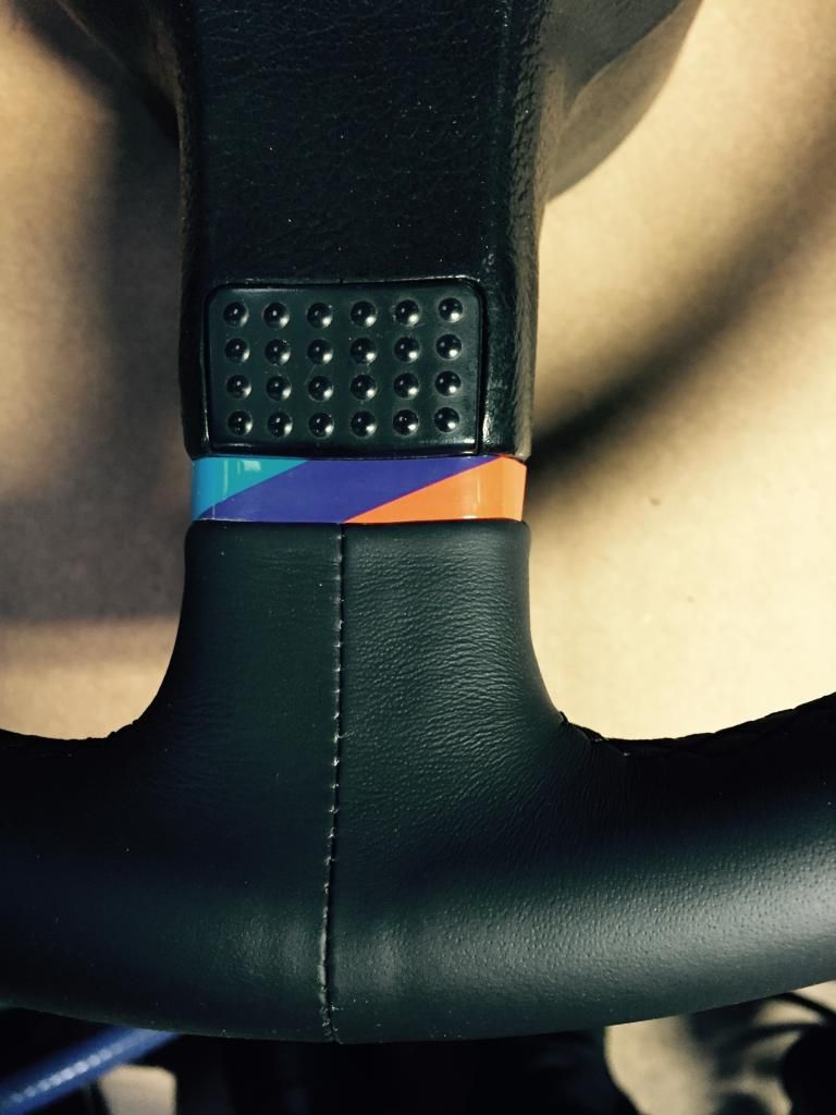

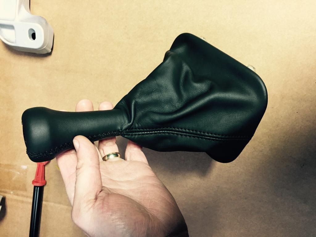

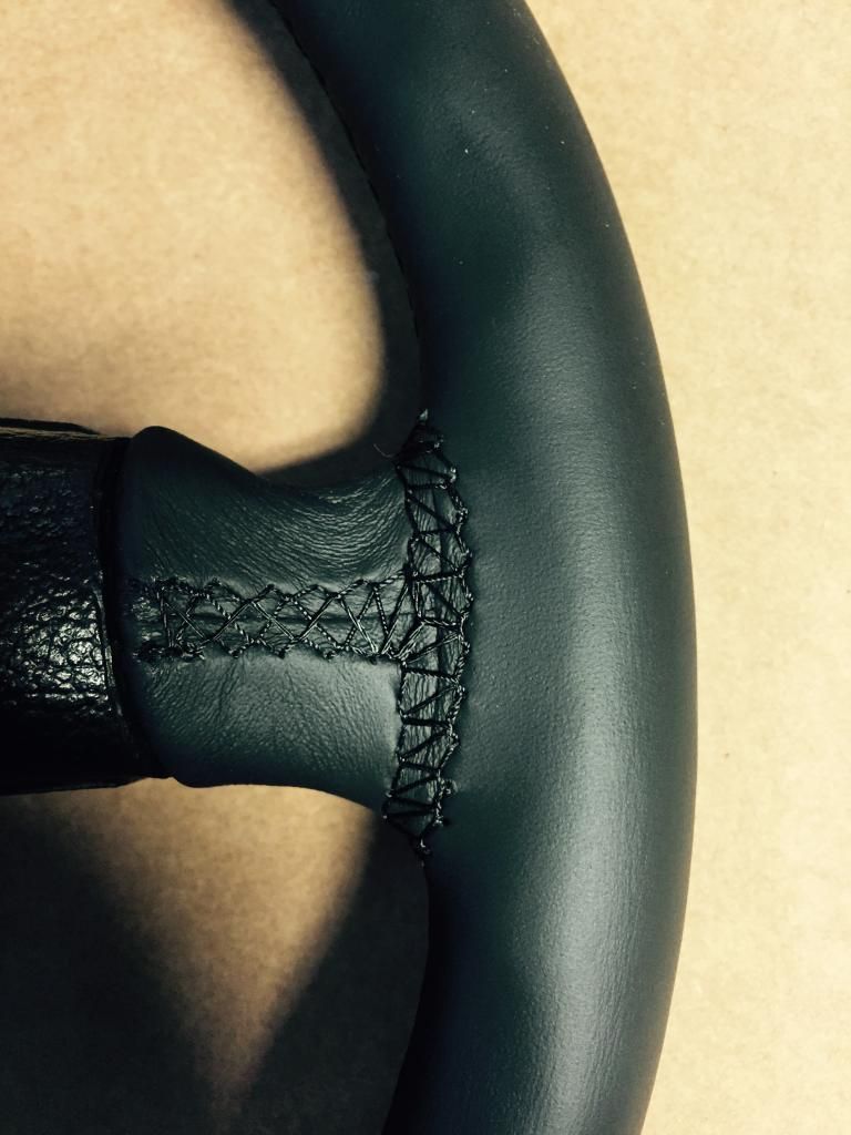

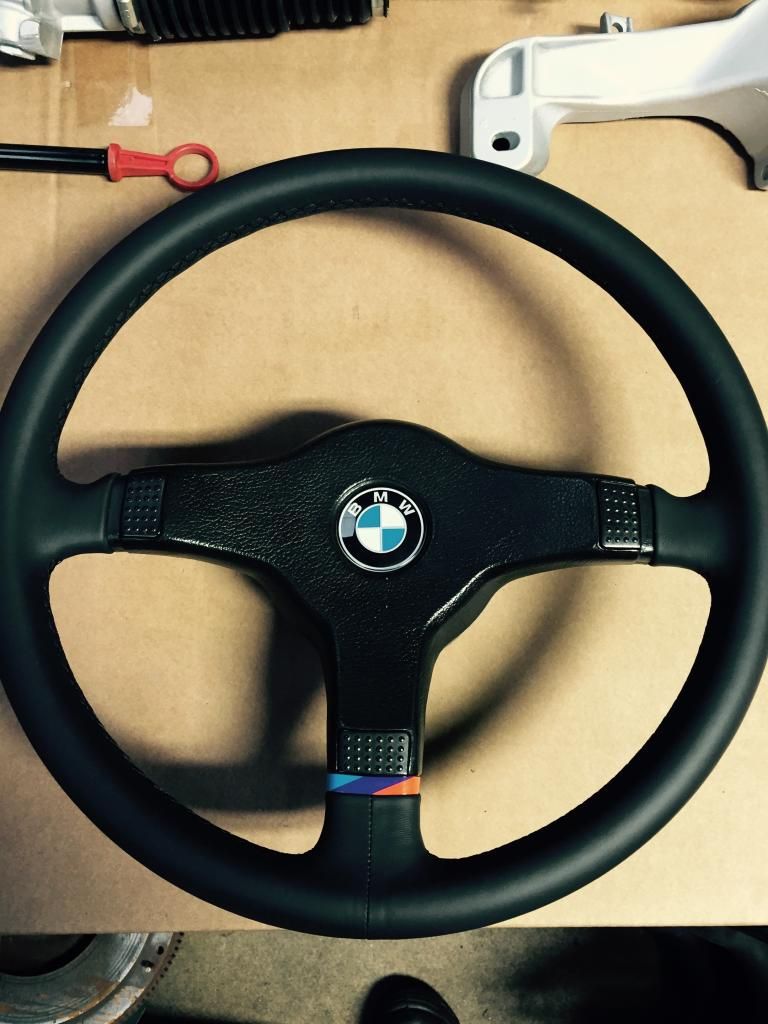

Just received my steering wheel and gear knob back from Jack at royal steering wheel. Quality job...

Wheel £105 gear knob £45

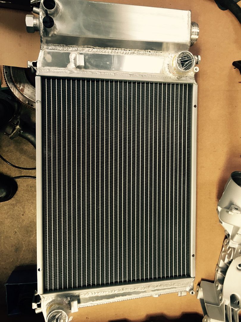

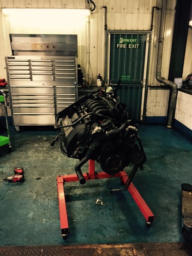

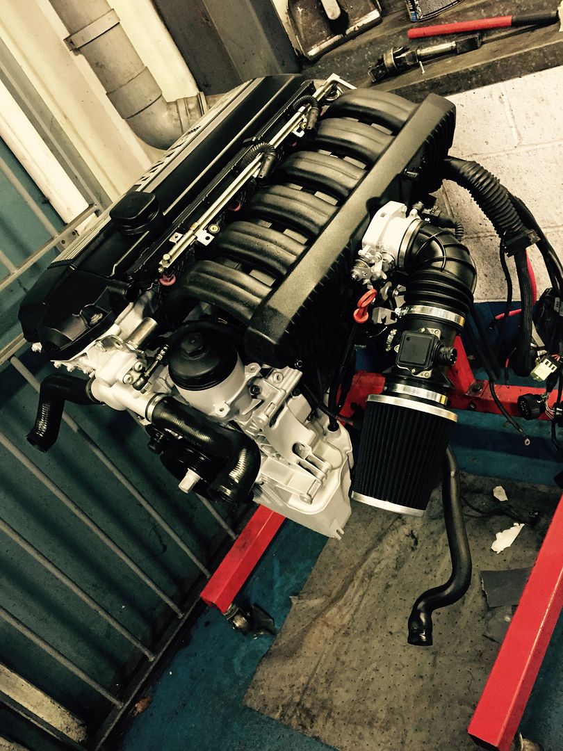

I have modified wiring loom to plug straight into e30. Fitted extra temp sensor and added wiring for oil level sensor. Fitted m50 manifold and modified a few bits to keep breather/oil separator.
Engine almost ready to go in...
New alloy rad

BTW, the stitching is meant to invisible on the side of the knob, like the OEM one, but it looks nice, and different.

That engine looks the sh*t on that stand

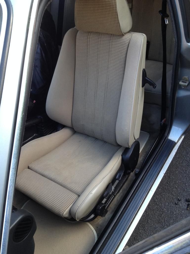

Damn, where did you get that from?P_VIDDY wrote:
Managed to source some matching front sports seats...
I have the same interior (new condition though). Searching for years now for a nice set of sport seats. Can't find them!

Some guy had them sat in his garage for years. They were black with dirt. He let me have the for £60 in the hope they would clean up
