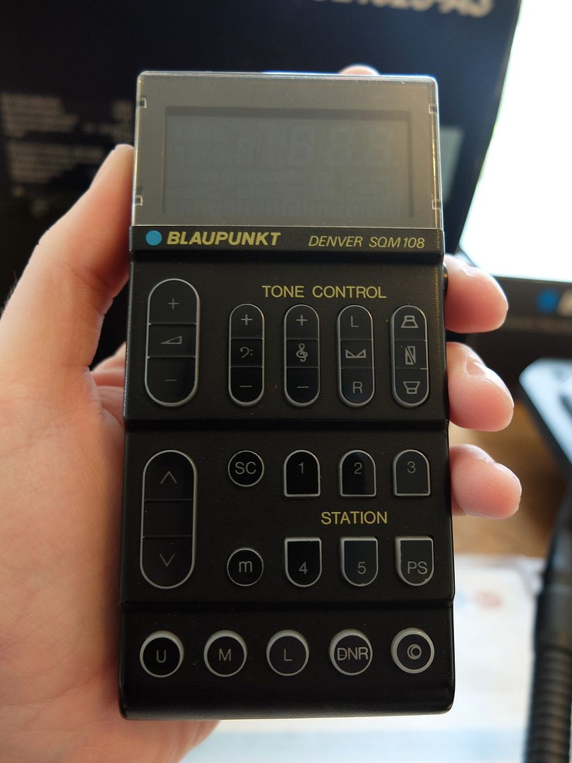

Denver SQM108
Now this was more of what I was looking for! It’s a tuner and amplifier and came with a remote control that mounted to the console on a stalk. On the remote you can control the radio settings and also has some basic equalizer options. Retailing for 505 deutschmarks as of December 1989, this wasn’t cheap.
