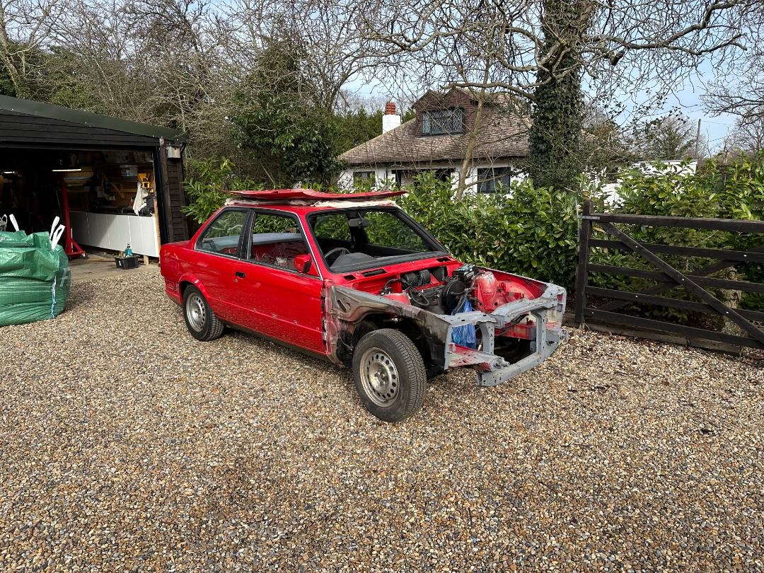

Not updated here in a while and a lot has changed over the last 8 months or so. Although unfortunately the car is still no where near completed! I have sopied these posts from another forum so... here goes
Subframe came off. I started cleaning it up but then got bored very quickly and decided it was easier to drop at the sandblasters.
24 hours and some primer later.... its back.
Christmas meant slow progress on the car throughout December, but I have now got some parts and tools together to carry on.
Bought a pair of new lower arms, clutch slave cylinder ( that's going to be fun to fit...), steering pump and new rear lollipops.
Also got some Bilt Hamber rust treatment gel and under-seal, torque wrench, nut splitters and a rotary sander.(I'm hoping I can polishing pads for this?)
I need to get some sheet metal from somewhere to start with the welding as this is whats holding me back at the moment. Luckily a friend has said he would help out with this as I'm a novice! Updates soon! (I hope)
- Ashley1995
- Posts: 91
- Joined: Tue Jun 03, 2014 11:00 pm
- Location: Surrey

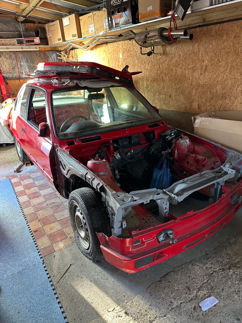

The friend doing the welding came over yesterday to take a look and give me some pointers.
He said i need to do a bit more cutting and prep work. Also where there has been a repair before, on the drivers footwell corner, to cut the repair out and start again. be cleaner and a better job this way. Unfortunately I may be removing the wiring loom sometime soon too... I was hoping I wouldn't need to but i'll need some more room around the fuse box to repair a patch here.
Other than that iv'e got another (that's 4 now) Steering pump which is correct this time, so iv'e cleaned it all up and that's ready to go eventually. The front struts are off and iv'e started stripping them down ready to be cleaned/painted etc
All good fun
Spent all day yesterday on the car. Cut out more of the rust, stripped more down and pasted loads of BiltHamber gel over some areas.
Took out the interior to cut the rust out, and wrapped the seats in shrink wrap to keep them clean and that.
I've got the carpet out and the passenger side is wet, and the underside is stained blue..... This shows where the coolant leaks from then
Now on the hunt for some good front wings. Both wings are mostly okay but along the sill is rusted out.

It's been a whole 8 years since I last posted on here and about the same amount of time since I last properly worked on this car... A lot however has happened in that time and more importantly, over the last 6 months I've dedicated every spare weekend I could, to focus on getting it finished and back on the road.
Really, the work halted for a number of reasons. Lack of skill, ability, tools, finances and therefore motivation. I then changed jobs, moved house, bought other cars, had a big car accident and went through a breakup.
Finally though, I had some money spare and found the motivation to push forwards.
The car was fully stripped and sent to a bodyshop in March 2023. The owner was a friend of a friend, an older gent who takes time and pride in his work. He had the car for almost a year until it came home to me in March 2024.
The full car had an entire respray, in the original 138 Zinnobarrot. All bodywork repaired as needed, new front wings fitted and the underside re-treated in a new coating. Multiple panels had surface rust and corrosion that needed addressing, both doors for example. Repairs were made to both front corners of the passenger footwell, the sills, the rear arches were cut out and replaced, the list goes on.
Once home, I had a couple months away on business so work started again in anger in June. The work completed since then is too long to list, but primarily;
Engine parts replaced (water pump, timing belt, thermostat etc) and then re-fitted, all suspension replaced, brakes and brake lines replaced, interior re-fitted, glass fitted, wiring loom repaired and re-taped, body panels re-fitted, clutch replaced, gear linkage rebuilt (with the Z4 short shift mod) the list goes on.
Wherever possible I've replaced clips, seals, filters, hoses, o-rings, bushes, fuses, relays, bulbs etc.. All fluids are fresh and clean with multiple flushes of coolant and oil.
Once the engine was in and everything connected, we fired her up for the first time in 8 years. At first I had no fuel so replaced the fuel pump and primary relay which did the trick. She started on the key with no issues. We've run the car up to temp multiple times and it holds temps and pressures as it should.
Next steps then, left to do is a short list.
Bleed the brakes, re-fit the exhaust and prop shaft. Sort the tracking, check everything is torqued to the correct specs and then get it in for an MOT. There's a handful of small cosmetic bits I am not that happy with, mainly with the interior, but I am focussed now on getting it on the road, I can replace these parts later.
I'll add some pictures in the next post,
