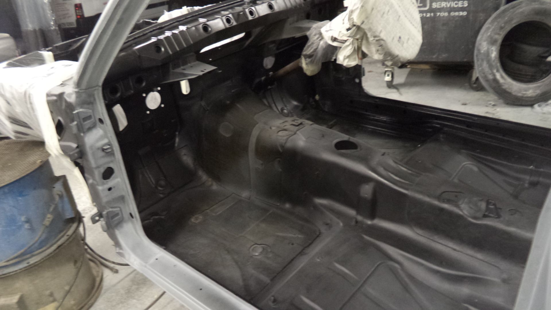

I would suggest giving that bit of brown to the left of the clutch pedal on the seam sealer a poke though, mine looked just like that and it turned out to be a 50p sized hole.
bmw-mad wrote: Driver side foot well area

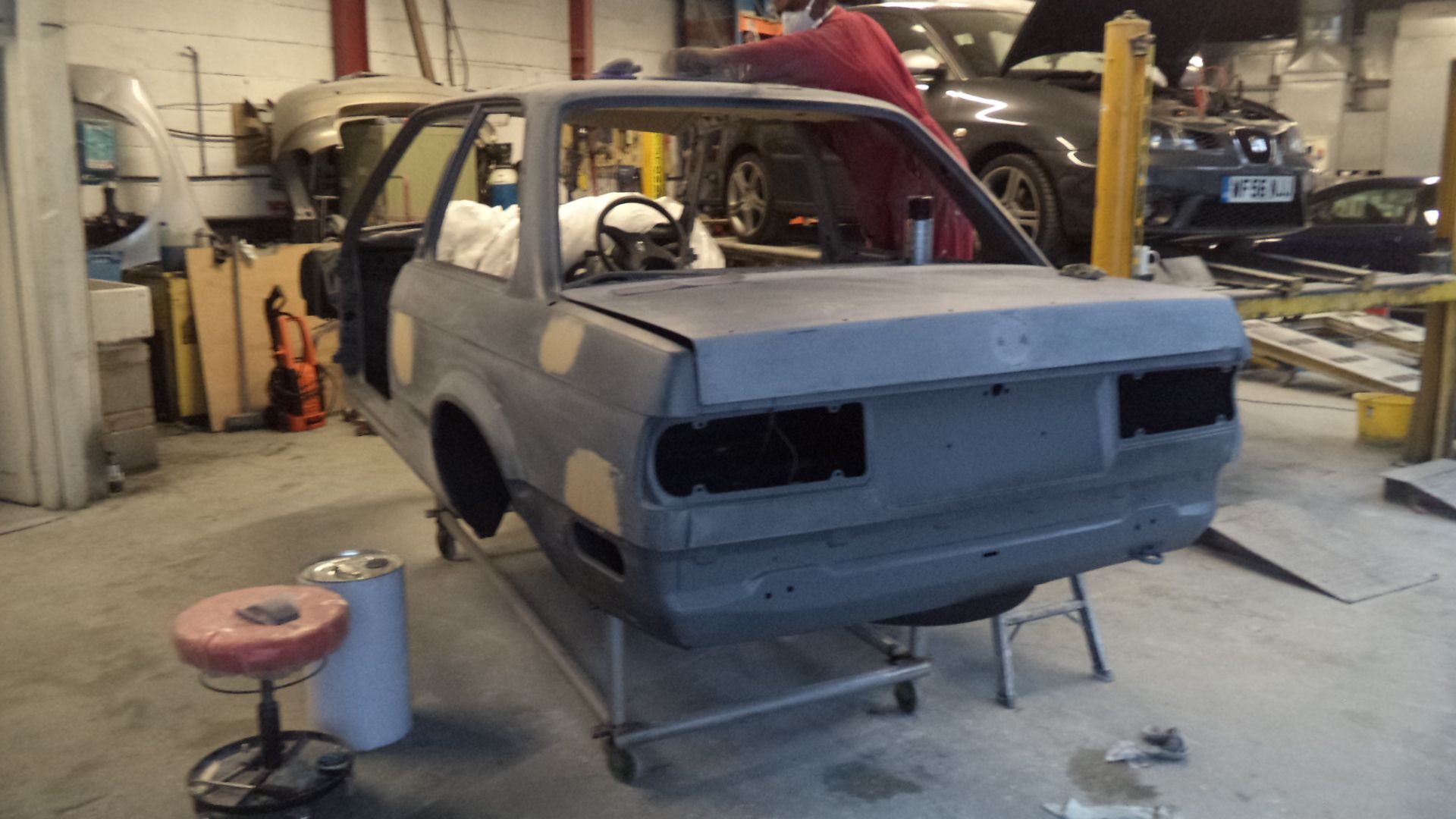

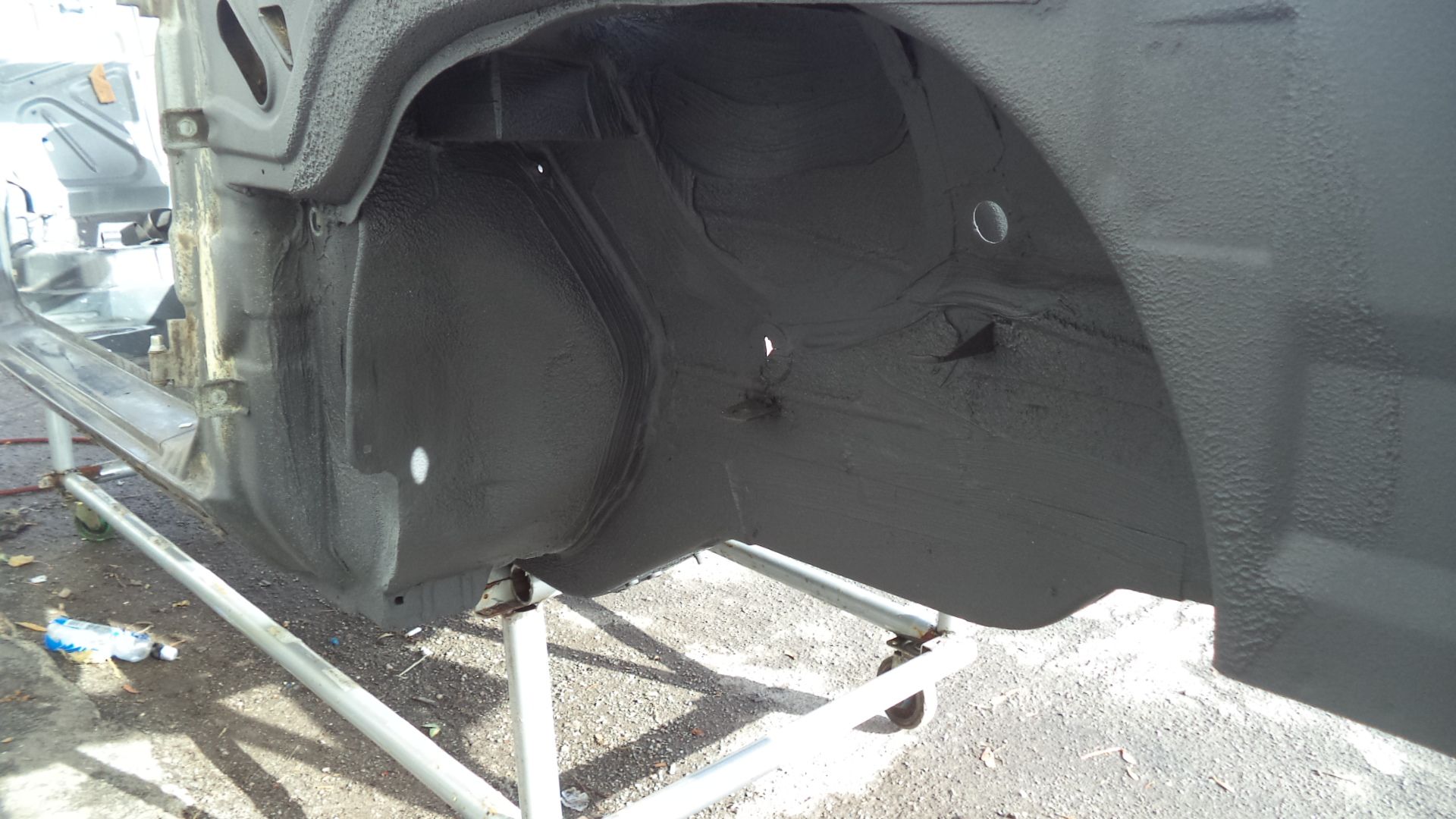

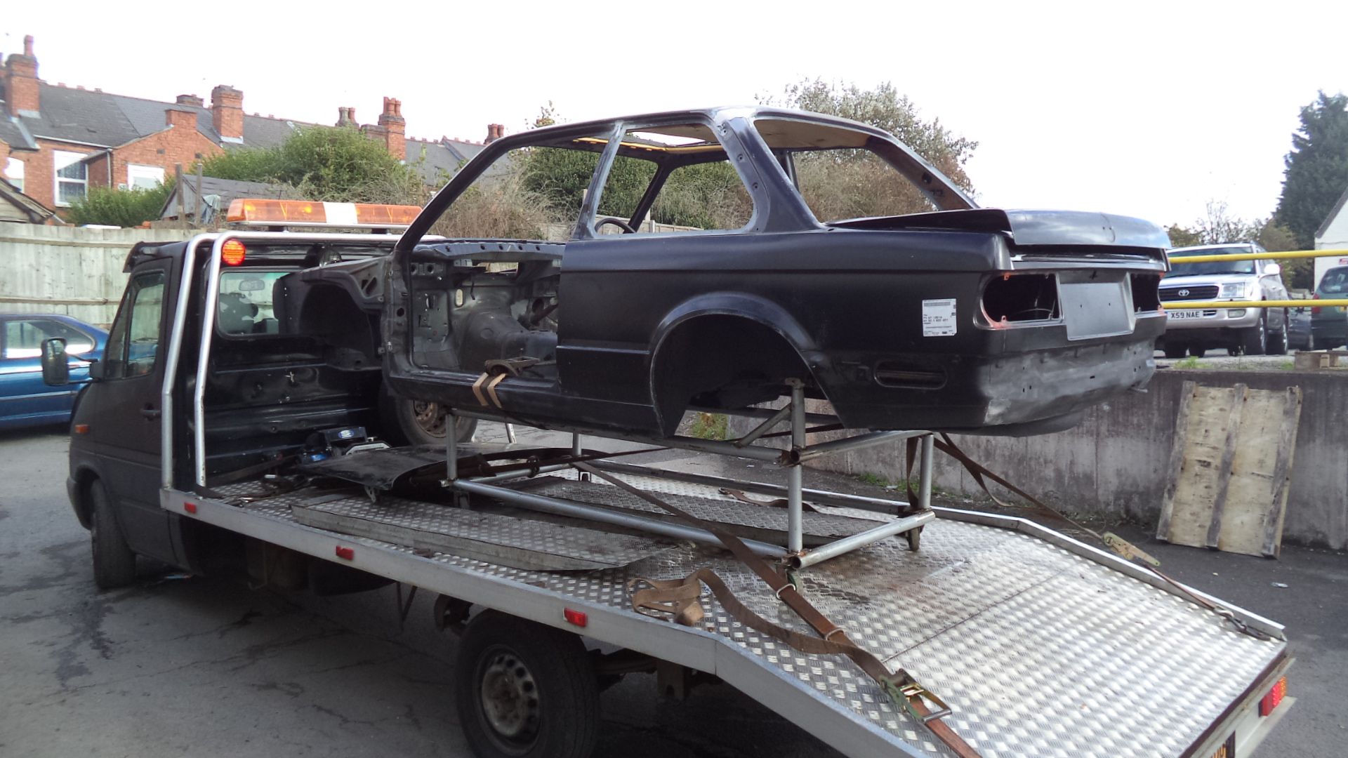

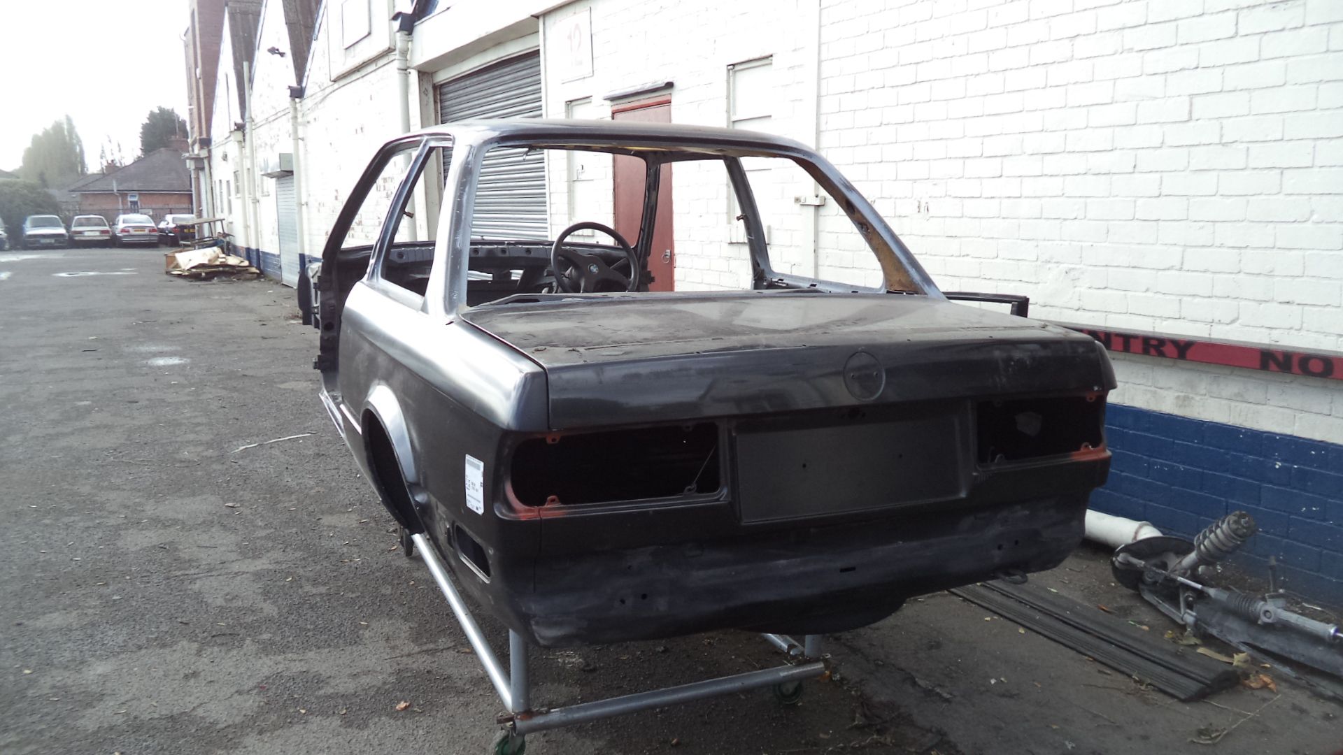

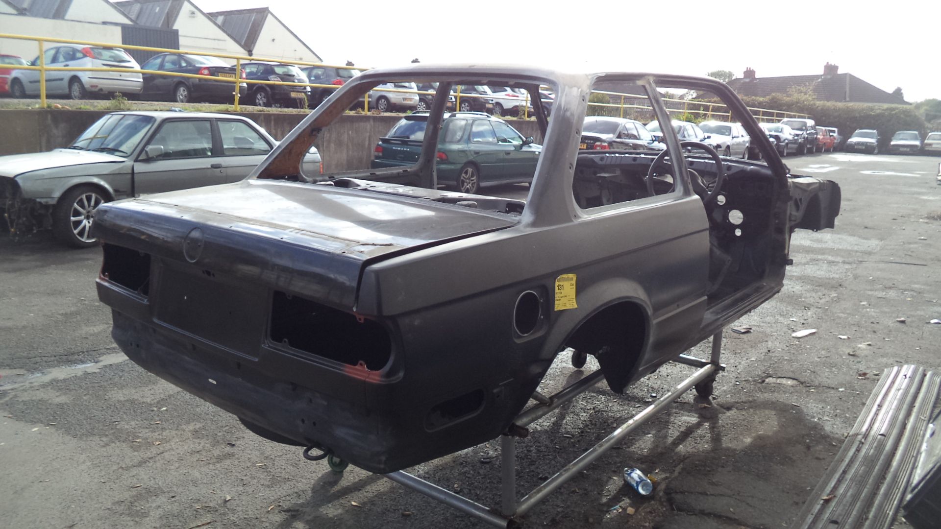

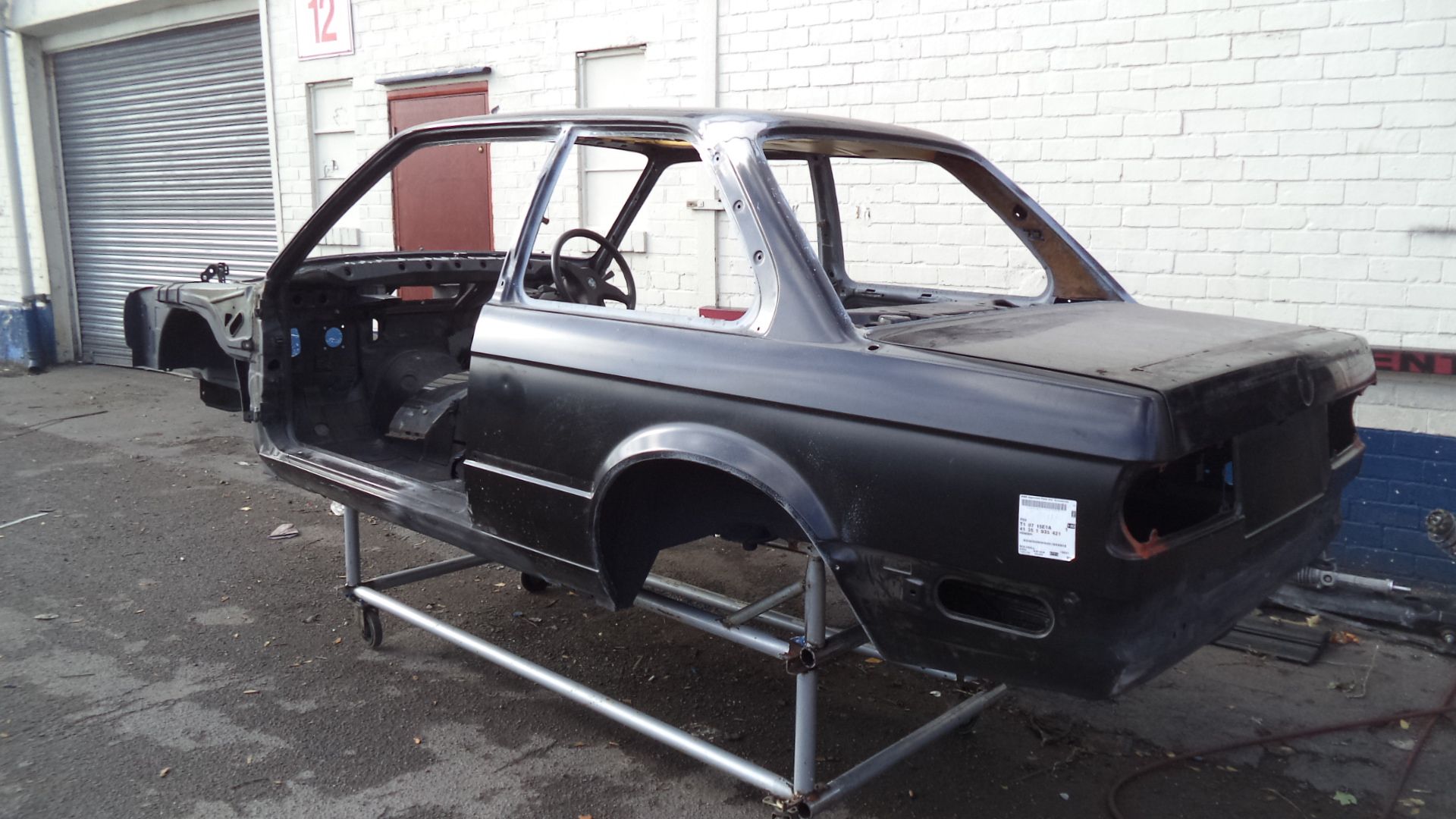

An overdue update
Car was sitting in the back of the workshop for a few months as work picked up and the body shop was to busy to take it in.
But a call from the body shop saying he can take it in got us motivated again!
So what ever needed tidying up was treated and covered with sealer and stone guard!
the whole underside has been stripped and stone guarded really happy with the result of the finish.
Unfortunately didn't get a chance to get pics of the underside while it was on the ramp, but will add some when its back up there.
Not a lot of pictures but here's how it looks just before it got to the bodyshop last week.
On the truck on it new wheels :D
Should be back by the end of next month, its pretty much getting painted inside out.
Just getting the suspension components ready to refurb and rebuild for when it comes back
jimbom30cab
Tech 1 freak
Posts: 7634
Location: in the garage
Tue Oct 28, 2014 10:07 pm
Great update, what did you use to stone guard under?

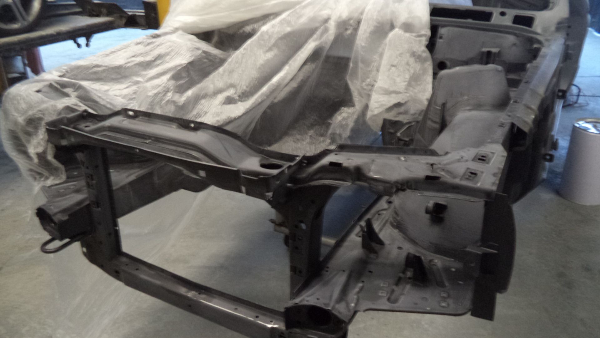

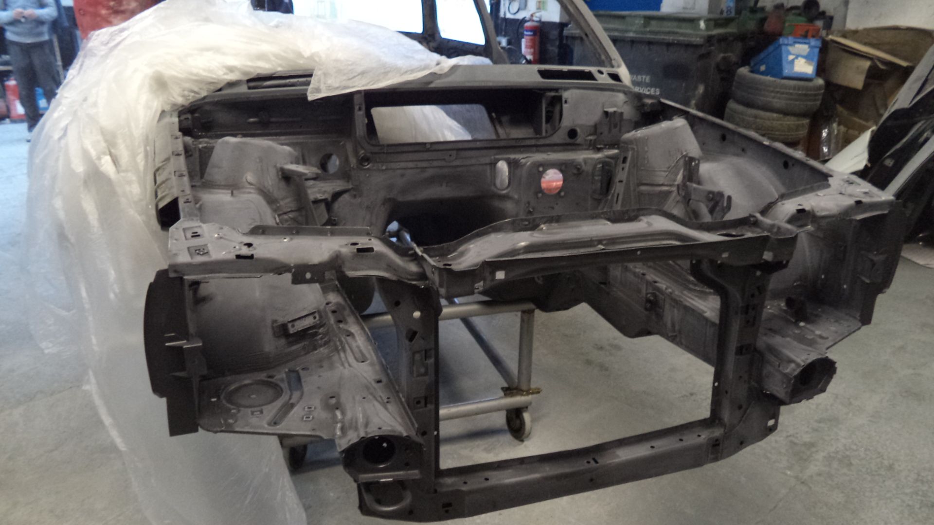

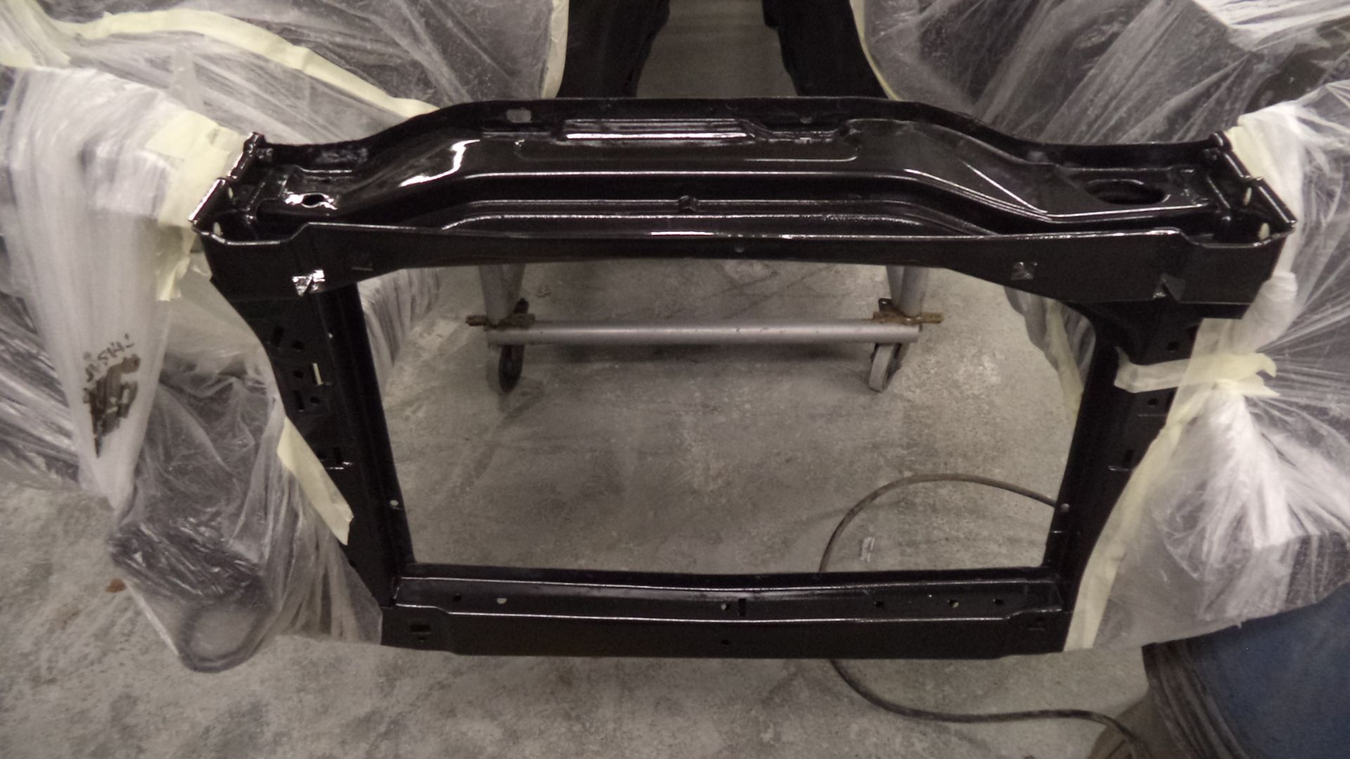

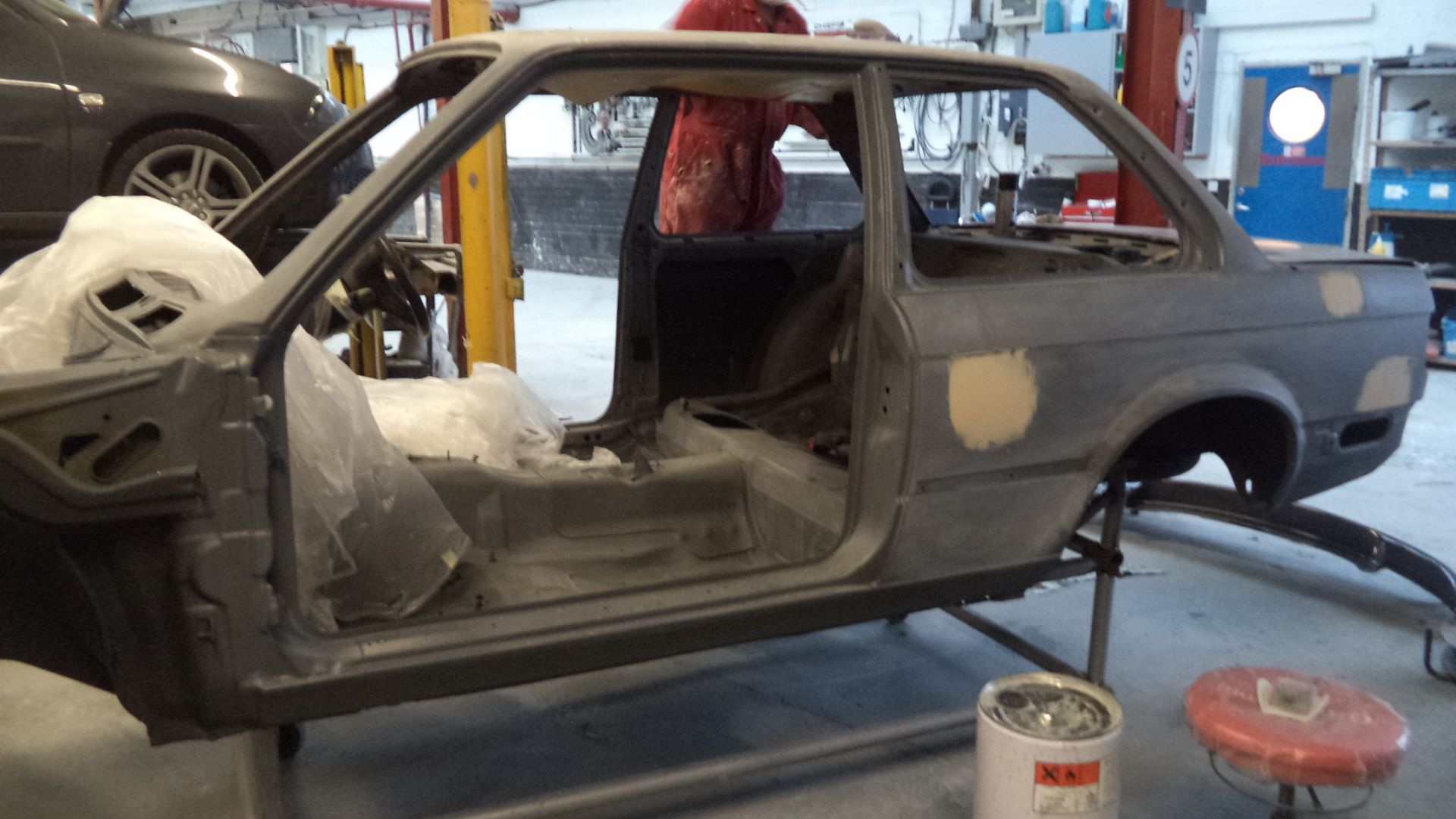

Another update
Things are moving along nicely at the bodyshop.

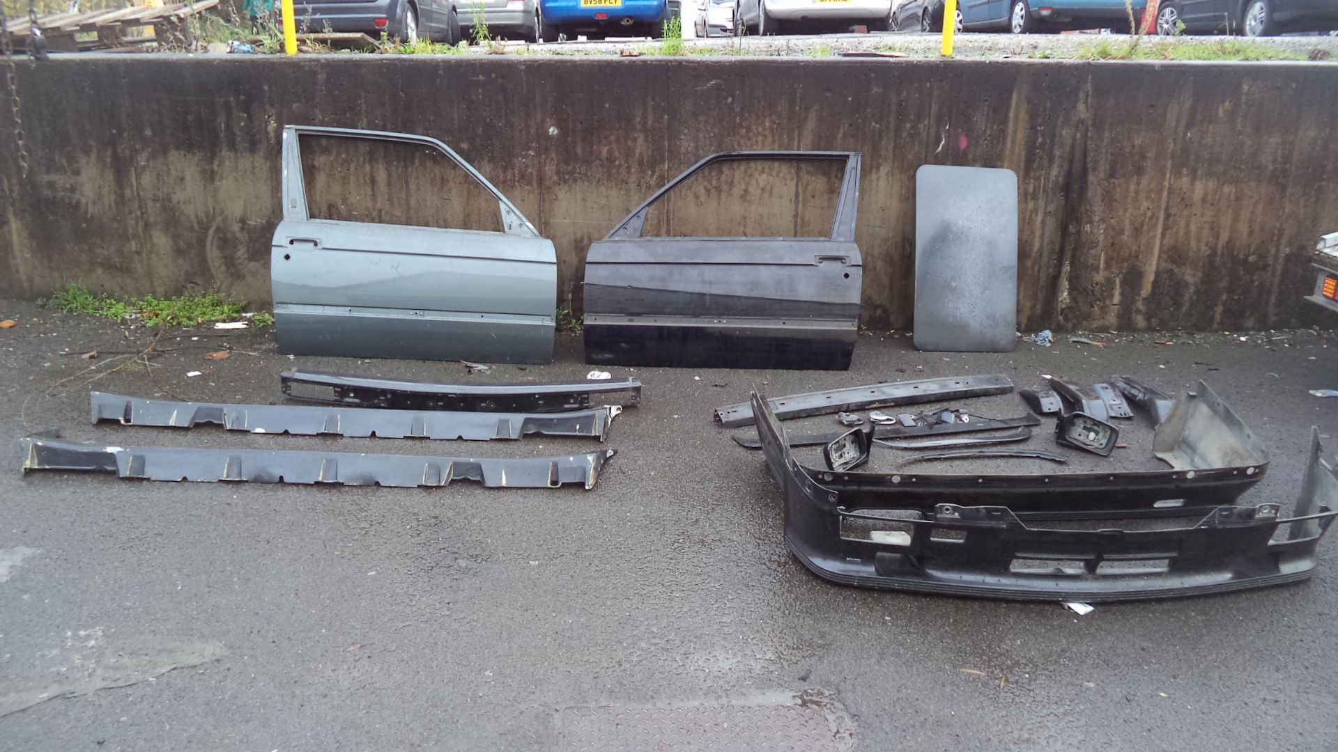

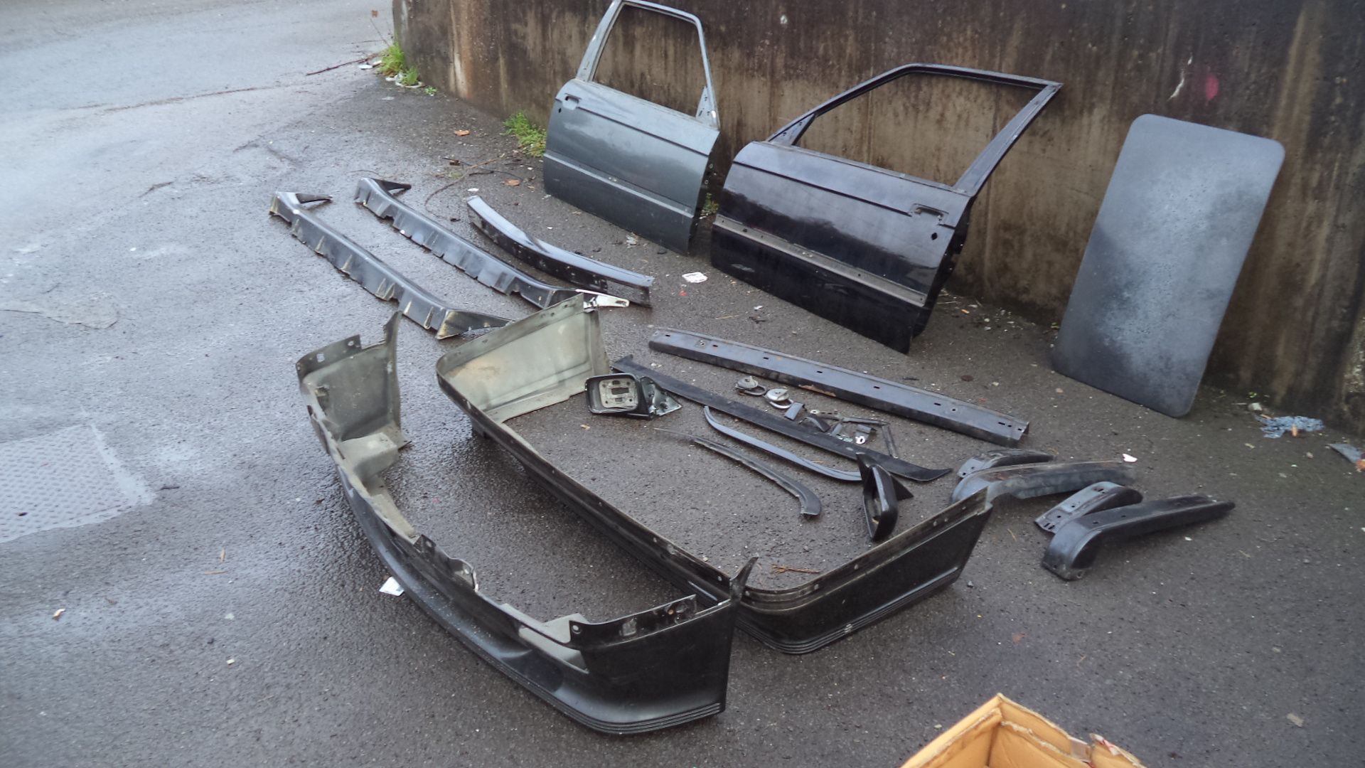

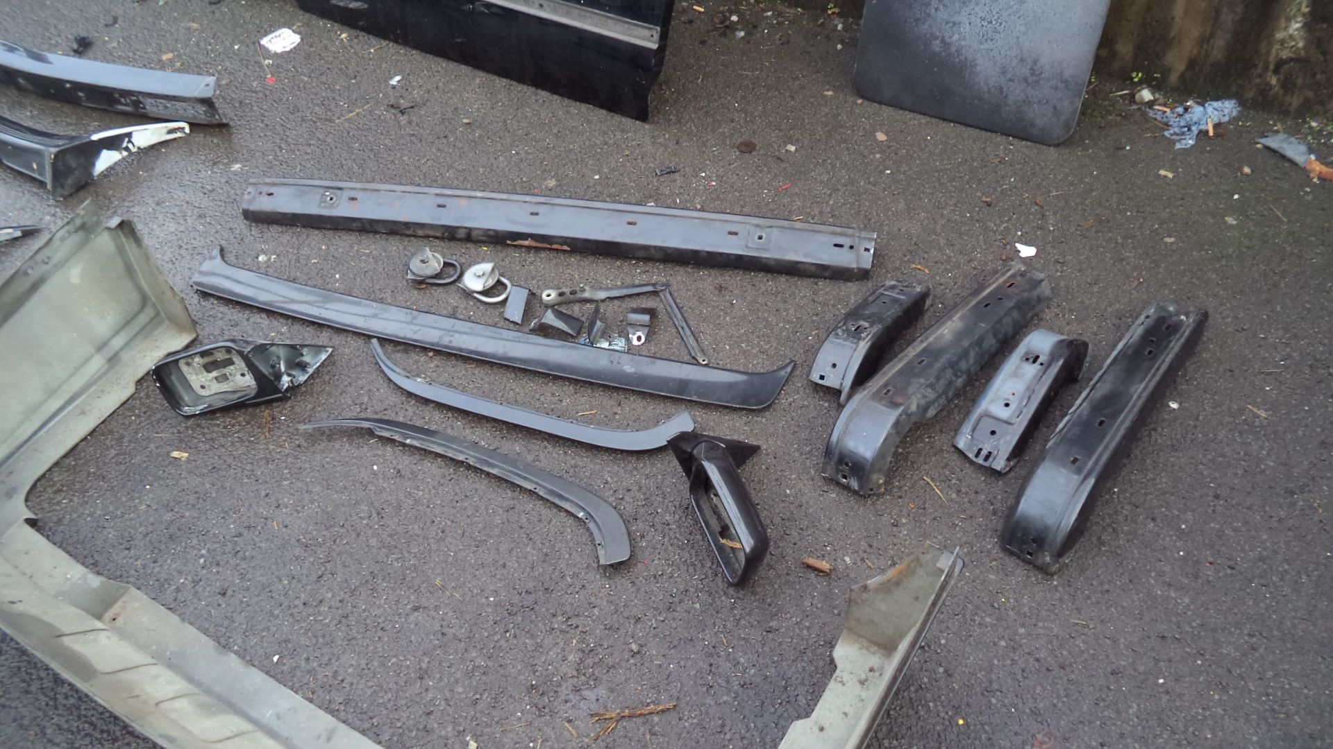

They have been bugging me for the panels,trims and kit to be dropped of,, so a bit of time was taken out to strip all the bumpers, doors etc
Here's some pics of all the niggly bits stripped getting loaded up

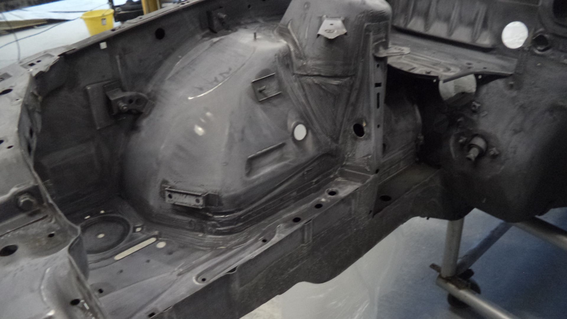

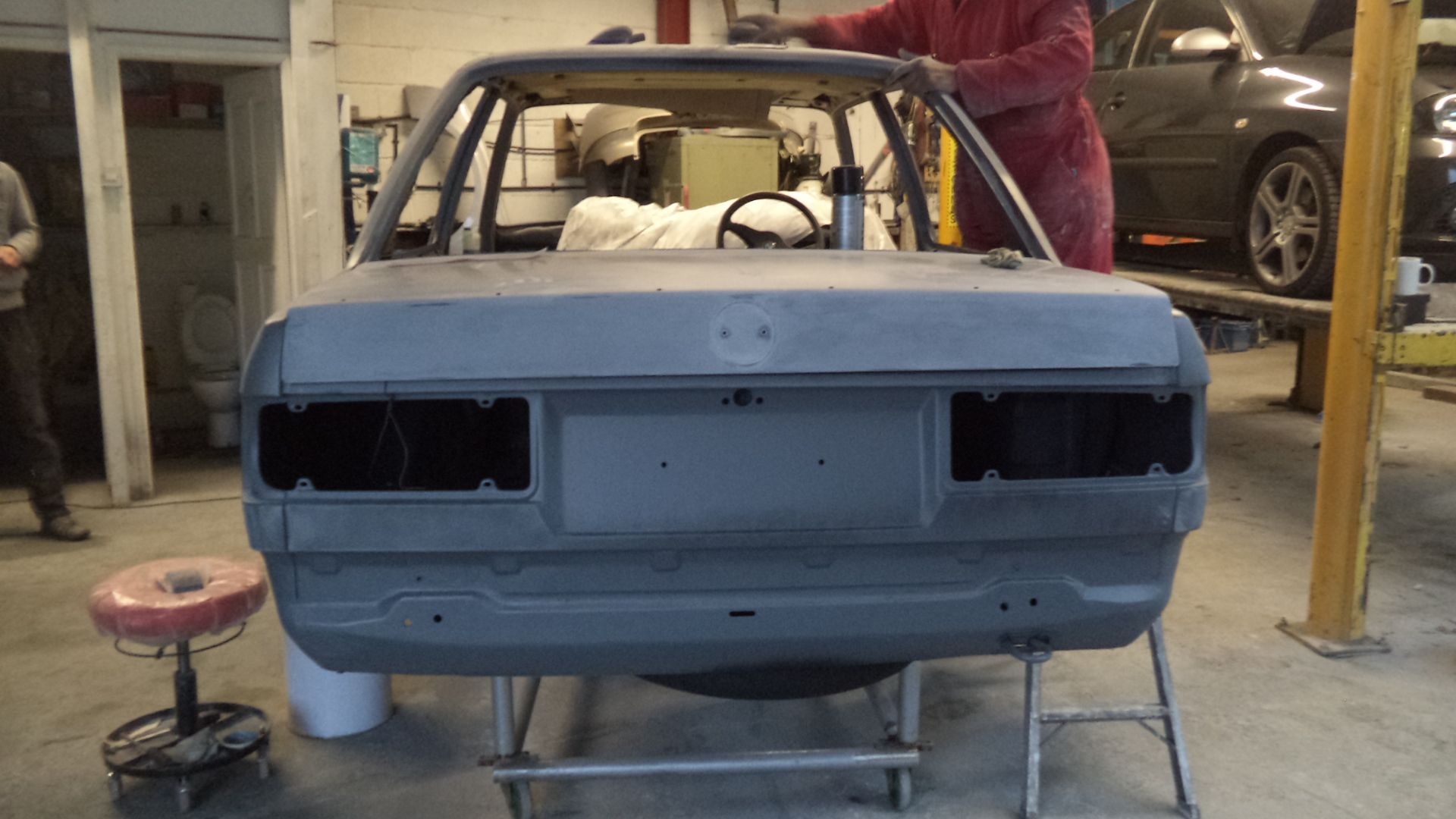

And some progress pics at the bodyshop

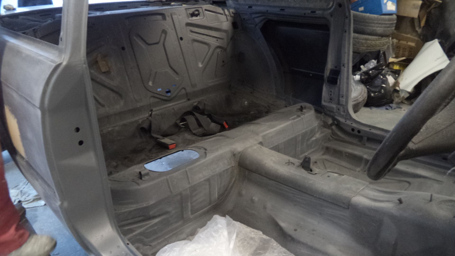

Shell has been prepped primed and getting prepped again.
Engine bay is looking good, it didn't really need doing but it would have been rude not to as we have gone this far with it.
Inside should hopefully been in colour this week :)

Wed Nov 12, 2014 10:42 pm
A very thorough job!
Although i've got to ask, why when the car has been picked clean of all other parts, the rear seat belt buckles are still in?
bmw-mad
Posts: 2684
Location: Birmingham
Wed Nov 12, 2014 10:51 pm
bss325i wrote:A very thorough job!
Barry I asked my brother the same question after uploading the pics!
I've reminded him to remove them when he pays a visit tomorrow.

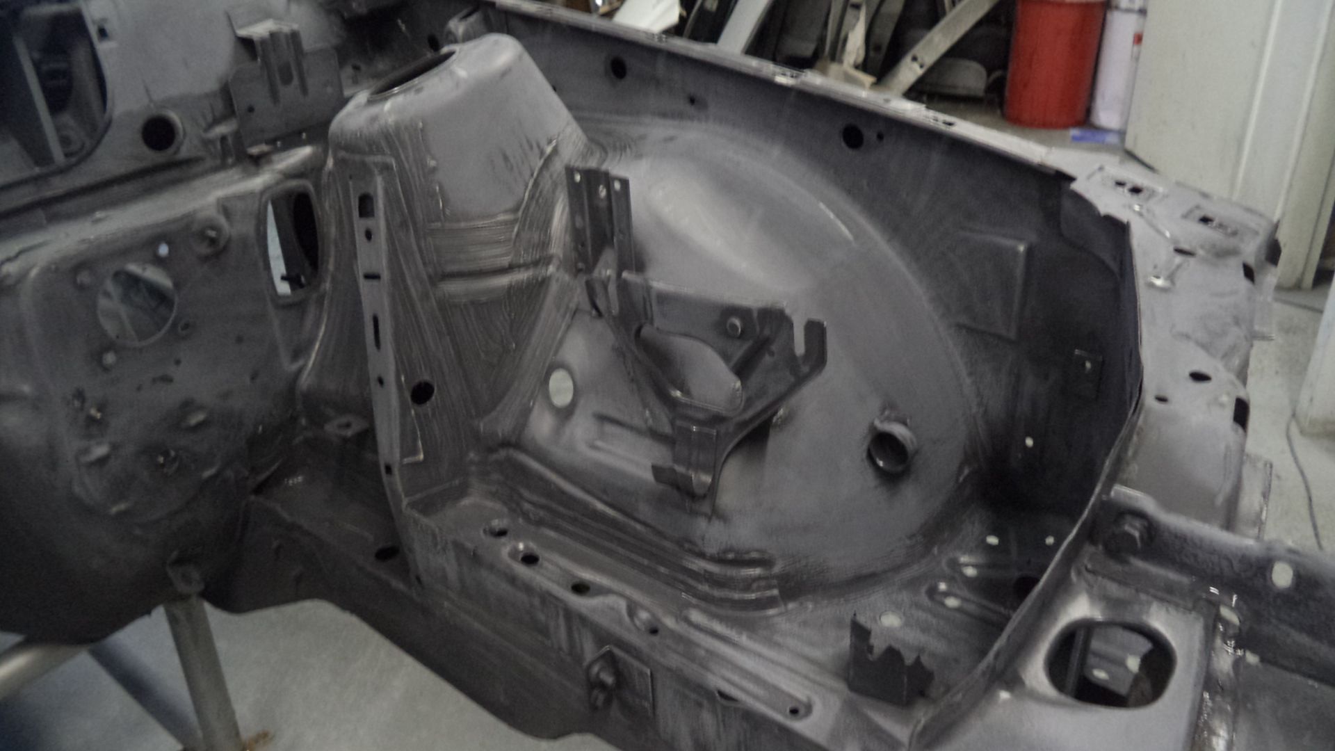

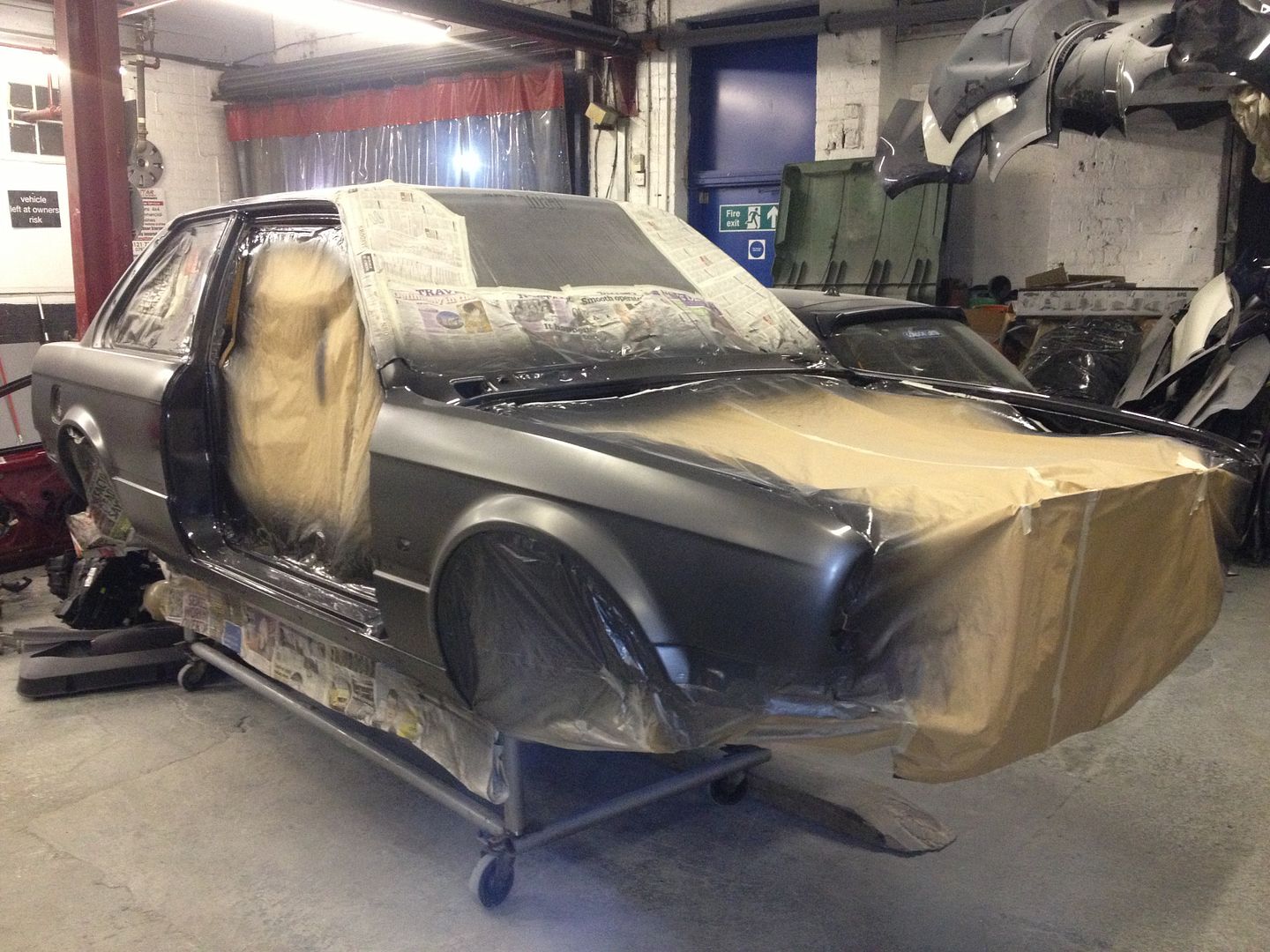

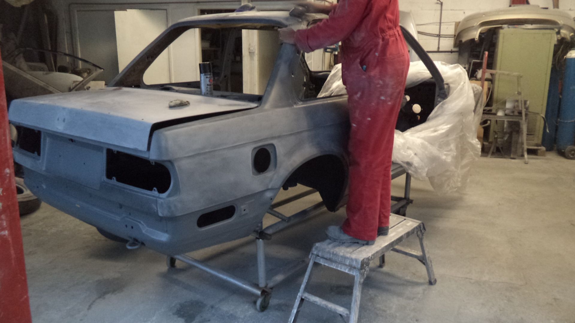

Sun Nov 30, 2014 7:08 pm
Thanks for the comments guys
Not really had a chance to go over the bodyshop
last time I went last week I forgot to take my camera but got crap pics on my phone!
Was moving along nicely all the insides etc have been painted engine bay and boot look excellent, well happy with the result!
The body has been flicked over also
My crap pics
We got the wings hanged in place as we wanted the seal at the top sealed before it got painted to get that factory finish.
Hoping to pop over tomorrow to see progress and get some better pics
Will update again tomorrow
Andyboy
Alpina Colada
Posts: 12576
Sun Nov 30, 2014 10:33 pm
It would be worth fitting and adjusting the doors before the psint goes on - they're bloody heavy. When gapping them set the rear or the door slightly high as the fully built up door weighs much more than a bare one.
Fabulous restoration - nice to see these being saved now.
Mon Dec 01, 2014 12:00 am
Nice job :cool:
I agree with Andy, get the hinges adjusted if need be before painting them

Andy/dan that is the plan, the body shop guy is waiting on us to come and fit the Pannels up for this very reason.
We don't want to be faffing around once it has fresh paint!
