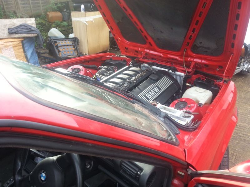

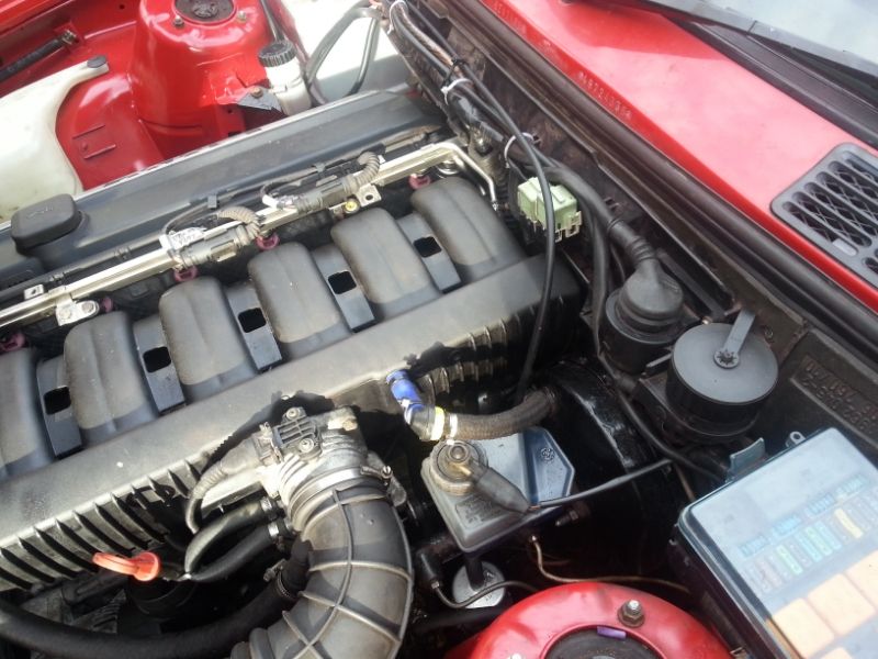

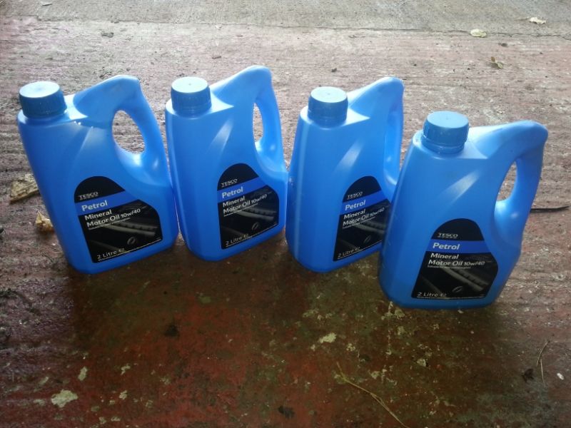

Okay, catch-up time! So, once she was starting aok, we set to getting everything else together. Despite having used an M50 inlet, i'm using the M52 Throttle Body, which means the wiki-recommended E34 525 throttle cable is not very well suited. So i'm using an E36 328 one! Bit of extra length means it neatly stows within the loom-tidy, making it much easier to replace etc, and still largely invisible in the bay. Once adjusted, it works perfectly!
Nice (crappy) running in Mineral oil...
The bay...

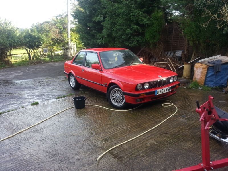

And for her first time out of the garage, a good wash and a dash of sunshine before heading off for the MOT!

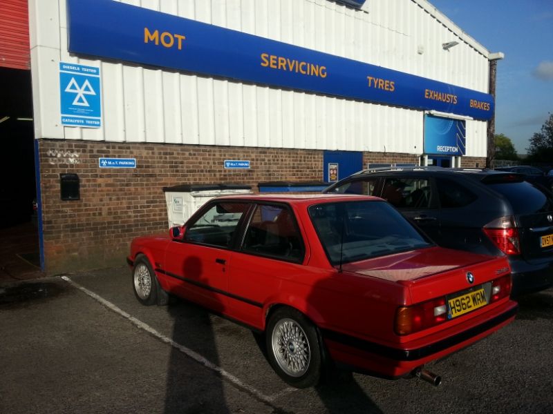

We had a bit of drama at the MOT - We'd got the electric fan up and running the night before, but the fuse had blown as we got to the MOT place, but luckily we caught it in time before it got too far. Passed though, and as you'd expect, NAILED the emissions clean as a whistle.. 0.295% & 120.
Bit of an oil leak turned out to be the dipstick not quite in enough, and i'm going to have a custom fabricated exhaust made up (same tailpipe) as this one just does not fit the e30, despite being an e30 325 system - Thanks, Sportex. (Yes, i know it's a cheapie, but needed something to get her mot'd!). Sounds good though... Now has a good 170 miles under her belt, running in nicely!

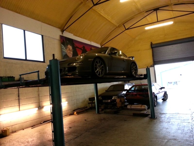

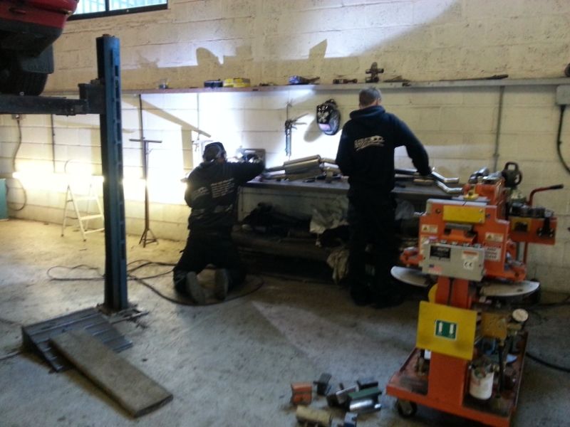

So, bit of an update.. Hadn't done much due to being busy with work, and being in the middle of a 5-week pay period (ouch), but i went to Infinity yesterday to finally have a stainless system made to fit. Very chuffed with it too, car feels more solid for it, as they made some decent mounts for me too, and added an extra one as well.
Build pics (Unfortunately not the greatest quality photos)..
All lined up, complete with crossover..
Welding it all together..
Unfortunately, i didn't get a pic of it back on, as i got chatting to a guy that came in in an E36 323 whilst they finished up, and talked him through the M50 inlet stuff! Anyway, they did a great job, definately recommend their work for any Bristol/SW zoners. I'll grab some more pics next time i have her up in the air
Oh, this nice GT3 was in too. Had a good gander around the flat 6, as i've not seen one up close (and underneath!) before. Nice!

Just for now, here's a pic from the MOT Matt sent me a while back..

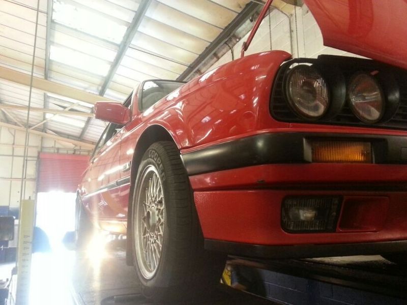

Ok, so as well as having a good blast out to a meeting i had today, i popped over to my folks to say hello, and borrow extra tools/driveway space/a second set of hands.
As it stands, i've covered just over 1200 miles since putting the engine in, so as well as deciding i better buy some oil & a filter tomorrow, we decided to do a compression test, just to make sure all is well in the hood. Really excellent results:
Cyl 1 - 182
Cyl 2 - 185
Cyl 3 - 185
Cyl 4 - 184
Cyl 5 - 184
Cyl 6 - 185
Plugs also looking super healthy too - Truly a testament to the quality of Dan's engine rebuild work. This is only one of them but all 6 are identical - Basically, exactly as you'd want them to be..

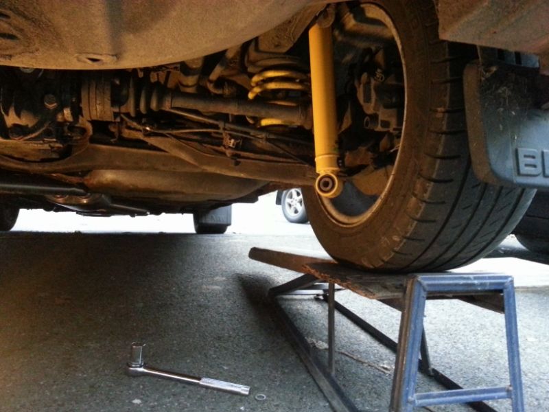

Also finally fitted the 2,000 mile-old Spax Adjustable dampers & E36 top mounts courtesy of Mick, to replace my seriously aged Billies. We had some fun pushing them all the way in then pulling one end each - The Spax are a serious upgrade at this point.
Old Vs New:
Accessing the Top Mount nuts:
Getting lined up.. Should point out at this point that the car needs a wash!!
I must have dropped a sleeve out of one of the shocks whilst upwrapping like a total plank - luckily, after a mere 1 minute of attacking with a file, we managed to make use of a bolt sleeve from an old Rover SD1 towbar, that actually fitted the bottom shock bolt better than the standard sleeve in the Spax shock that i hadn't unwrapped like a ****. Needed a quick date with a hacksaw and then another minute with the file to make nice, but i might rob the other sleeve he has next time i'm over ;)
Even from the quarter of an hour drive home, it is a HUGE improvement. Rear end drops far less under acceleration, and nicer through the corners too. Now very excited about refreshing the whole underside, as even the damper switch makes the car feel more solid.
Old Vs New:
