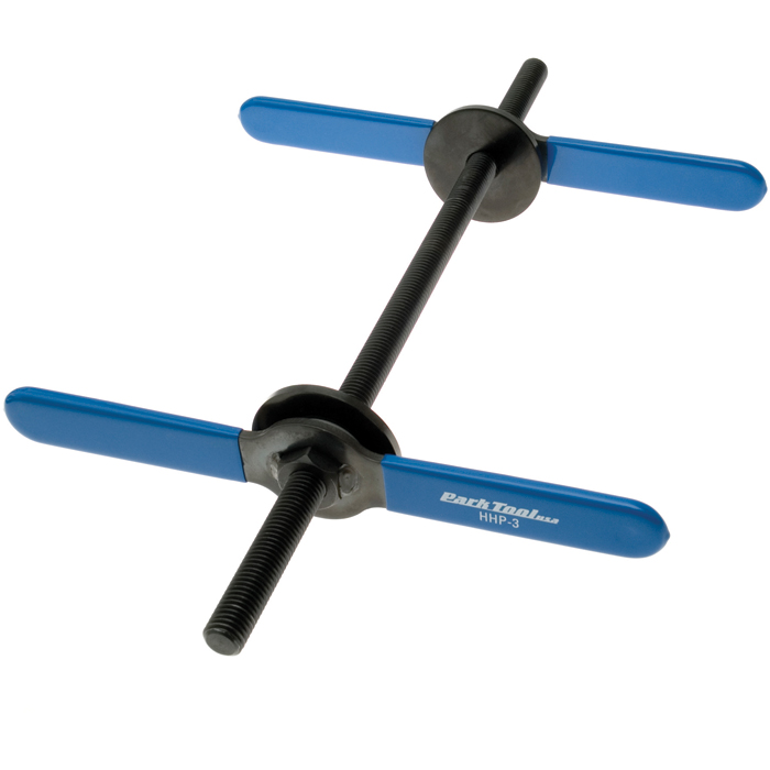

Update! more goodies from this week
Gotta squash these in soon! I reckon a sash clamp should do the trick!! :)

mcbonio
Posts: 1868
Joined: Sun Feb 12, 2012 11:00 pm
Sat Feb 08, 2014 12:15 pm
I wouldn't use a sash clamp, you're not going to get even pressure on all sides of the bearing. Use a bearing cup press.
Or if you have some threaded rod and big washers you can make your own.
Jamie8GTi
Posts: 330
Joined: Fri Mar 01, 2013 11:00 pm
Location: Suffolk
Sun Feb 09, 2014 11:48 am
mcbonio wrote:I wouldn't use a sash clamp, you're not going to get even pressure on all sides of the bearing. Use a bearing cup press.
I was going to use a sash clamp with a pre cut spacer I made that I used to knock the old ones out, but seeing how simple they are and considering I have four to do, Might give making one a go! cheers for the heads up!
