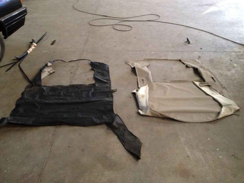

Sport headlining

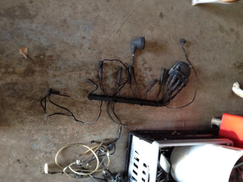

Ignition leads:

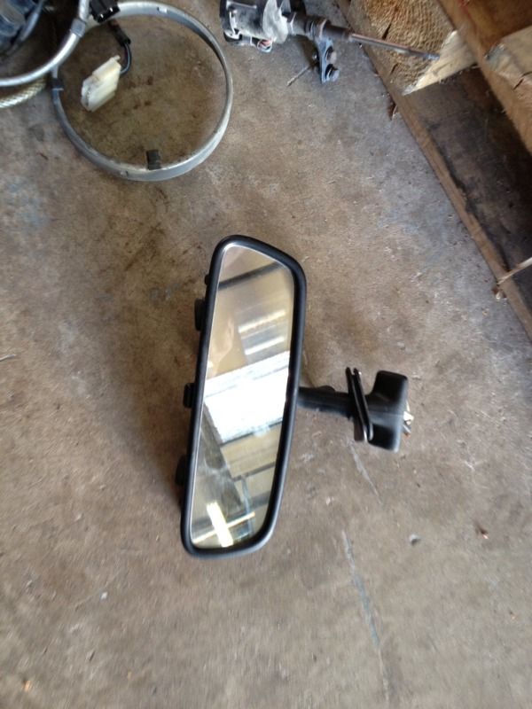

Maplight mirror:

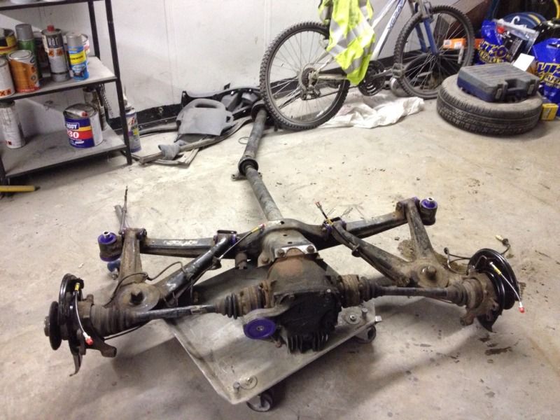

Its been a busy day today, my mate had some free time so had a chance to remove the rear axle and front end off the donar car:
After work i got a few hours graft taking the rear axle apart so i can fit Powerflex bushes into the whole rear and some new bearings.

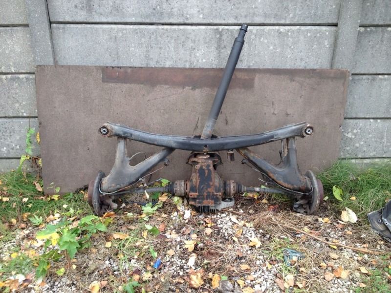

virtually rebuilding the back end. I'll show all as it goes on, first thing i did was push out the rear bearings:
Easy job when your mate has a press but make sure you take the circlip out before you get the bearing out!! lol The rear beam bush's were an absolute PITA!! :cry: Took ages to get out and ended up burning one of them out!! But it was done:

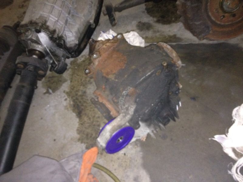

The diff was easier, lump hammer and some anger :x , out it came:

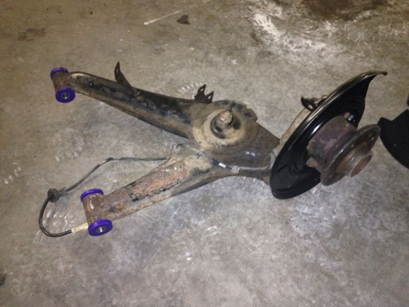

The rear trailing arm bush's were a slight nightmare as i drilled and punched them out. Also bought some new back plates as the old ones were slightly fooked!!
New nut and bolt:

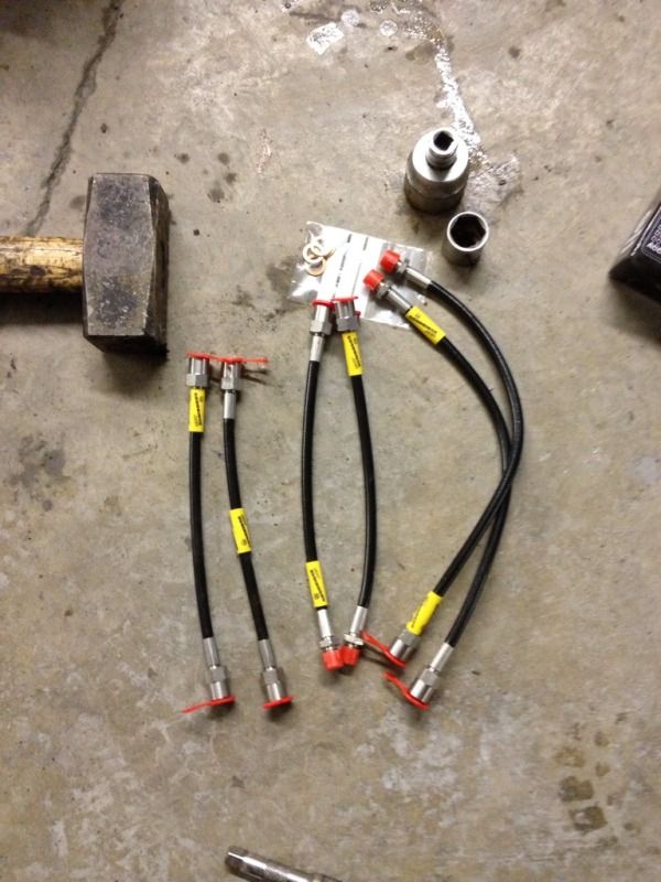

Goodridge braided hoses:

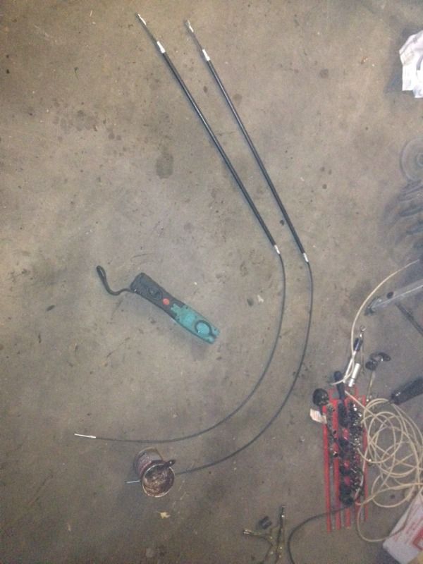

New handbrake cables:

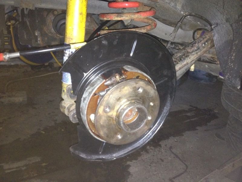

New shoes:

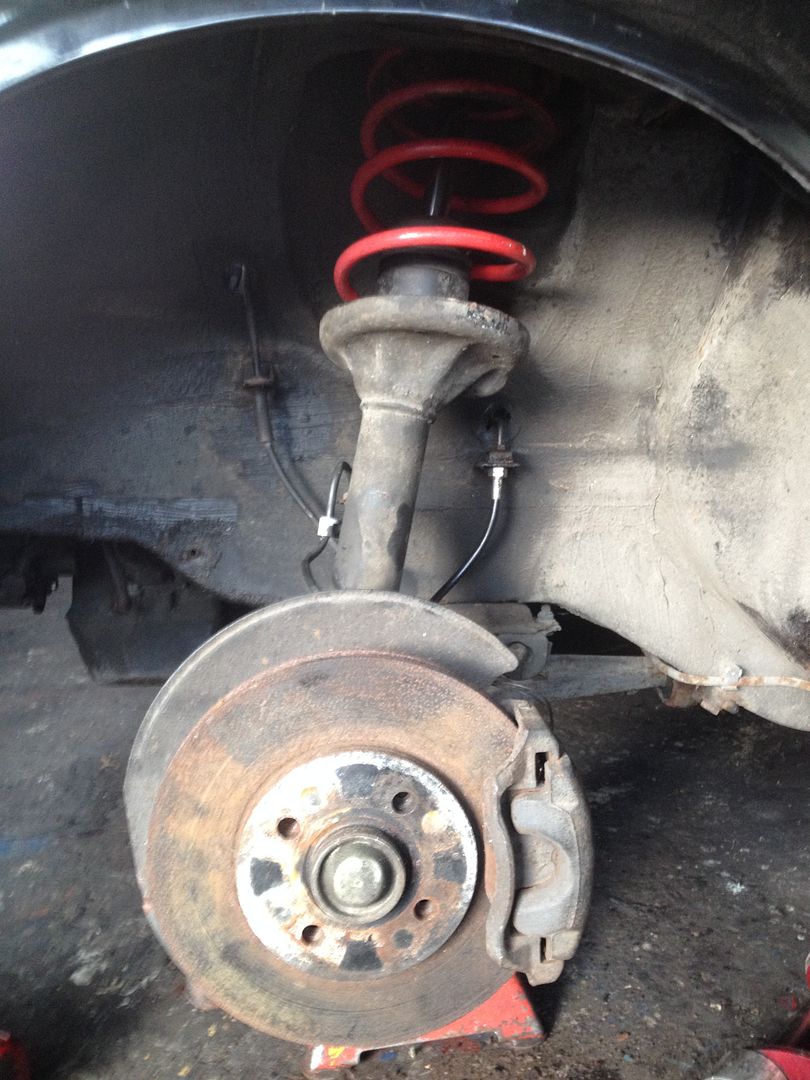

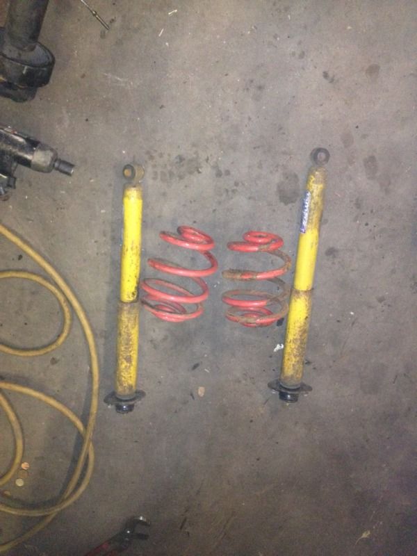

The original shocks were shot but that didn't matter as they were going. Got both done and put them on the car with the braided brake lines:

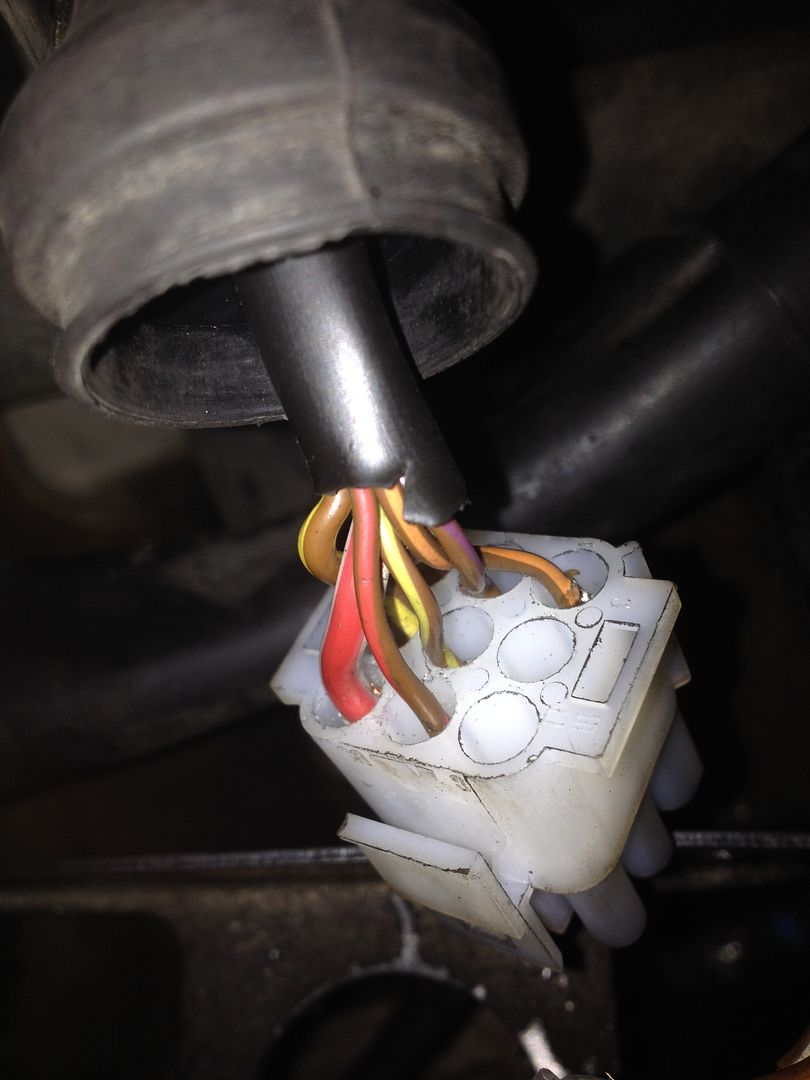

When me and Alex was fitting the engine, i remembered that the connector for the injectors was connected using terminal blocks so i wanted something more tidier than that so i bought a kit that would help:
It was abit fiddly but i got there in the end.

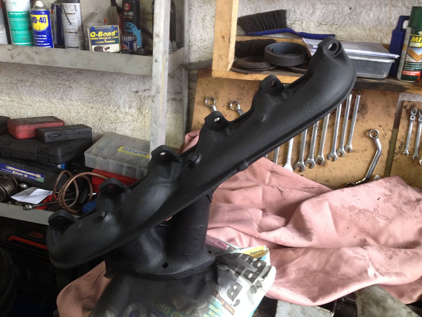

The manifold gaskets were shot so i had to take it off, and while it was off i gave it a lick of paint:

While i was waiting for the bits, i wanted to bleed the clutch and the brakes. I started with the clutch but something wasn't right, it would get to a point where it felt like a brake pedal so i replaced the master cylinder which didnt work. I took off the slave cylinder and the fork lever was non existant. I had to take the gearbox off and see what was going on, in the hast of putting the engine and gearbox in, me and Alex had forgot to put a release bearing in. On the phone to Manchester Motor Factors who delivered an LUK version.
Before everything went back up and tightened up, i changed the gearbox oil:
I finally managed to bleed the brakes with my new tool:
