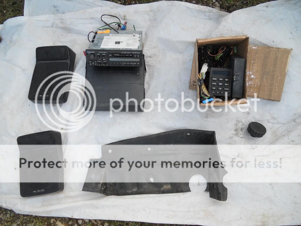

Managed to get out there today and get a few bits done... The plan was to fit a few bits and then get the Cruise Control off the breaker turd I have at the moment...
I wanted to get these bits installed
I didnt managed to get it all installed. :(

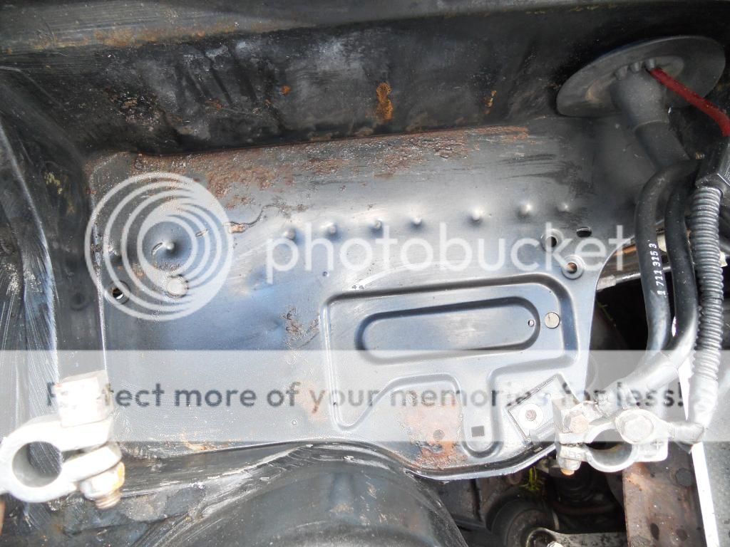

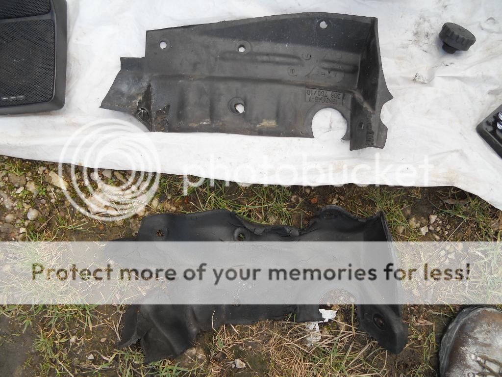

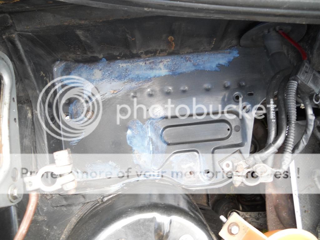

Started off with the foam replacement for behnd the battery, its been 'hanging' for a very long time and needed replacing, I had a spare one with some wear but better than my current one so used that for now, I can switch it at a later date for a new one when I get round to it.

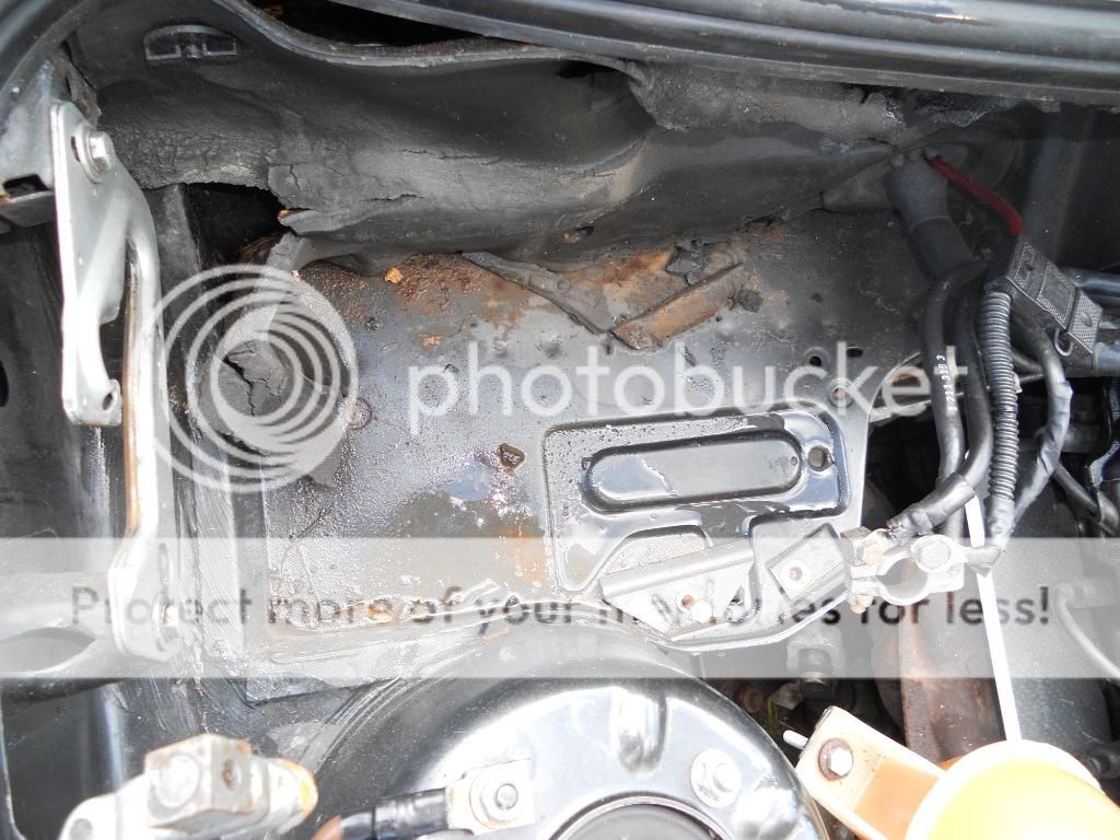

Took the battery out and this was my view 8O
So the replacement was definately better...
Some sanding back and cleaning up then treating with some rust stuff...
Then primes and painted... It was very cold so the rattle can was spitting the paint out, doesnt matter too much though as the battery will cover it. I'll give it a few days and polish it up a little, hopefully it will flatten off a bit.

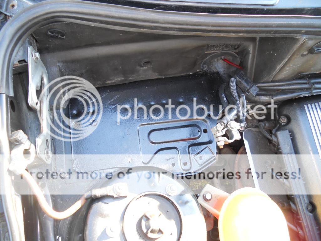

Then put the new foam on, loads better

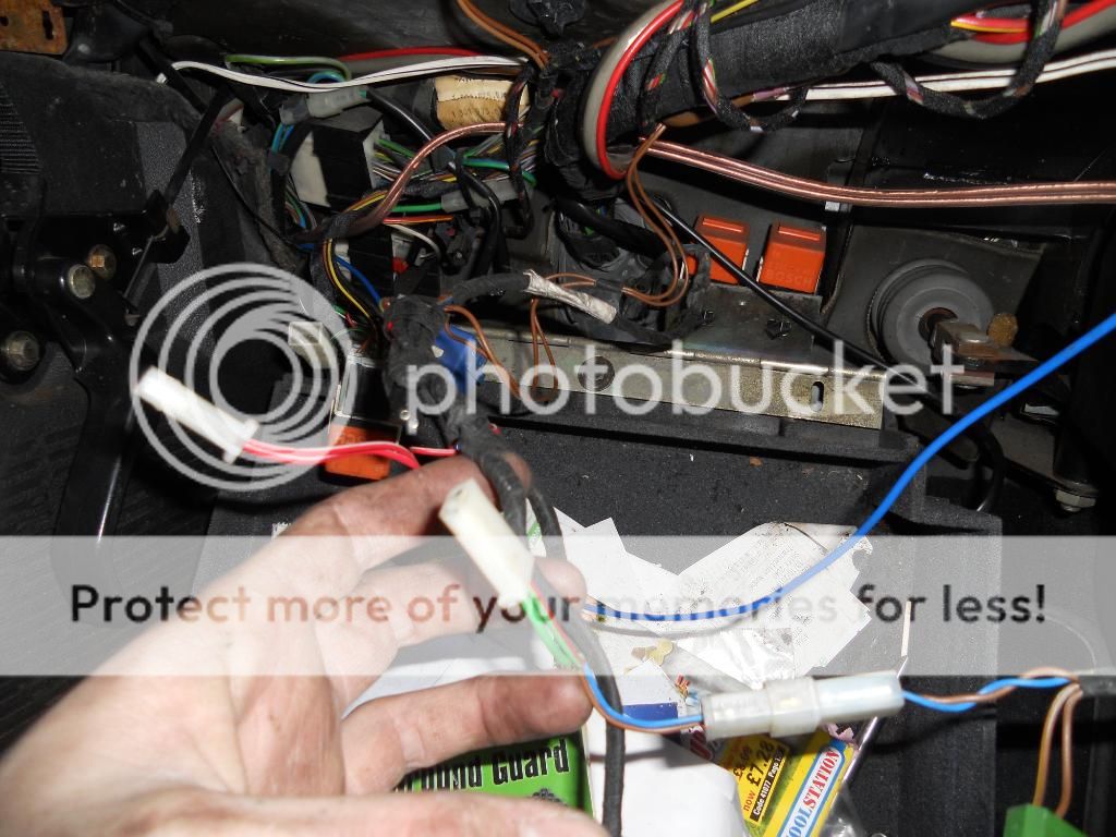

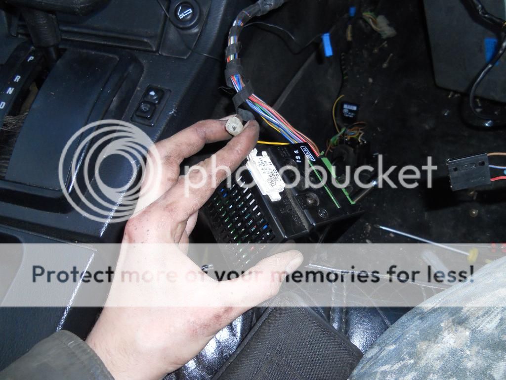

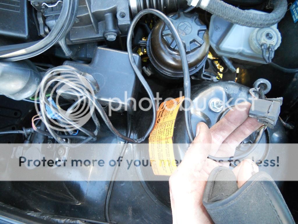

I then started on installing the OBC... 8O Thats loads of fun :mad: After lots of swearing I managed to get it lighting up, but still need to figure out where a few plugs go.
First ones being the 2 down behind the glovebox
Then one next to the OBC itself...
Theres a few of these ones I have no clue where they plug in :cry:
And then the 2 in the engine bay
Fook knows where those 2 plug into...

Only done an OBC install on a facelift turd but i'd imagine it's similar, all the wires behind the glovebox will go into that big white plug and hey will be shaped to only go in one place. As for the ones in the engine bay, only thing i know of there is the temp sensor and the exterior siren both infront of the nearside wheel near the foglight.
That rust on the battery tray wants investigating though fella, that's way worse than my chromie and with a tiny prod it was a hole, i'm guessing that's showing rust on the inside as well :cry:
I was thinking it looked pretty solid 8O
I did both sides of mine with black smoothrite and about 6 coats of waxoyl :D
Might not be factory finish but who gives a fook when you can't see 90% of it unless you take the battery out :mad:

It wasnt as bad as it looked mate, my first thought was 'poo'...
I then had a proper poke with my inspection tool to make sure it wasnt bad
Then I sanded it and got the drill out to remobal all the surface rust, to bare metal, then treated...
With regards to the 2 plugs left near the glove box, I had a feeling they went into the big white plug, fook knows how im suppose to see where though as my eyes and finger dont angle well and cant see where. :cry:

Actually looking back at pics of mine it was a bit worse so you might be ok, i'd still be checking the inside though.
The big white plug should just unclip from where it is held. :wink:

Yes Rav, I printed that out and took it with me, couldnt find where they went though, the guide needs altering I think as it didnt really go in order which it started out like it was going to.
@Dave - I'll check the inside of it over tomorrow just to be sure. The big white connect plug thing, I've never been able to get them things off, always end up just pulling on them til they snap :cry: I'll work it all out tomorrow though and hopefully get it sorted.
Need to remove the horn from the breaker for the obc though as my kit didnt have that part. Then I'll need to figure out how to use the obc :mad:

Think you slide it rather than pull it! ;)
