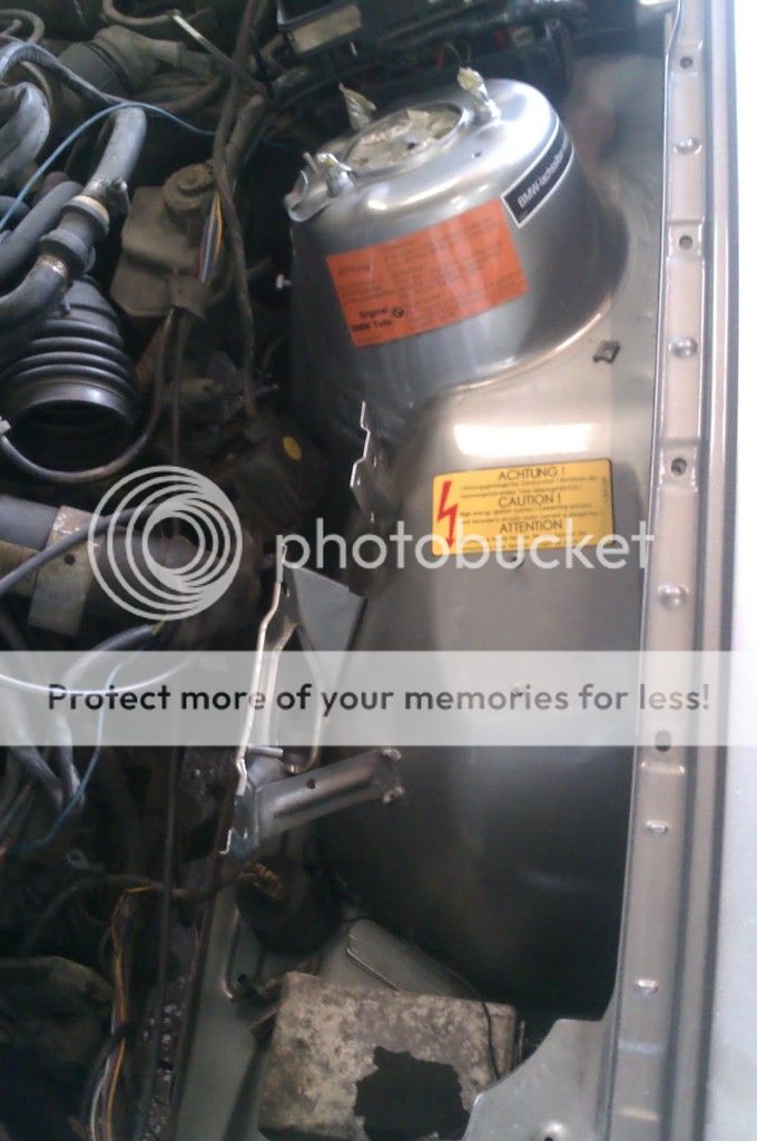

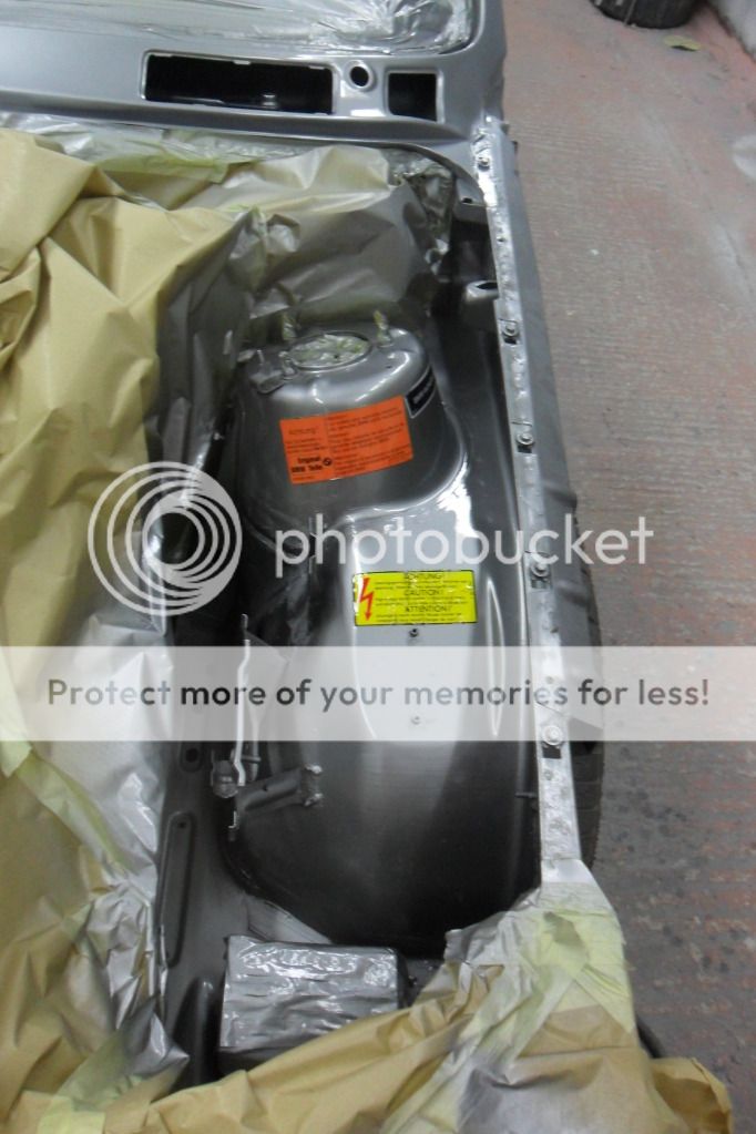

kitch wrote:Yes, full respray including the engine bay, boot and floor inside. The rest of the battery tray is sat in the car. They said there wasn't anypoint replacing non rusty parts as it opens up seams which can cause extra rust traps. Of any interest to you?
Oh yes, that makes sense.
I was wandering if you could get some pics from different angles of the battery tray as i'd be interested to see what it consists of. :cool:
Sorry for the bother!
Cheers mate.
kitch
Posts: 878
Joined: Sat Nov 01, 2008 11:00 pm
Mon May 21, 2012 9:15 pm
Haha, I like 2doors more but this is a special 4 door to me. Cheers, hope it's worth it.
Yeah I'll get some photos of it up bud, I should be picking it up this weekend so if I remember I'll do it then :)

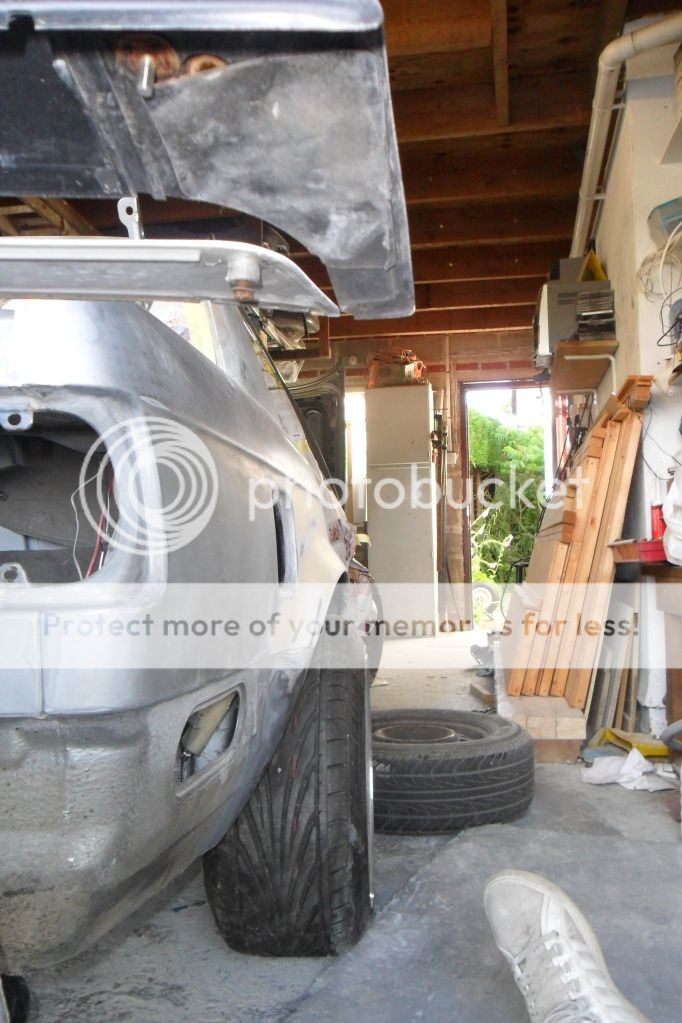

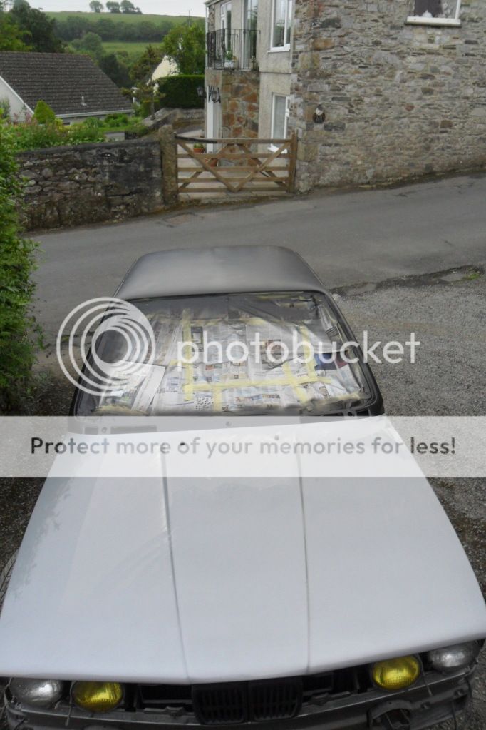

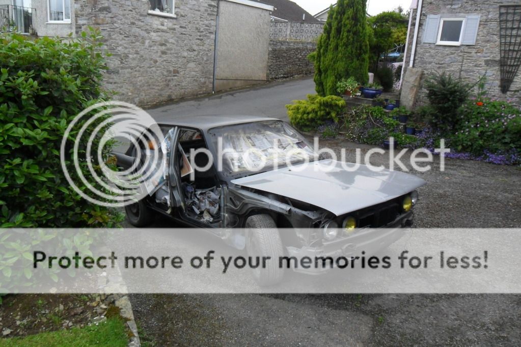

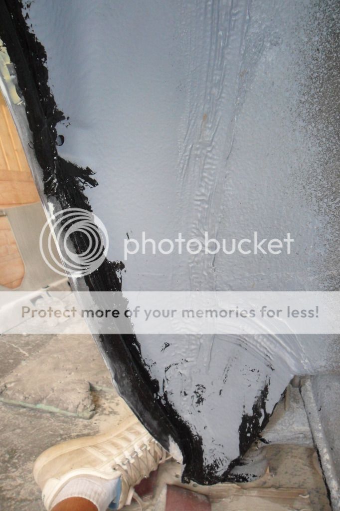

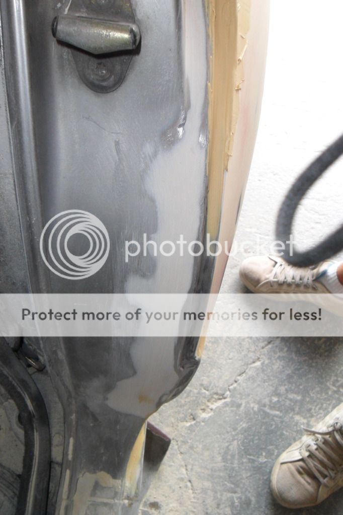

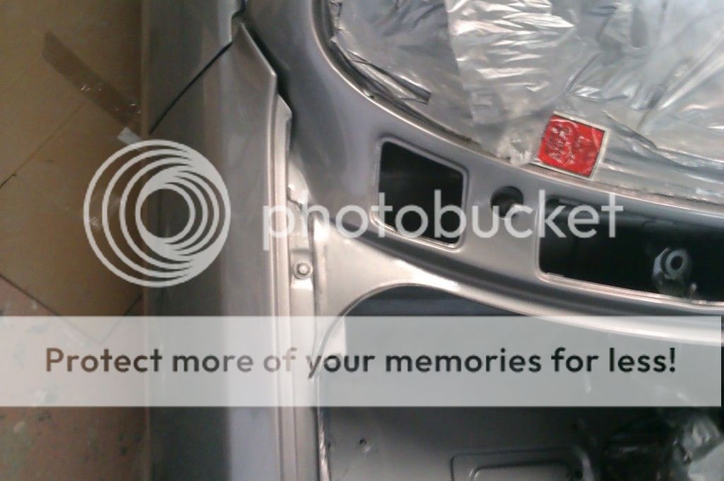

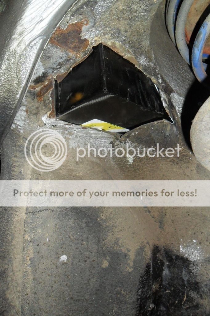

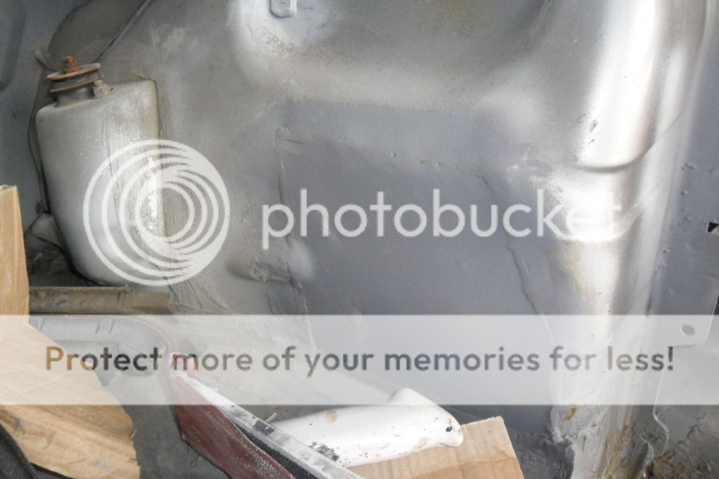

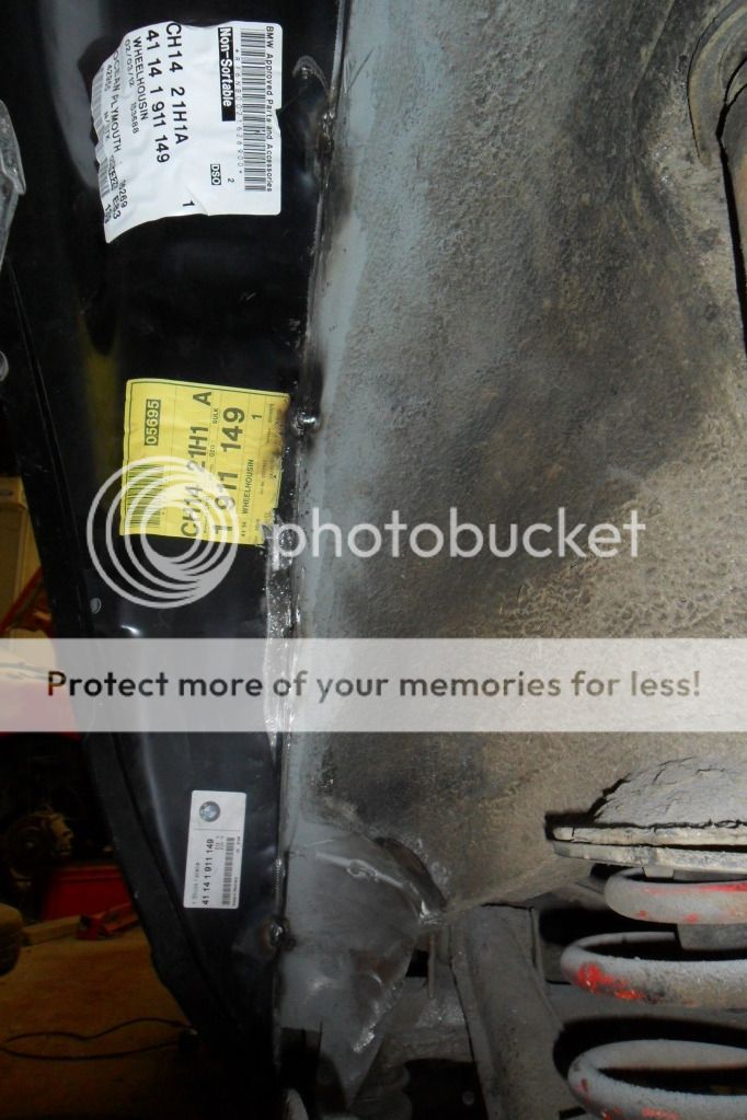

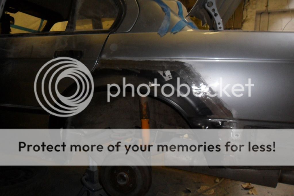

Bit of an update. Got my turd back from the welders recently, my brothers made a good start on the body work :). I ordered 2 new wings today for the nice price of £350 8O but they're on back order so I don't know when BMW will have them in :(.
Driver's side arch before.
and after
Passenger's side arch before
and after

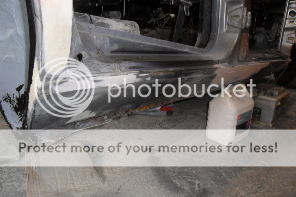

Driver's side sill before
and after

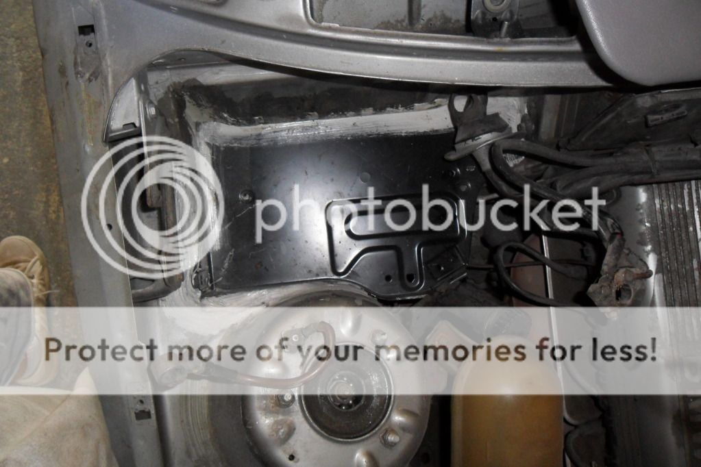

Battery tray before
and after
Image.
Scuttle before
and after

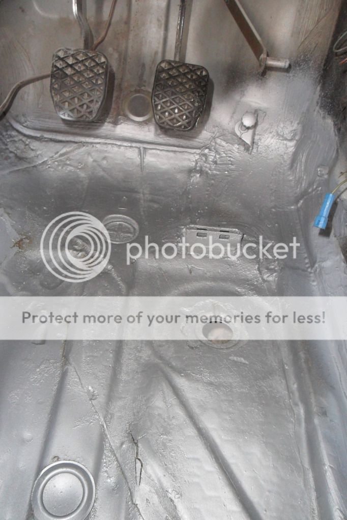

The foot wells

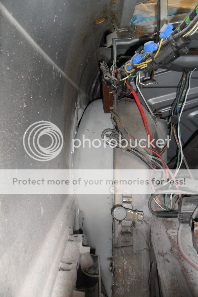

Some of the rear inner arch where alot rot out and of the bit by the breather tank

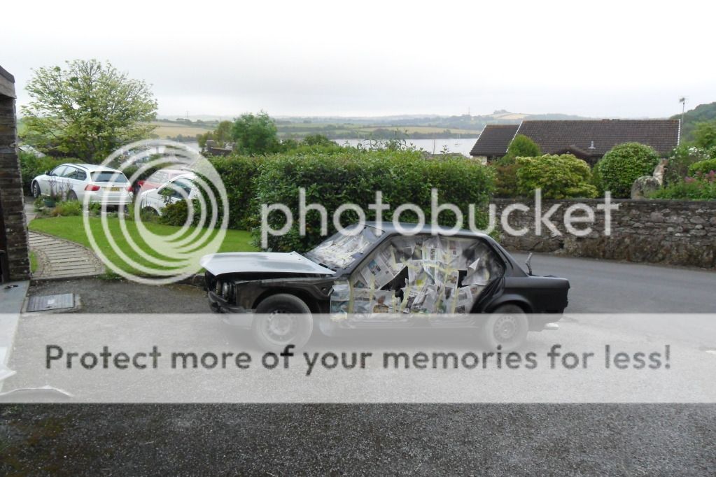

And a few general ones of the car

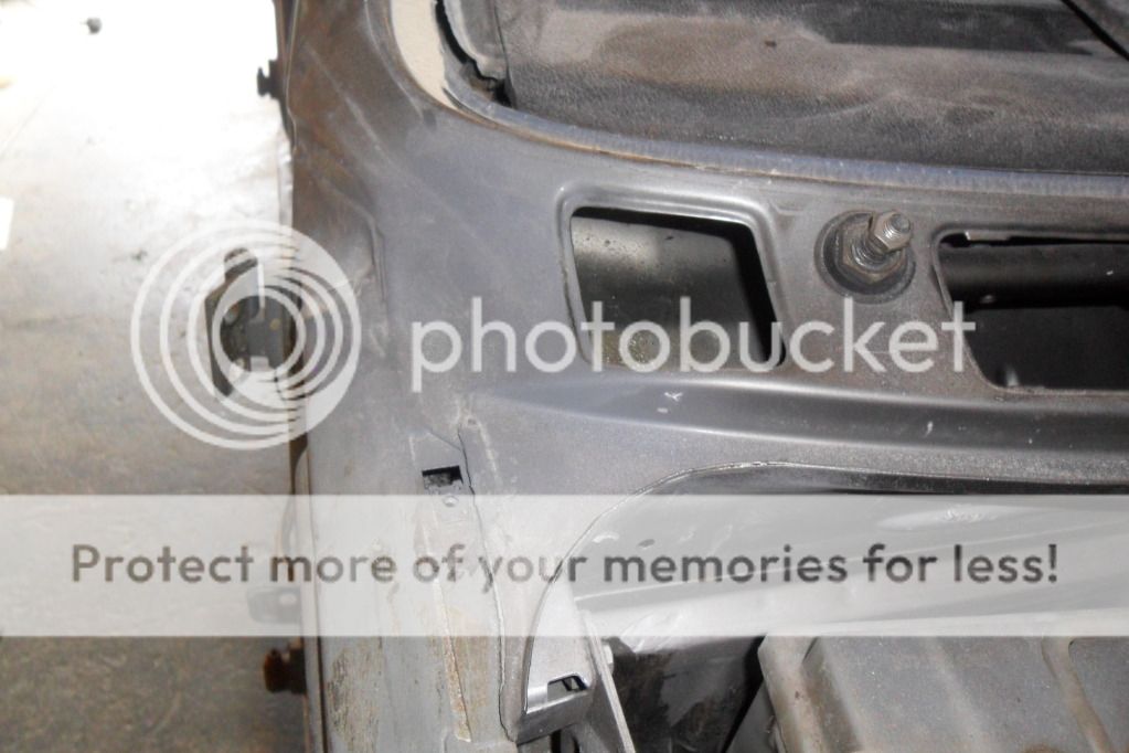

The bodyshop have sealed up all the metal that they put in. I've put some polyurethane sealer in the arch lips to stop mud and crap collecting and rotting them out which is what happened before. I've waxoyled inside the sill and rear arches. I'll give them another going over when I do the inner arches etc but I'm going to wait until it's painted before I do that. I've also sanded and primiered the front of the floor and that'll be painted with the rest of the car.

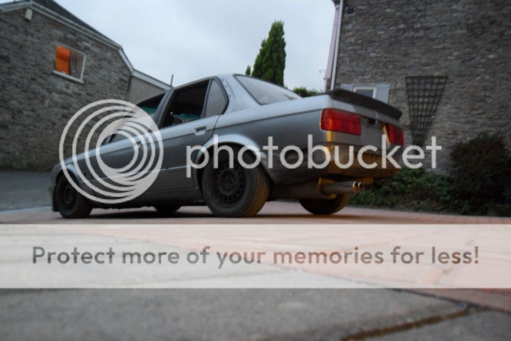

Sun Jun 24, 2012 9:09 pm

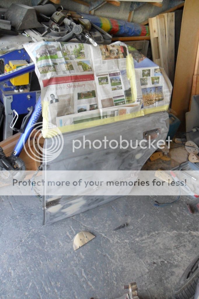

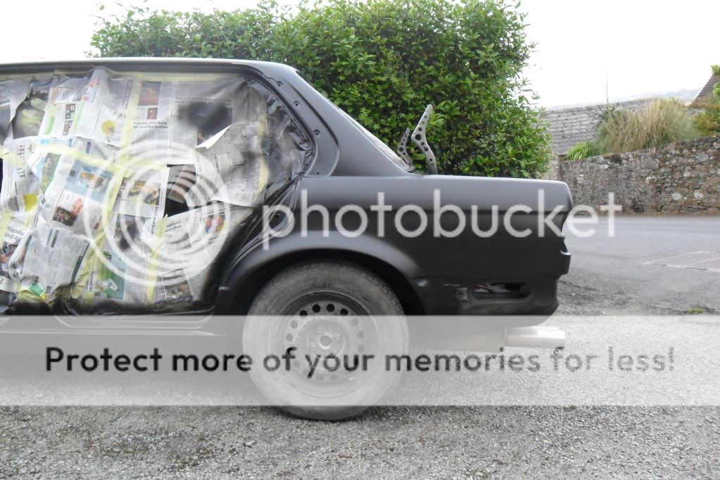

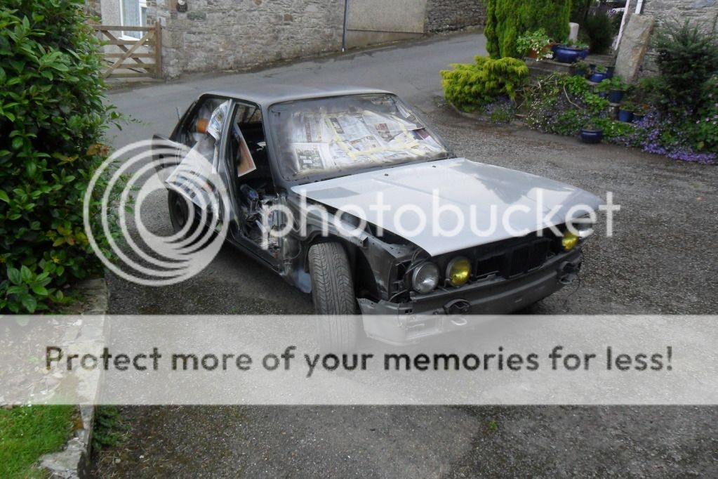

Few up to date photos. Pretty much ready for primer, should be done tomorrow night hopefully.
kitch
Posts: 878
Wed Jun 27, 2012 9:36 pm
Primered the shell this week

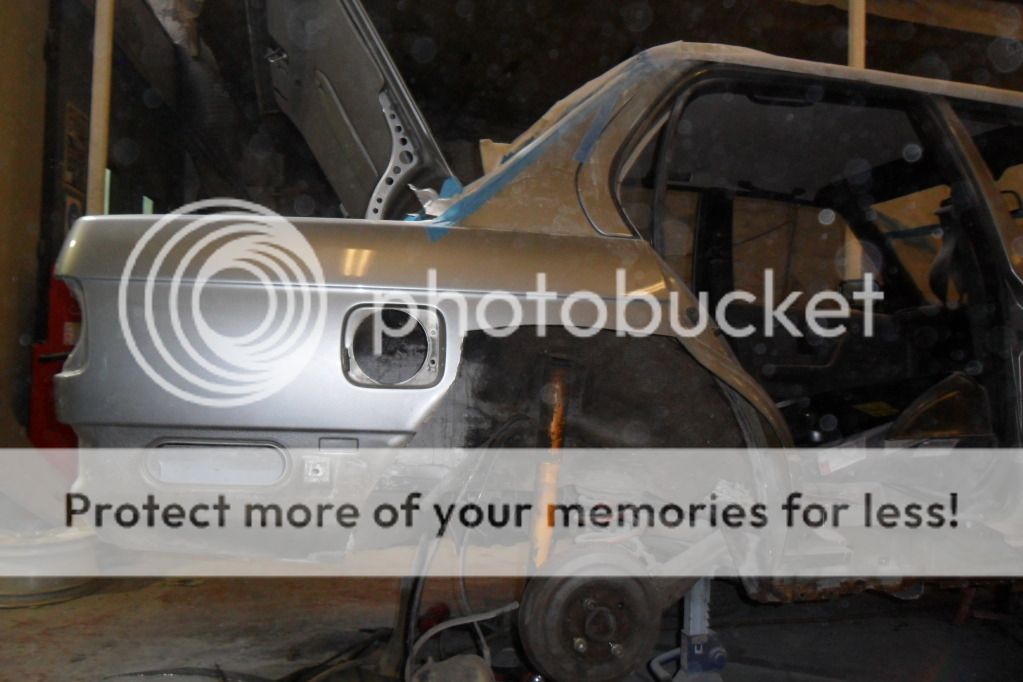

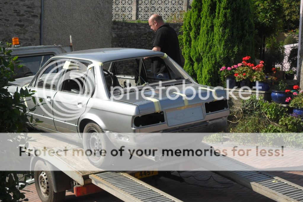

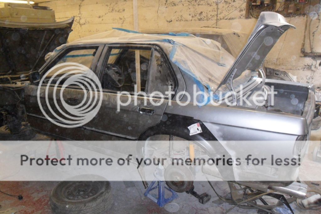

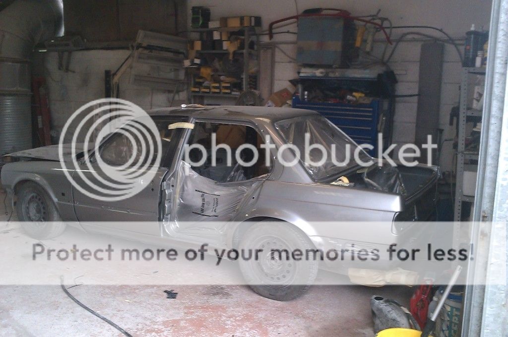

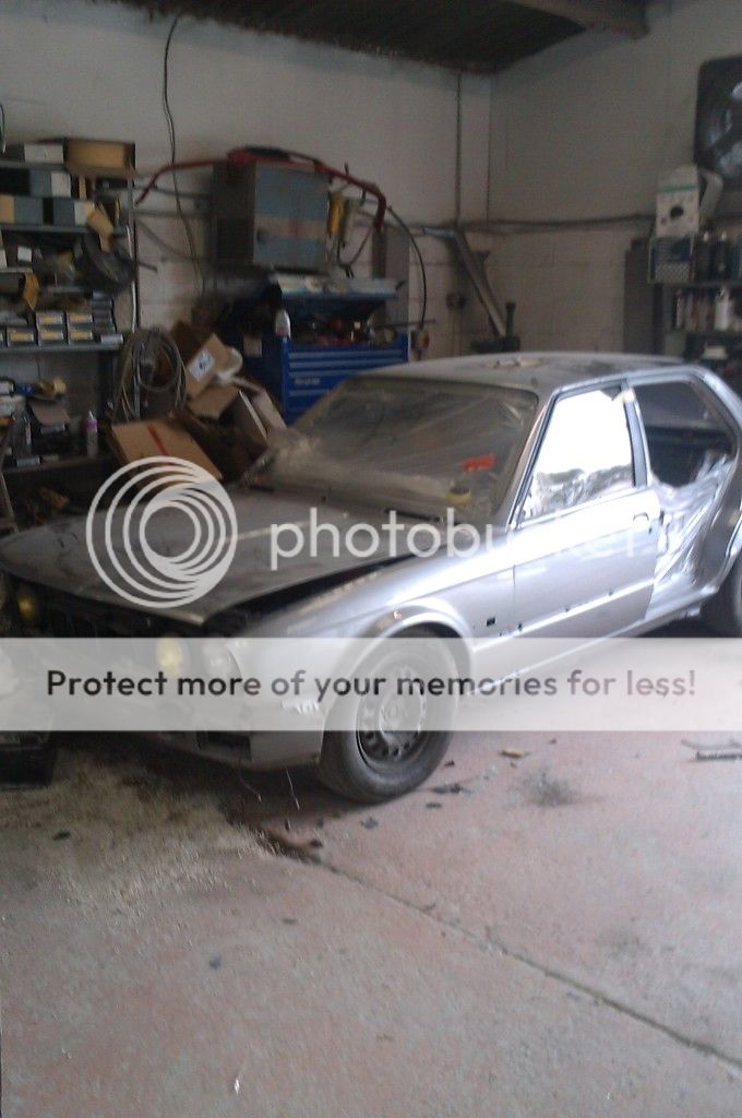

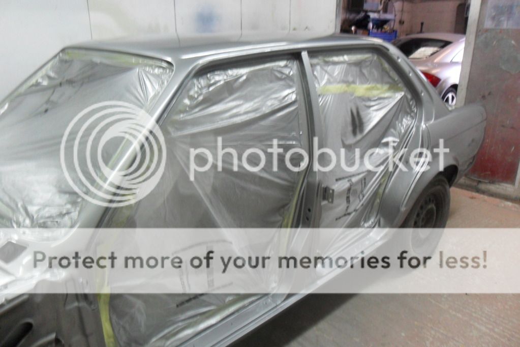

Mon Aug 20, 2012 6:34 pm

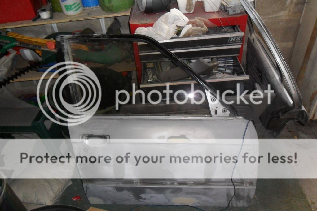

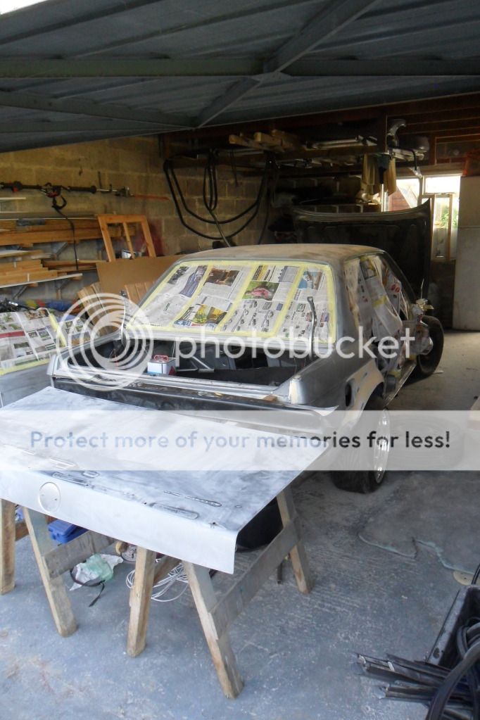

My car is finally underway. Got it recovered to the body shop this week.
They've sprayed the shell so far, should be doing the doors etc this week too.
If I have time I'll pop up and get some better photos
polsta
Posts: 10322
Mon Aug 20, 2012 7:26 pm
a lot of work there mate, looking good,mines having similar work

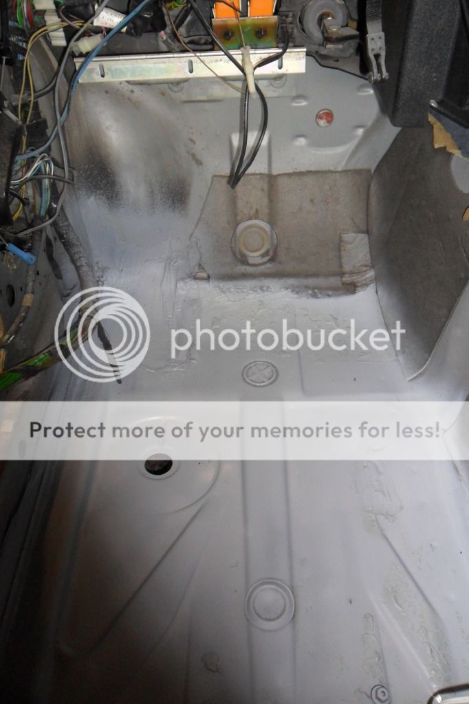

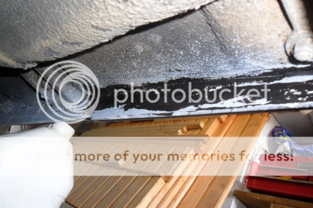

just an observation, but why did you not scrape back the sound deadedning from the front floor pans to look for any issues and then give a better finish one re done ? in mine i removed it all, and there was some surface rust about just startting on the floor metal under the deadening, and also on the "join lip" that goes across the front there, there was some rust starting and glad i found it, under that deadening its sort of hexagonal honeycomb effect and moisure can get trapped/chanel under it
would be a shame to have missed anything under there after going trhough all that work, and you can buy new deadening isnt expensive
kitch
Posts: 878
Mon Aug 20, 2012 8:59 pm
I did chisel it all off. I know what you mean though, it looks like I haven't. If you look closely on the bottom right of that photo you can see the honeycombe bits. There was a bit of surface rust but nothing mojor. Cheers for the concern though :)

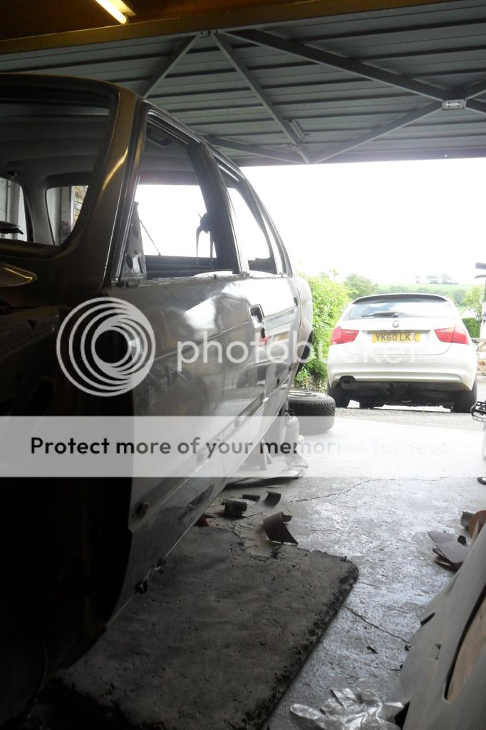

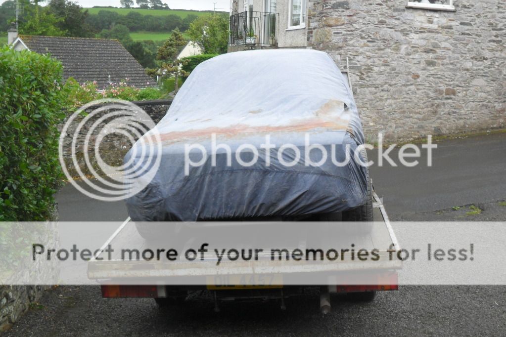

Fri Aug 24, 2012 6:25 pm

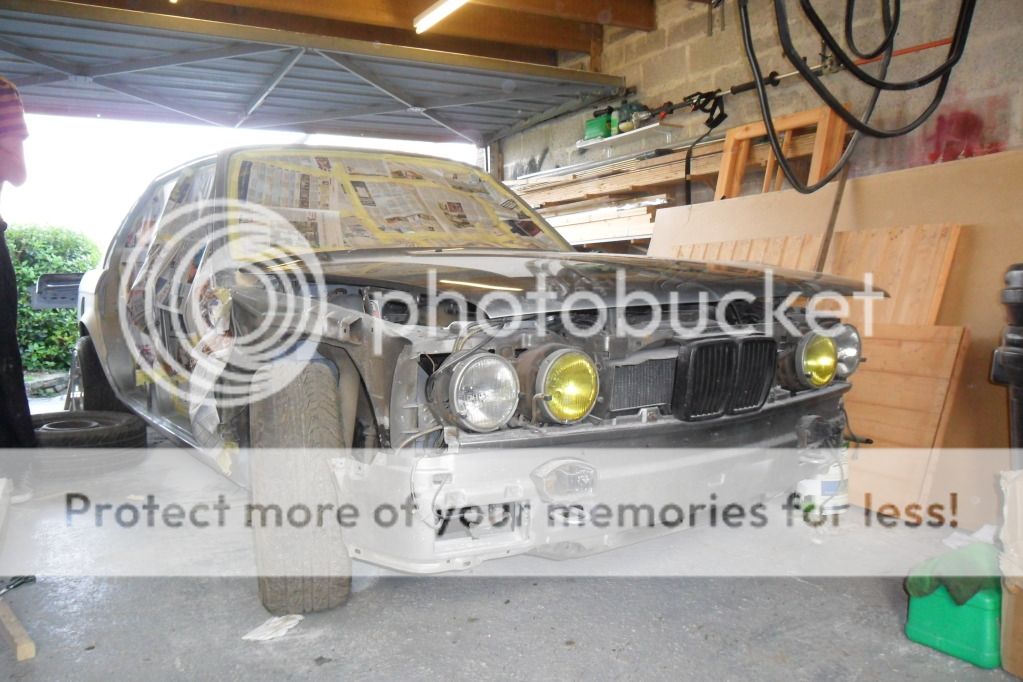

Popped upto the body shop today. the car is looking really good. Just need the rear doors and boot to be painted and put back on the car and then it can come home. Need to pick the skirts and bumpers up from the blasters tomorrow ready for primer and paint too. I can't wait to get it back on the road, it's been over a year since I last drove it.

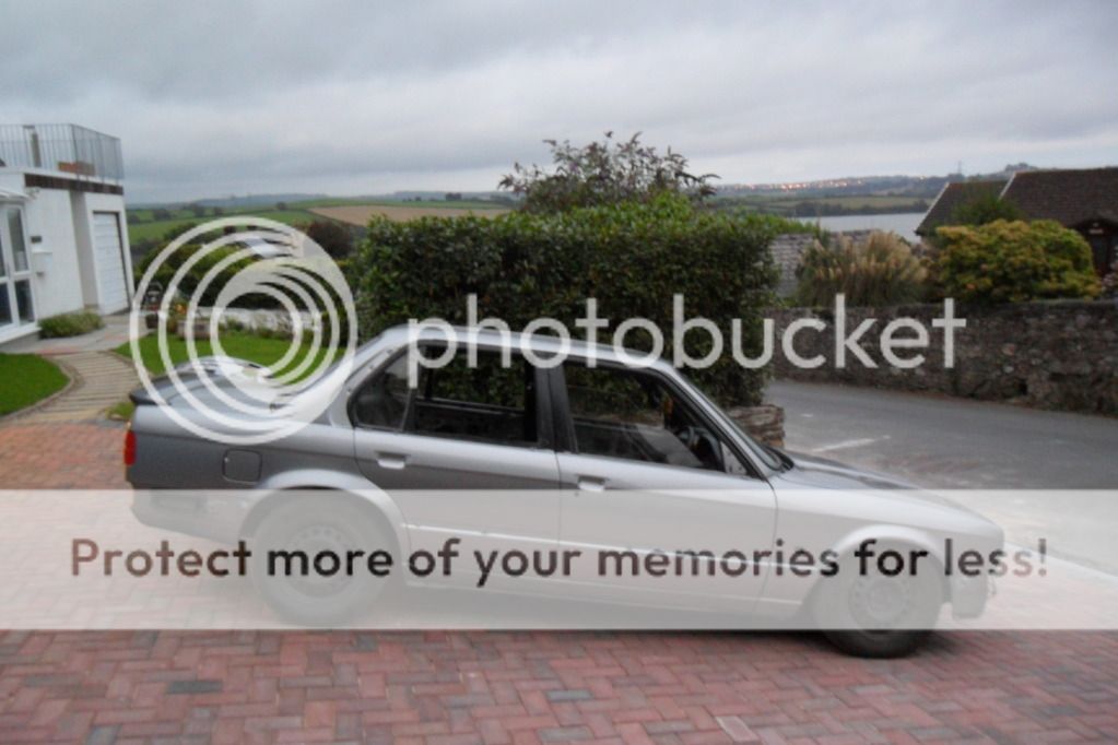

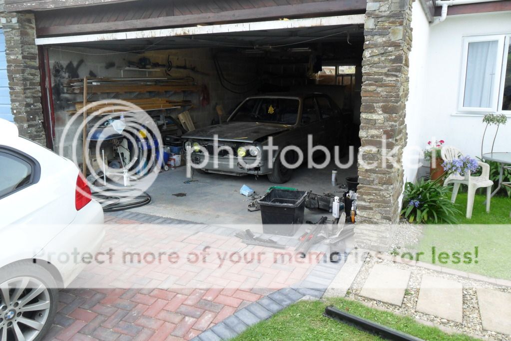

Wed Sep 05, 2012 9:36 pm

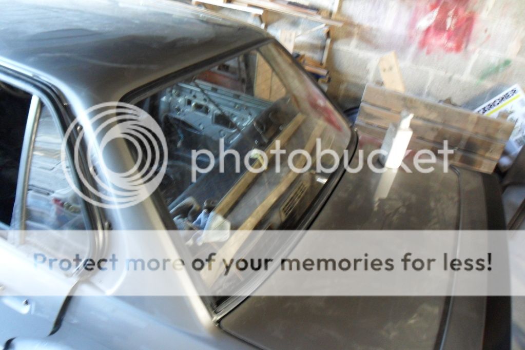

Few recent photos of the shad.
Coming home
In its home for time being
Nice new black inserts for the front and rear window
Windscreens in
and a few of how it stand atm
