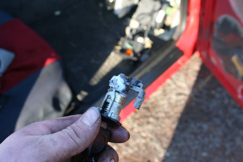

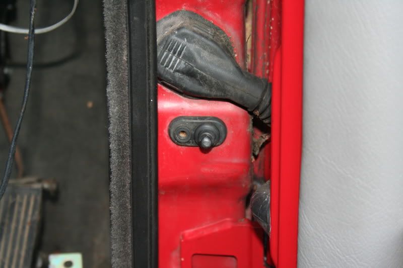

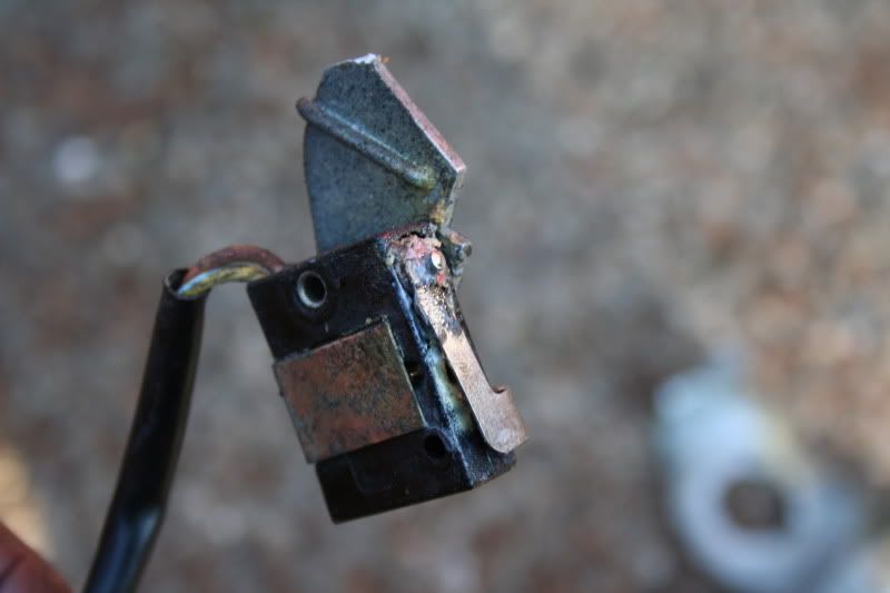

Interior lights not coming on when the doors open? E/W not working either with the doors open? Then its this little chappy. I've swapped both sides out as neither was working. So 1 little job jobbied.
Central locking is fully working and the car is all on 1 key. which is rare in itself. Anyhow, this like many e30s didn't lock the central locking without turning the barrel flat. IE deadlocked. Well from new you should be able to turn the lock left and the central activates straight away. Then if you want to deadlock you keep turning the key, get me? Well you can see the mirco switch tab has bent, then i've "bent it a little more" and it broke
Spare parts bin found another, i find now that you need to bend the tab out a bit more and play with it to get it to work again properly.
lube up the lock, i think maybe over the years that the tab on the back of the barrel wears out a bit hence the central and deadlock not working as it should. So really its a bit of patience and p!ssing about bending the tab and putting it together and apart until its all right. Which it is now and smooth operating. Some grease on the hinges and latches mean nice free swinging doors

If you sort that interior light problem please tell us how...mine don't work either
- Posts: 22697

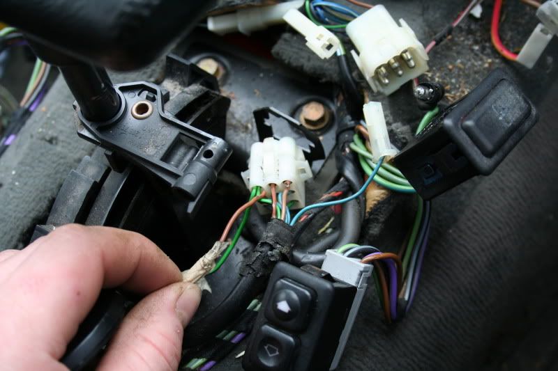

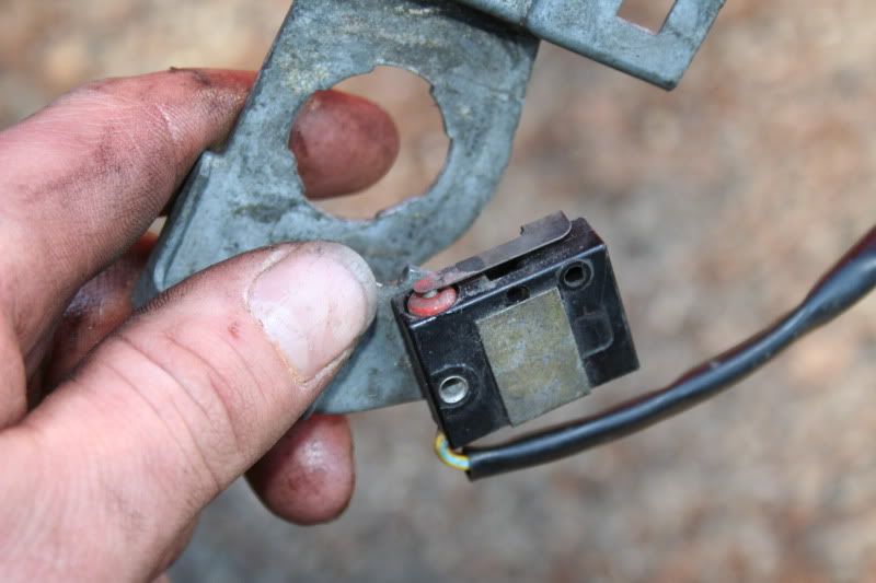

/\ replace the switch pictured

this is the earth for the light on the selector arm. i want it to work, so would running a new earth somewhere else be the best answer? i shall have to try and see.

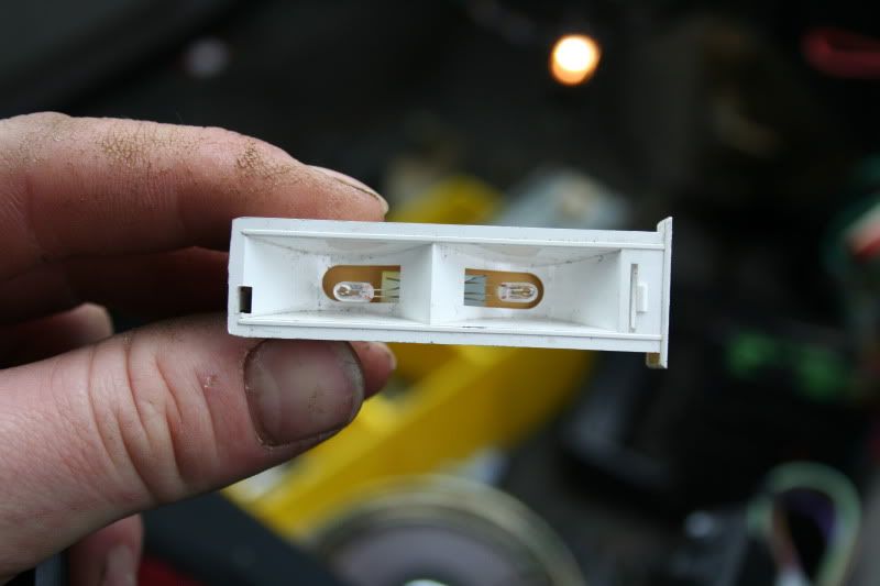

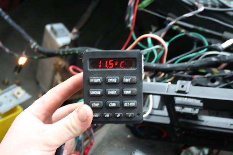

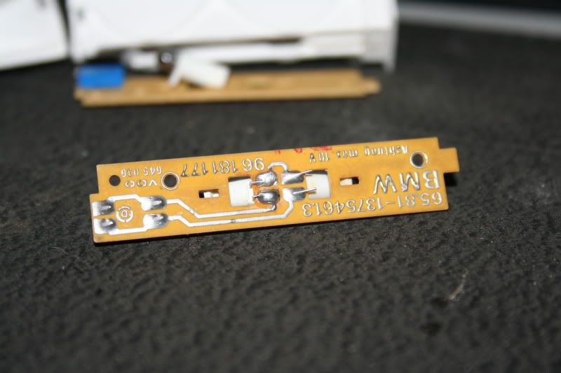

These are the OBC bulbs which let go and replacement from BMW is now £60+VAT which is bloody silly money.
So i've soldered in these new bulbs, they are tiny but.......
We are in business

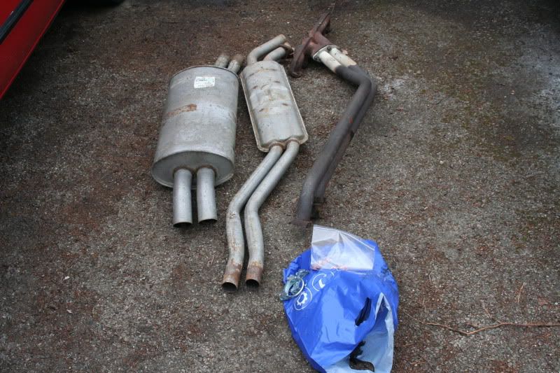

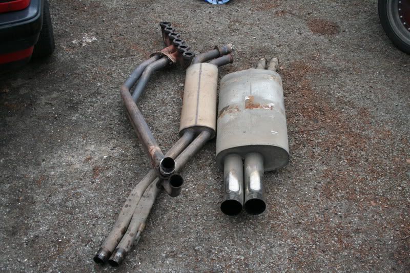

not the worst but not good either, i've changed the whole system today as the scorpion isnt quite what i think people who want a standard 325i auto want these days. Doesn't suit the car imo

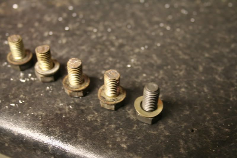

No broken studs either, now this car had a headgasket done @ a BMW main dealer in 2007. Look no oil leak from the front corner of the gasket like they ALL do! Good advert to me to use a genuine BMW one on my 2 door i think.
Minor clean up and in with the studs

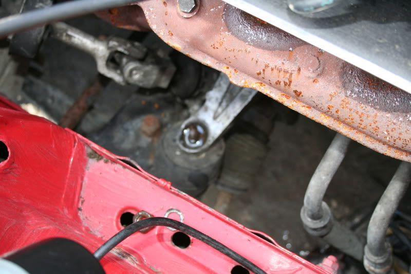

All on and it fitted quite well! i didn't have to try and bend much. Much to my surprise it sounds pretty good, almost like a genuine system dare i say it. Straight exit too

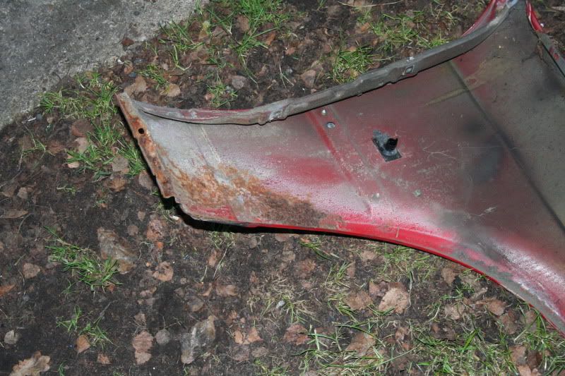

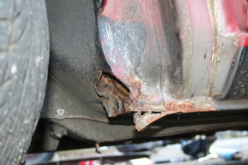

Passenger wing needs some treatment but its just surface rust. This is the scuttle side and the tricky repair to get loocking right
Whole and you guessed it there was a mudflap hiding it!
after a good poke and a bit of a clean up. I think the screen will have to come out and the dash stays out until this is sorted.
We are in business

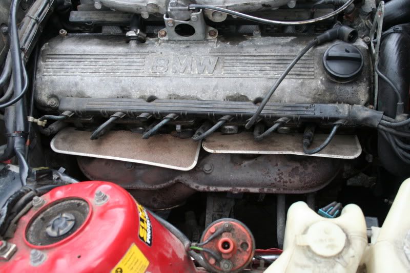

Nice gaskets
Came off easily
Nice nuts
Much better!

/\ dito. Clock is ticking. Well we can always do a wiki article for sorting the OBC bulb issue.
i torqued the manifold nuts today in true homo style, bentley told me 22-25NM is the kiddy. So i did 23.5Nm

That scuttle is a fairly easy repair, no need to take the screen out. Trim the rust back with a dremel and get your dub freak mate to tack (tak!) a plate in, skim of filler, primed and a zinnober rattle can job jobbed. Obviously some paedo style waxoil on the back of the repair and its sorted.
Screen out , drilling spot welds and lead loading is not the route you want to be taking with this turd !

i was only thinking about screen out pete for heat reasons, andy can butt weld so my job is to prep every where for him so he can make the plates and weld it.

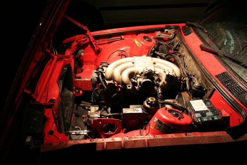

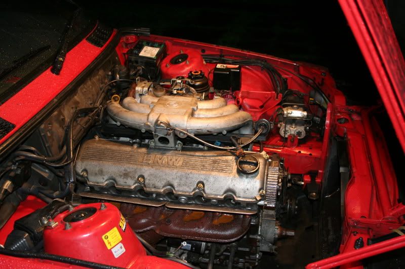

bit of a wee strip down and clean up in the bay,
bits ready to go back on, but the 10mm bolt in the upper timing cover f**king snapped. So my old man is sorting that out for me. As its where the metal pipe that runs across the front of the engine is held on.
Lots more going on but until saturday i can't get at it again. Day light is a premium thing this time of year!

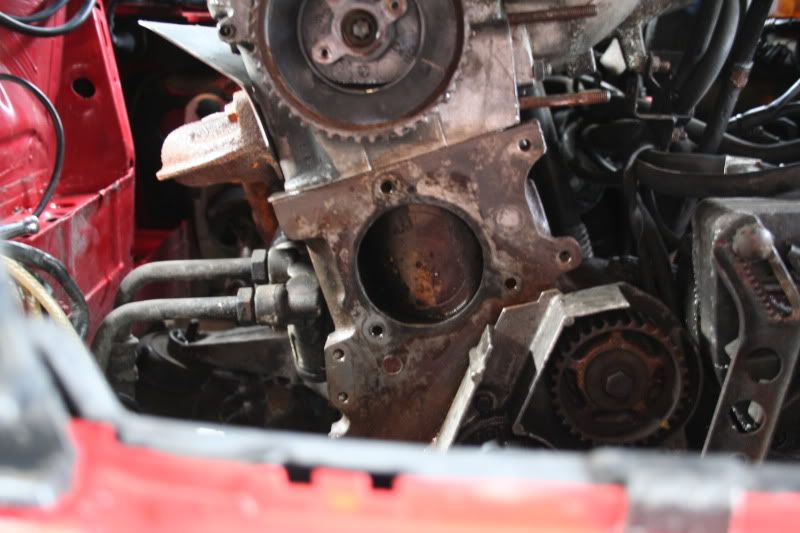

Anyhow yesterday was another move in the right direction and nearly the end of the mechanics i'm going to do to this
block was surprisingly clean or lack of rust like they can after this age and milege. Dare i say better than my 2door one! i could set the silver on the back of the core plugs! So it shows what regular coolant changes can do

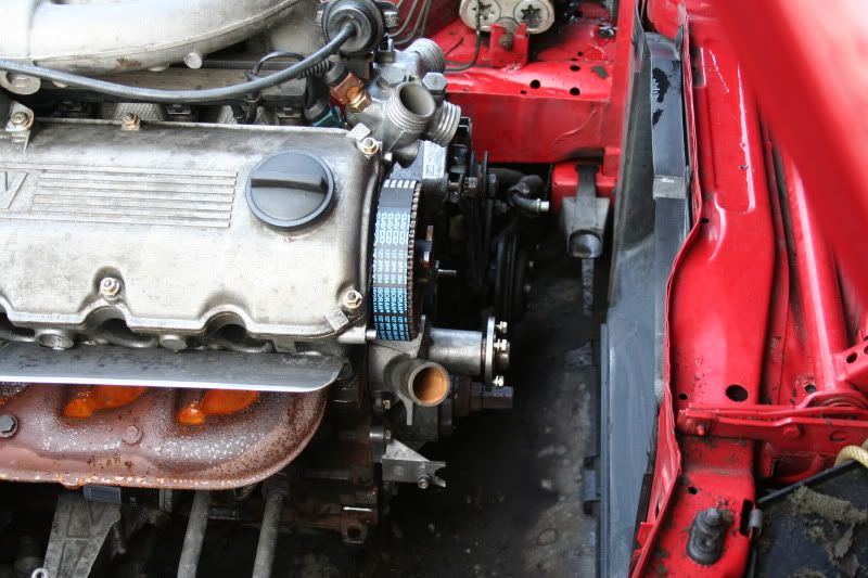

All belted and tensioned, timed and cranked over and up. All the nuts are horrid and rusty

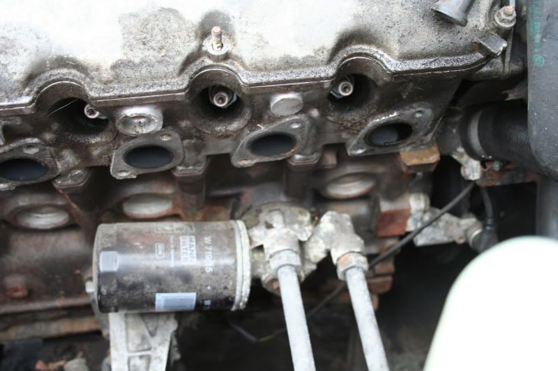

pipes all cleaned up. This car had a headgasket done @ a BMW maindealer in 2007. But the pipes still had a bit of mayo in them and felt a bit too squidgy for my liking. So i've binned them and fitted this lot i had in "stock" This is part of the reason i've stripped it so far down to try and wash out any remaining mayo as the dealer obviously didn't bother much.
We want nice BLUE coolant flowing round lol

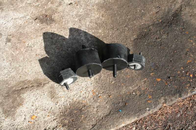

Mr wippy engine mount, its like a saggy turd. Both sides. The gearbox mounts were hanging as usual
New vS old. I should get a pic of the box mounts as they were comical and had both split in half.

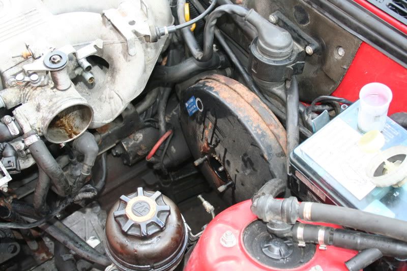

Manky rusty servo?
I knew this would come in handy one day. And that day was sat! Its a good job i did the engine mounts as you can't get the servo out other wise it hits the inlet. So with the donk jacked up on the sump gives you the clearance. Much nicer, whilst i was here the old skanky brakefluid was flushed through and some fresh ATE super blue fitted for that nice pedal feel. Not without drama, ALWAYS fit the rubber caps on the bleed nipples. The drivers front didn't and i heated it with a blow torch and the c**t still snapped. I've again got a good caliper spare so that went on and a clean up waxoil on the metal brake lines in the arches. to keep the MOT man away

So no much left now really. Refit the rad bleed the system up and an oil change/filter and fit the new TCA bushes and on to the bodywork. I picked up a nice dash today thanks to Glenn for that so the inside can go back together too.

noice, someone lose the bolts for the crank pulley? cuts down some longuns mush.
Manky rusty servo?
The rear lines T piece are all very good condition due to being replaced in the last couple of years.
