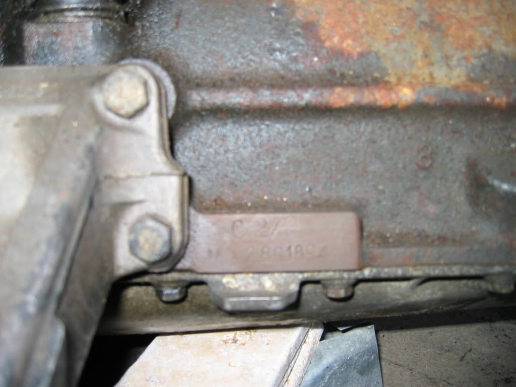

Speaking of the 2.7 here she is in all her glory (not):
All numbers present and correct:
I am really pleased with how original this car is. Block and Head and all the Bilsteins with original alpina numbers on, and here is some pics of its History:

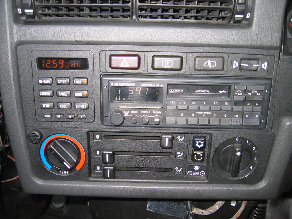

So far ive fitted my 13 button obc, headlamp w/w and the Aircon setup, now im waiting on the 1.3 loom arriving and i can get it moving under its owm steam again! I just wish i was a bit better at taking pictures as they never seem to come out right.

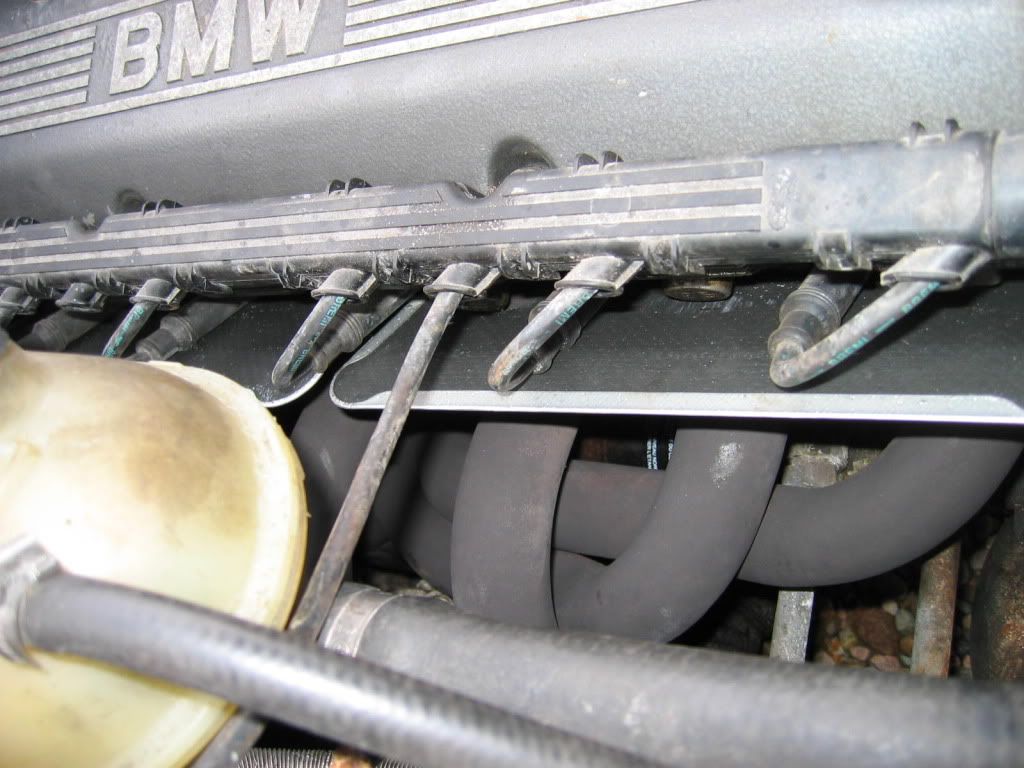

Whilst doing the conversion I also fitted the Alpina 6 branch manifold and s/steel system.

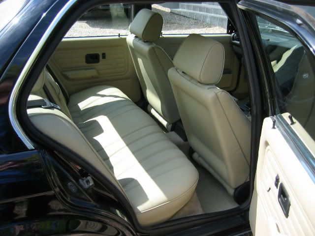

I got my Aircon/ HLWW / 13 button OBC fitted along with an original Blaupuntk from the era, and also managed to get a mint window circuit breaker switch to replace the faded original. So all looks nice:

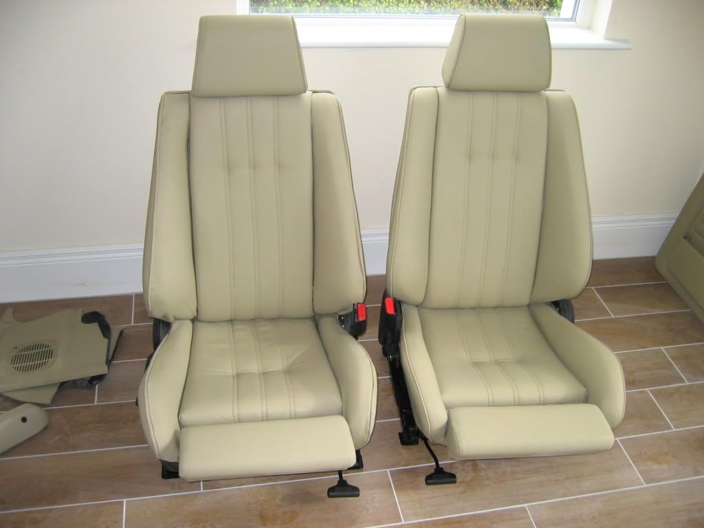

I have managed to get my drivers seat repaired locally, as it had the usual worn bolsters, and have treated the whole interior to a dymix dye clean and feed.

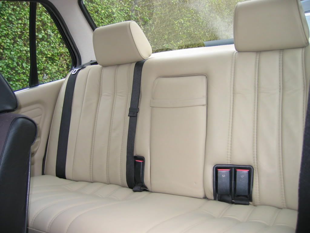

Also fitted the rear head rests:

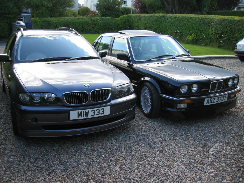

Here she is sitting beside her big brother, a B3S!

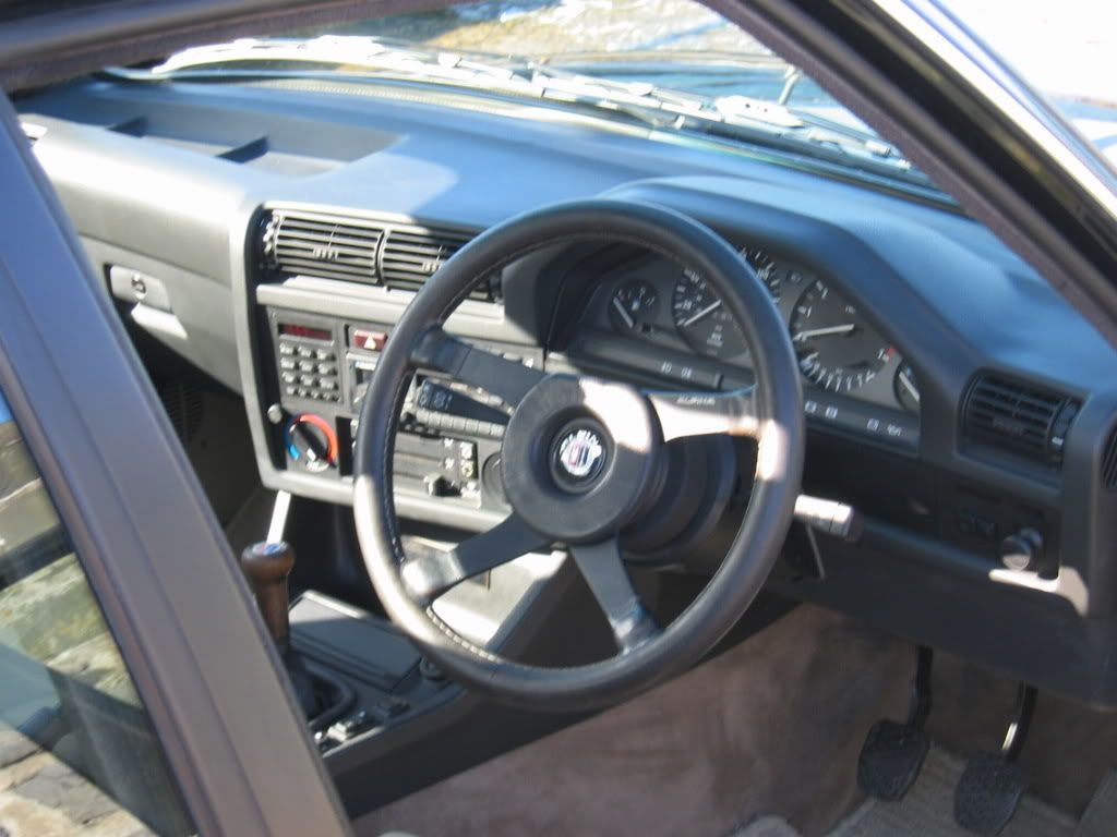

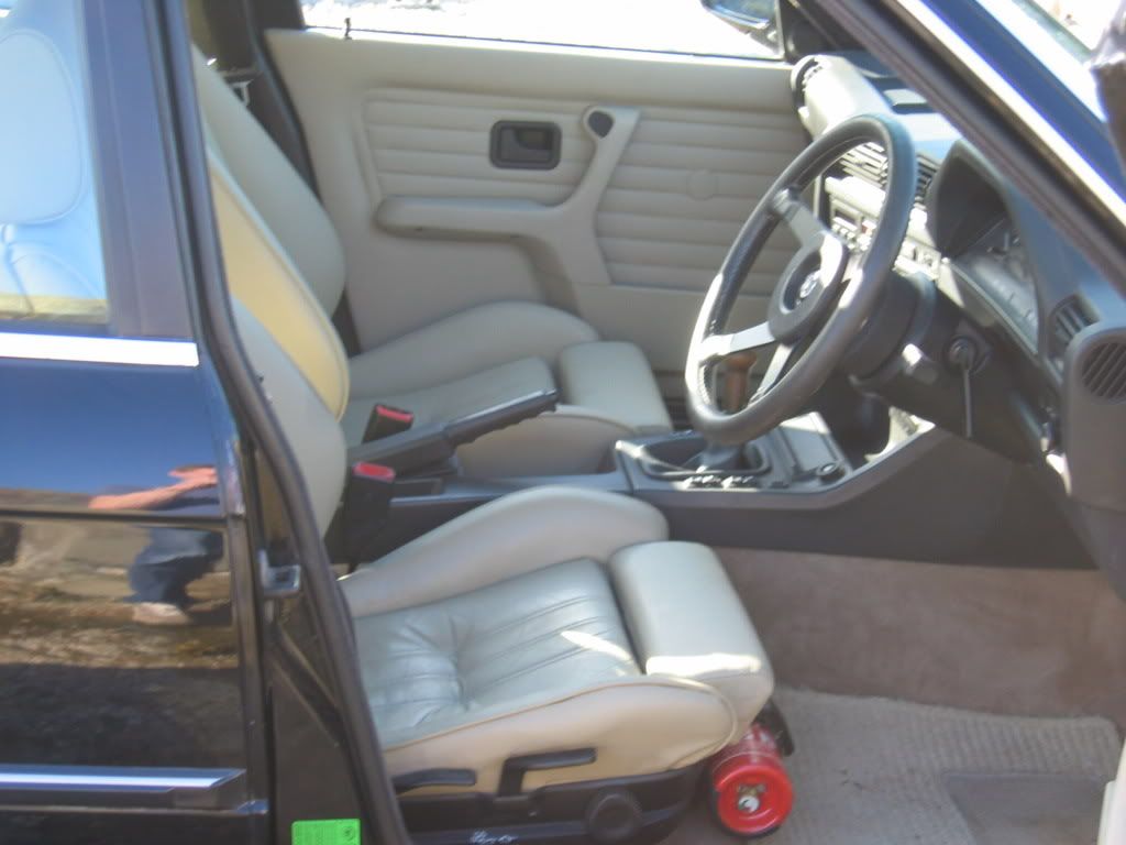

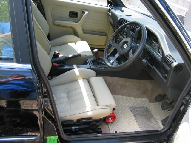

Some shots of the finished interior:

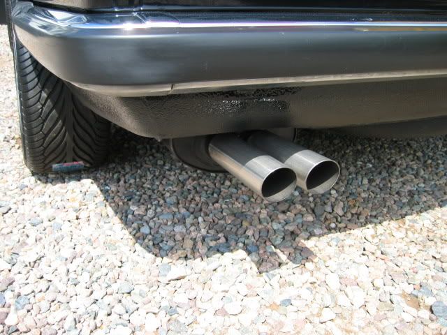

I also managed to get a decent set of tailpipes welded onto the stainless exhaust i picked up second hand.
Here it was before i got the angle grinder out:
And heres how it looks now - im very happy with it, its as close as i can get it to the original ALPINA/Boysen look, and it sounds superb!

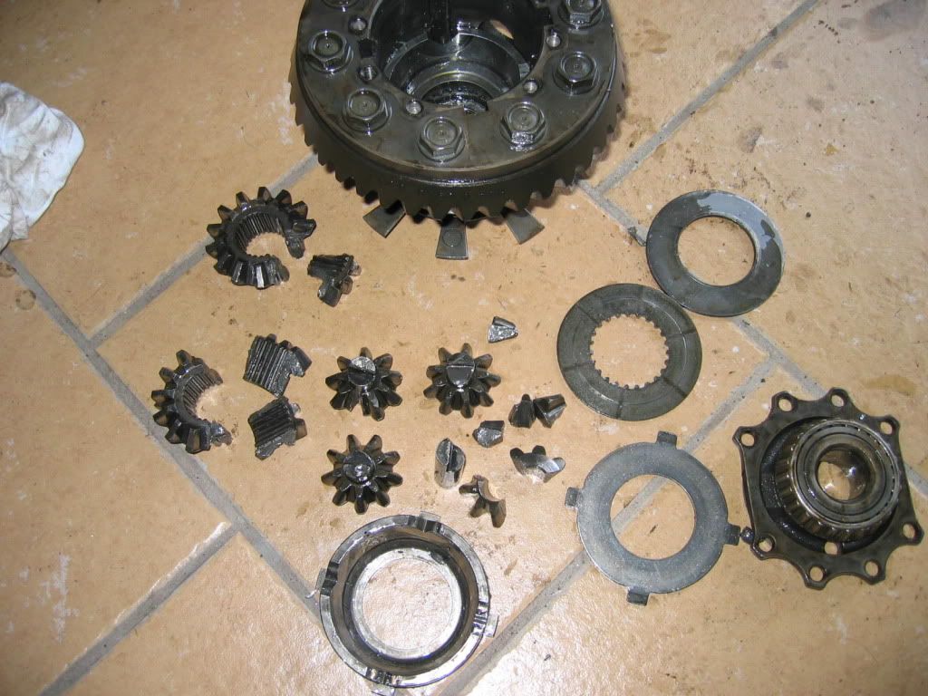

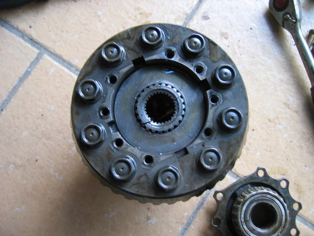

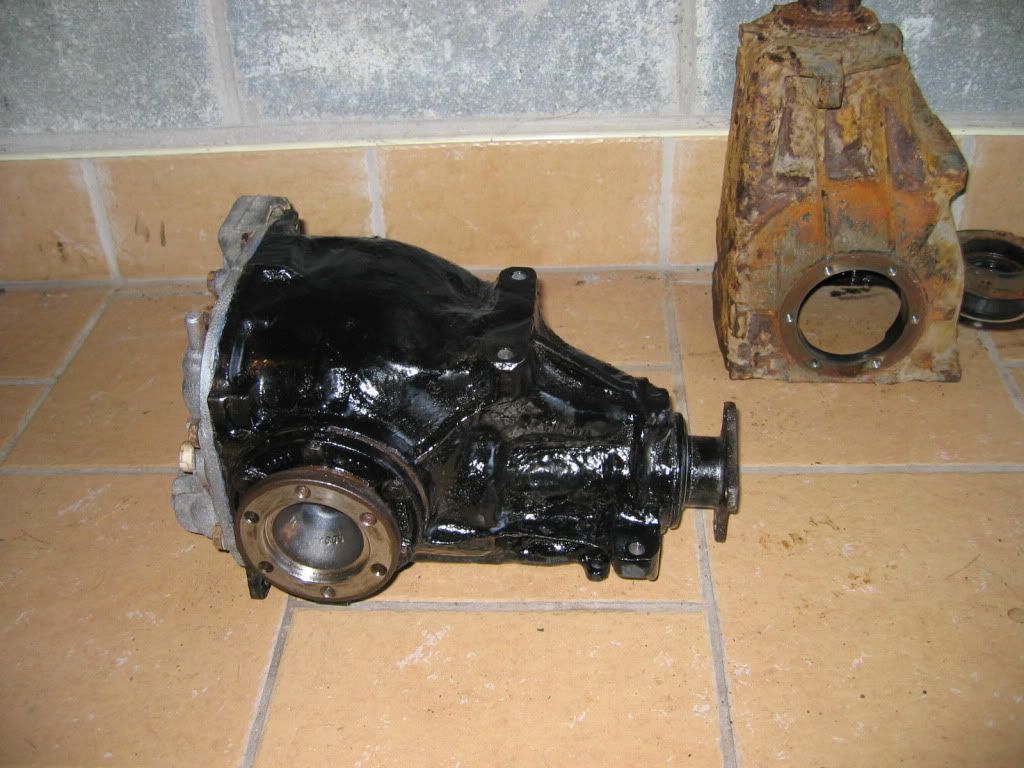

When i bought the car i was told the original LSD was scrap, so i sourced a 3.91 ratio lsd, and had it rebuilt with 40% lock up.
Here is a few shots of the old diff - Scrap is an understatement...
New diff ready to go in:

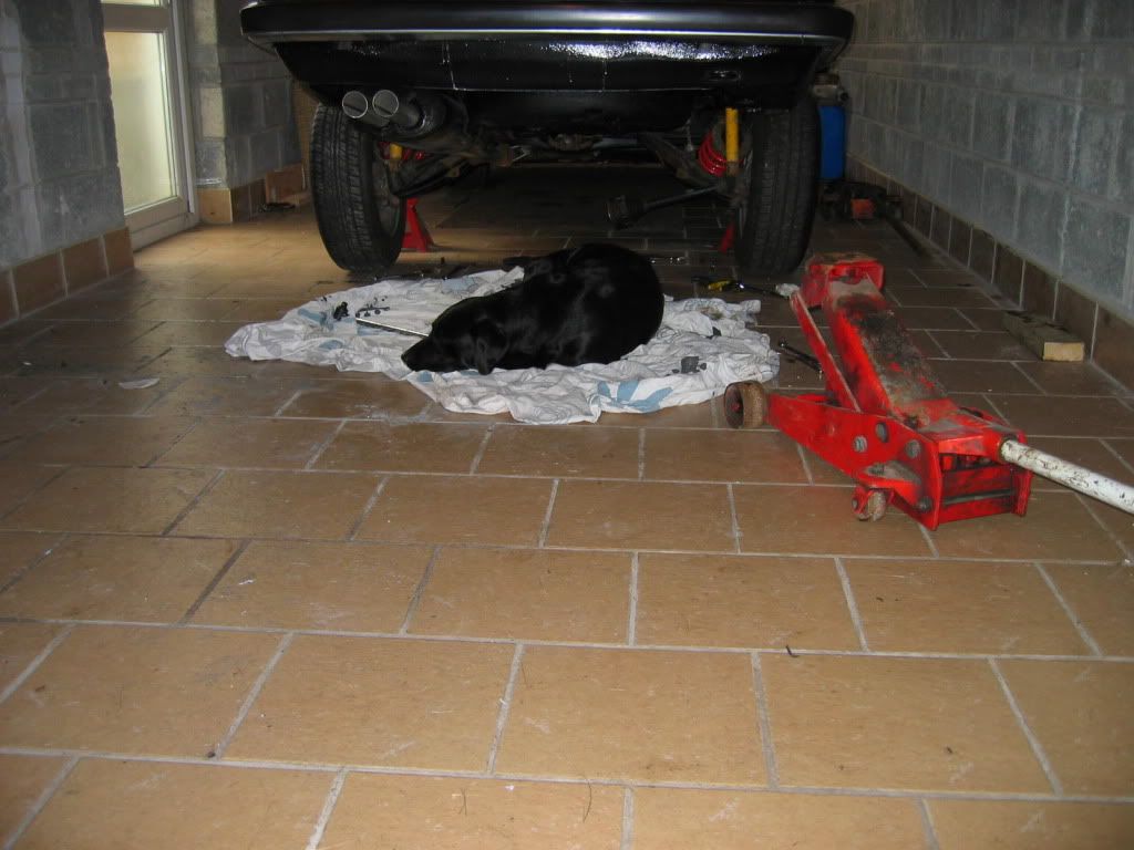

I had a helper that night:
Just making sure the diff was working- Had to be done really!!!!

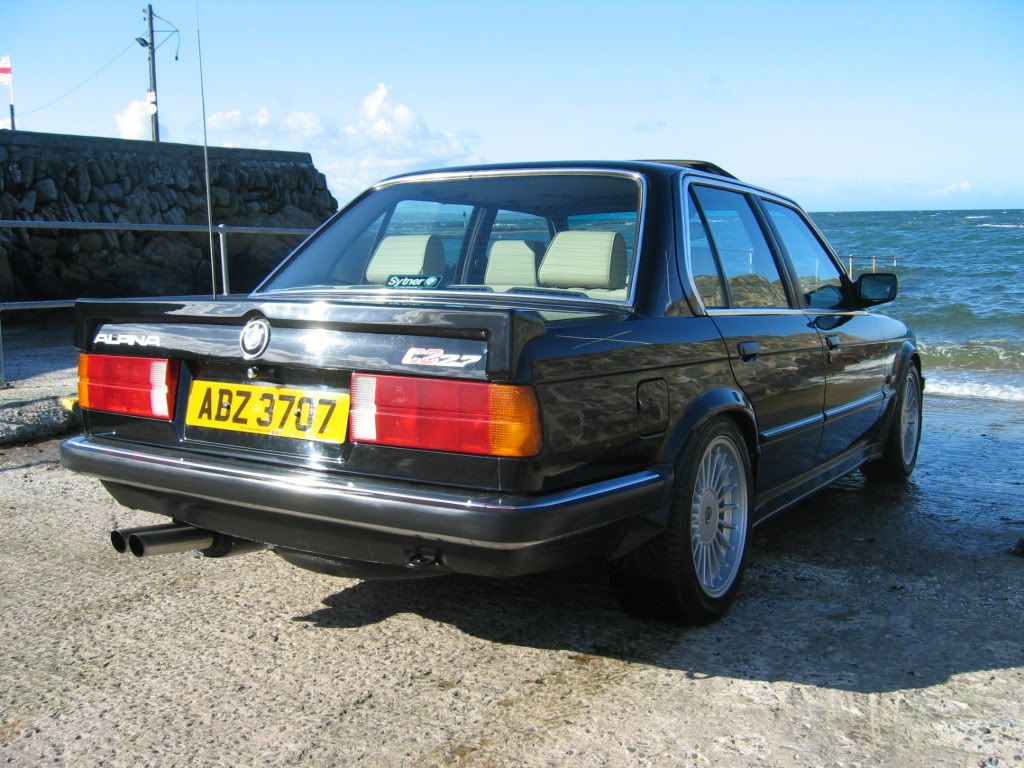

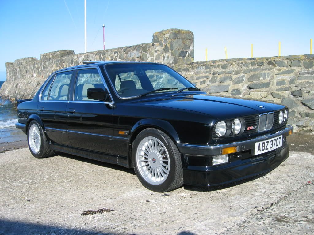

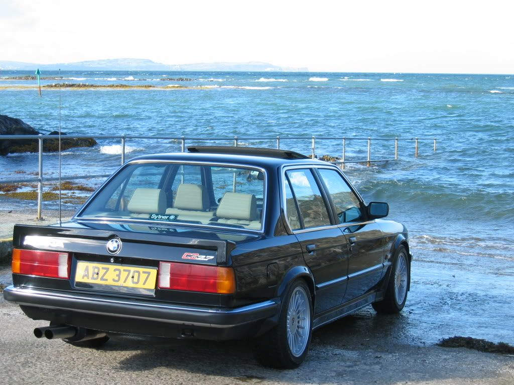

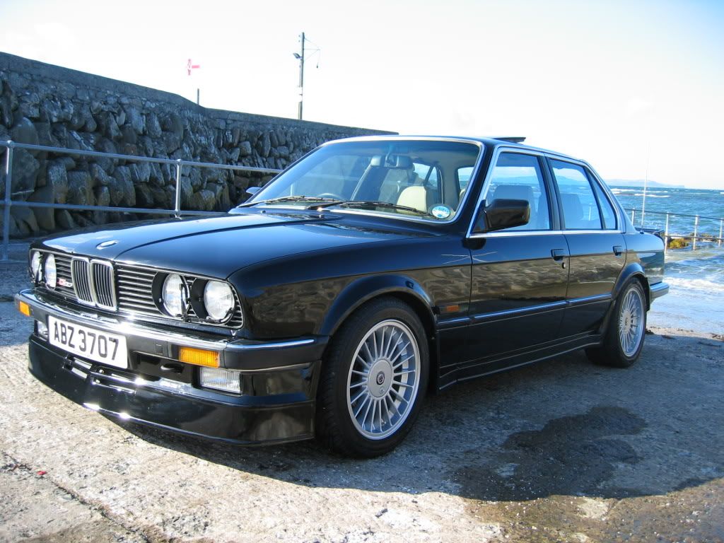

I've had this taxed since the start of this month and done around 500 miles in it. So finally got round to taking some pictures:

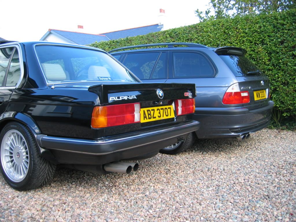

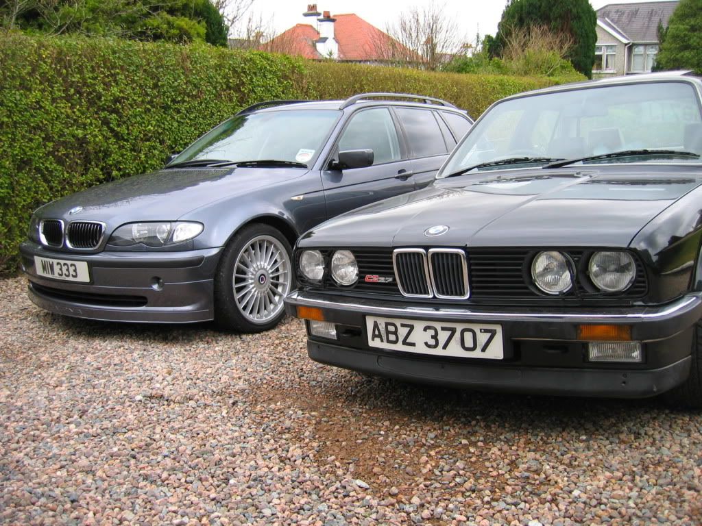

Here she is sitting beside my B3S. It make the e46 look so overweight....
It gets ALOT of attention on the road, which is hard getting used to, but in general its been excellent driving it day to day.
Only gripes are rubbish brakes compared to the e46, and an exhaust which is too loud at high rpm.
