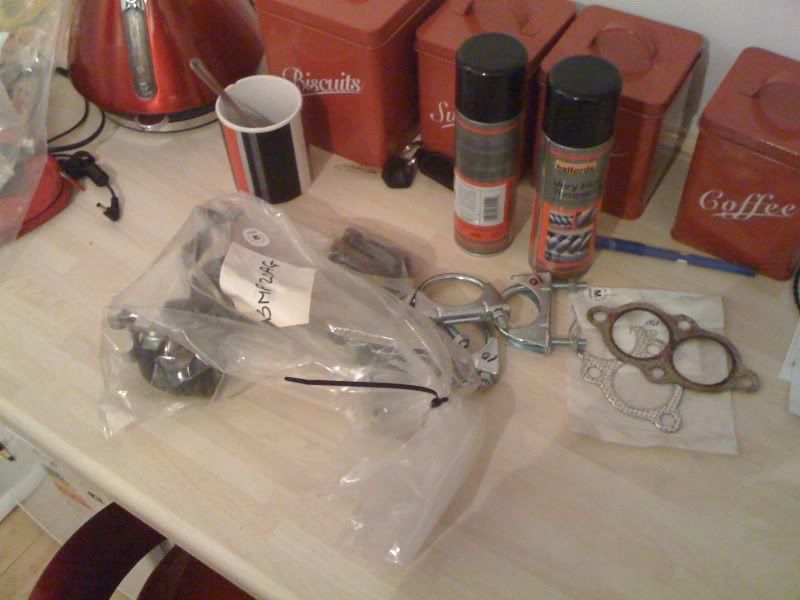

First off - the 'new' exhaust put together
Then went to get some new parts from the auto factors too
Predictably most of them were wrong!
One very rotten looking heat shield
Went back to the autofactor and got the RIGHT parts
Also been collecting bits and cleaning up bits to put back on....
Got the manifold flange end of the exhaust masked off
Then Painted matt black with VHT paint

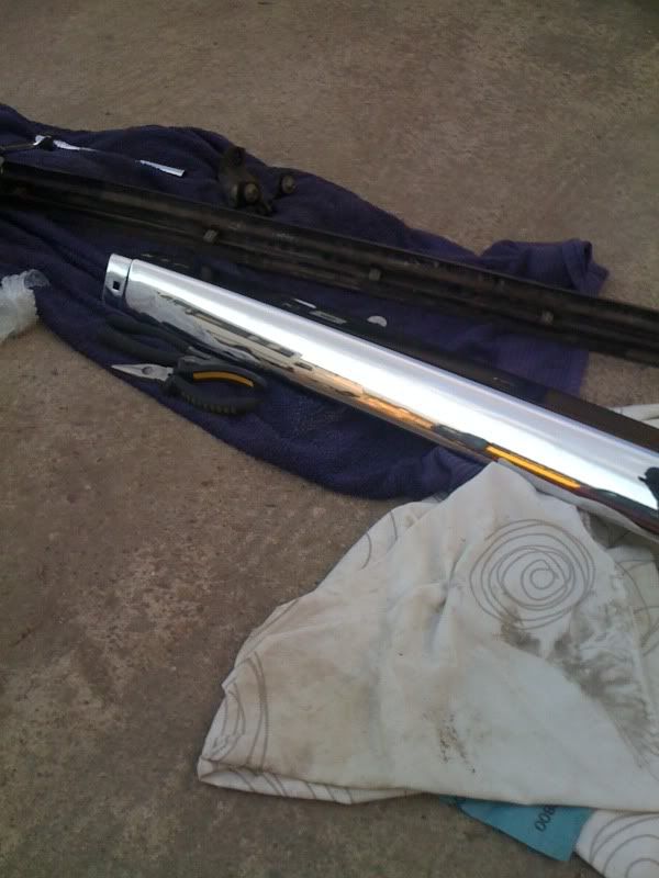

I bought a replacement chrome bumper as the original was bent so I started stripping the new one down - it's in generally good condition but needs new cover sections between the corner and centre section
Polished up the good sections

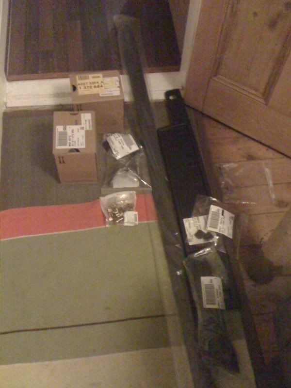

Then this arrived... a big parcel from our friends at Cotswolds...
Time to unwrap and I will post more photos later

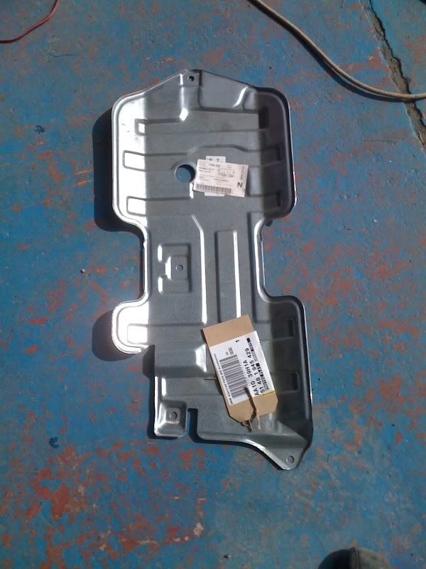

exhaust heatshield!

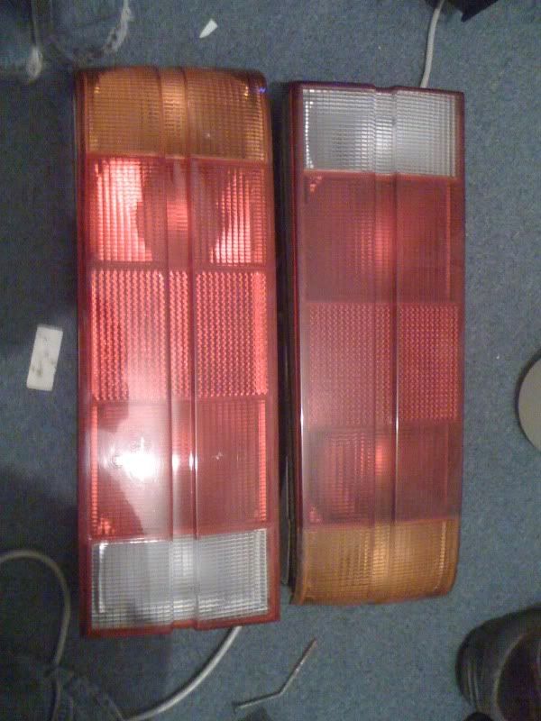

Light units with new gaskets after lenses were polished and new bulbs throughout:

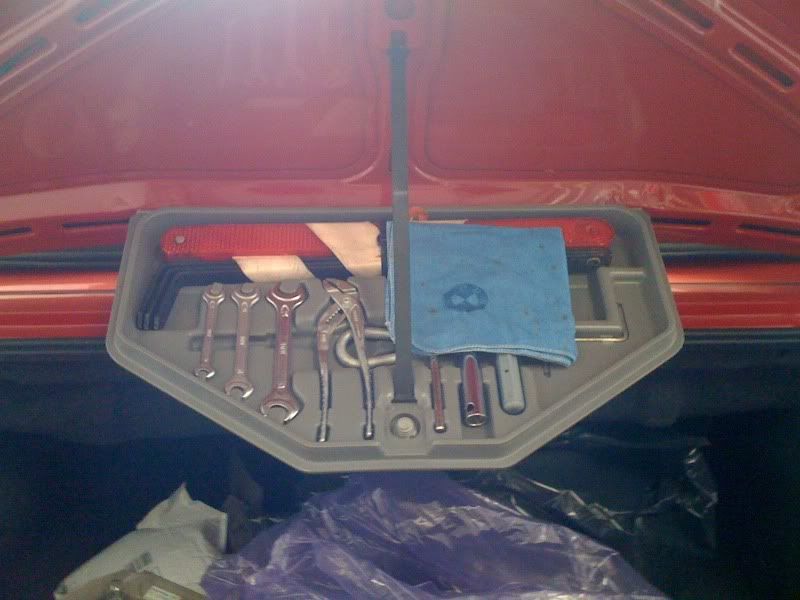

nice new tool kits in place:

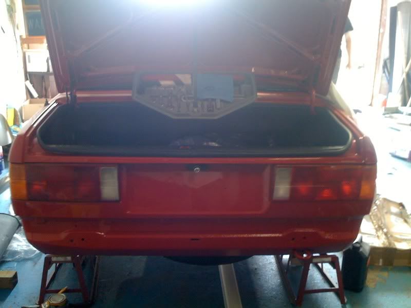

Lights fitted back in and re-gassed boot strut in (IT STAYS OPEN NOW - WOOT!)

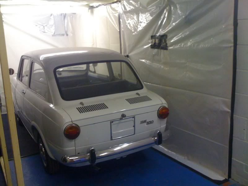

I have also been busy making a clean room for the Fiat which looks like something from Dexter Kill Room

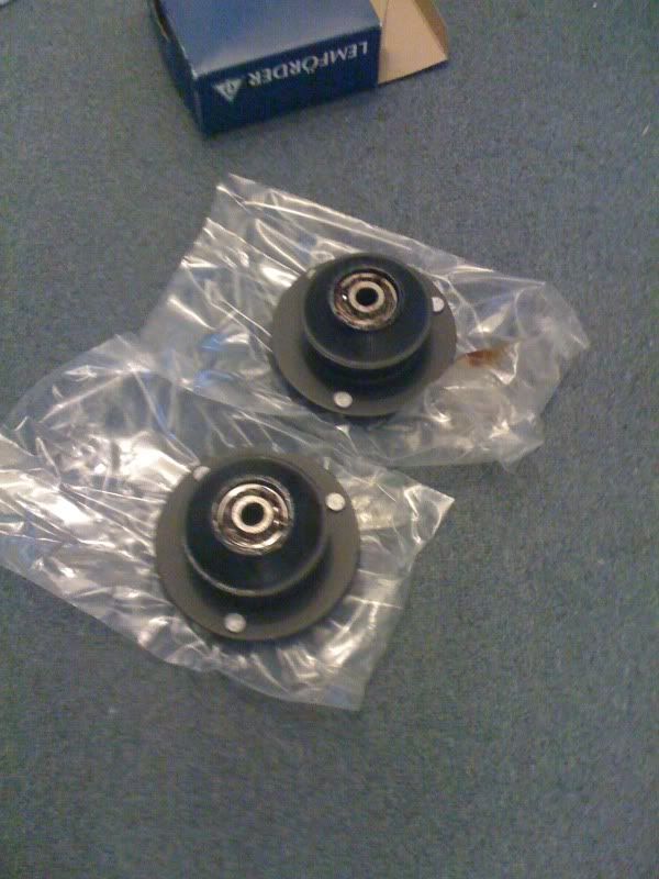

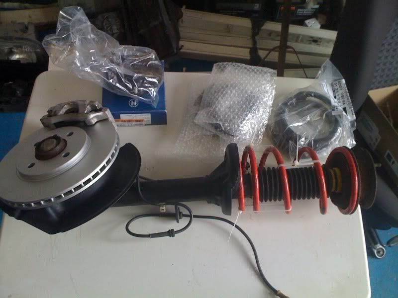

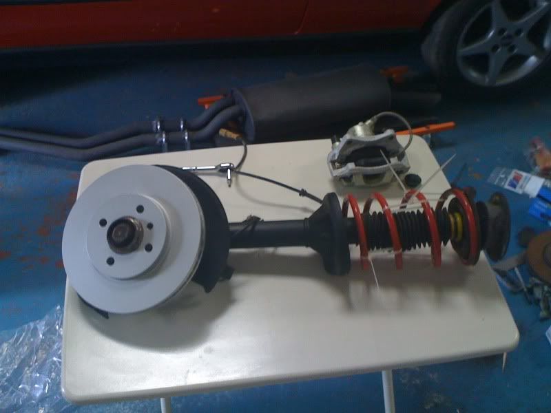

I have managed some work on the Cab though and I have been doing some work on the new struts - old discs and pads off, calipers cleaned and struts painted up:
All ready to go back on once I get the new top seats for the springs and top mounts. Note the spring compressors.... gotta love cable ties!

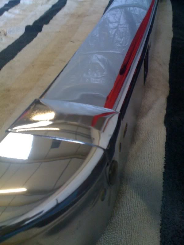

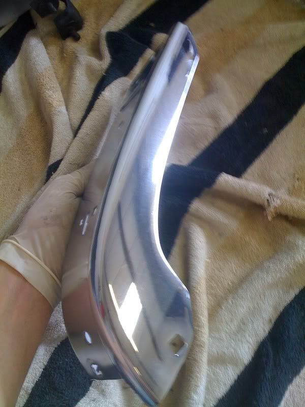

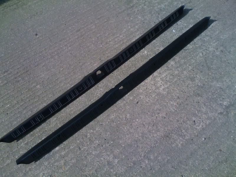

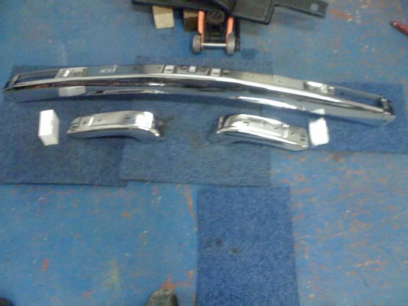

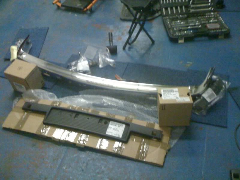

Small update - the new bumper joining sections arrived today. Ordered them from Hadrian Car Panels limited and they were really cheap - £18.50 each.... but it shows. Dealer wanted about £120+ each for them :-/
top ones are the originals with a smooth contour and good metal finish under the chrome, the bottom ones are the new ones, much thinner metal, a slightly more squared shape to them (I guess the press tool was much less refined) and the finish under the chrome isn't great so I don't expect they will polish up very well! Going to give them a go and see - if not, re-chrome the original OEM parts.... ££££££££

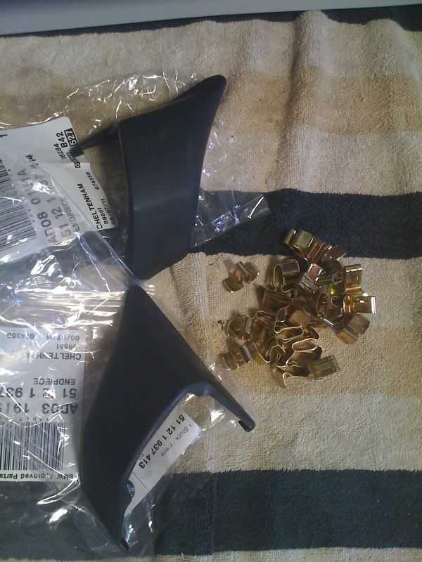

Then my parts arrived from BMW... YEY:
2 each of Items 9, 10 and 15 - simple..... oh wait:
4 of item 10, NON of item 9, 2 of item 15 and 2 of item 6? Why would you think I need 4 of item 10, there's only two struts on the car... and item 6 is the bits I just cleaned up that were already on the car (see first photo).... CRAP STICK!
I did get a boot strut that might actually work though now!
Top mounts should be arriving from Euro Car Parts tomorrow too!

update:
been fiddling with the cabby and the Scirocco today - got the strut rebuild complete with all new spring seats and top cap, new top mounts and assembled and cleaned up. I also rebuilt the back bumper now that I have the join caps and its looking smart - just need to order the new rubber bits!
Thats all for now really - most of the work was slow tinkering so nothing much to show - once I get the next batch of parts it will start to come together

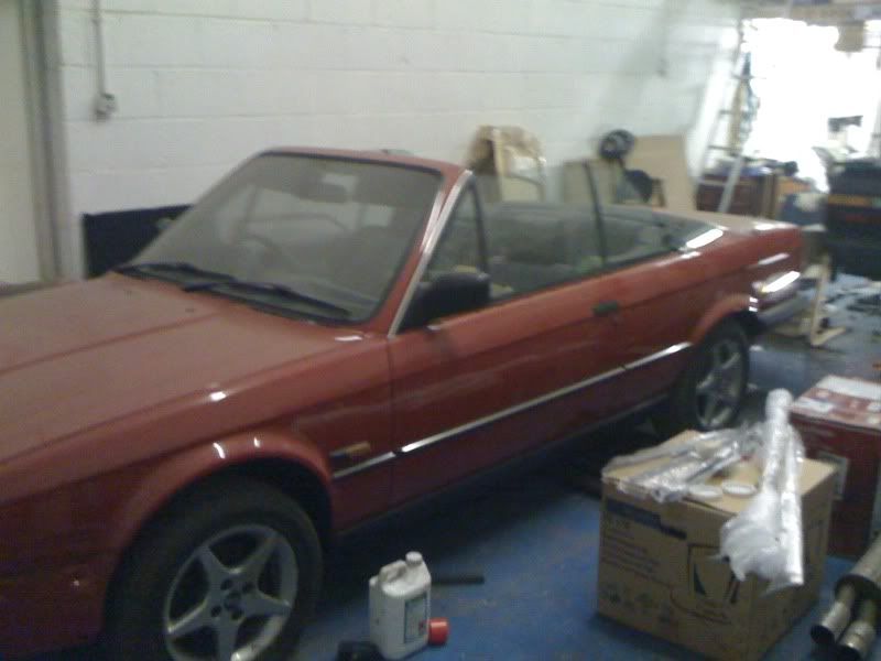

Bit more progress today...
Got a big order of bumper parts from Cotswold including all the rubber bumper strips front and rear, new indicators, bolts and clips. The bumper strip came in a 10ft long tube... that was interesting to get to the workshop in a scirocco!

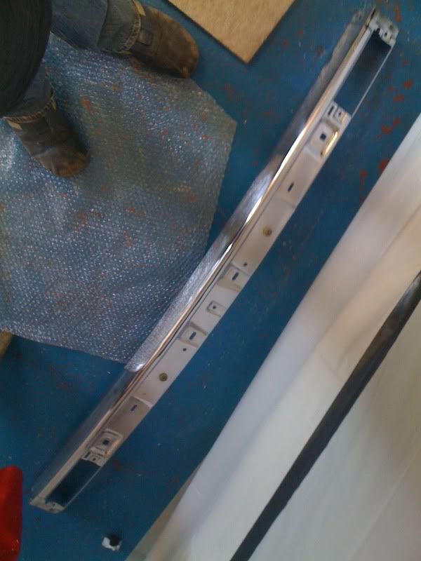

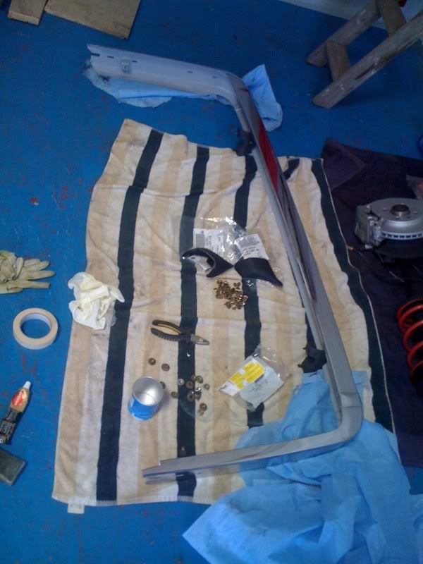

I stripped the rear bumper back down and cleaned the insides, then primed and painted with a random grey paint (Ford Dolphin Grey or something like that) to make them look more original and new - excessive; maybe, nvm!
Then start on the front bumper while waiting a spare pair of hands to come help me lift the bumper on... Before:
After
The front has come up OK but there is still a very light haze to the chrome even though it has come up super smooth and shiny so considering replacing them both.
Rear back on - starting to look like a car again now!
Looking pretty good - You can see now (anyone that followed my thread about numberplate surrounds) why I want the right surround for the rear, the gap looks large and it has to look just so to go with the new bumpers!
Got the front centre section polished up too and it looks pretty smart... from here
then on closer inspection...
C0CK! Need a new bumper then (seen as the two corners still have a haze) - not fitting £300 worth of brand new parts to a shite chrome section
Yet another expense!

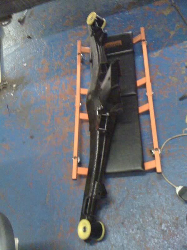

Then work has slowly started on the m535i!! Beams are back from coating... and now I feel the need for this to be done to the cabbie... this is going to be expensive!

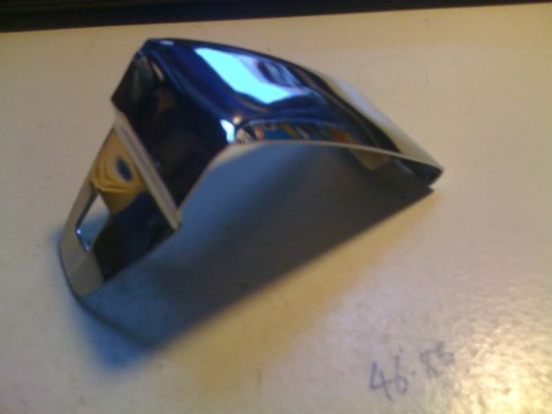

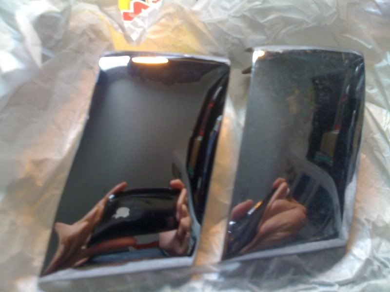

First up - new bits for the front bumper! The new joint caps looks the nuts (on the left) vs the scrubbly old ones (on the right)
Then I picked up a new bumper for the centre section which is in overall dent free condition and polished the hell out of it and painted the inners to protect from further rot as I did with the other ones:
Then on with the assembly...
Replacing all the rubber bump strips and plastic parts too for the real fresh look, even new indicator units... hmm shiny and pretty!
