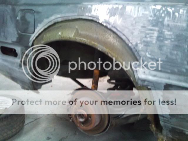

O/S rear quarter had quite a good dent in it, covered by a copious amount of filler. Ground all the clag out, pulled the dent, was left with this:
And the reason for the new arches:
Take it offf!
Inner arch rot at base of quarter panel/Sill.
These two were trading rust stories for some time:
Take it offf!
Onto the otherside:
Inner arch rot this side was much worse, so i ended up spending a sunday rebuilding the arch tub. Quite tricky as you have the get the shape spot on for the outer arch to meet up against it snugly, without the inner forcing the outer arch out of shape
Hopefully on those pictures, you can see i rebuilt the shape of the tub, in various sections, and then once the shape was right i tacked a band of steel at a 90 degree angle, around the arch tub, to give me a new return edge to which i could spot weld the new outer rear arch lip to.

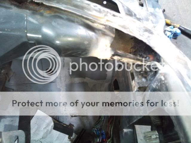

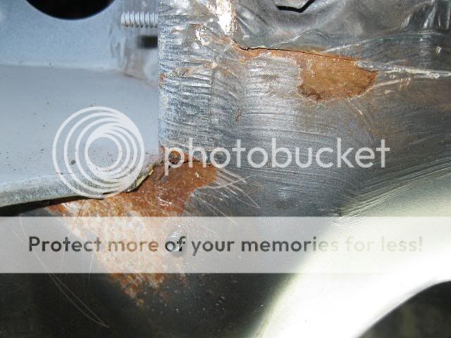

At this point, whilst giving it the once over, i could have sworn a saw the seam sealer move.......
Yup more rot.
This cars a turd. end of.
Oh look, one in the chassis leg too for good measure.
Partly my fault i suppose for not stripping the inner wings down and assuming what you could see on the surface was sound. Cranked the mig out of semi retirement.
I swear to god :X, this little hole was the most infuriating moment of the project so far. It was directly above the steering coloumn, which i couldnt be arsed to take out. And i wanted to weld it up from inside the car for neatness. This train of thought proved quickly incorrect, when i couldnt get to the area of grot to clean away the seam sealer and paint. Hence me lying on my back, in the car, welder popping and fizzing on the dirty sealer and painted metal, covering me in tiny lumps of molten mig wire.
Oh the joys of welding. :Cry:
Looked shit aswell but itll grind up.

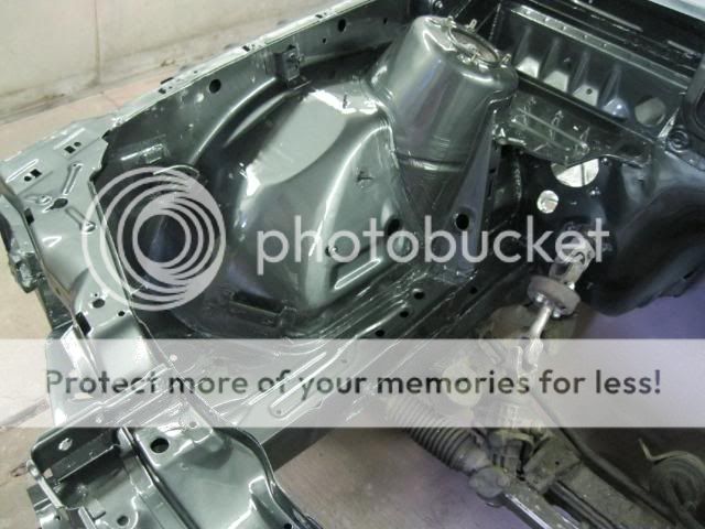

Time for a small update on this. Work suddenly became very busy in 2011, and the Sport has had to take a back seat. It was pushed into the corner of the workshop, covered over and forgotten about for a few months whilst customer's cars took priority.
However, in kit form, the Tech 2 takes up a LOT of bloody space
and now with cars and campervans coming out my ears, i really needed to start getting parts back on the sport, and off the floor.
So anyway, iv hit the engine bay, inside, parcel shelf and boot with paint, which will hopefully allow me to re fit wiring looms, interior, engine, box etc in between working on other cars. It will also free up some much needed space as things go back onto the BMW, and subsequently come off the workshop floor!
Oh and i went for a colour change aswell, Dolphin Grey wasnt really my thing.........
......Well ok ok i only changed the shade.
