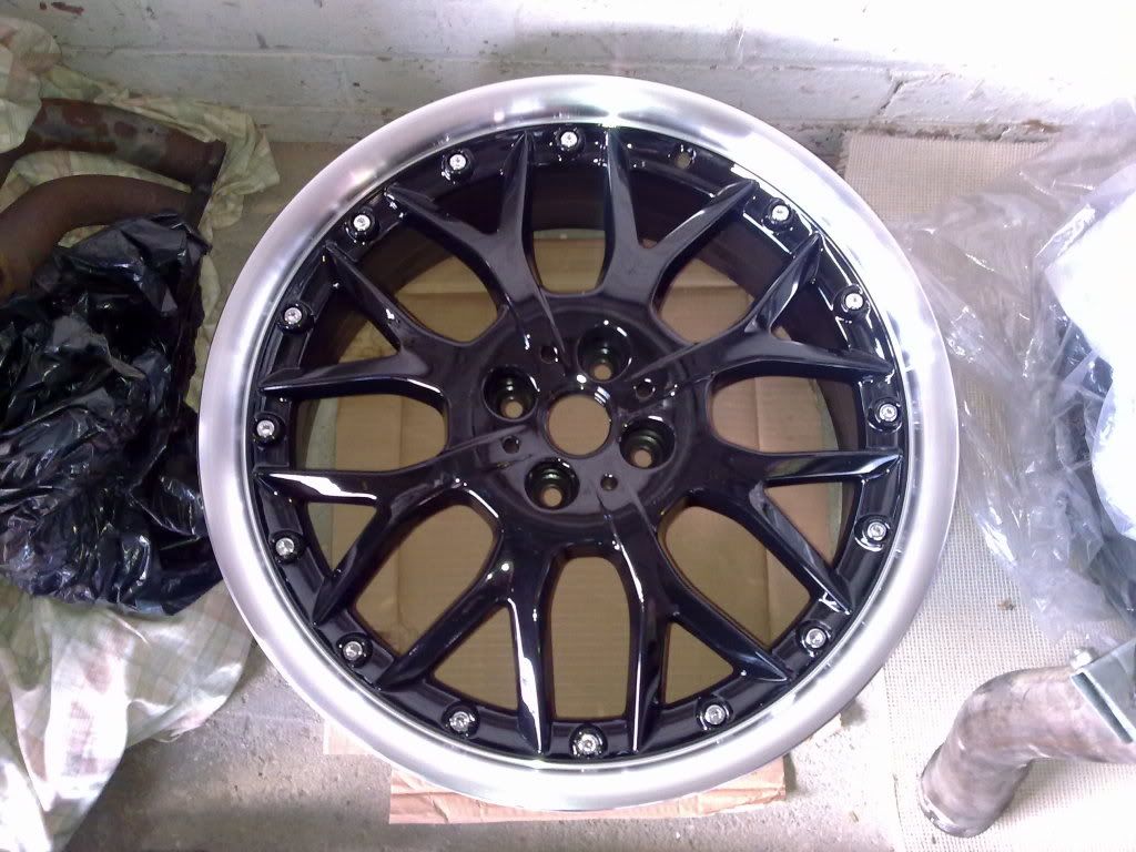

well guys i just got these not really what i wanted but hay they are brand new 18" delivered for £190........yes £190 delivered.
might just sell them on agaian for a profit. 18x8j 4x100 centre bore is 56.1 :roll: new mini wheels

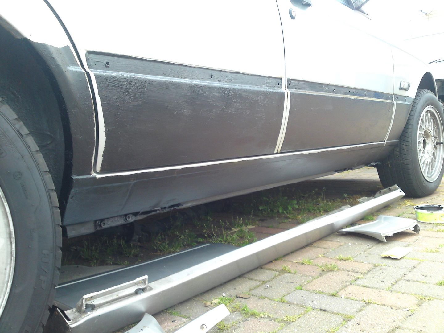

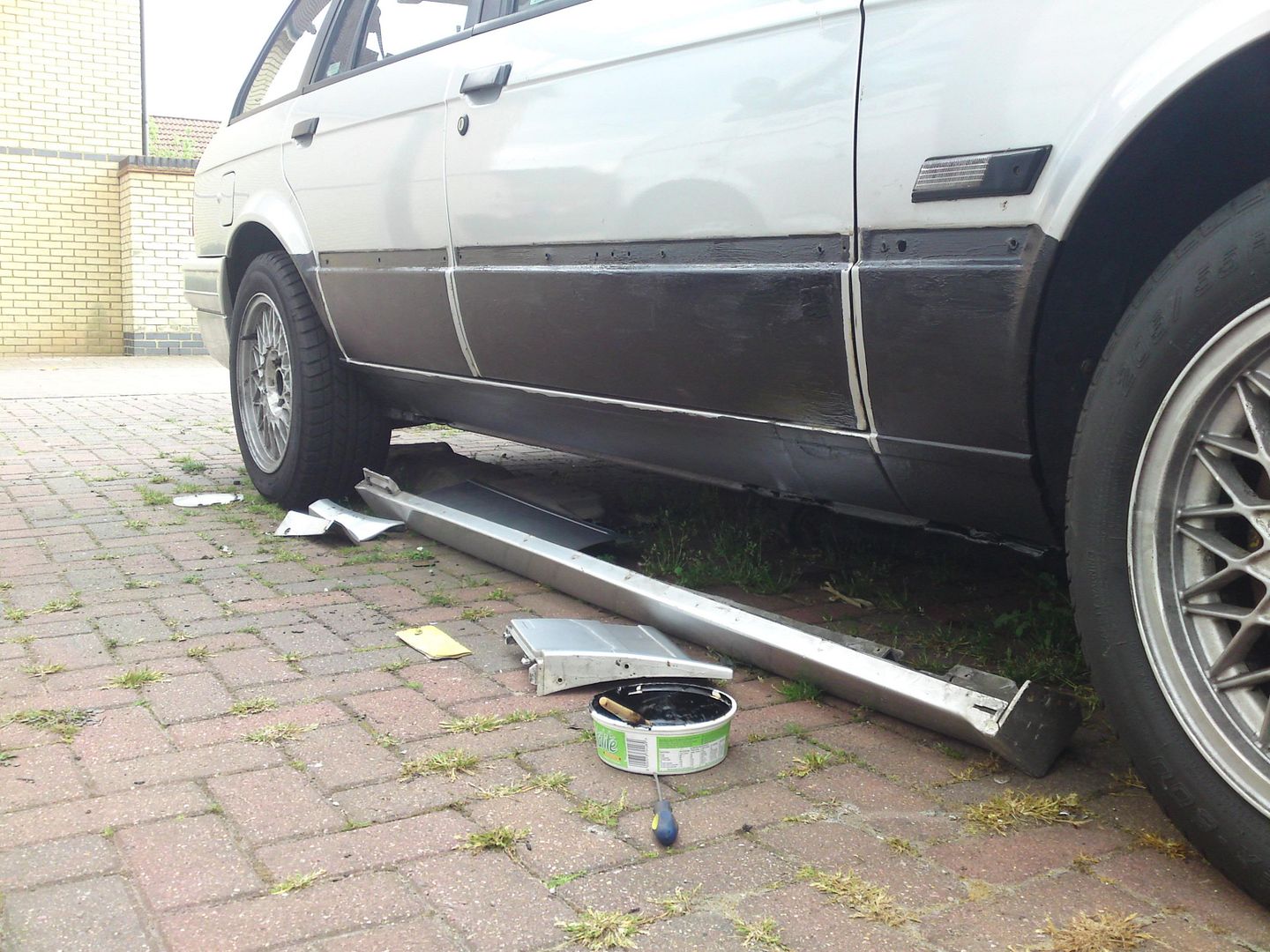

Taken the kit off today as it going off for it`s new engine next week so while i was taking it off i decided to underseal the bottem of the doors and side seals just where the tech2 pods will sit.
once i get it it back all up and running i shell be do all 4 arches and underneath the car.

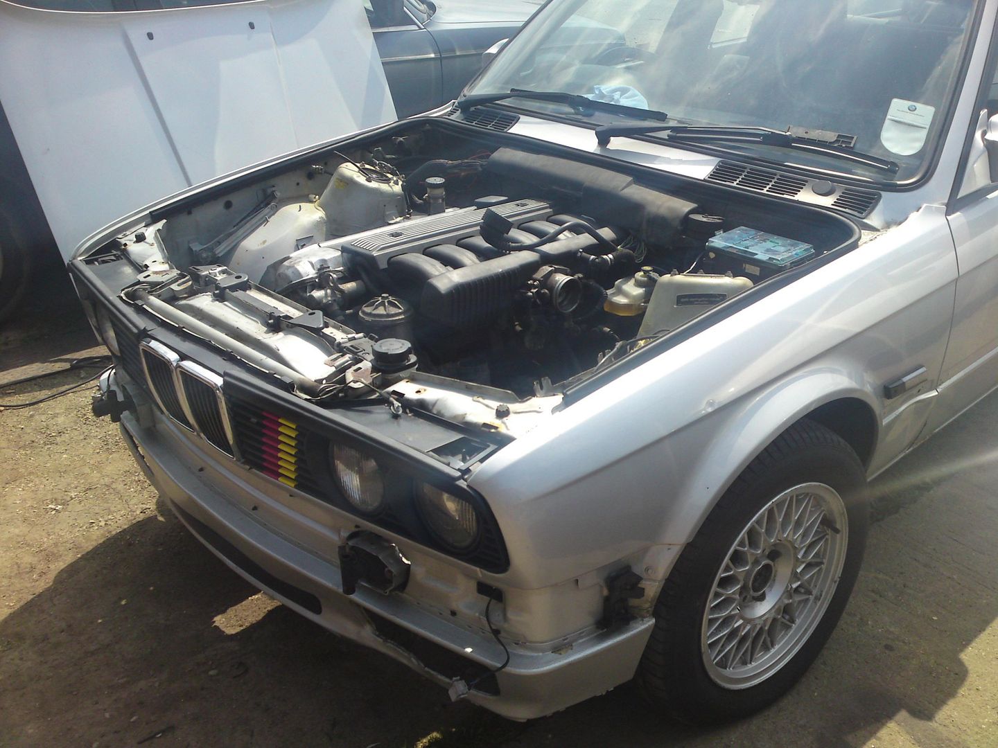

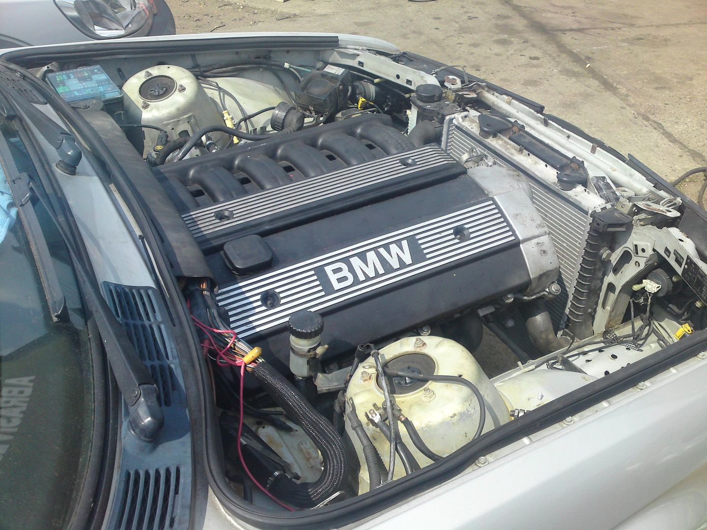

The touring went of on monday to have the engine put in by monday afternoon it was in them boys dont mess around, really looking forward now on getting back and getting it finished.

what underseal are you using baz.did you just paint it on.shame about the sport but it doesnt look like its put you off :cool:

mabz wrote:what underseal are you using baz.did you just paint it on.shame about the sport but it doesnt look like its put you off :cool:
it`s called tetra schutz very good stuff you can either paint it on or spray it on has a 50 year life long last on it, if you need some let me know as i do sell a few tins of it.

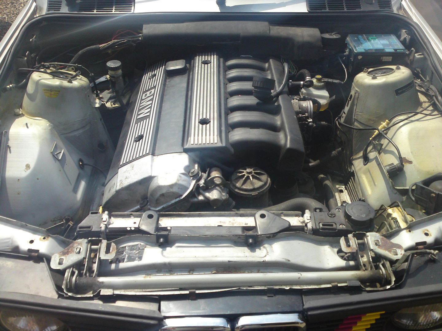

anyway happy man today the m50 is in :D

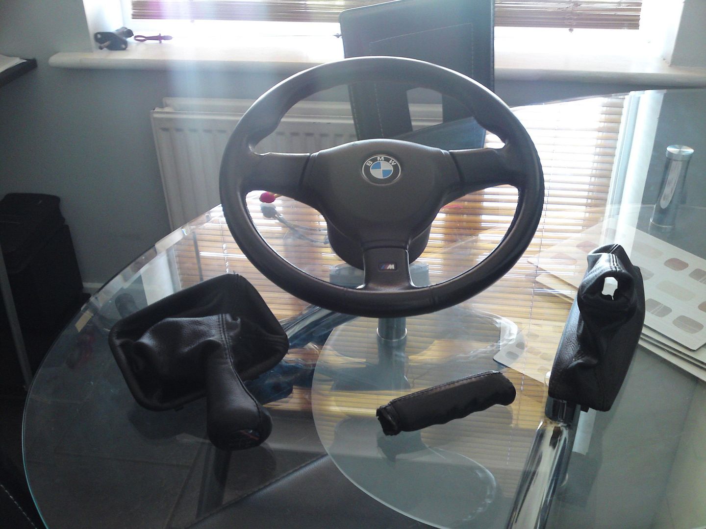

Out with the old and basic and in with the new and sporty.
370mm M-tech 2 wheel with leather handbreak crip and leather gearknob and gater.

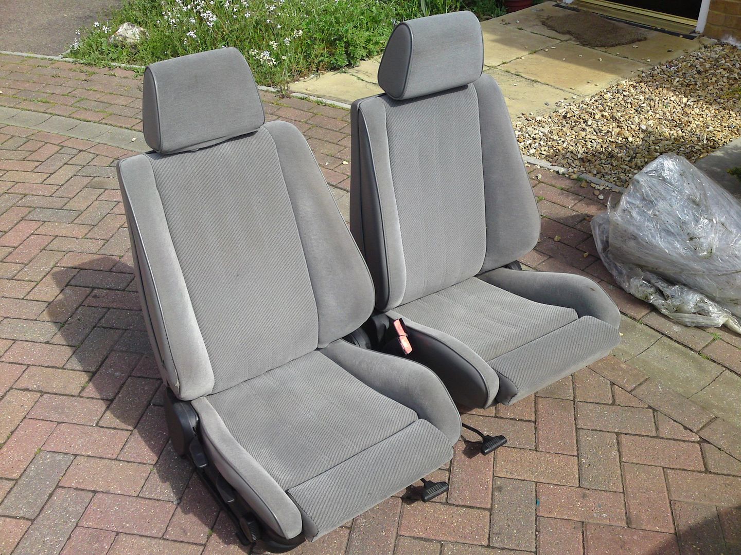

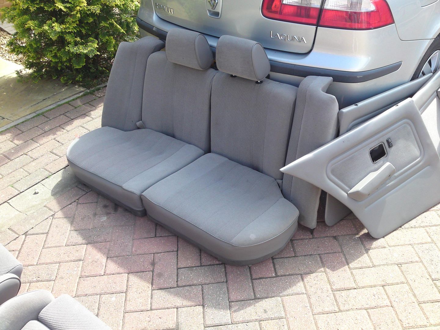

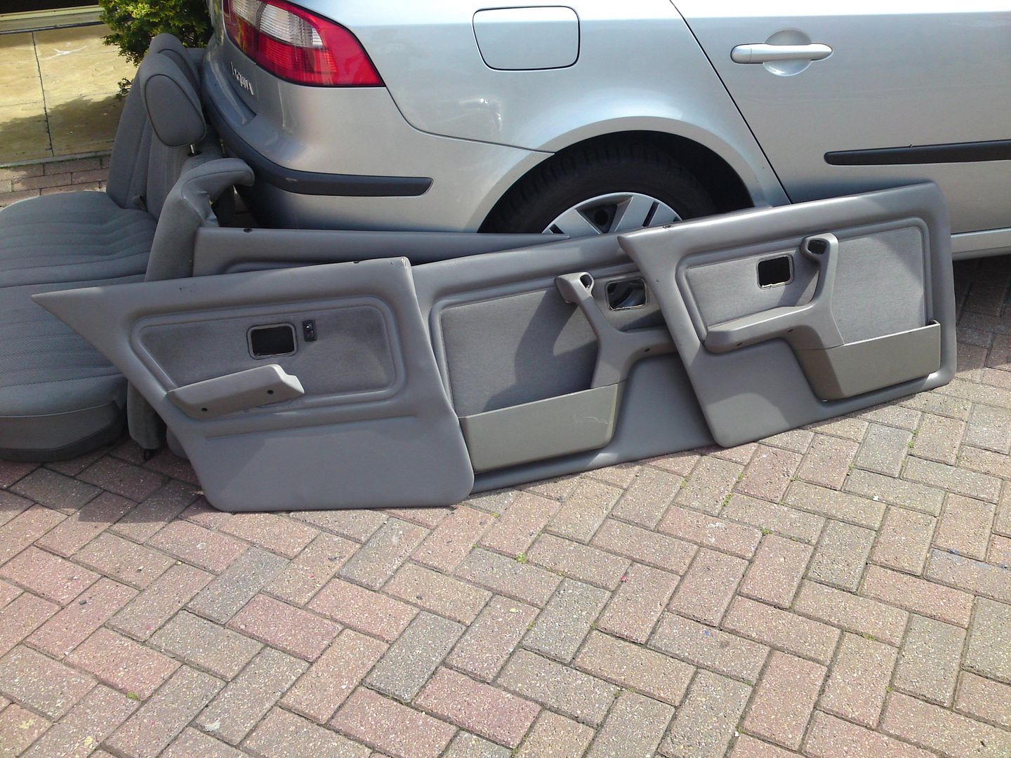

and my new spanking touring cloth interior.

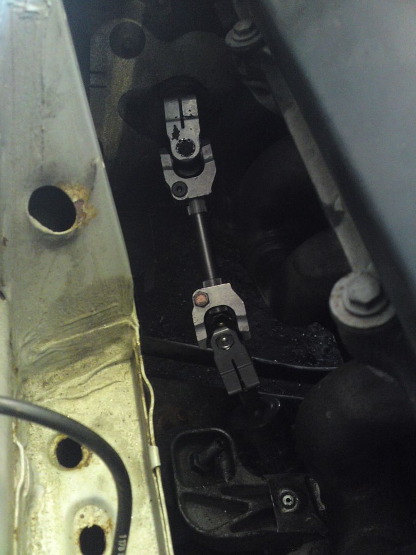

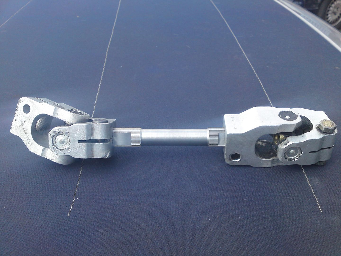

Look what Dan sent me great work fella and thanks for getting it back to me so quick.
and all most fitted :cool:
did have to give the manifold a bit off a beating did still hit. :?
Sat May 29, 2010 11:04 pm
Your best to cut the manifold Baz, a V shape cut from the underside of each primary on the rear manifold then bend it down and re-weld, makes all the difference and ensures no contact with the linkage, I have a fair bit of clearance on my track slag but it still touched on hard left handers
Standard
Cut underside and bent down
A good 15 - 20mm closer to the block for minimum effort
You will want to paint that splined shaft BTW they rust quicker than expected

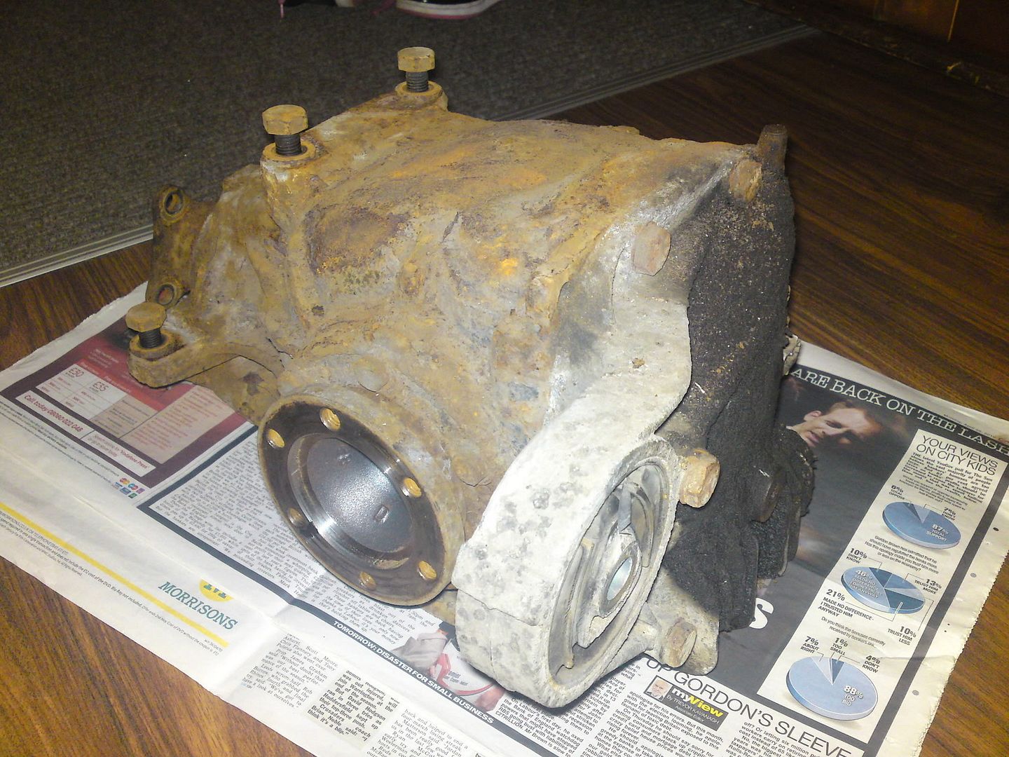

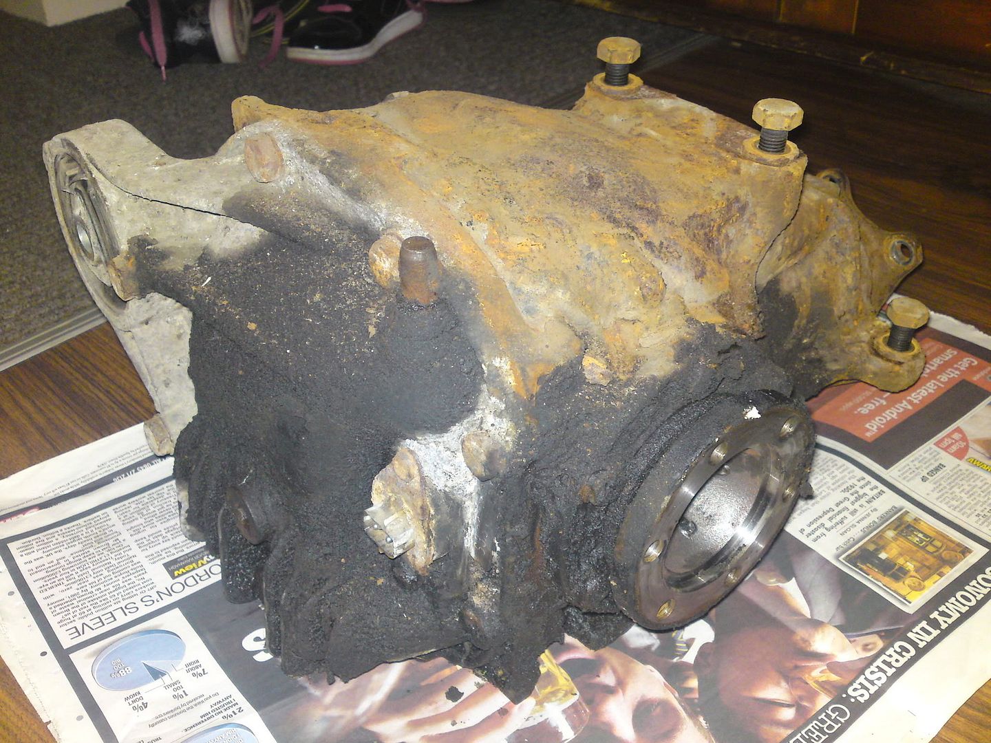

Look at the state of this diff, got it off today was glad to see a tag on it saying s3.91 :D
i`m looking at sending of to garath as anyone sent one of before as there bloody heavy if so how much will it cost.

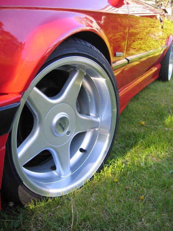

also what do you guys think to these on a touring ? brock b1`s 16x9 all round.
Tue Jun 01, 2010 12:27 am
Baz i really think this car would look the bollocks with a set of 15" BBS to give it that sleeper type look, with it being such a nice looking shell.
