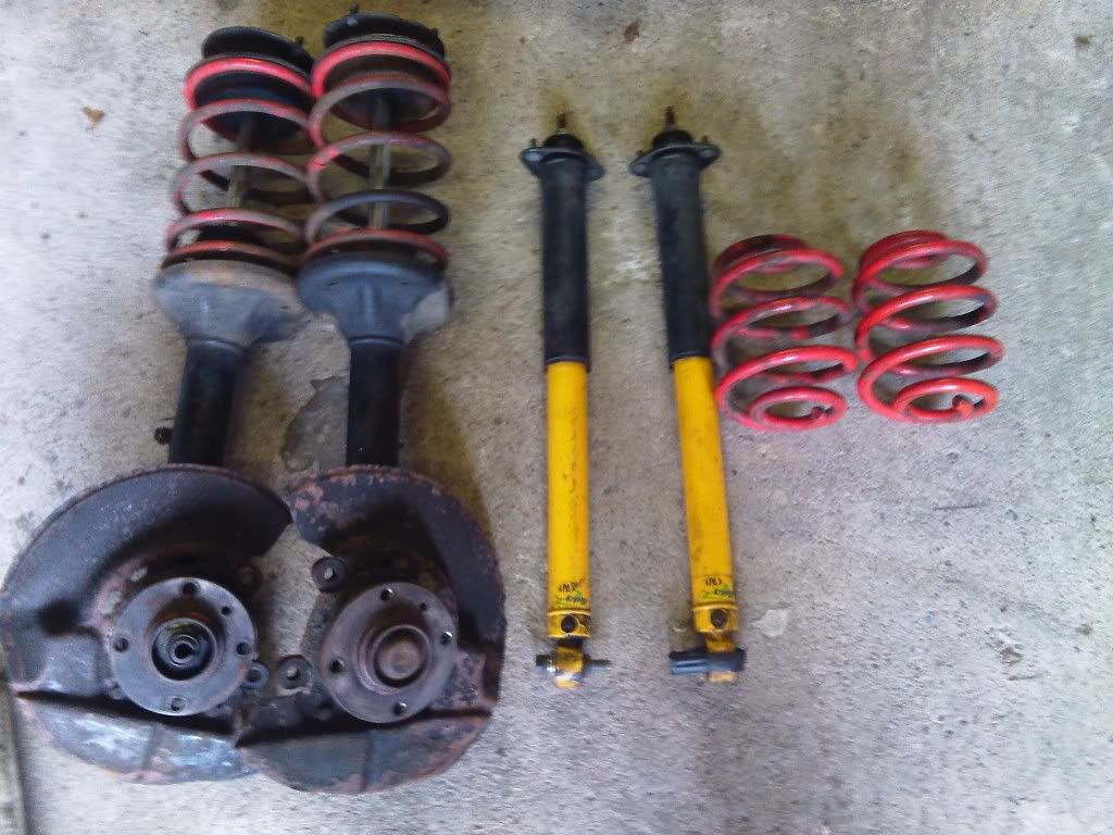

This is what i got at the moment

If they are 51mm legs then you just want some 6 pot front 40mm springs and the rest will be fine. 8)

Sorry for being ignorant but how do i know if they 51mm?

Measure them mate. It's diameter of the strut leg. :D

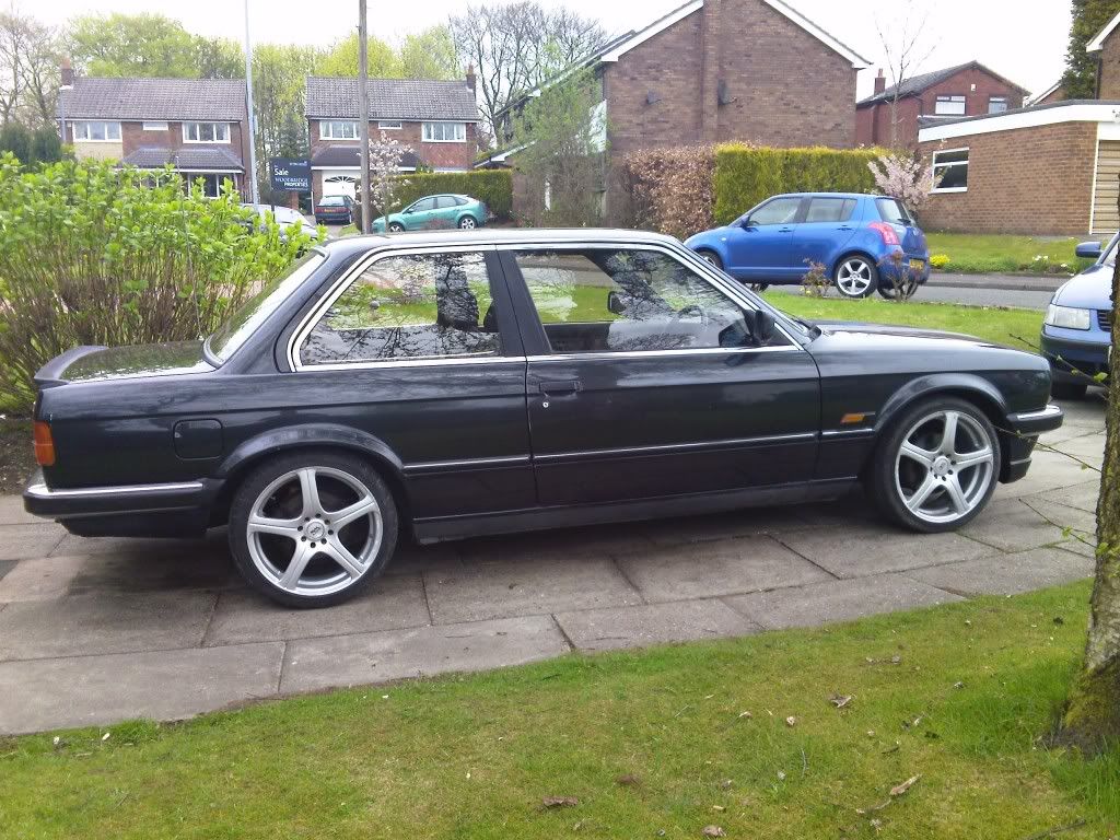

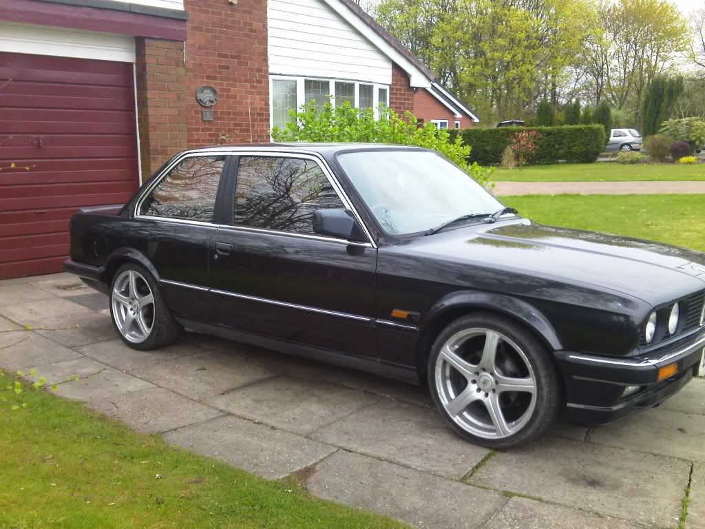

Please ignore the wheels
Lowered with spax adjustable coilcovers -40mm looks allot lower thou`. The ride is stiff as F.... I need to adjust them. I now got two option 15` BBS split rims of a golf mk3 or 17` black alpinas
Some pics:

Get the BBS splits will look quality.
Coming along :cool:

Right andreia,
Firstly, nice car. It is excellent to see a really nice tidy chromie, you've done well to find one in such good condition!
Regards the suspension, the adjustable spax units you have will obviously directly fit but the spring rates will be for the m10 engines so softer than what you require, so handling will not be as good as fitting the correct springs. You could always contact spax and get different springs. I am guessing they are the rsx units with the krypton gas? If so they should be able to supply you with some springs. Yours will be the same as the 320i ones.
Keep up the good work.

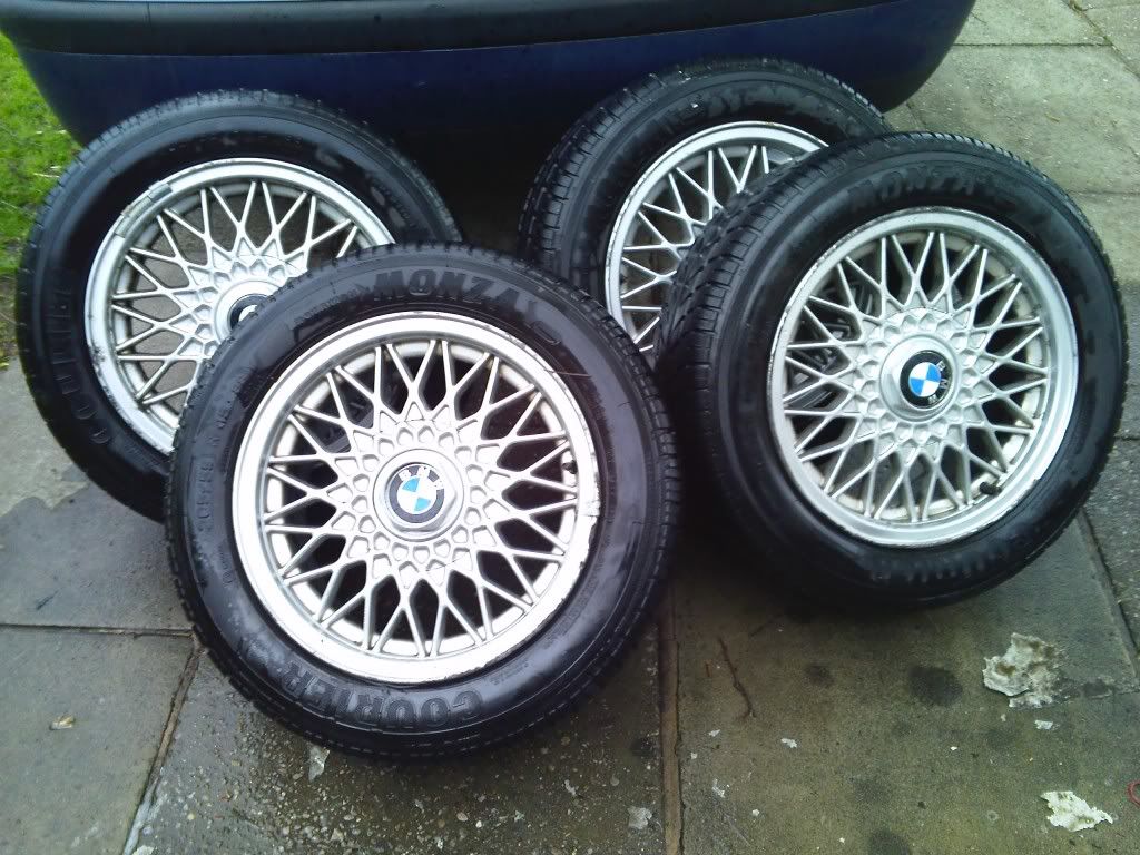

Got these set of bbs today thanks to Eternety 15` they`r in average condition, good tyres and one centre cap missing, Got home and gave them a quick wash. I want to refurb theese whells what is the best diy process and what products to use? I might just put them on like this, get a centre cap and refurb them in winter. Some pics

they look great, some good old tcut and a tooth brush will bring them up minty, spend 20 mins per wheel and you probably wont want to refurb them

I would agree with alex. give them a good clean and get them on the car and get a pic up shell look a lot better wearing them

i bought a touring for £70 it had a set like that, looked dirty ish and not brilliant, the wheels themself after a clean and tcut with a tooth brush made me look a fool for spending £200 on a refurb then new caps 8O i was impressed, my step dad was the one who did them
the only thing is you will have to put up with any curbing :D
before
not really the best pics, but the wheels looked that they had just been refurbed, think he spent the best part of half an hour on each though.
after
hope this helps :D
it will only work if the laquer hasnt peeled off and gone nasty

Wheel acid is your friend here, I used Mer wheel cleaner which is acid based on my Hartges and it did a fantastic job of getting all the grime out. Wonder Wheels is another acid based cleaner, you will need to protect the wheels after using acid cleaners though or the dirt will just get straight back in

I have some tcut in the garage so il try this first, unfortunatly the laquer has started peeling on one of them also they have the odd spot of what i think is surface rust, they do look good in the pictures ( i have a very good camera, and they just been washed) but o a closer look you can see all the defects. The shell is not perfect and will get a full respray in the winter so il t cut them and put them on and will have them done proper when il respray the car. At least im on the wright path after the mad moment i had with them silly wheels :D
